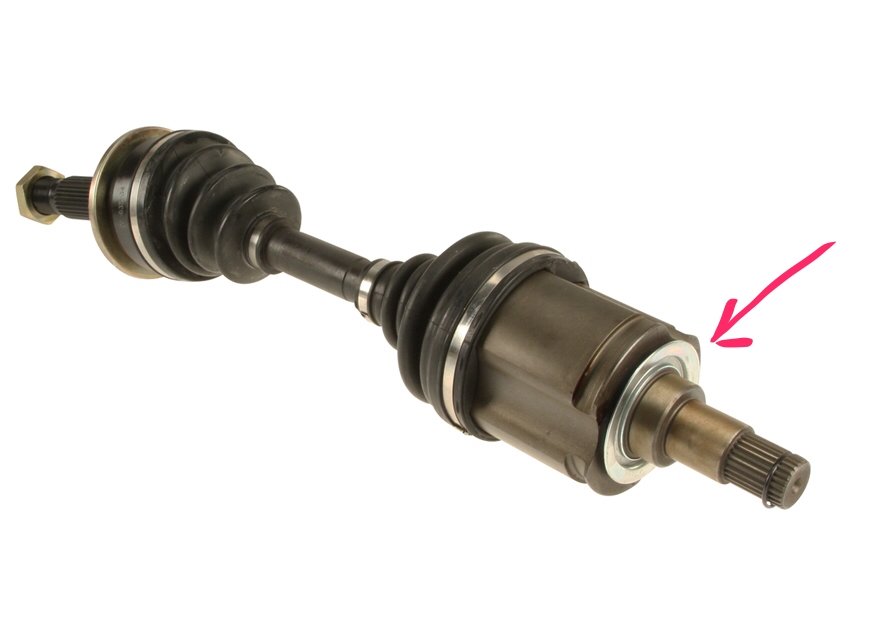

    Did you bend the little collar that is in the cv nearest to where it goes into the diff at all?

    No not the lock ring. I was wondering because when I took my axle out I just pried against the flat collar that sits close to the differential to get them out and I could see that if I didn't bend that back into place it wouldn't allow the cv to fully seat inside the diff when I put t back in. If the cv wasn't seated I think you would know. It would've fallen out when you were putting the other end into the hub assembly I think.

    This silver part is what I was talking about

    I think I straightened those out. I wasn’t able to pull it out by tugging on it for sure.
