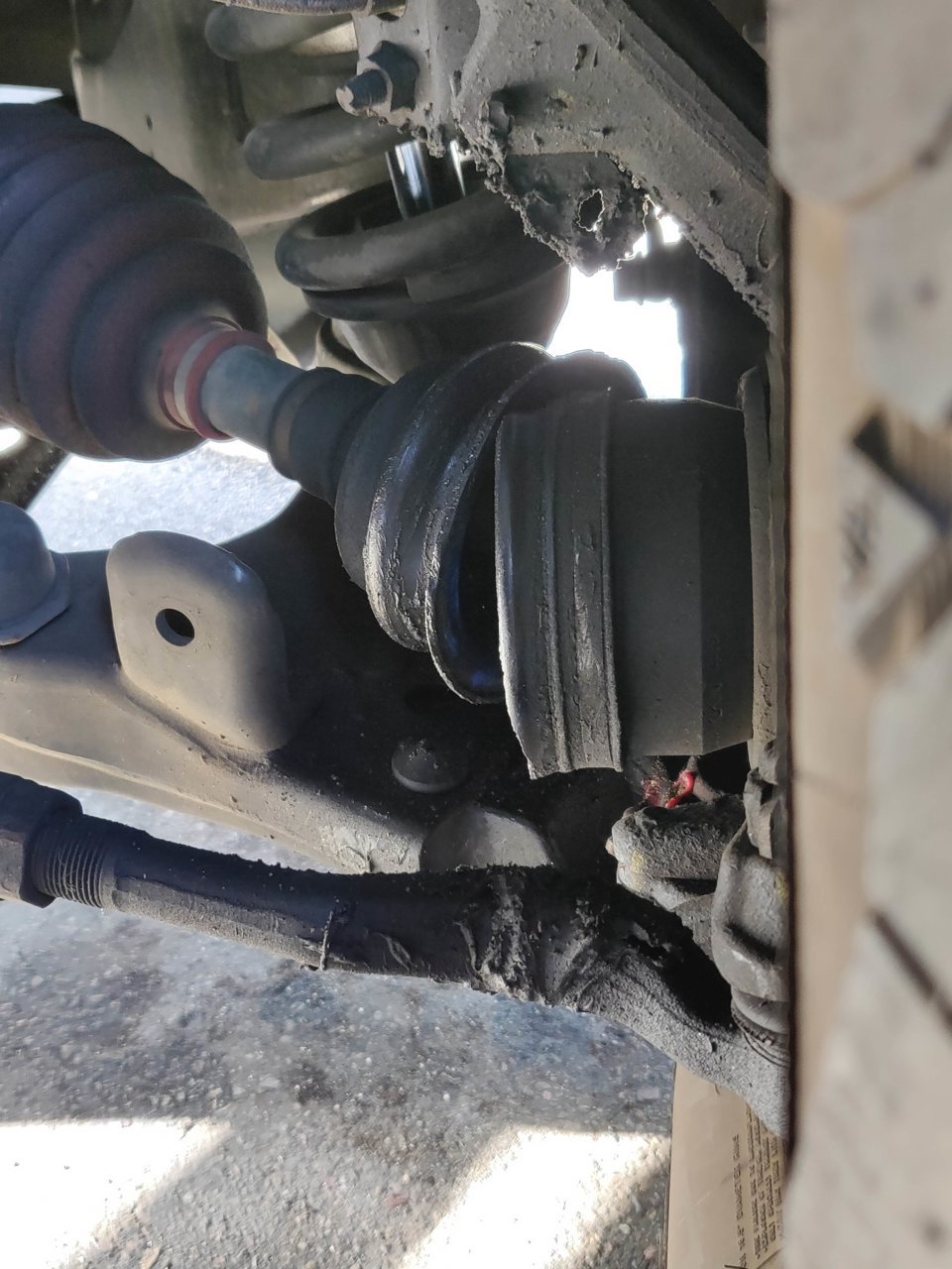

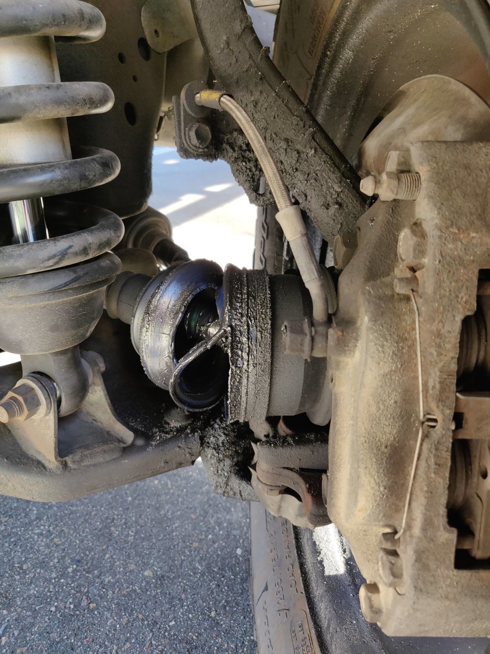

    Welp, both of my outer cv axle boots are toast. These are CVJ rebuilds with upgraded boots all around. Not sure how many miles are on them, maybe 20,000? (using how many oil changes since swapping them) and just shy of two years. The axles are still good (good cores/rebuild parts I suppose), but there has got to be a better boot (bold because I'm not bitching at CVJ) option- are there any other options?

    From what I've heard most people just reboot them with the kits from Toyota, is your CV angle really bad or something? That seems quick to blow through them. How much lift do you have?
    Somebody more helpful will be along shortly I'm sure, but I'm curious of the answer too as I just replaced both mine with OEM spares and will be rebooting my stockers soon.

    My lift is pretty moderate, I didn't even adjust the Icons, I kept them at the factory/pre-configured lift they came with, I even have an OEM like rake by having 1.5" aals in the back. But, the fronts are mid travel/extended droop, so when I'm romping around they are allowing a lot of droop.
    I'm thinking of going with CVJs again, but with OEM boots this time.

    Well, it's about the same amount of work to pull the axles out and completely replace them as it is to pull the axles out, repair the boots and return the axles.
    Considering the outer CV joint could have been exposed for some time before you noticed the damage and the joint is almost certainly contaminated, you're going to need to clean the joints, re-grease them, install new boots and then return the axles to the truck. While that is the less expensive route; the bulk of the work is still removing & replacing the axles.
    I agree that 20K miles is awfully quick for the boots to fail but I think I would just pull the axles and put new ones in. It's a little more money but about the same amount of effort. Plus the fact that the boots failed so quickly would make me worry about the quality of the rest of that axle and CV joints.

    $400 for OEM or comparable quality CVs isn't outrageous...would probably pay more than that if you bought them from Toyota. You can get them from Vatozone for as little as $60 per side or ~$90/each from Napa...that's where I get my spares. Still running OEM but have Napas as backups for if/when they fail. At least with most cheap CVs you get a lifetime warranty...even though having one fail on you and having to repair it on the trail kind of sucks.
    Seems odd that a place like CVJ would use low quality boots that would break like that in only 20k miles...my OEM boots see some abuse and have lasted longer than that. When my old ones tore the just got a little crack in them...They didn't pop off completely like yours did. Weird
