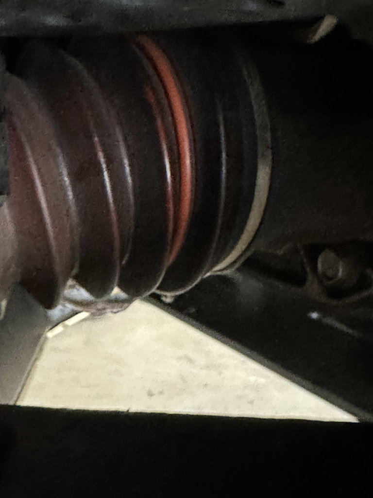

  5. Jan 13, 2025 at 5:36 PM
    Ginger-Vitis
    Ginger-Vitis Well-Known Member
    Jan 14, 2020
    #316105
    311
    08 Tacoma 5spd
    So I have a messed up issue. With my current suspension set up at full droop, I am literally pulling the tulip bearings out of the inner cup and destroying cv's. I tried putting my sway bar back in to limit droop and it's still an issue. Does anyone have dimensions of the extended travel CVS from Napa? It looks like I need at least another inch of axle or an inch of inner cup. Not trying to spend our RCV money at this timePXL_20250114_012545437.jpg PXL_20250114_013352940.MP.jpg

    Do you have limiting straps for your lower control arms? If you're allowing that much droop, you're likely also maxing out the swing in your ball joints and putting those under a lot of extra stress.

    311
    08 Tacoma 5spd
    Limit straps are ordered, after pulling measurements I've only got 2"of down travel with no moment. Planning on setting 8" straps to 1" of down travel expecting them to stretch another half inch. But even at one inch of droop I can still feel the tulip bearings coming out of the cup on the inner CV. Ball joints are a constant problem. But I don't mind changing them once or twice a year.
