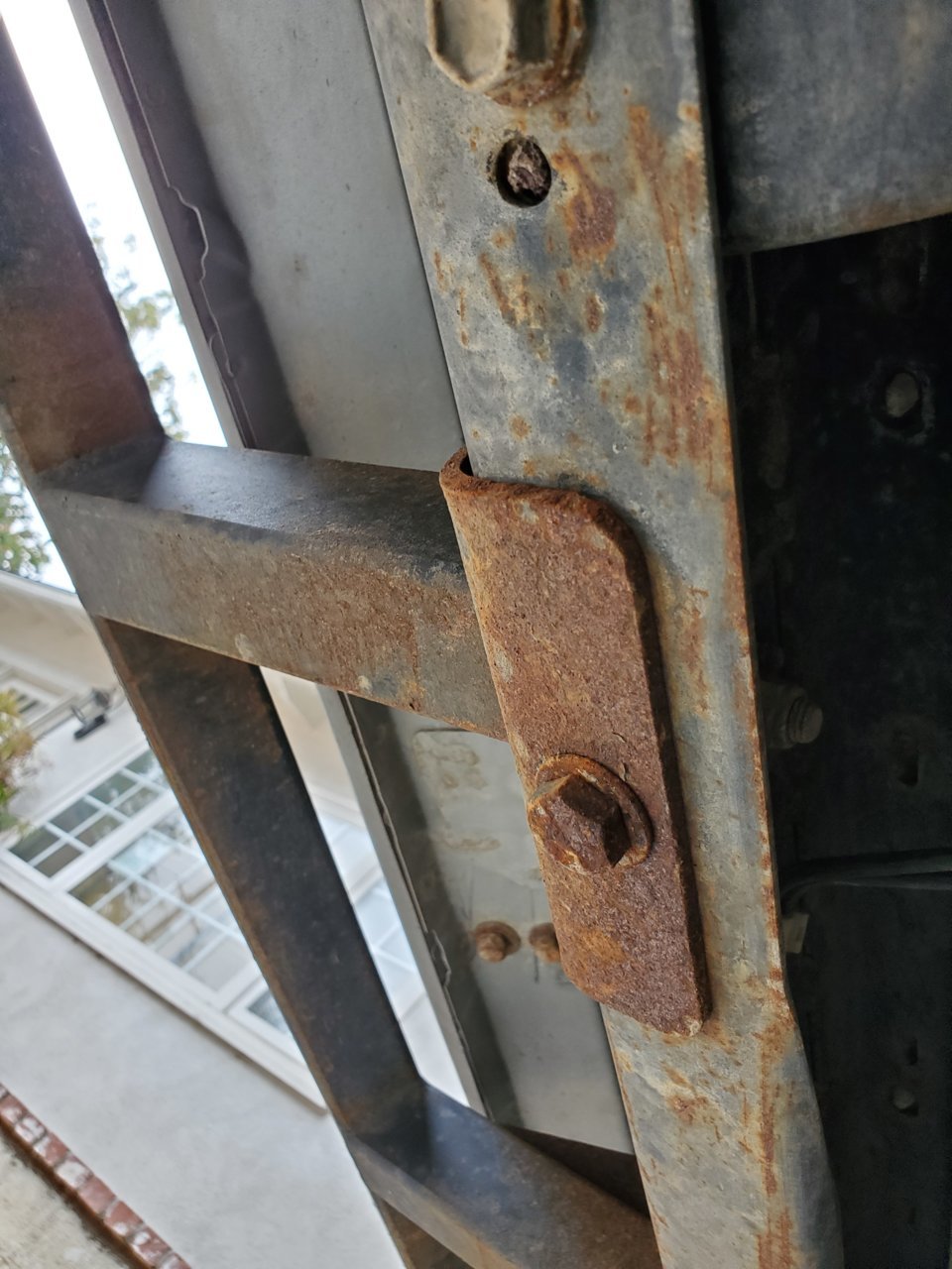

    Did a little exploring on the truck.
    No I didn't drive anywhere, just looked.
    Rust
    The rear axle and leaf springs are covered in the nasty stuff.
    Time for intervention.
    I ordered a wire wheel , rust converter and undercoating.
    I'm cheap so I went with rustoleum spray stuff.
    Pics to follow.

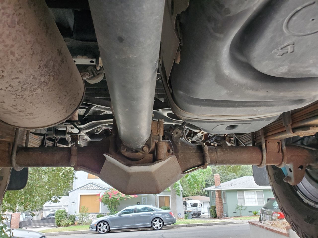

    Well that looks ok
    Damn
    Crom and ETAV8R like this.
  9. Oct 24, 2020 at 12:38 PM
    #189
    ETAV8R
    ETAV8R Out DERP'n
    Feb 20, 2008
    #4832
    4,947
    MGM 09 AC 4WD V6 TRD-OR w/ Tradesman Shell
    Just the basics
    Wow!
    I was worried about mine but not after seeing your pics. I'm not quite there yet. Life goals.
    Crom likes this.
  10. Oct 24, 2020 at 12:42 PM
    #190
    CVYota
    CVYota [OP] Damaged Goods
    Sep 13, 2009
    #22686
    9,332
    Andy
    Crescenta Valley
    2011 DCLB V6 4WD

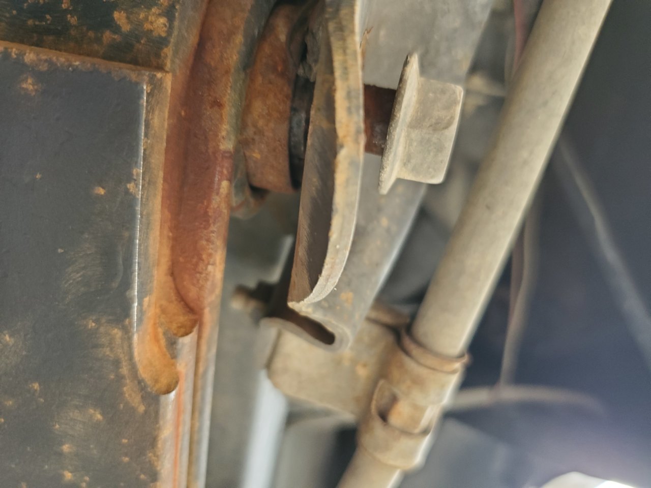

    Yeah its bad. Took off the top layer of rust and sprayed a converter on it. Then I found out why the springs have been so noisy.
    Crom likes this.

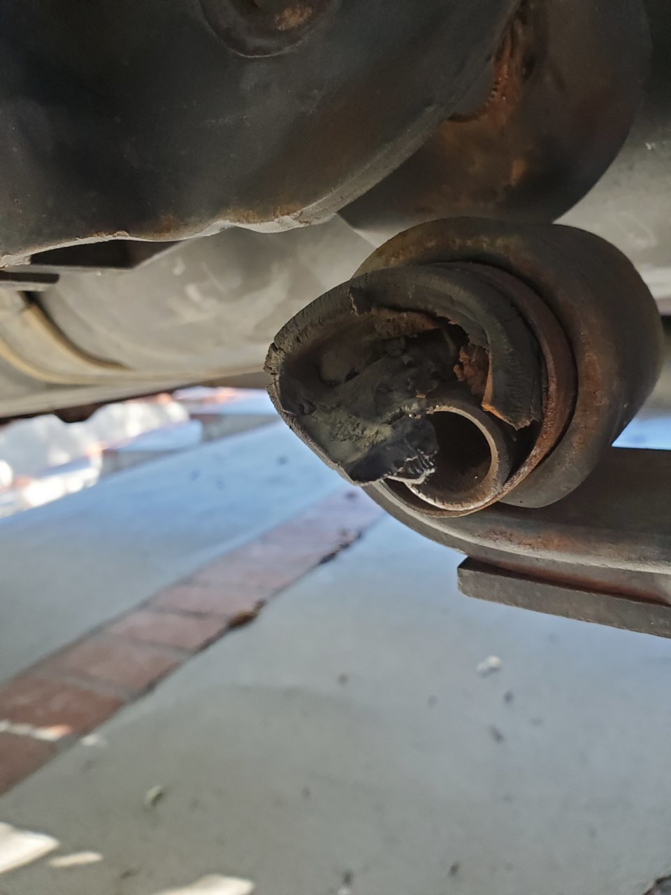

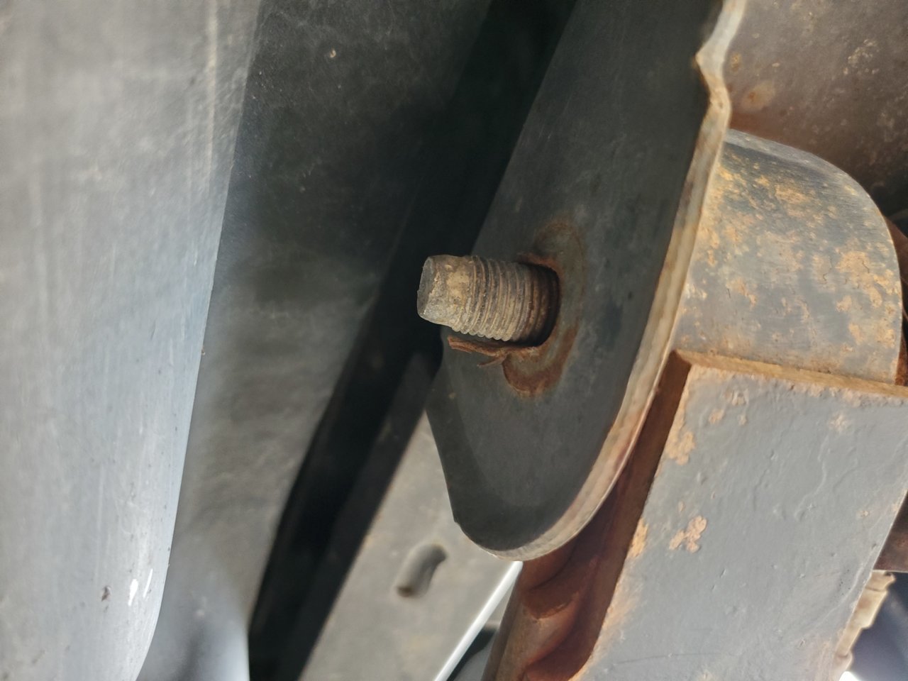

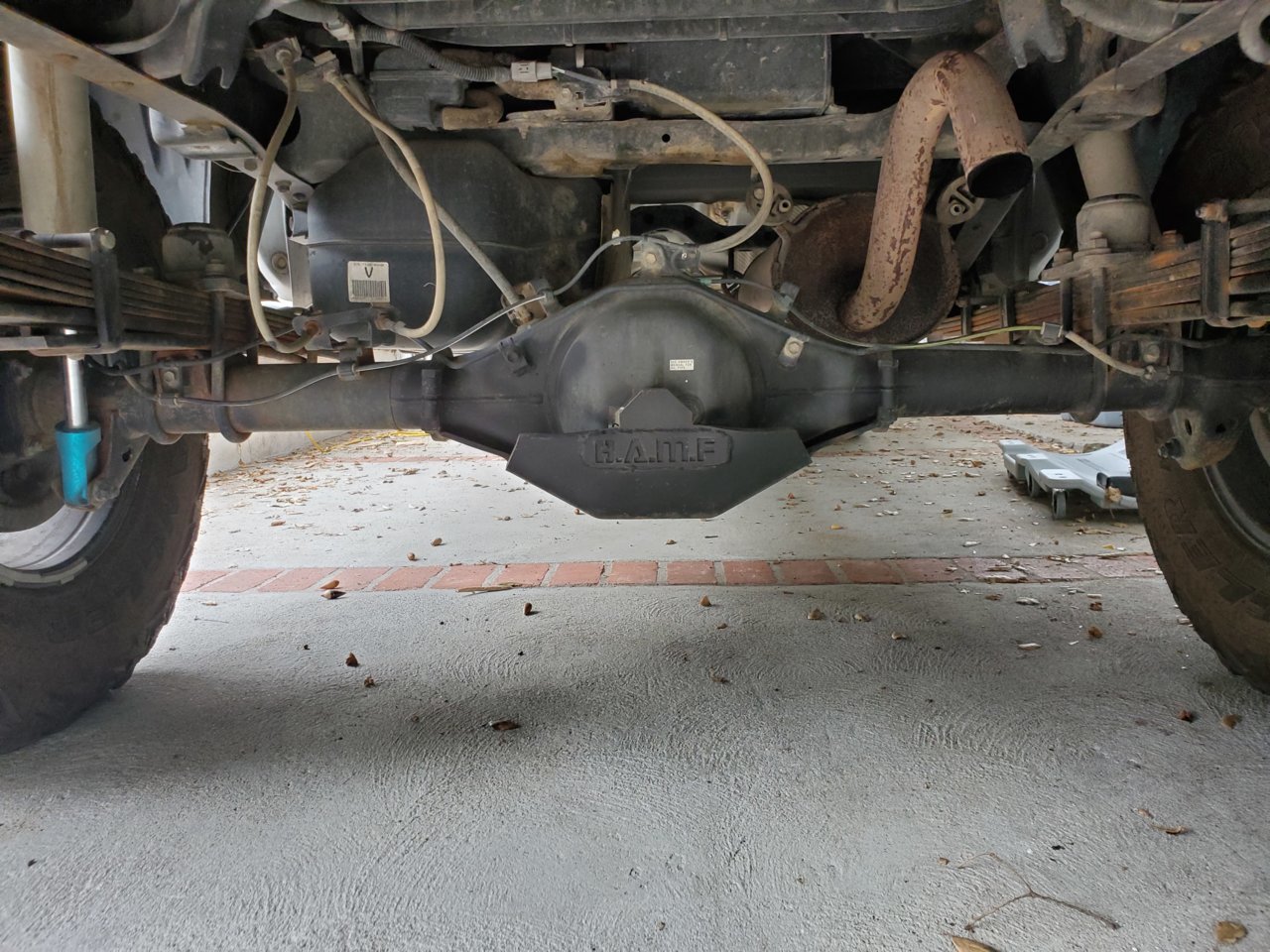

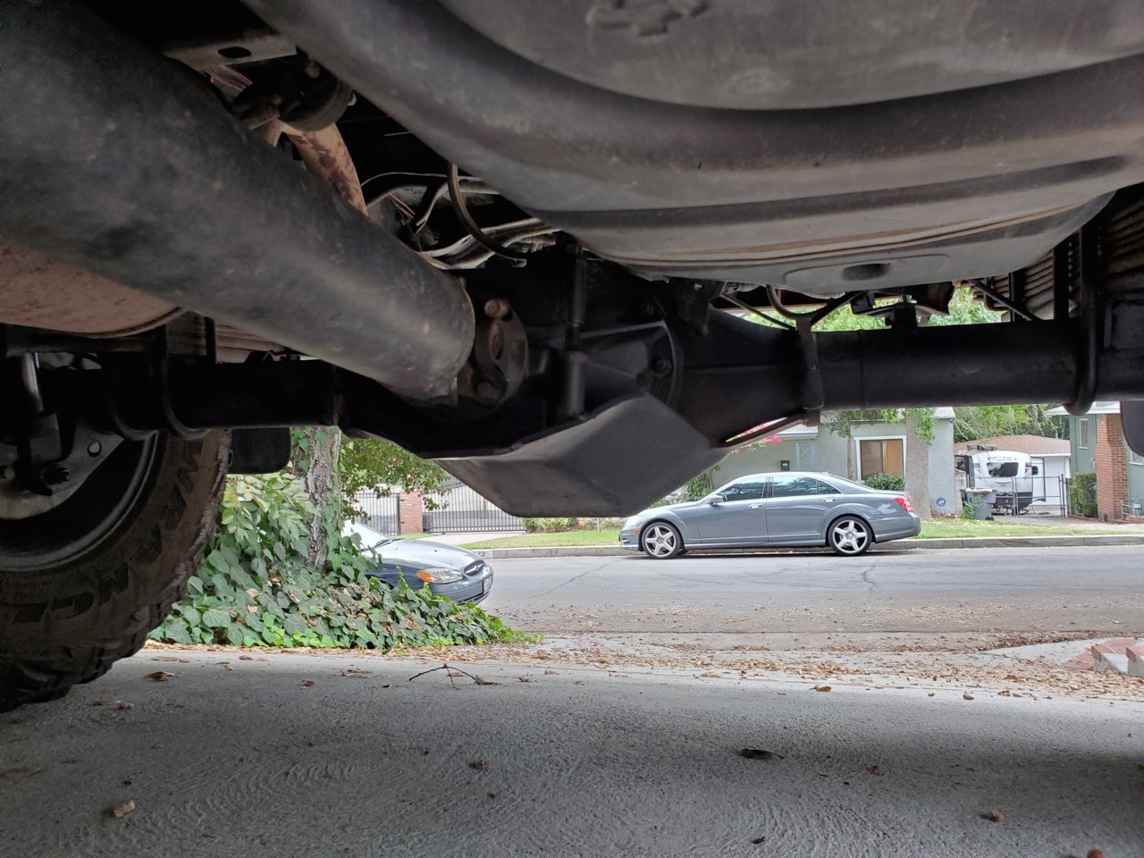

    Ordered new bushings and threw a castle nut on the springs (only one that fit). Put a coat of undercoating on. Still some spot work to do.
    Crom and Soul Surfer like this.

    2011 DCLB V6 4WD
    I think I found the source of the noise
    Crom, Soul Surfer and ETAV8R like this.

    I don't ever want to do that again.
    2 days of pain.
    But the squeak is gone.

    I have a couple nylocks that’ll fit your 19mm bolt on the leaf spring. Come n get ‘em.

    Its all put together. Got a bag of bushings from ARB. And all needed hardware, locktight and torque specs.
    I was worried that something horrible could have happened off roading, but after the wrestling match I just had, I know it won't just pop out.

    2 days to relace leaf pack bushings?

    When you spend half your time trying to take shortcuts and the other half realizing you can't.
    The dakar pack was twisted because of the bushing, lots of rust to mitigate and 2 trips to the hardware store.
    And I don't move fast.
