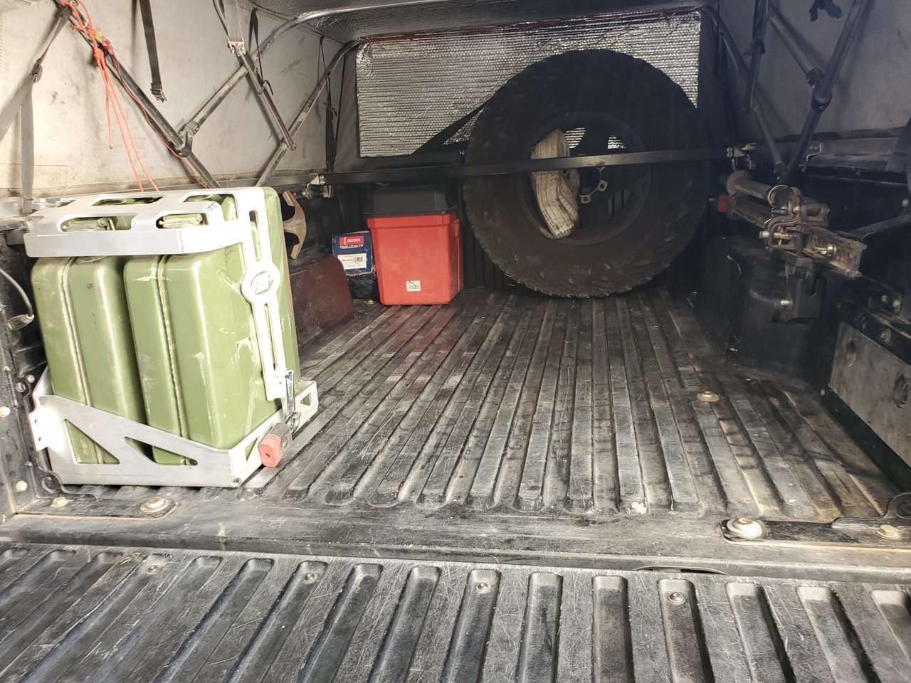

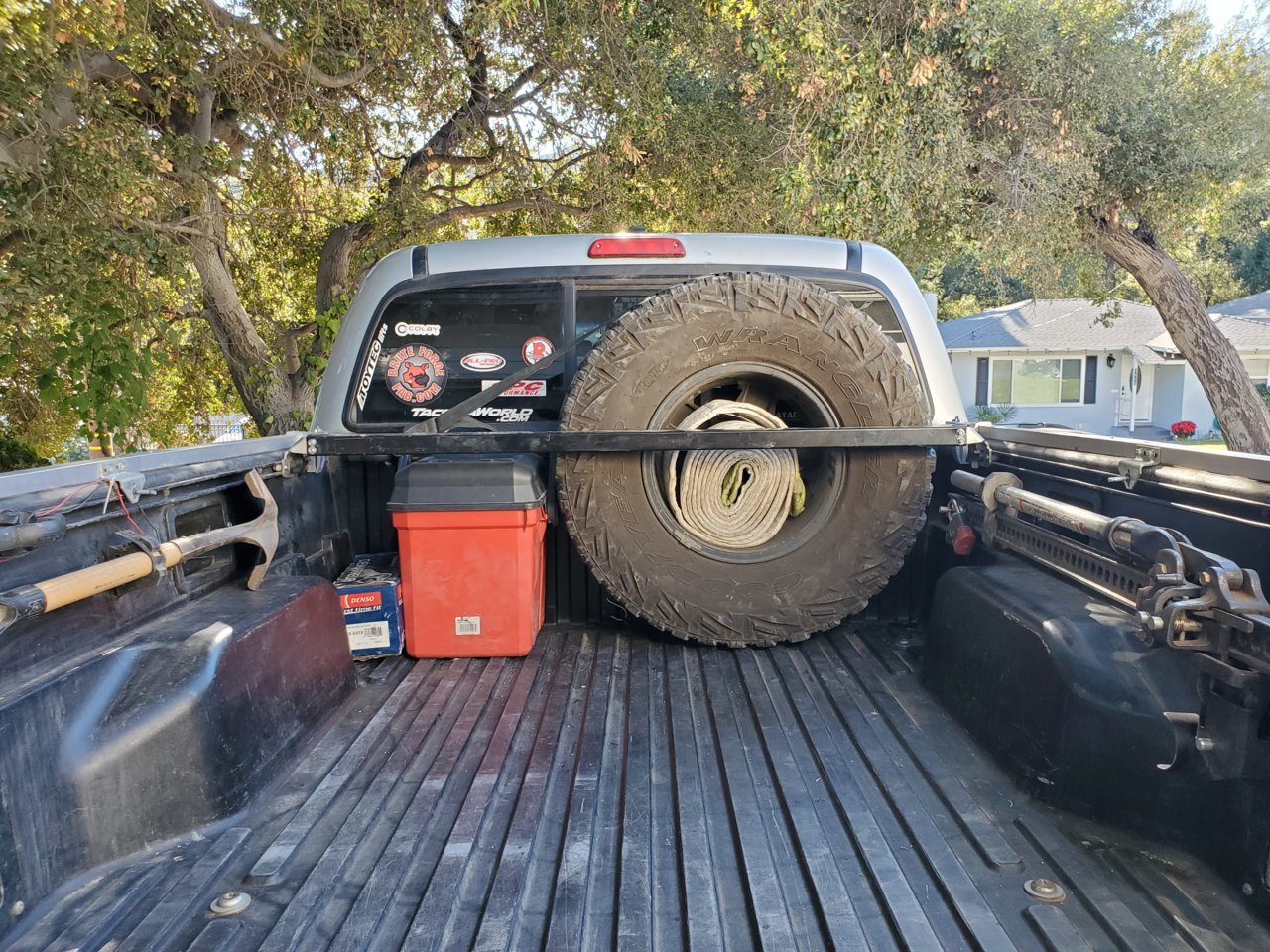

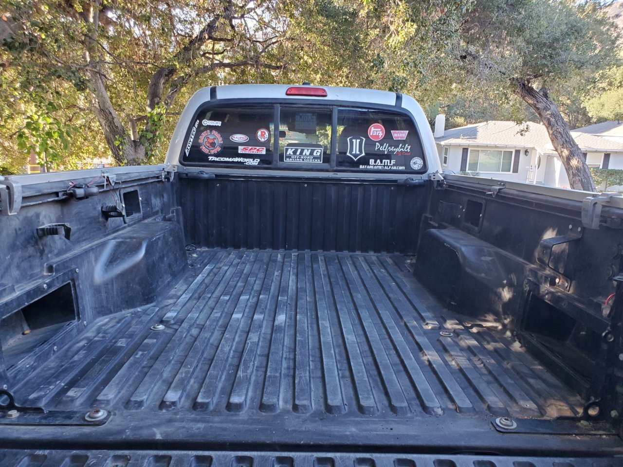

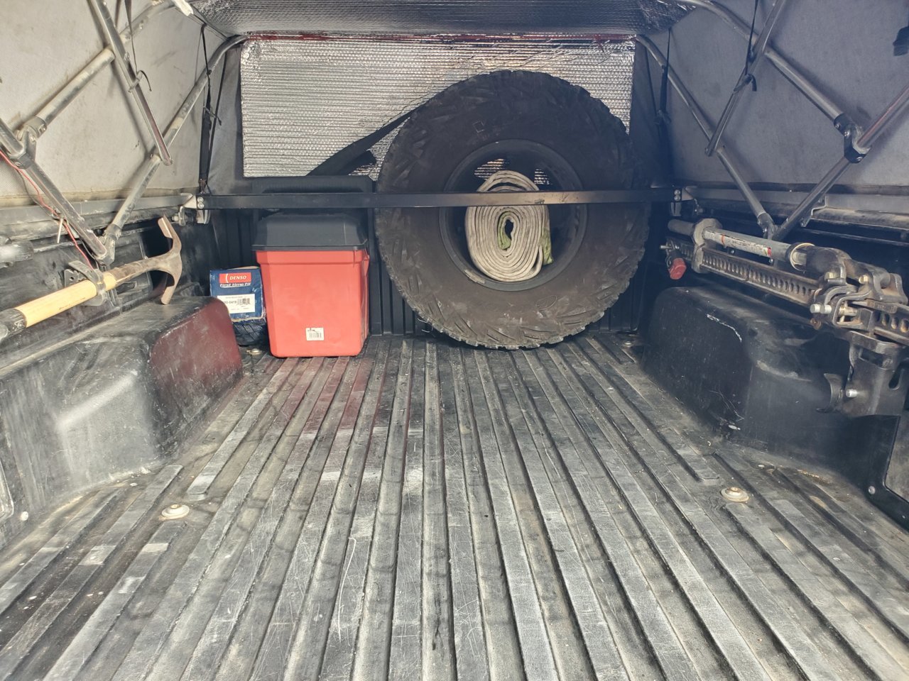

    Now to re design
    I got a double Jerry can holder and used a different utility box, in a different place. Took out the water tank, haven't used it yet. Might reinstall it later.
    And then I ran out of steam, I will install the Jerry can holder later.
    The plan is to take a week long trek to Colorado. So I got this to hold 10 gallons

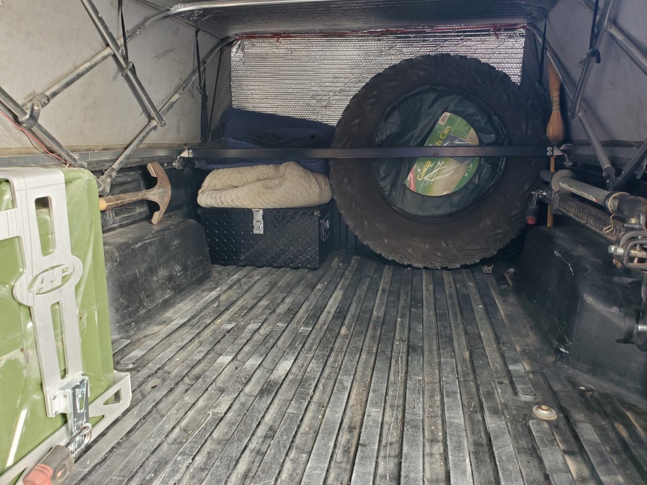

    It's the same stuff you used, it covers the top and front, just for a little insulation.
    Installed the double Jerry cans, 10 gallons now, I feel a little better about the longer treks.
    And I found a utility box that fits next to the tire, I will have that next week.

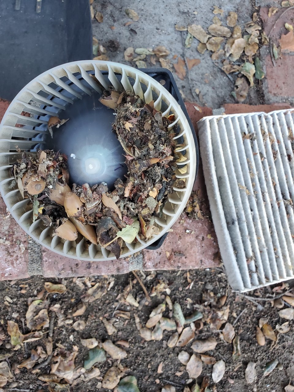

    So for the last year the blower fan has been failing, last month it wouldn't start without banging on the bottom a few times, normally only took once.
    Bought a new one and found out why the old one was doing so bad.

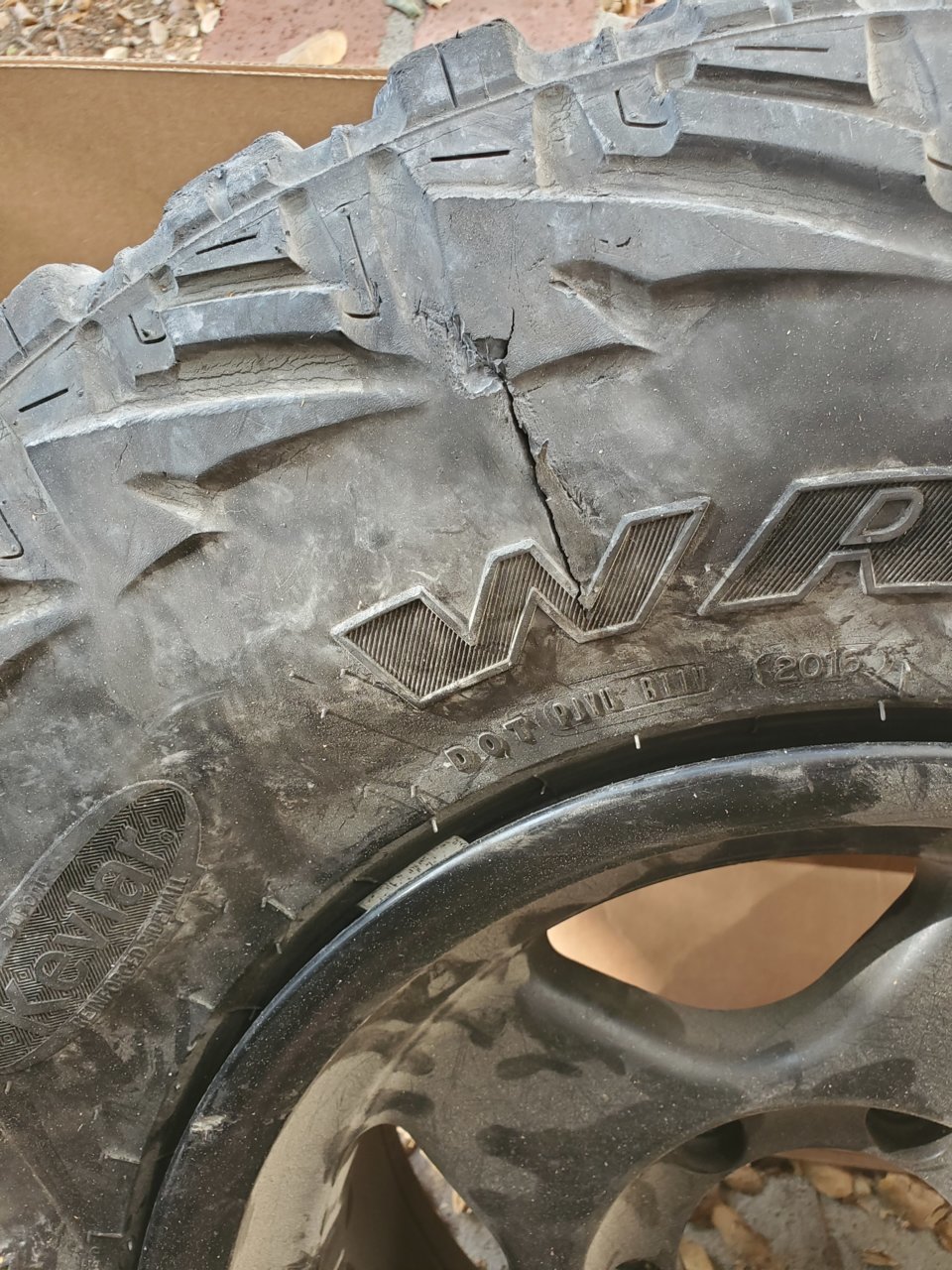

    So I did this last trip
    Apparently it's a bad time to get new tires right now, worldwide backorder.
    Decided to replace all 5 tires, I also need a matching wheel, SCS F5 16" 4.5 bs 0 offset.
    Also on backorder.
    So after 2.5 months I went online and found 2 tires. One on a jeep website and one at a dealer in PA that was willing to ship.

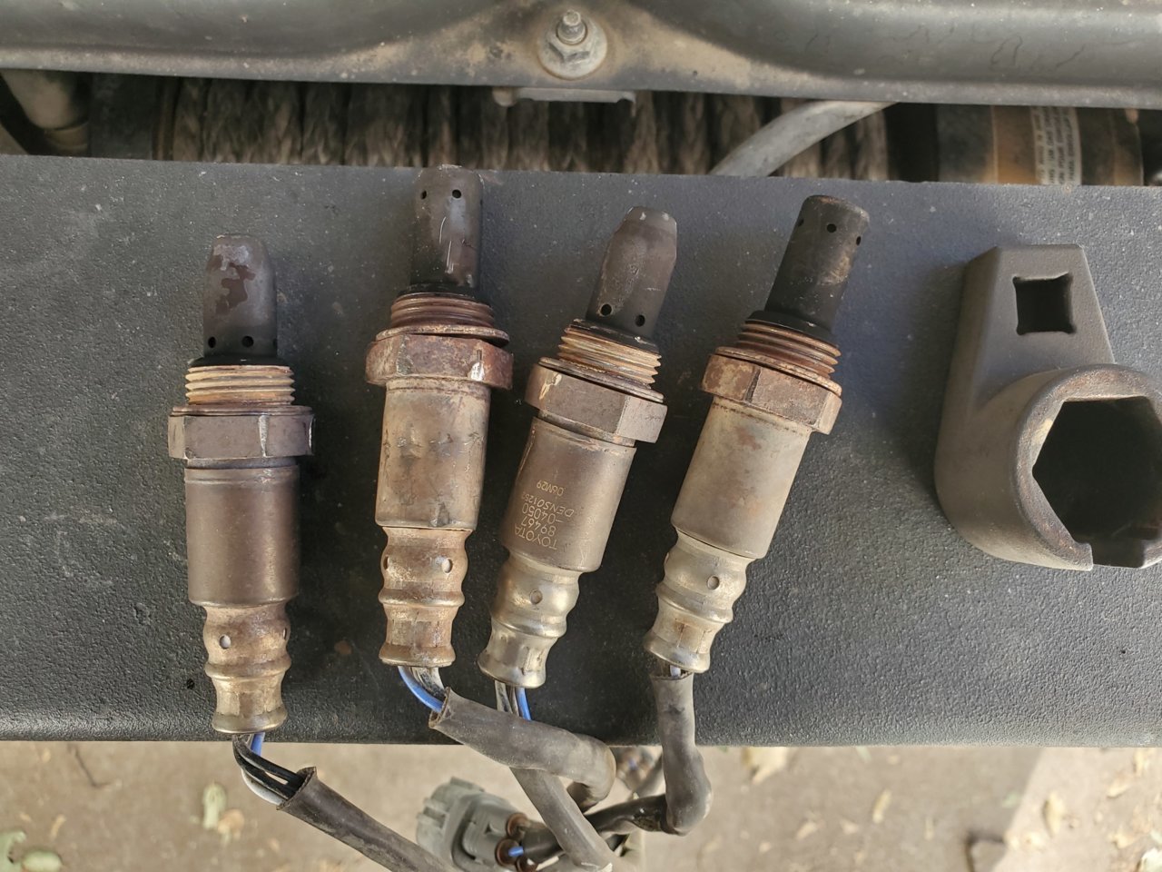

    Crescenta Valley
    2011 DCLB V6 4WD
    I was watching a car repair video today (rainman ray, the guy is good) and he replaced a bad o2 sensor on a Toyota. I though, gee, I have never done that and my mileage has gotten worse over the years.
    I looked up how often they should be replaced, it says at least every 90k.
    I'm at 180k.
    Got 4 on order.

  20. Feb 27, 2022 at 4:47 PM
    #220
    CVYota
    CVYota [OP] Damaged Goods
    Sep 13, 2009
    #22686
    9,332
    Andy
    Crescenta Valley
    2011 DCLB V6 4WD
    O2 sensors are done. The special socket and a breaker bar were helpful.
    Hardest part is unplugging them. The secret seems to be unplugging first, they won't come out if the wires get twisted.
