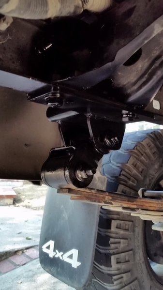

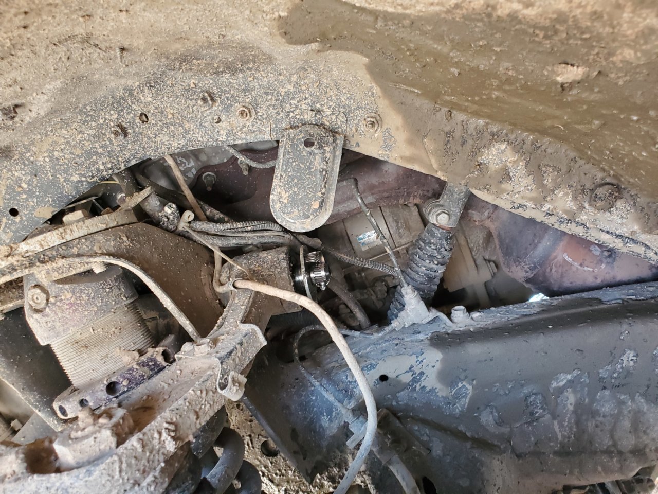

    Just got back from an extended DV trip.
    3 issues to address.

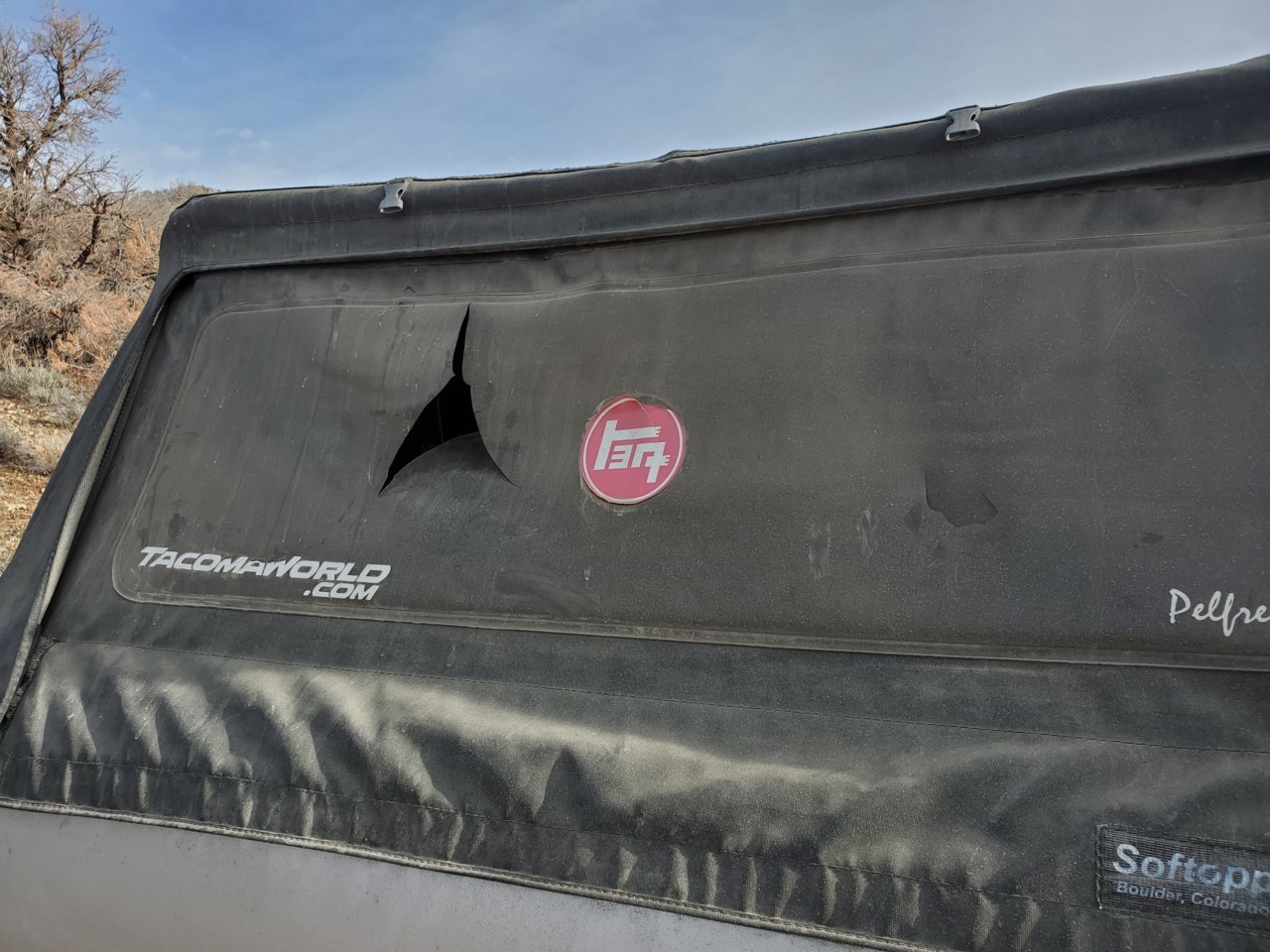

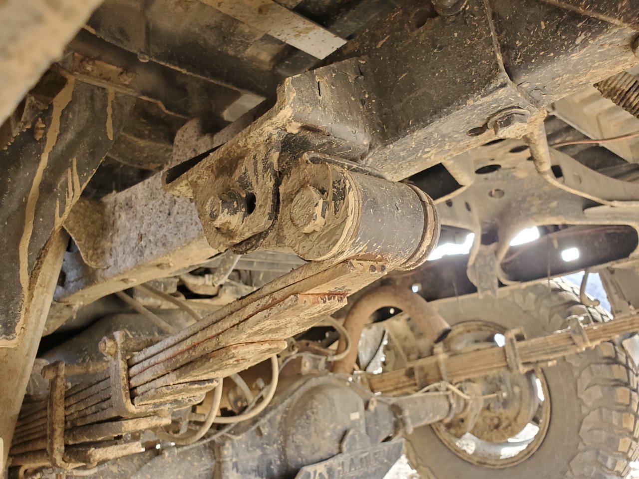

    Front suspension, rear suspension and back softopper flap
    Still not sure what I am going to do by myself.
    We will see

    Front suspension it appears you lost the control arm nut can you just replace or install a whole new bolt and nut?
    Rear suspension what kind of shackle hanger is that it looks like it’s welded on?
    I’d think you could just order a new softopper rear window

    Did replace the nut, a totaled 4runner was in a parking lot and they let me take the nut off of it. But there is lots of work to do on the front.
    The back should be hanging but the leaves are 12 years old, so they are actually lifting the shackles up.
    And yes, I already ordered the back flap, unless you are offering to pay?

    I can’t see what all the front needs I’m still looking at the rear I get the leaf packs are flat are the Dakar heavy’s? I’m still trying to wrap my head around the shackle hangers. At this point I guess the simplest approach is just replace the leaf packs. If the hangers weren’t welded I’d suggest to consider a set of the Archive hangers

    All the bushings in the uca and lcas need replacement.
    Yes drakars but these are good hangers. Probably will also get the kings rebuilt. Been about 160k

    New
    Worn springs

    Now that I look at the pic I can move the shackles back another slot. That would have helped

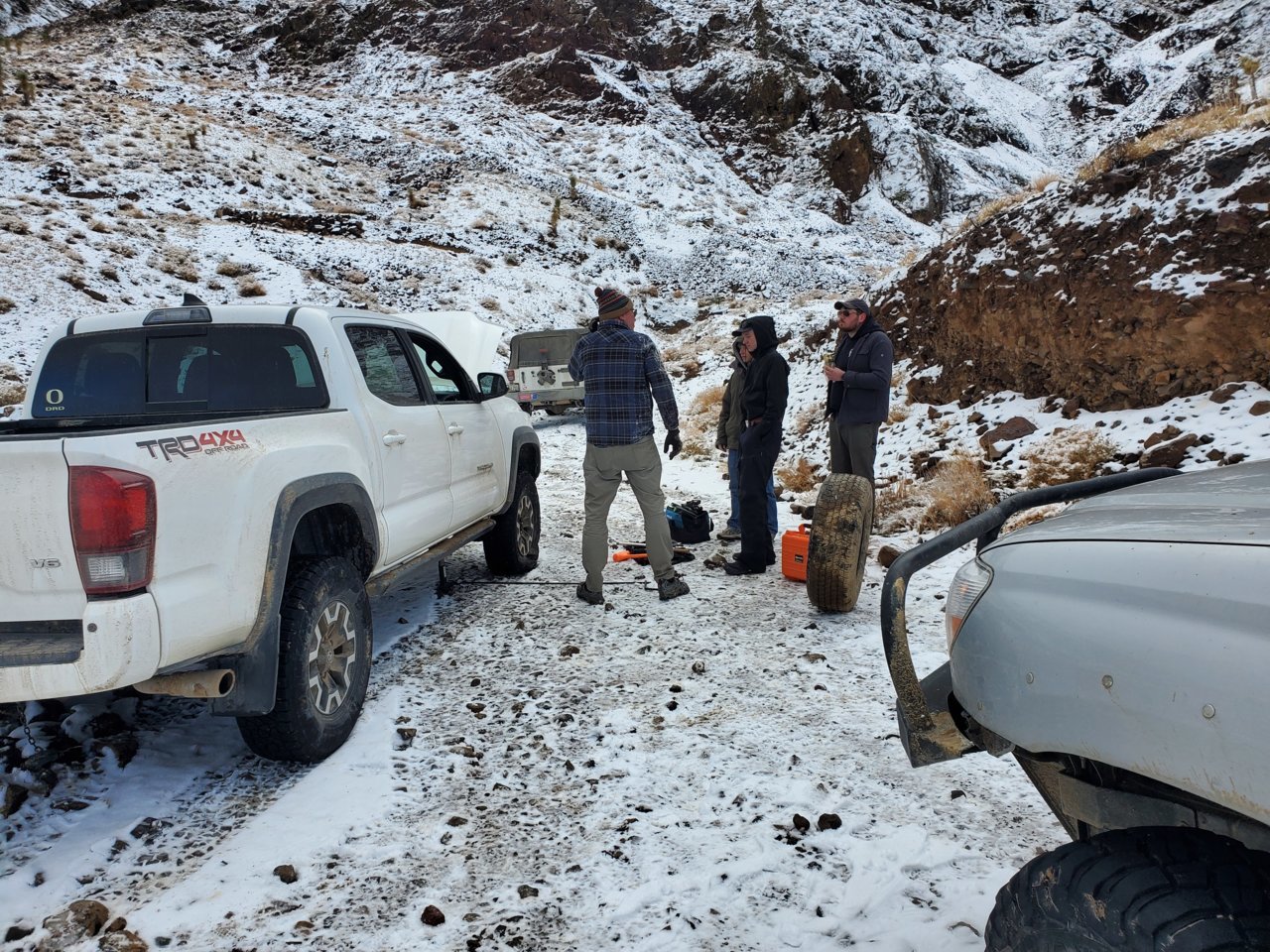

    I lost a nut on my UCA so I skipped the run to Defense mine, I have done it twice in the last few months. Stayed in a glamping tent in Panamint Springs, to avoid the rain and tried to go up hunter mountain, lead jeep had bad tires so we turned back. Went up to Santa Rosa mine and the stock Tacoma with ATs lost 2 tires In the snow covered rocks.

  20. Feb 25, 2023 at 1:23 PM
    #240
    GHOST SHIP
    GHOST SHIP hates you.
    Mar 9, 2015
    #150537
    22,402
    GHOST
    Meant to ask, what shackle flip is that? I know I’ve seen it before.
