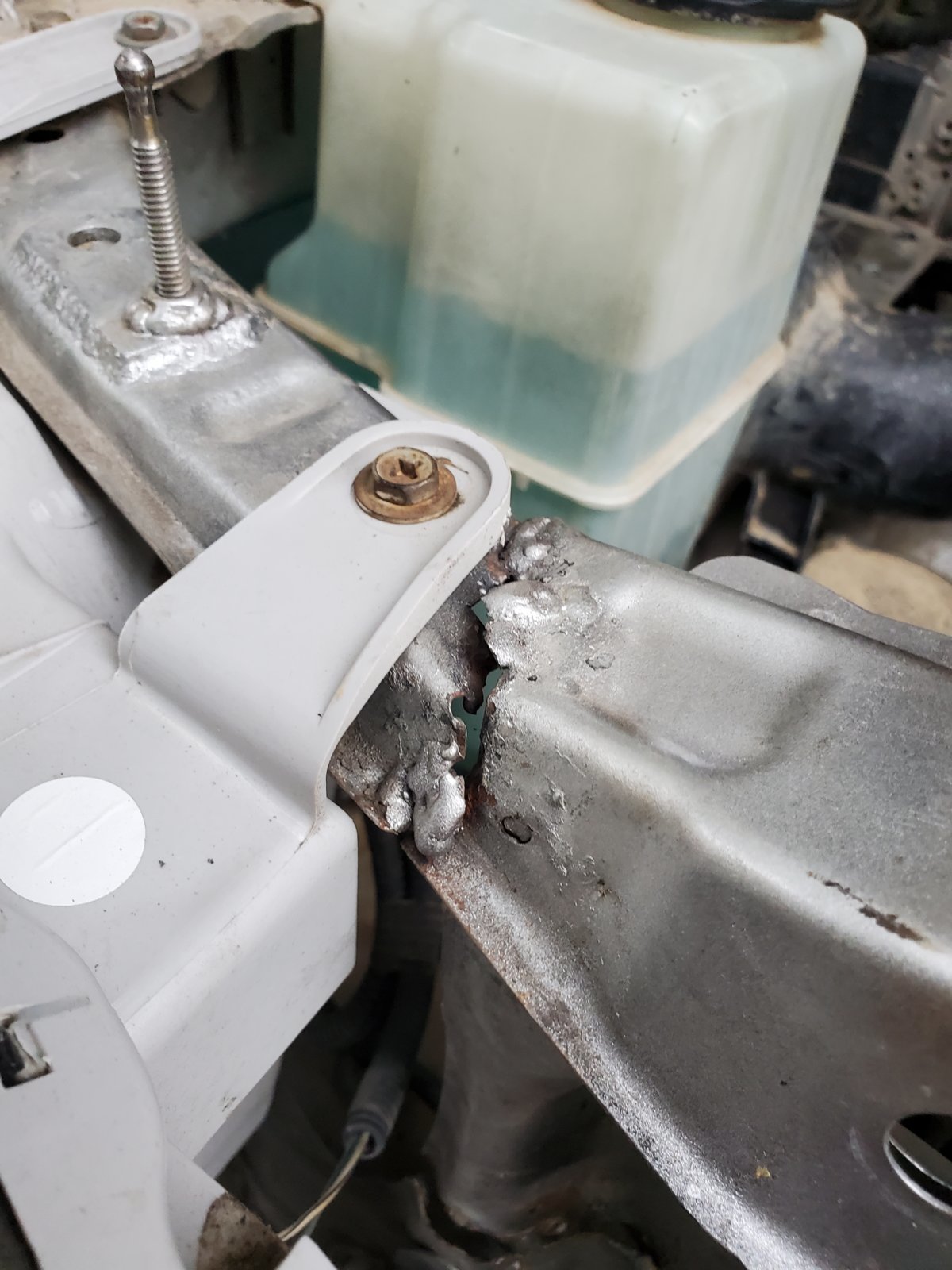

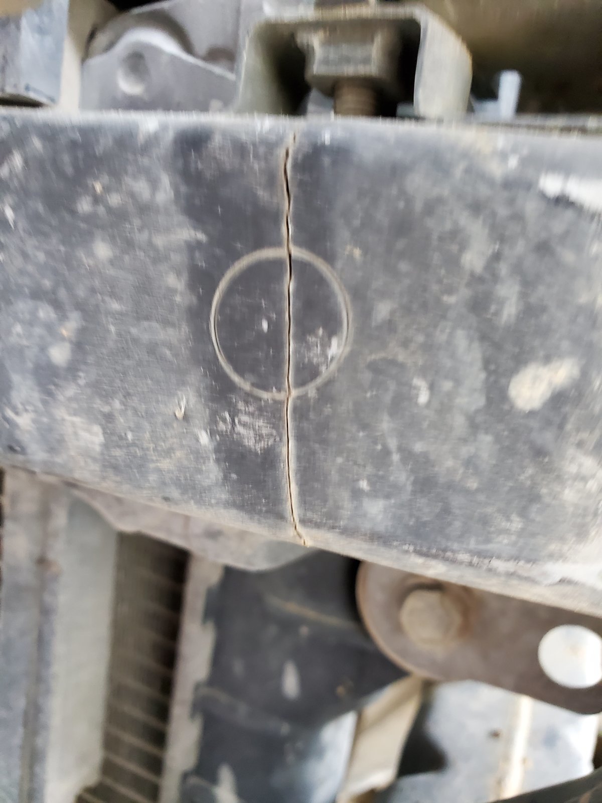

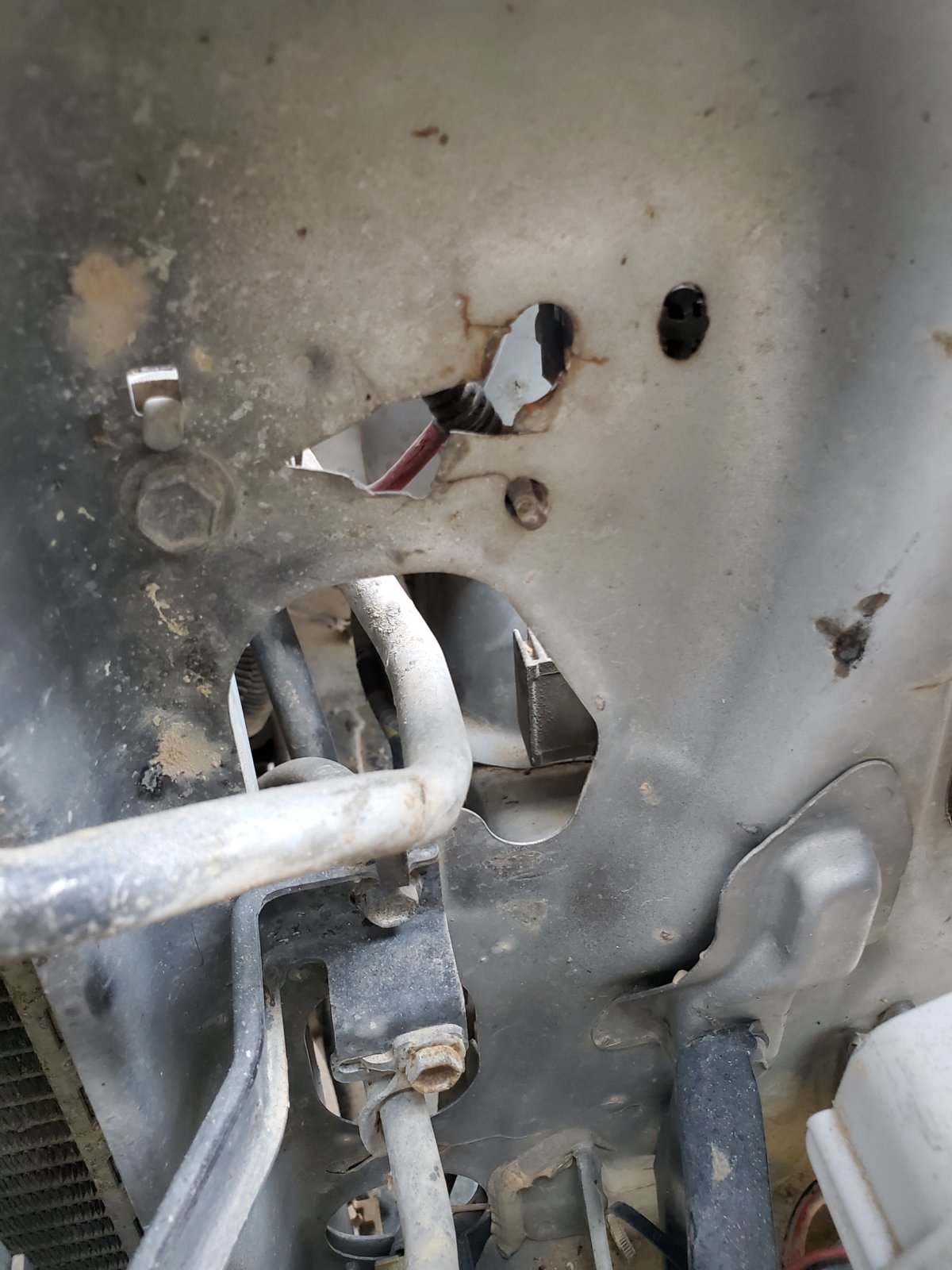

    What I ended up with was a combo of a few ideas and some of my own. I was going to splint the break with 2 thin bars but the screws would cause more tears.
    I ended up using one bar under the core, one bolt and wrapping the core around the bar.
    Still flexible but holds it in place.
    The bar is bent, to match the core
    Just needs to be road worthy

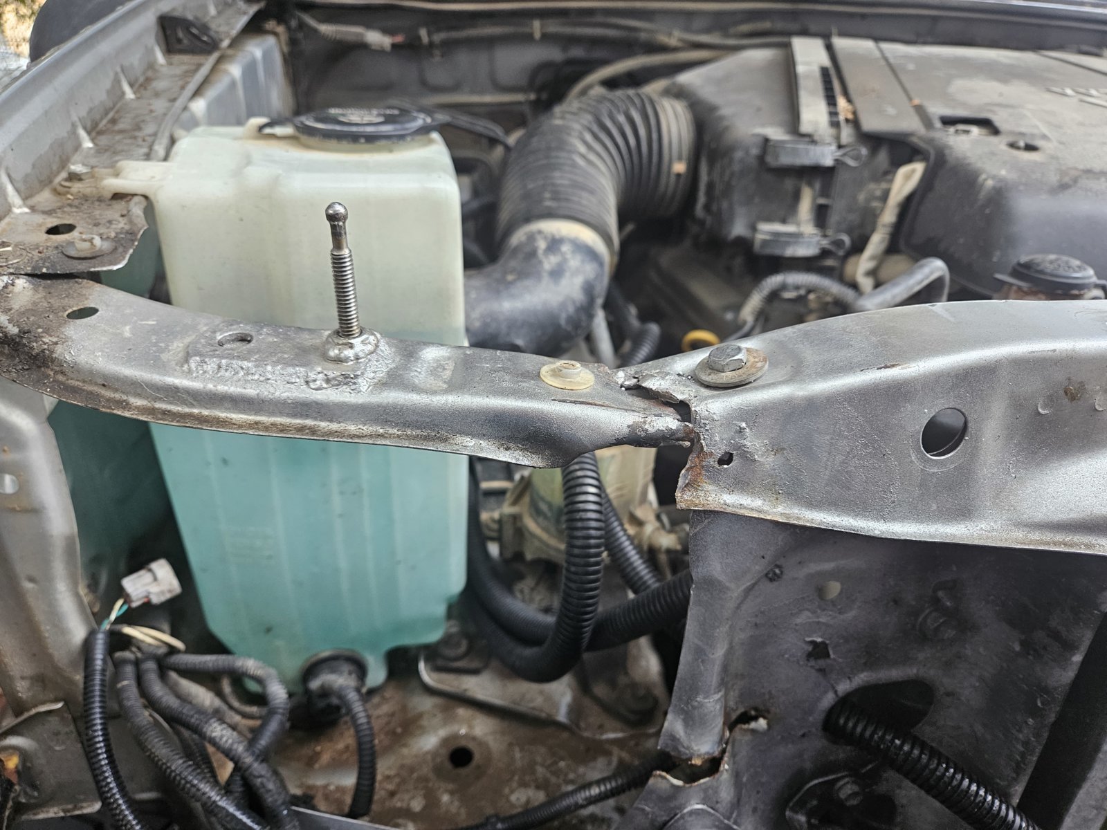

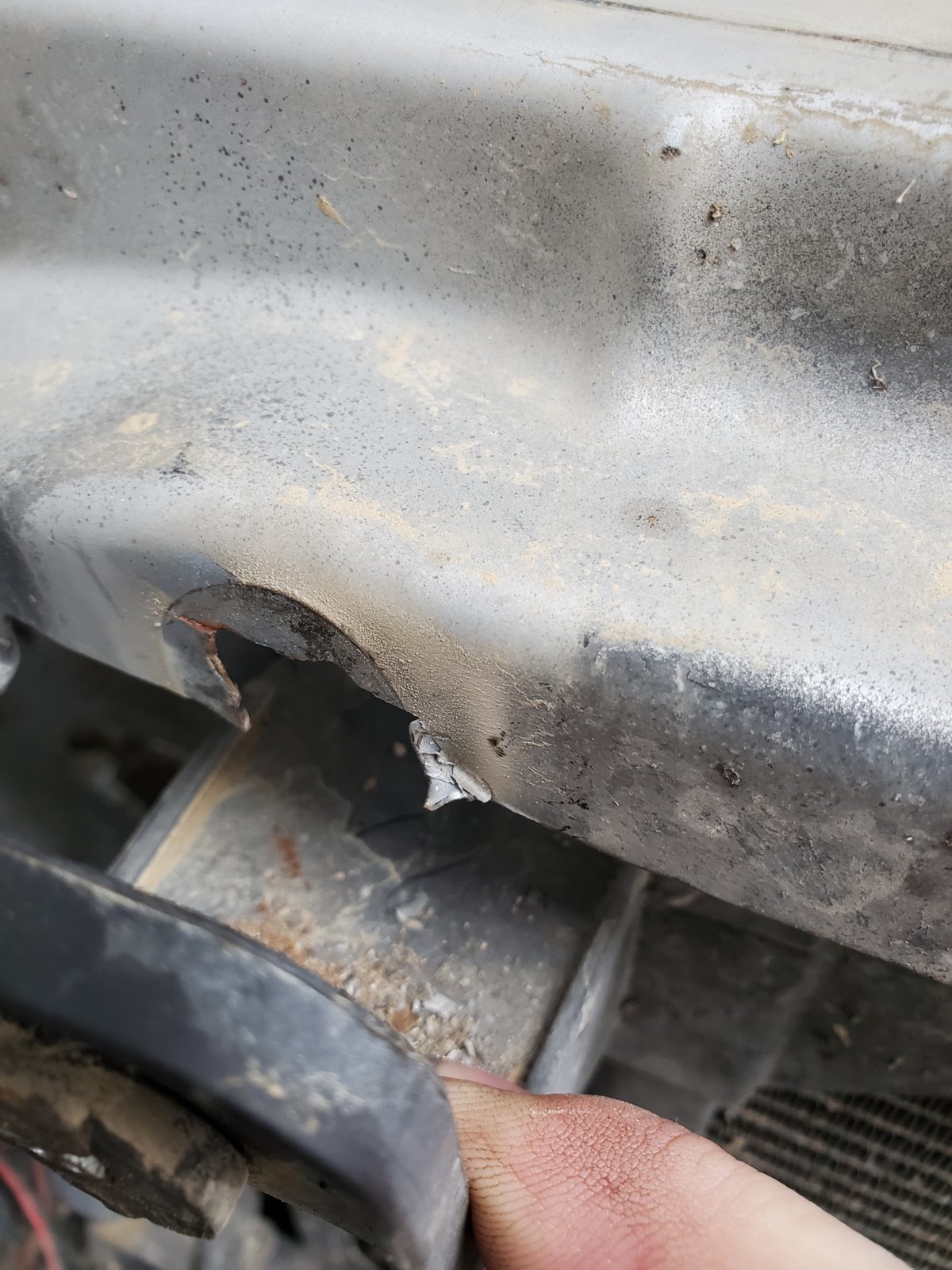

    @GHOST SHIP to the rescue!
    Just got the truck back and Sergio outdid himself on this one. He fabbed up a radiator core support and installed it this weekend. Hood latch works again and it seems to handle better. Can't wait to beat the shit out of offroad.

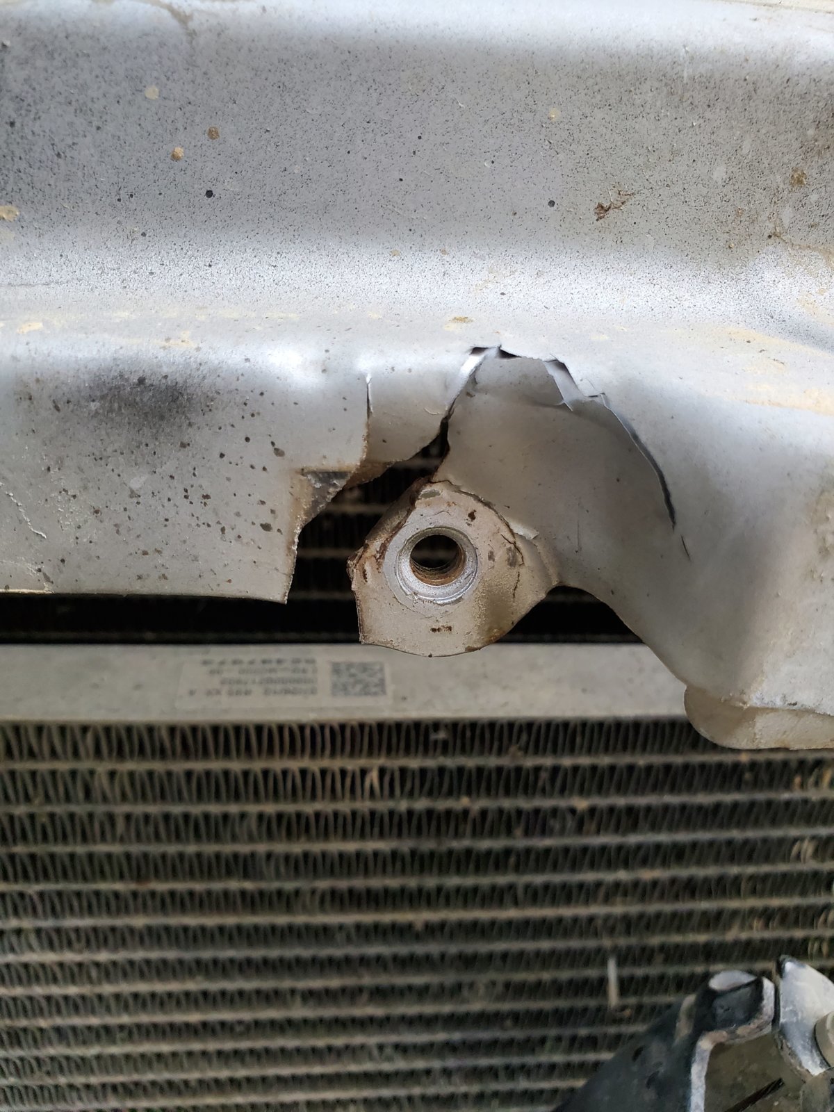

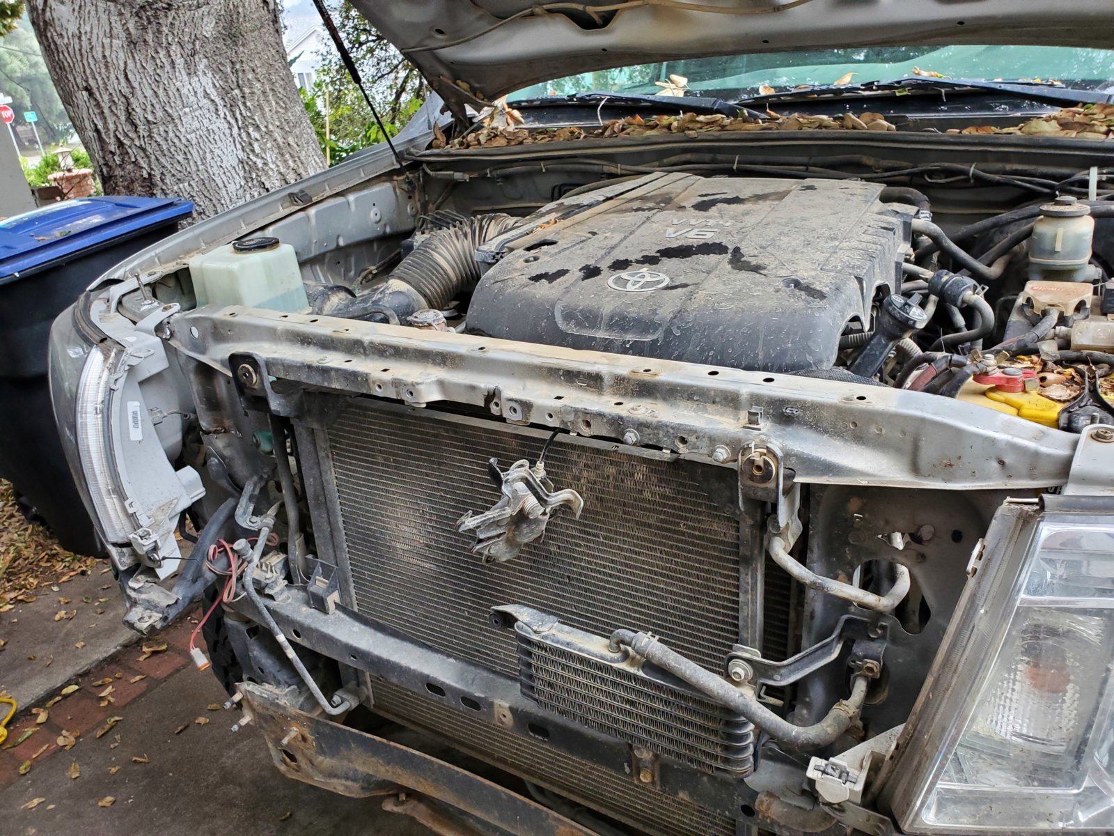

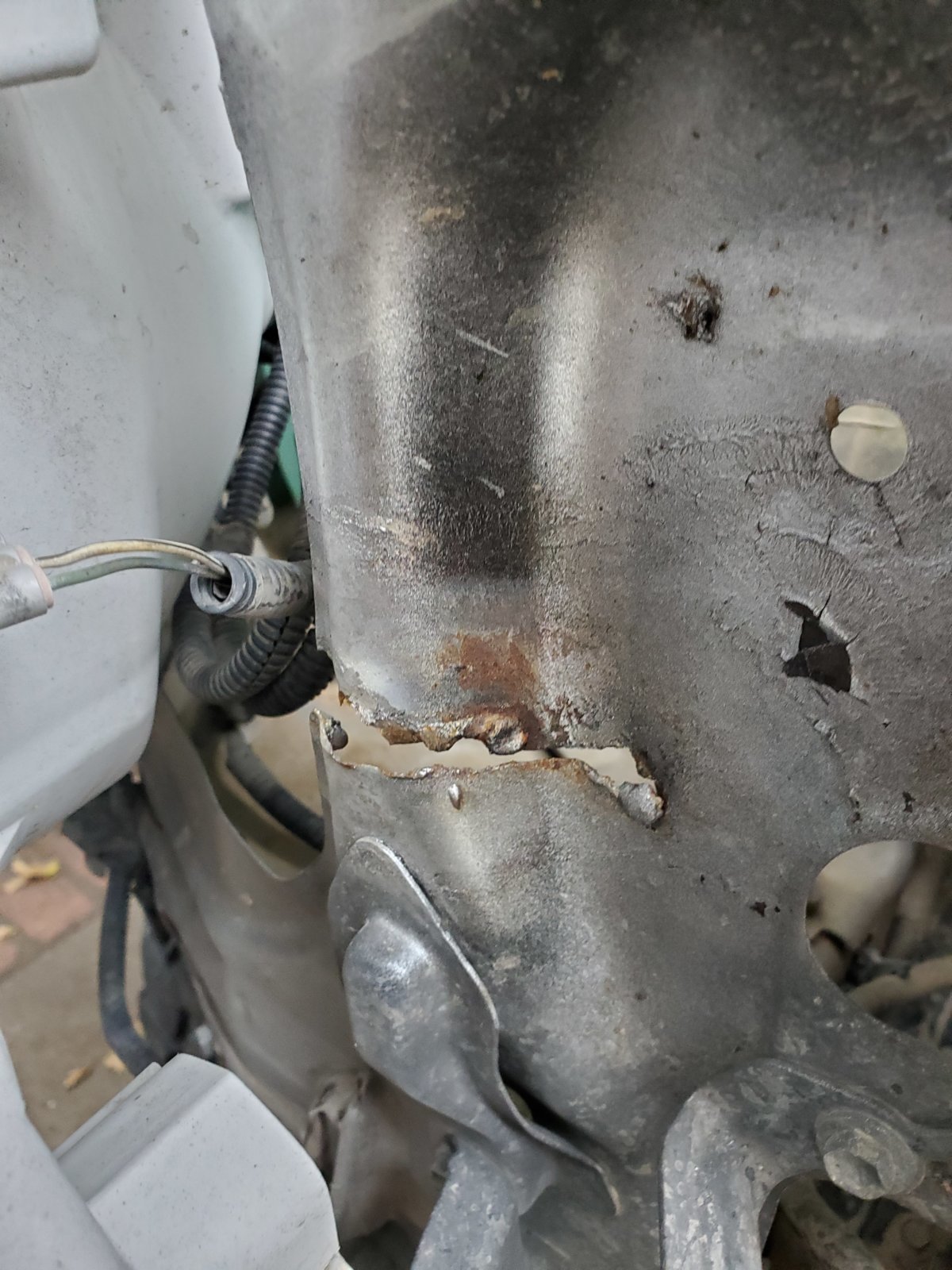

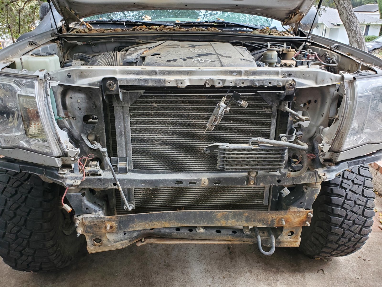

    These are the only pictures I took when I had everything apart. The front end of your truck was held together with nothing but hopes and dreams.
    IMG_9184.jpg IMG_9185.jpg IMG_9186.jpg IMG_9192.jpg IMG_9189.jpg IMG_9193.jpg
    I wish i would’ve gotten shot once I cut everything out of there and again with the new support back in place before we started putting it back together. This project is definitely not for the faint of heart. Still, super happy with how it all turned out.

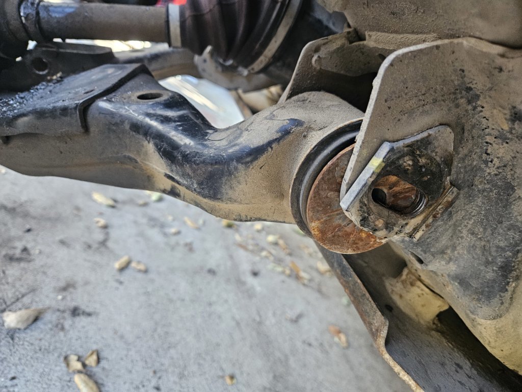

    Really did a number on the truck this time.
    Offloading in DV, heading to defense mine.
    Got up the ruff part but didn't see the last rock in the way, hit it hard, my head hit the steering wheel, gave myself a concussion.
    Lost power steering, no leaks, push one of the LCA arms back, shearing the tabs on the adj. Now I have found out the real bad stuff.
    Steering rack seems to be ok but the intermediary steering shaft is bent. However, I have deformed my shock tower. That is going to be the tough fix.
    This is the good side, with the spacer mod on top
    This is the damaged side
    Top cap is split on the Icon and all 3 bolts are sheared off

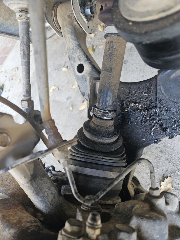

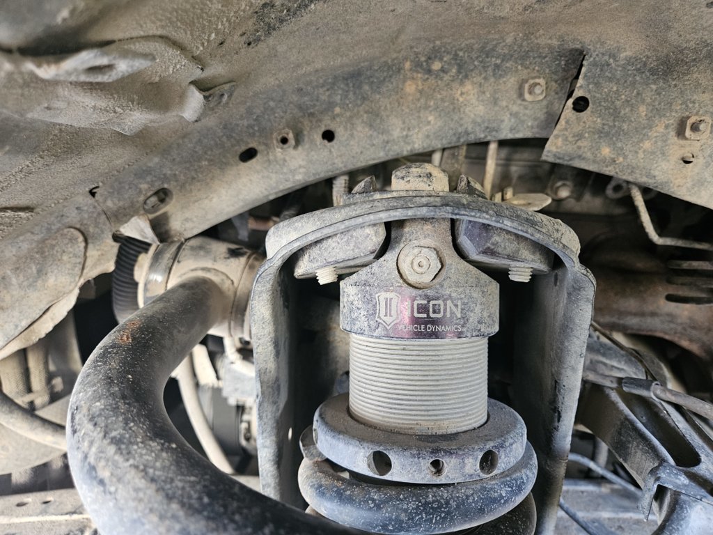

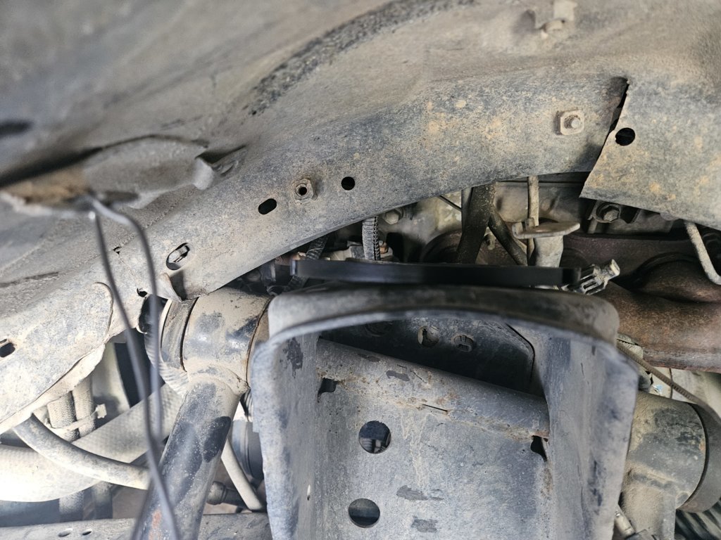

    On to teardown.
    Bolt holding the tophat on the shock, broke in half, top tower is definitely out of shape, you can see the flat spacer i put on top. Clip came off of the outer CV boot, grease everywhere, back tabs on the rear LCA adj bent back and I am replacing the intermediary steering shaft, hopefully that is the only issue there.

    Did a little too much yesterday, head is still not 100%.
    Took the skidplate off today and also found the DS tie rod boot, on the steering rack, is destroyed not sure if it is a replacement part or just replace the whole thing, time to look online.
    Anyway, enough for today. I will tackle the intermediary steering shaft tomorrow.

    $20 for the tie rod, I can afford that.

    Shock is complete, the spacers took a big hit and had threads, they aren't supposed to.
    Reamed them out and all is well. Looks like Icon sent a universal top hat, no notch for the Allen wrench and 6, tapped holes instead of just the 3

    Got the heim joins in and when I went to install the shock, I found the tophat is 1/2" too wide. I am in contact with ICON, we will see how this goes. It's always something when you don't have any idea what you are doing.
