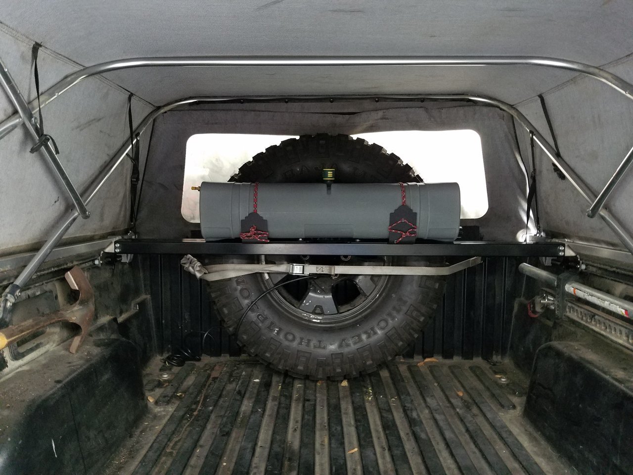

    Water tank mounted. Need to test the mount, should work
    Edit- worked great on a 5 day desert trip. Didn't move and didn't leak on a road that flipped my full, secured, Yeti over.

    Will you be able to access the water easily in the front of the bed? I'm sure that's much more secure than the bed rails though

    Yeah it will be accessed from the side, that's another good thing about the canvas top.
    It worked well out in the desert this last week, never moved or leaked.

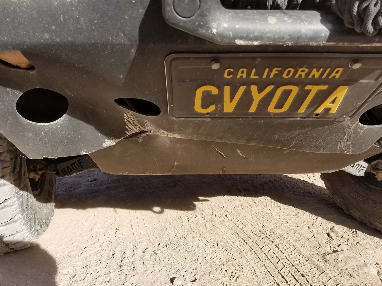

    So as you can see above, we made it out to the desert. It was a great 5 day trip along some new roads.
    My friends 1st gen tundra had some issues, his new exhaust mani, melted the shift cable housing and he got stuck in park. I used a BFH to move the linkage.
    Finally tried lippincott, turned out to be an easy road, I think they just went through and smoothed it out...check out my you tube page for the vids...cvyota
    So yes I hit a rock, if you look at the video it is the only rock around, I had little time to do anything, too sharp a turn and I would hit it broadside and maybe flip. I stomped the brakes at the end but the loose dirt was...too loose. Looking at the vid a hundred times I wondered why I didn't go off road before the rock, oh well I have a bit of work ahead of me as it looks like some of the mounts and frame horns are affected.
    Slow down

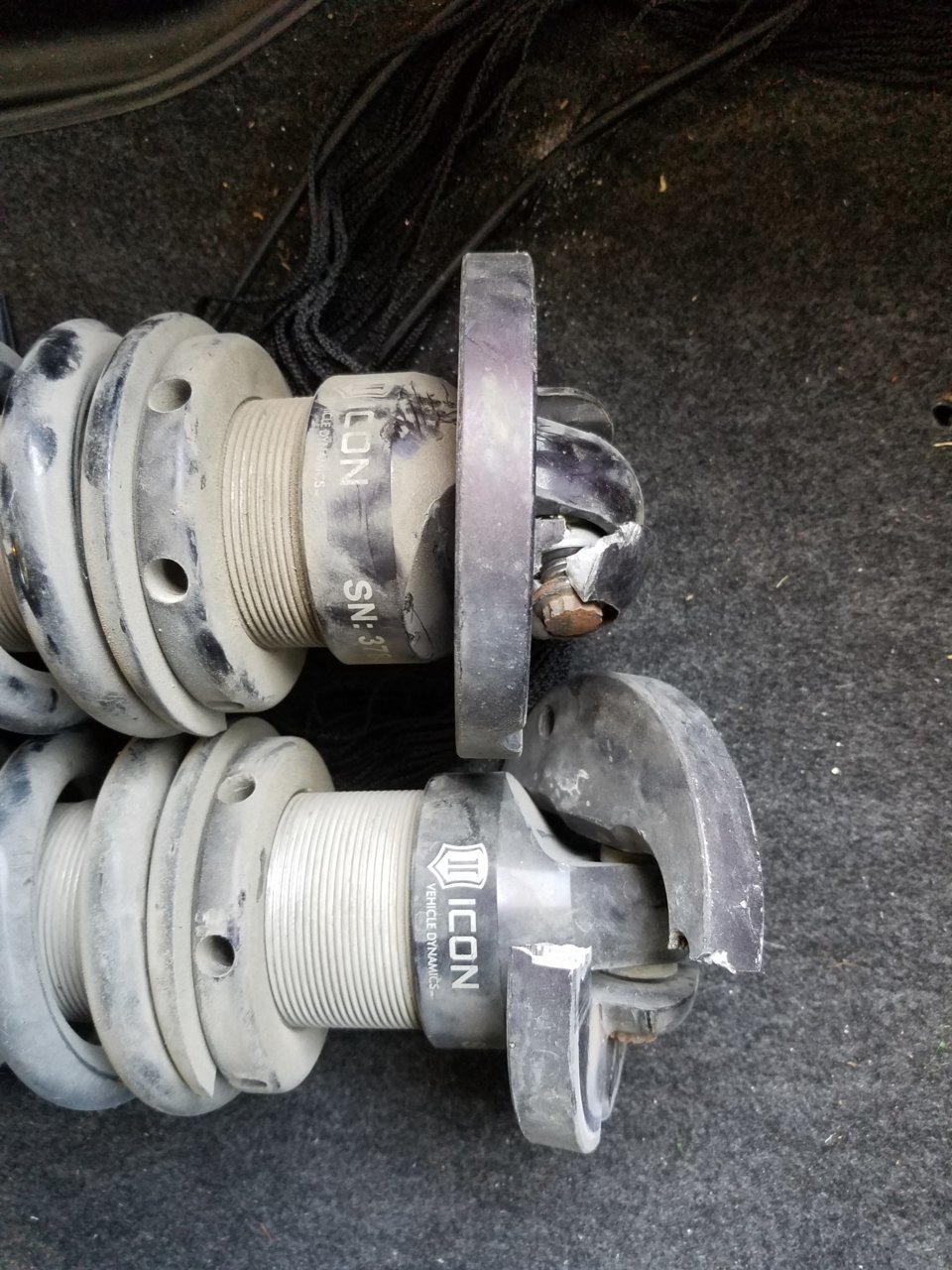

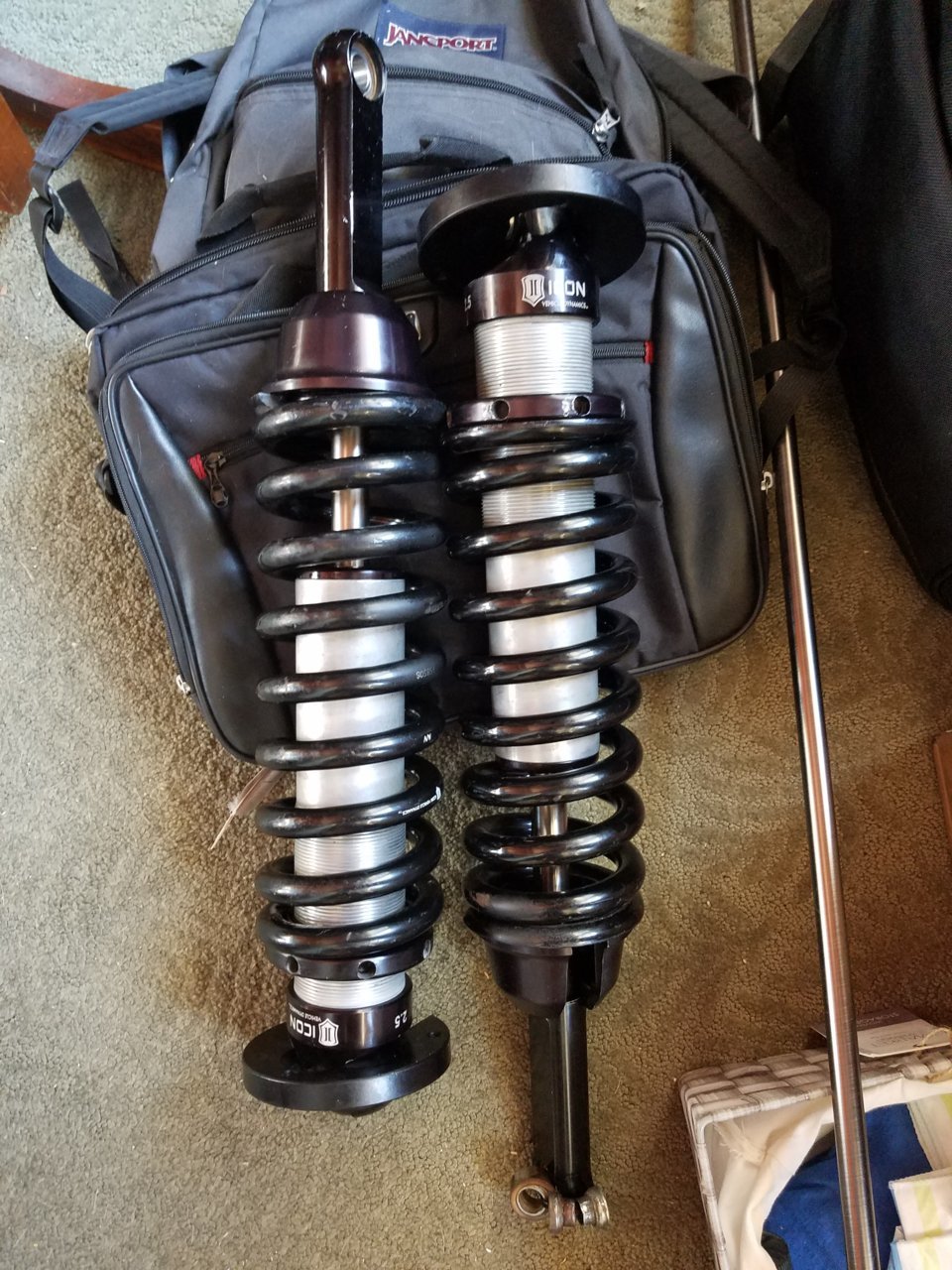

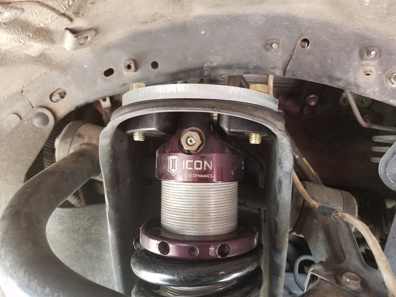

    Had the Icons rebuilt in the front after 80k, they have the breaks from the flex in the tower on the tacoma
    way too long, but they look brand new.
    This is the fix, a spacer on top to reduce flex
    Got to test them out in DV this last weekend. 200 miles on the dirt!

    I bet a lot of folks will like to know if that does fix the flex issue and stop the struts from breaking. Live the pic of the truck coming around the corner. Looks like a fun trip

    Another member had the fix, cant remember who. @Crom will know

    Yes it does. @HBMurphy was the first member to do this that I am aware of many years ago...

    The “Fix” I currently have is a waterjetted donut and 1/2” longer bolts on the top of the could bucket to virtually eliminate the flex of the coil bucket. Problem solved.

    The spacer seems to do well, time will tell

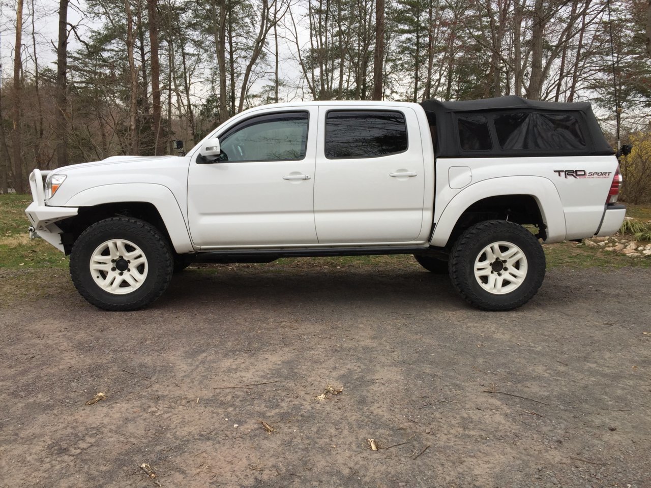

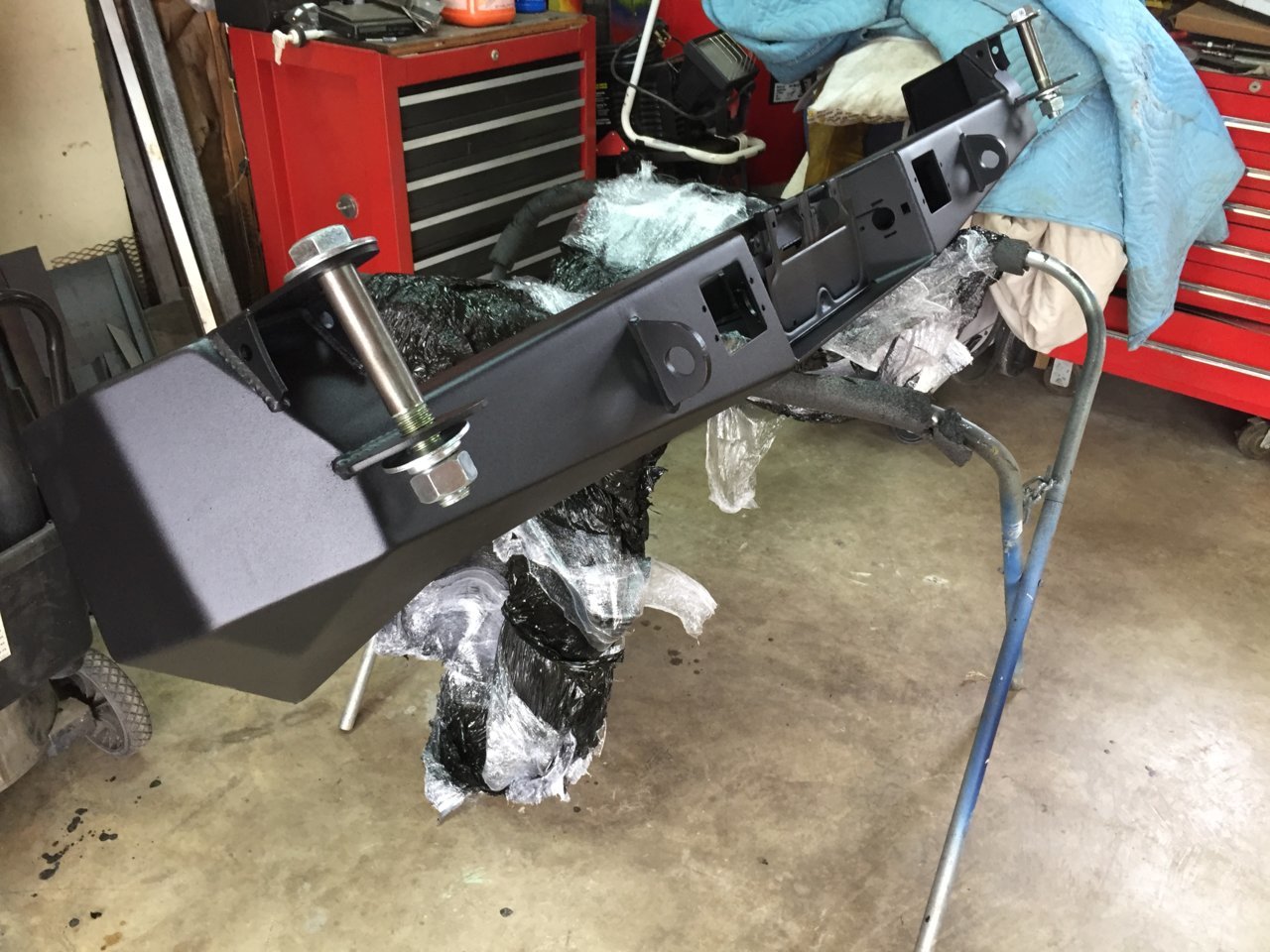

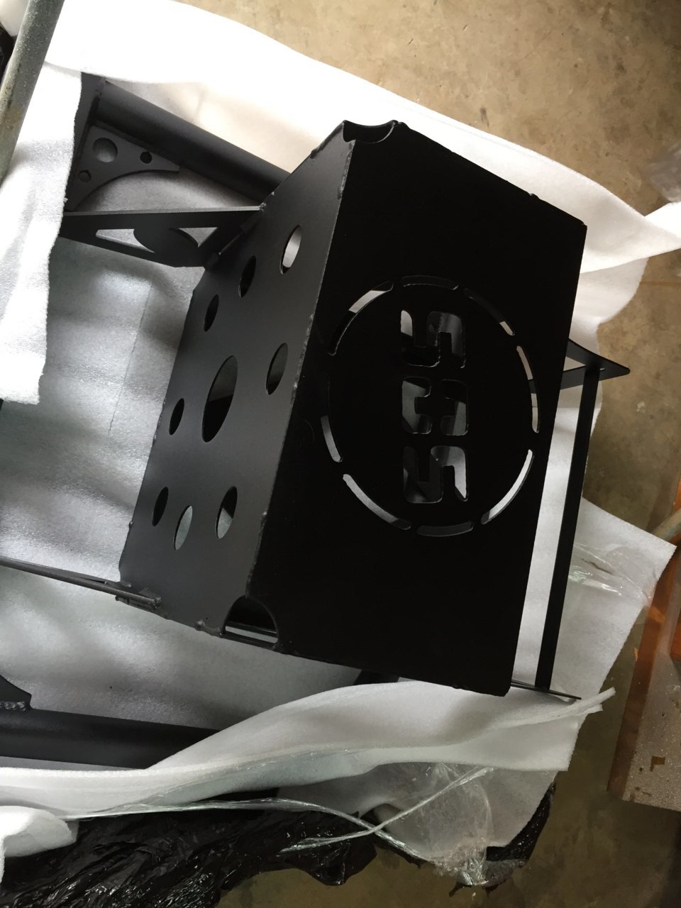

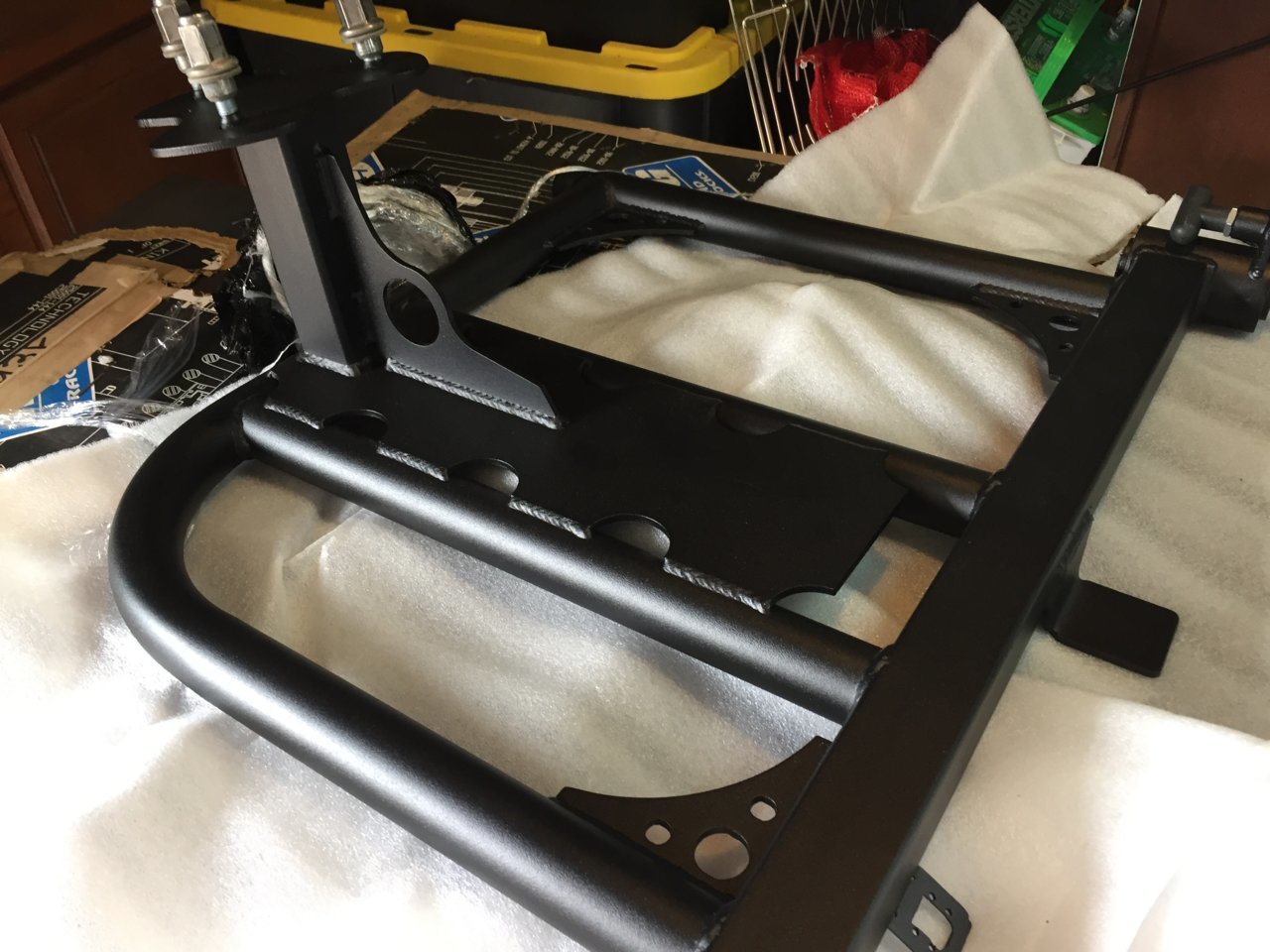

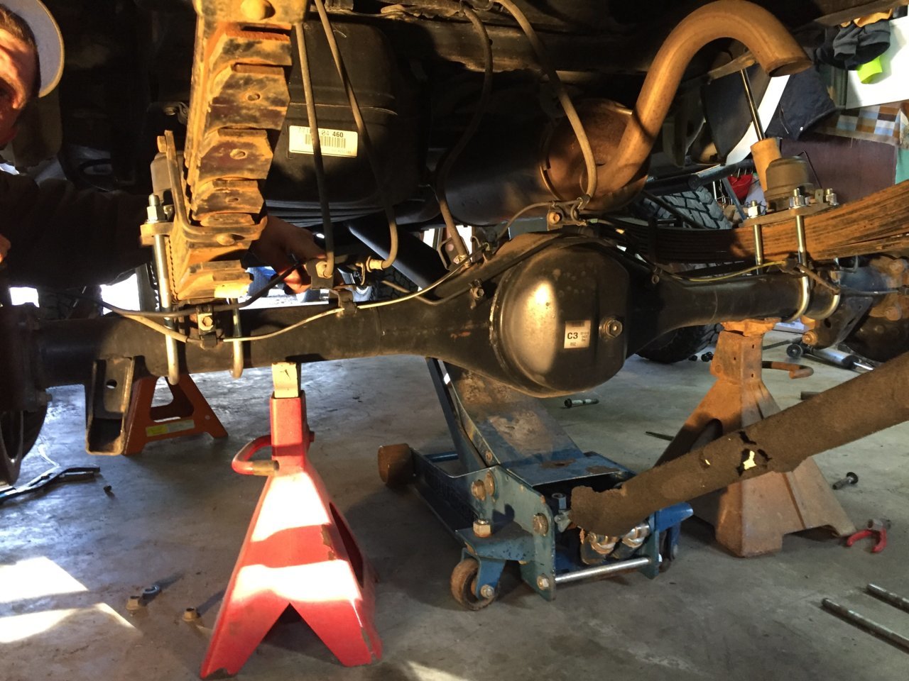

    It wasn't in that post but we also did my rear suspension. I removed my oem leaf packs with the 3 leaf aal's and installed Deaver stage III 700# progressive leafs. 9 leafs with 2 overloads for 11 leafs. I took off and sold my Icon 2.0's and we installed Bilstein B110's. I still have the +6 rear brake lines to install. I also got my rear bumper. SOS standard rear with dual swingers and dual jerry can holder. I ordered it powder coated black but I already scuffed just the bumper and started bed lining it white.
    Sink buggin now just a bit
    When I add all the weight of the bumper and spare it ought to drop it a little I'd think if not I don't care.
