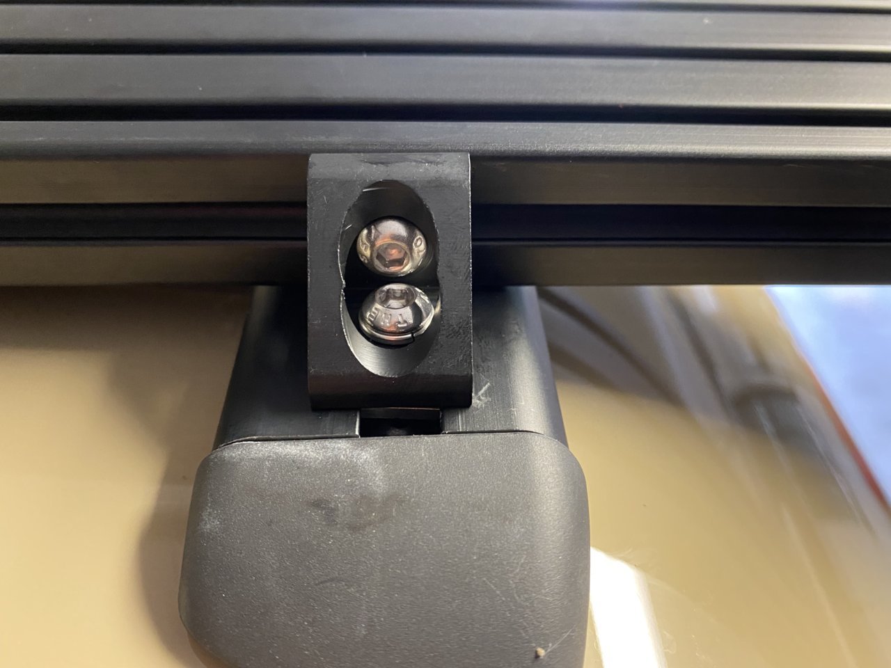

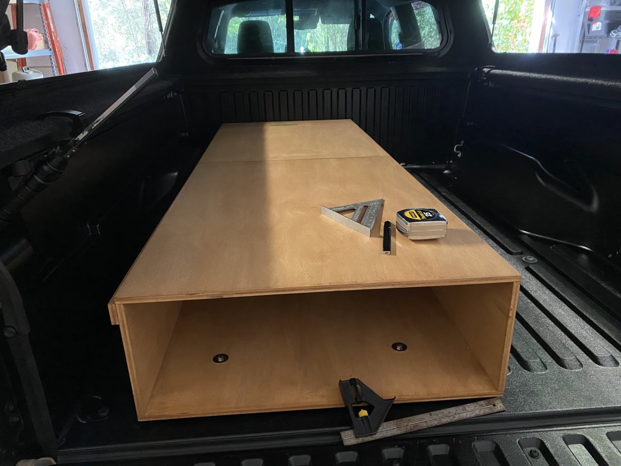

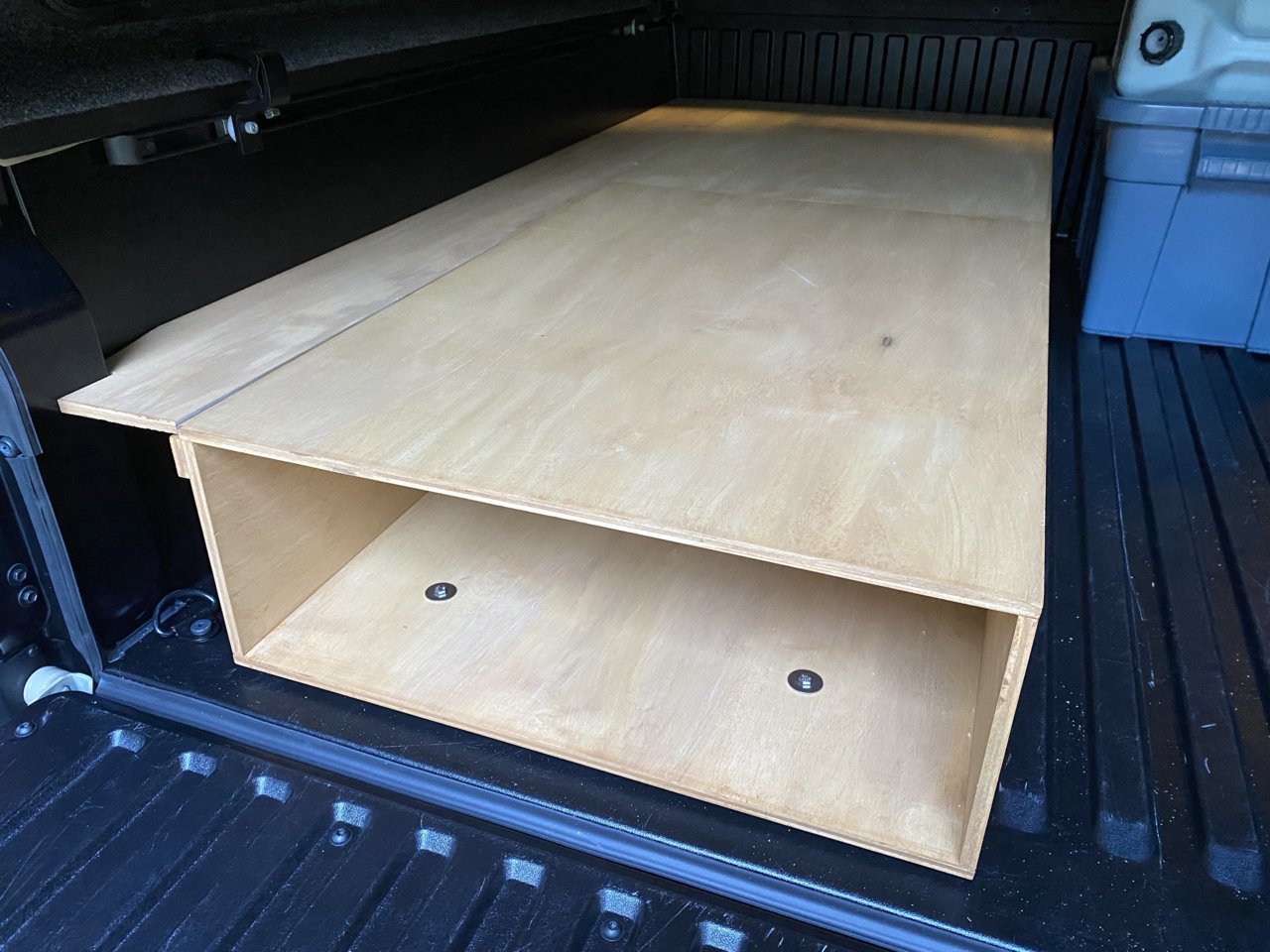

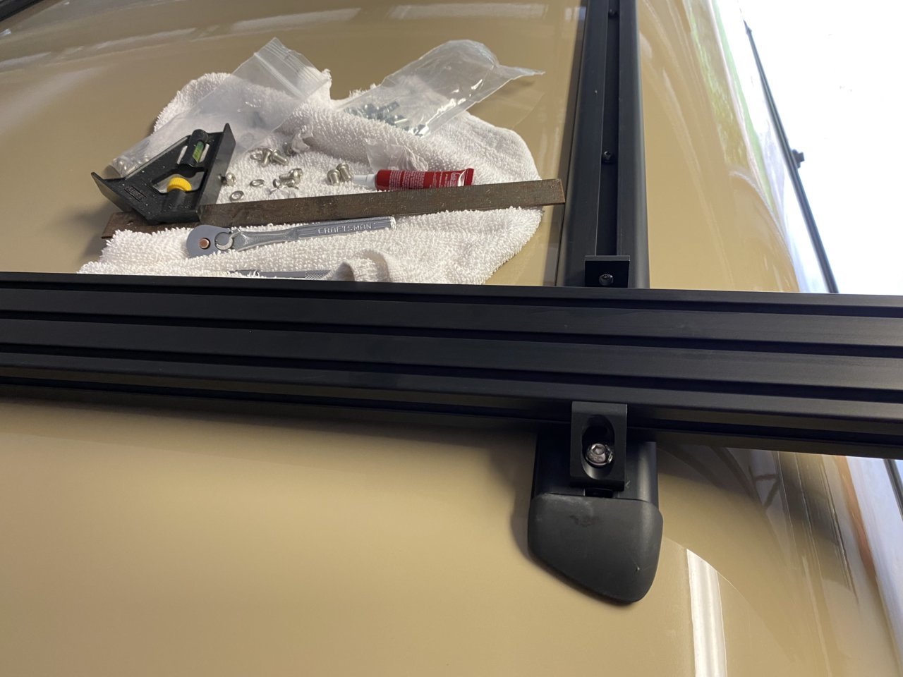

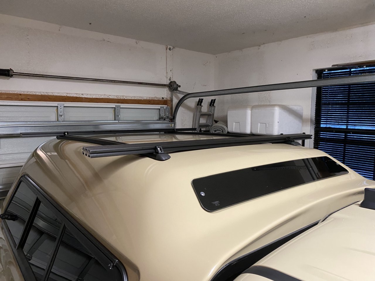

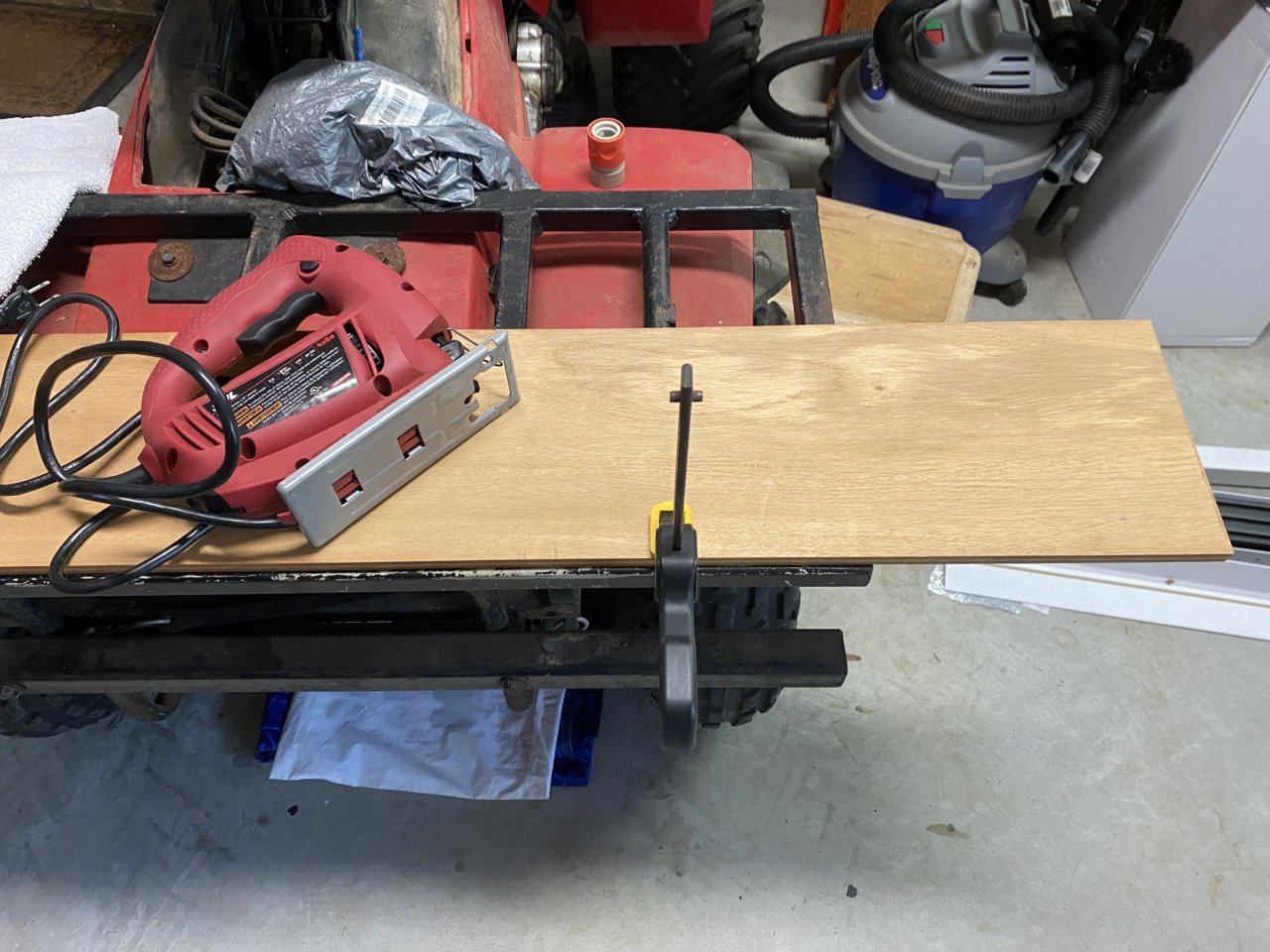

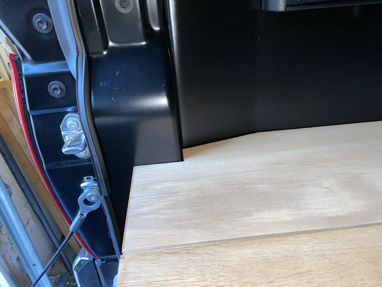

    Sleeping platform and roof crossbar updates
    After completing the platform I ordered some riv-nuts from Amazon to secure the platform to the truck. After they were delivered I learned they make special riv-nuts for plastics and composites that have multiple fingers that crush out to spread the load over a larger area to prevent them from pulling out of the soft material.:annoyed: The regular riv-nuts are not recommended for plastics because they can spin and pull out easily.
    Time for another “Plan B” for bolts and locknuts. I headed to the local Ace Hardware and grabbed stainless steel bolts, nuts, and fender washers. Once back home, I loaded the platform inserted the bolts through the holes and enlisted my wife’s help holding the wrench while I crawled under and tightened the nuts. Now that the platform was secured it was time to trim the notch in the filler piece for over the wheel well.
    Measure once, cut twice, fix it with a hammer
    Be sure to use the correct equipment when woodworking kids, old four-wheelers make the best sawhorses :thumbsup:
    It fits!

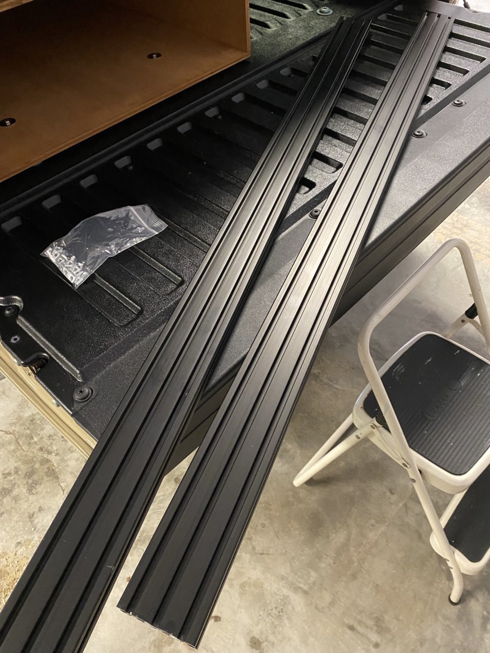

    With that out of the way it’s time to move on to the roof rack. When I bought the topper I had the roof tracks factory installed but declined the expensive crossbars and racks they offered. I don’t plan on carrying a lot of weight on the roof so I’m really not interested in a full rack, especially for what they cost! Cross bars are also way overpriced but I need something to hold an awning, shovel and my kayak when I need to transport it. I searched around on Marketplace and Craigslist but couldn’t find anything.
    Then I remembered Eric @ETAV8R had used electrical conduit for his cross bars. I looked back through his thread and saw he had changed things up some and was now using aluminum extrusion for crossbars. I asked him a few questions and decided it would work for me too. It was a fairly cheap (compared to actual crossbars) and easy to order from tnutz. I also ordered brackets, screws and nuts for the extrusion from them. They only thing I was not able to get was a 3” L bracket that Eric used to mount his awning, they don’t have it in stock and don’t know when they will have it so I just ordered the ARB awning bracket since I don’t have metal fab skills or tools.
    For the Yakima tracks on the topper you need flat nuts that slide into the channel on the track. Etrailer.com has the nuts you need.
    This was a pretty straight forward assembly, making sure the extrusion hung over equal distance on each side was about the hardest part. One thing I did find out was there is not enough clearance to use lock washers on both screws in the corner brackets that hold the extrusion to the tracks. I was able to use a lock washer on the screw into the track nut but had to use blue locktite on the screw going into the extrusion. Hopefully this works out! The awning brackets should be here this week then we can get that mounted and get a shakedown trail run in this weekend.
    1x3” extrusion
    Some assembly required
    All together
    MarX, Canadian Caber, EricL and 4 others like this.
