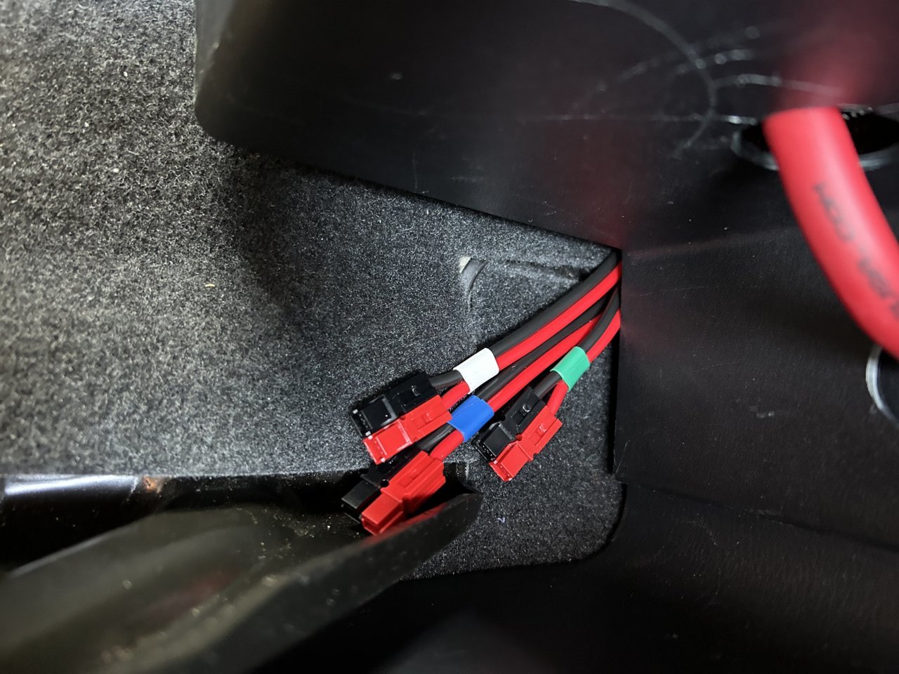

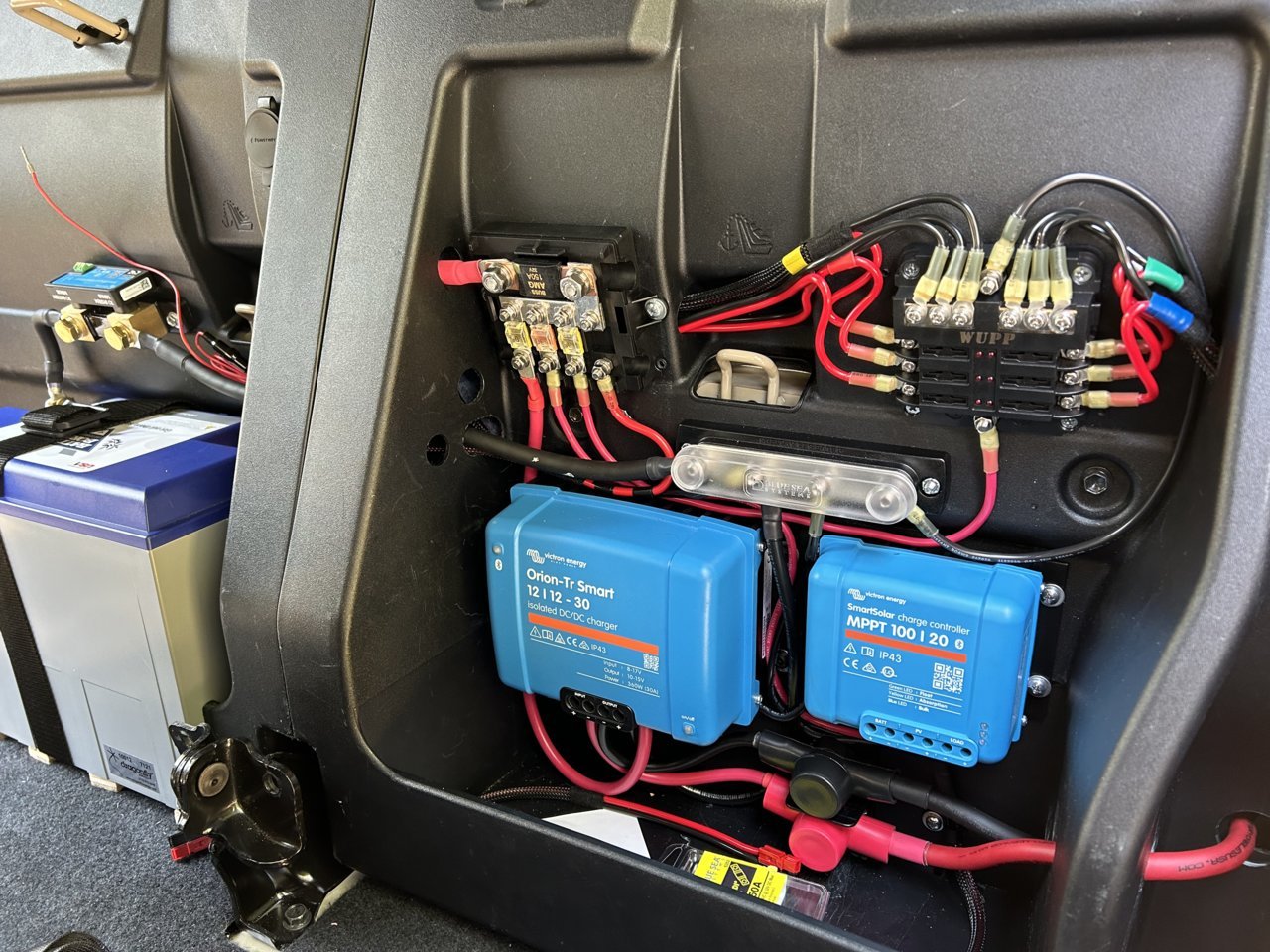

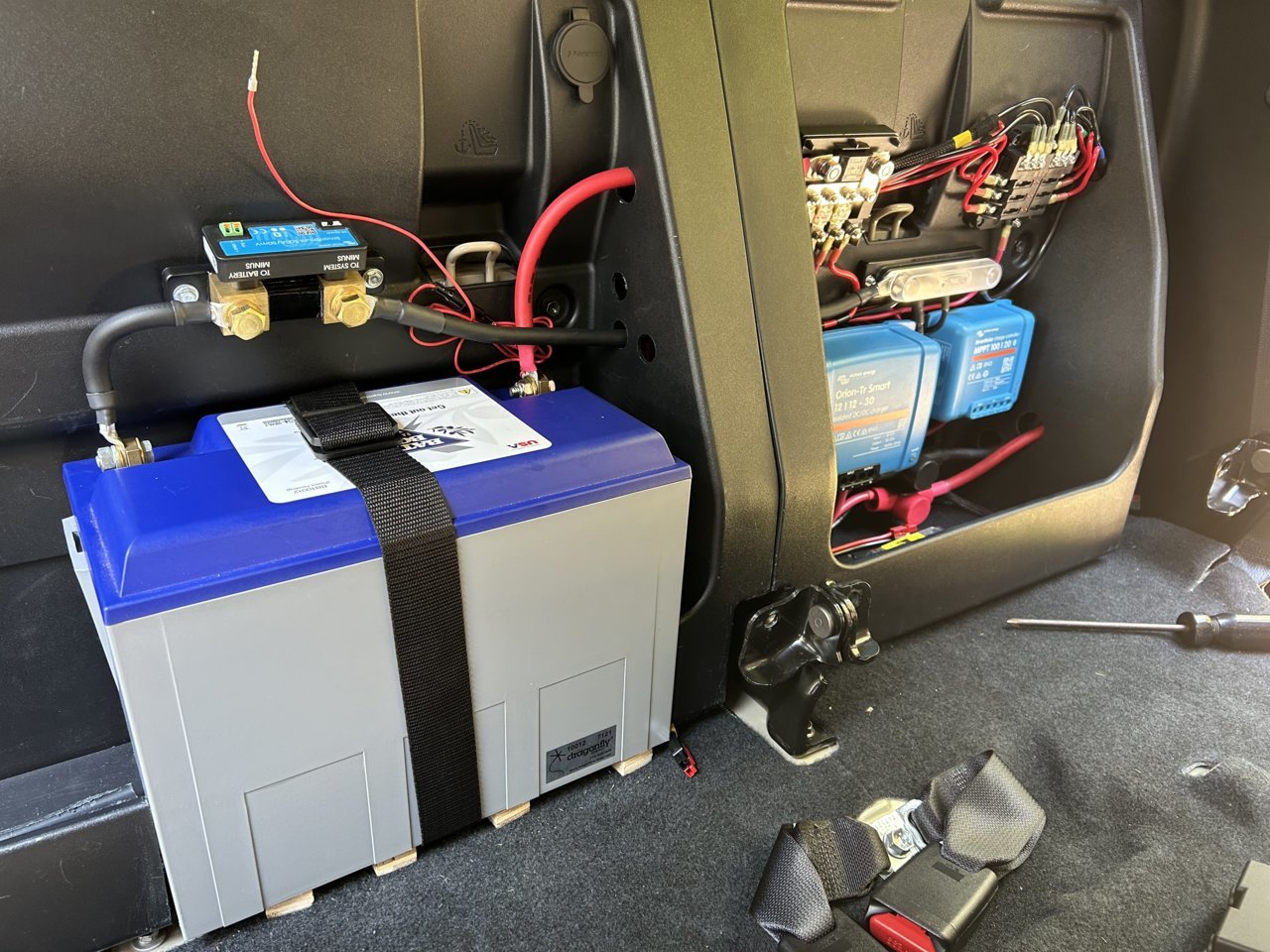

    No truck plans but I did this over the past few weeks
    Got rid of the rats nest of wires running to my house battery. Now just the 2 cables to the battery terminals and everything else to the left side midi fuse block. There is a 10 awg 50A lead running to the bed for another secondary fuse block back there that I still need to install. Right fuse block is for any in cab electrics I want to add. The inside fuse block is pre wired and terminated in Anderson plugs so I can make connections easy without having to pull the plastic trim to run the wires.
    I guess this is another write up I should do here in my “build thread” :rolleyes:

    This is nice!

    Nice neat work :101010:

    Thanks. I purposely didn’t take any pics of the multiple wires and fuse holders that were originally there lol. It was technically done correctly but it looked sketchy and I always worried about it. This makes me feel much better.
