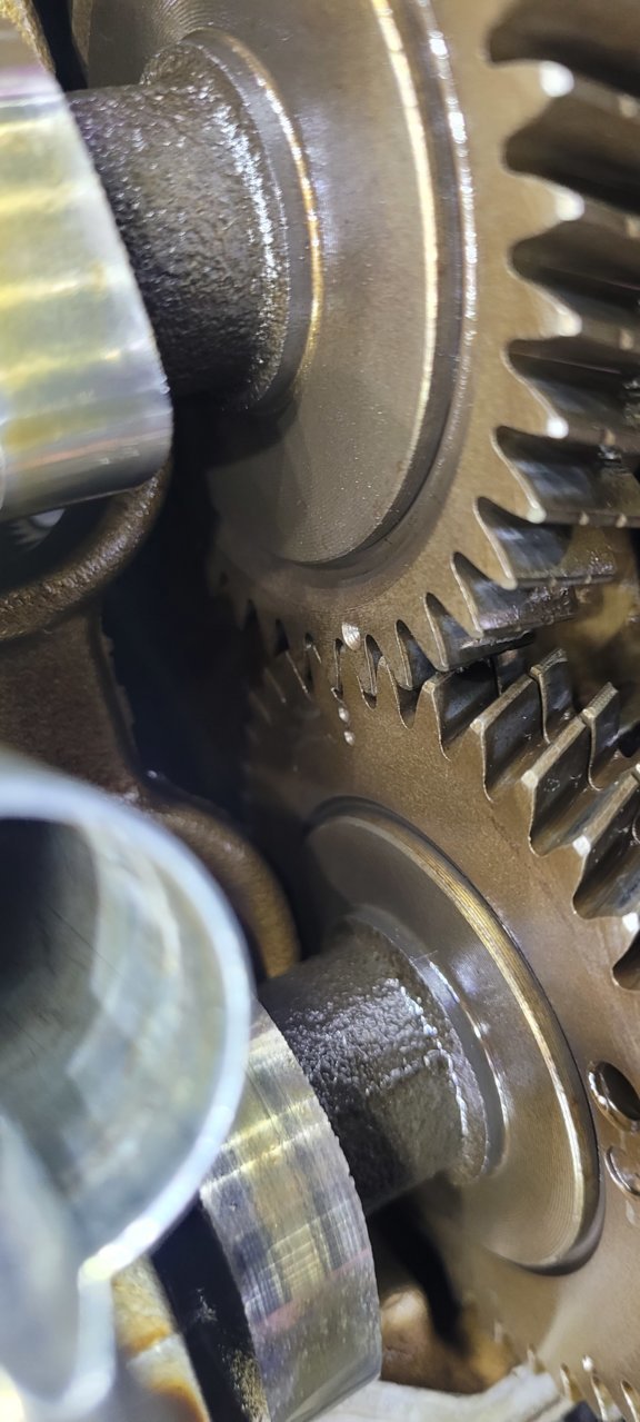

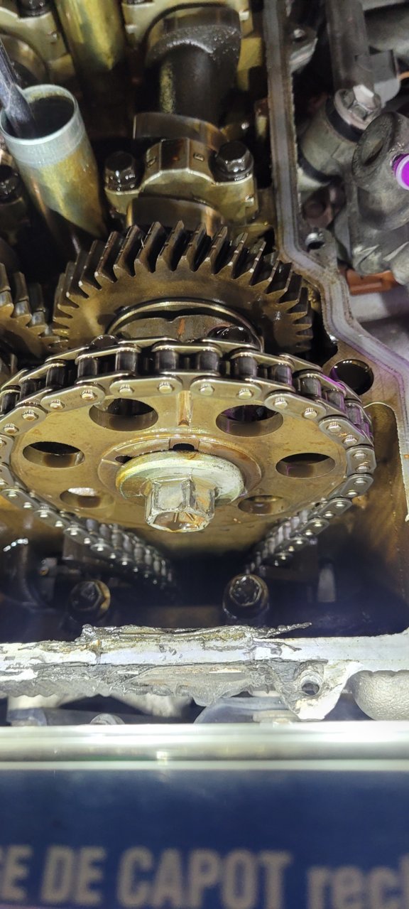

    so I just pulled off the cover and tried to align for tdc and found this....

    What would be the easiest way to fix the cam alignment?

    Undo em and rotate it

    All you need is a trusty Hanes manual and youtube

    I'm pretty sure this is what the issue it. surprised it runs!!

    Good thing it’s only one notch off. Hopefully it didn’t cause any damage. It is an interference engine I believe

    Check the rest of the timing. Down at the crankshaft pulley. If it’s good, be sure not to undo the chain from the timing gear on the driver side camshaft. Use zip ties to keep the chain on the teeth.

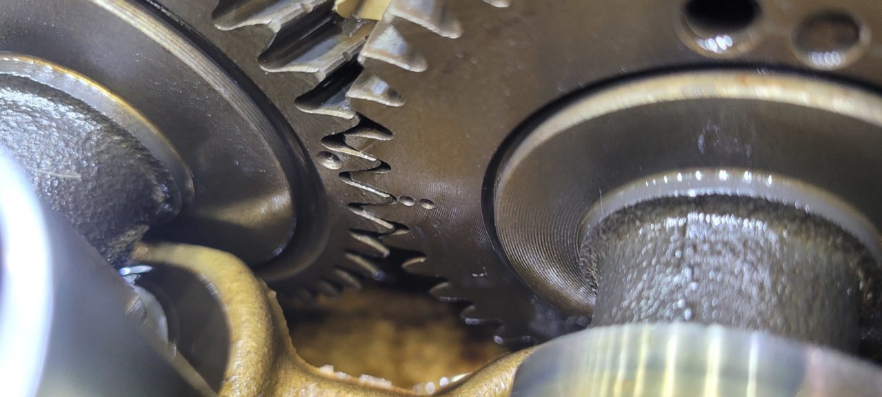

    I'm thinking the driver side is off. what do you think?

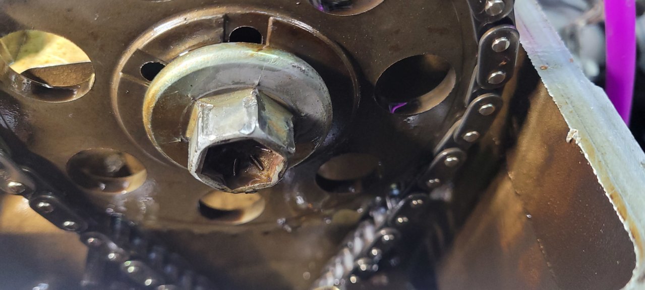

    yeah its looking like its the drivers side to me. think I can move it over a tooth without tearing apart the front end? not sure how to stop the tensioner from moving

    I wouldn't jump into removing that and realigning the cam unless you can prove that it was removed previously.
    Check your valve clearances first. Normal maintenance does not require removal of the cam, so it should never get misaligned like that.

    Make sure to check the timing mark down at the crankshaft. Sheesh at this point I don’t know what to tell you. Whoever buggered with that was careless. If the timing marks on the chain are non existent there’s no way to know for sure they’re even on the right teeth.

    Ok. Got all the marks lined up how they are supposed to. Pulled the timing gear off the intake cam and moved it over a tooth, then pulled the exhaust cam completely and aligned the dots on the gears. After torqueing down the exhaust cam I checked the intake cam bolts and they were like maybe 5 ft lbs! So I re torqued those as well.

    After thinking about it with the cam gears being off from one another and then the timing sprocket being off a tooth I think they sortof offset eachother a little and the ecu was just like whatever ill make it run lol
