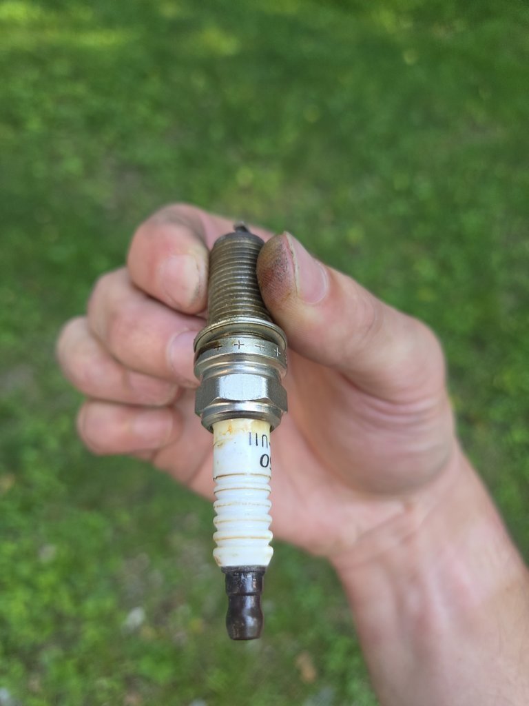

    When I got home I pulled the plug and noticed a little bit of oil around half of the edge of the plug, but it wasn't super oily--only one side. Perhaps oil seals need replaced...but would that even cause this misfire or is it probable it's unrelated? I swapped the coil pack from #5 and #6 to see if the problem follows and will report back tomorrow after my commute.

    Electrode looks good, maybe a little wear but oil could just be from valve cover. Doesnt look like its burning oil. My .02cts.
    Swap coil location, see if it follows.

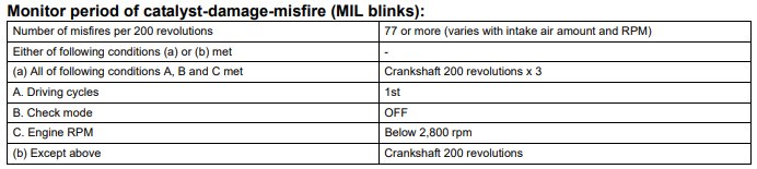

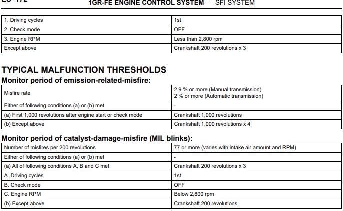

    Here is some data for Catalyst damaging misfire, looks like they're suggesting more than 77 per 200 revolutions is considered damaging (CEL blinking). I don't believe 27 misfires in a 4hr drive would be considered damaging.
