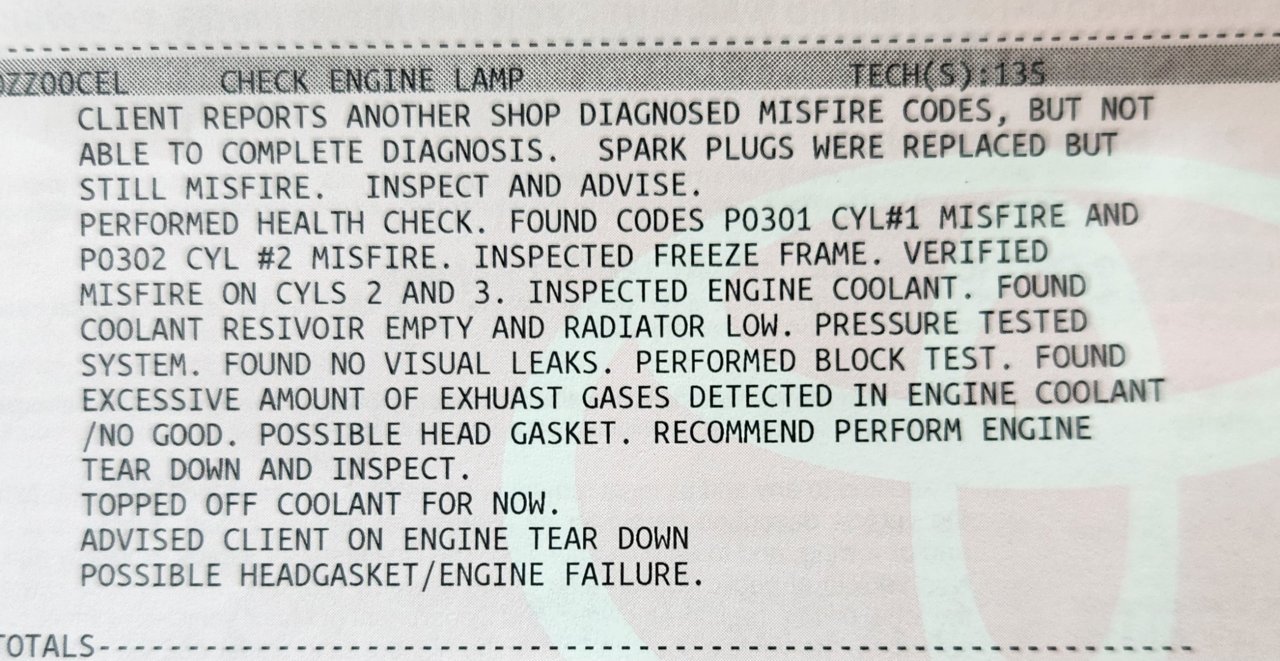

    Ended up taking it to the dealership to get diagnosed. Found that it needs a new head gasket. Cost for them is $7k. I know I can get it done for less then that but the worst news I could have gotten. What to do....

    From the dealership

    I see that the dealership mentioned that the coolant reservoir was empty and the radiator was low. Have you been going through coolant? I didn't see that mentioned in your initial post.

    I topped it off about a year ago and it was fine. It was on low when they checked it.
