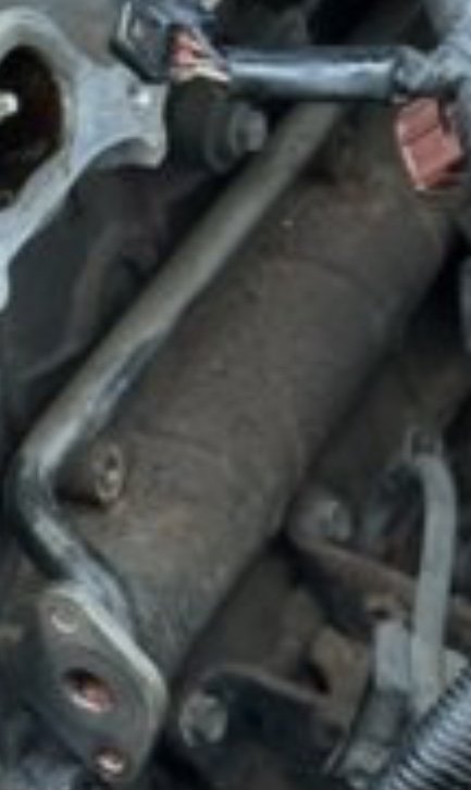

    I’m sorry, too. Good luck! Is that the plastic or metal coolant by-pass pipe?B0C5E50D-95EE-48A4-84FC-DD09B51B720E.jpg

    Looks to be the metal one.
