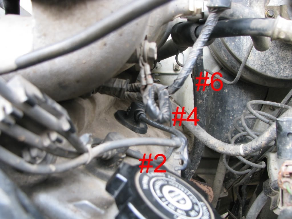

    Cylinder 4 does not have a coil. Only 1, 3, and 5 do. Do you mean swap #2 and #4?

    swap the coil that powers cylinder 4 to a cylinder that is on a seperate circuit from cylinder 4 and it's partner cylinder...so whatever cylinder..on either bank..just make sure that

    So after talking to a Toyota tech, he told to check the old spark plug for signs of scaring. The old spark plug was scarred and rusty looking so he said just replace the plug wire. Code hasnt come on and she runs great!
