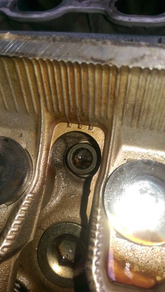

    What kind of driver type should I use to remove the cylinder head bolts? The Hanes manual shows regular hex bolt heads in their illustrations but mine look like 12 points.
    Can I safely use a 6 point driver or does that jeopardize stripping?

    Triple square. Buy the right tool for the job.

    It's not proprietary to Toyota. Many manufactures and industries use that style.
    I'd say the reason they didn't use a standard hex is clearance issues.

    I'm sure from an engineering standpoint, the doublehex can handle a higher amount of torque, less chance of stripping or rounding off, etc.
    As far as a "tool kit", they probably didn't have a backyard mechanic in mind when designing it. That style driver is widely used so it's nothing special as far as automotive repair goes.

    I wouldn't risk it. A stripped headbolt would be a the last thing I'd want to have to deal with.

    ^^^ yup, they do look very similar, but drilling out head bolts with stripped out heads isn't as fun as it sounds - been there, done that many years ago on a VW diesel, and they are HARD. IIRC, it was the result of my brother trying to use a 6pt allen wrench for removal.
