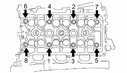

    The Tacoma engine line all use TTY (torque-to-yeild) head bolts. When properly torqued these head bolts microscopically stretch. The purpose of using TTY bolts is that it gives you a more accurate clamping force on the head gasket, unlike the older style where you simply tightened them to a specific torque and went on your way. By using TTY bolts and using toque angle settings, your clamp force is almost exact across the entire cylinder head.
    That being said, I would NEVER in my life take the chance of reusing a bolt when a complete replacement set can be bought for usually less than $50. That is like buying a water pump and saying that since the gasket didn't tear, I'm going to reuse it, and risk blowing and engine because a $2 gasket failed. You see, this is EXACTLY where an automotive shop cuts corners, and then a couple weeks or months down the road your engine blows, and you get all pissed at them for doing a piss poor job. By all means, go ahead and reuse the bolts if you want to. And sure, maybe you will be one of the lucky ones and you won't have a problem. But do you REALLY want to risk it on the engine of your truck?
    As for the answers to the other questions:
    Do not use ANY lubricant or antiseize on a head bolt. (edit this to no antisieze, lightly coat bolt threads with engine oil)
    Don't lubricate the washers. It is not needed.
    Clean all bolt holes with a thread cleaner brush and leave the bolt holes dry.
    Torque spec and sequence depend on the engine. Assuming you are building the 4.0 V6 you will have the following:
    Torque specification is each bolt in the above sequence first to 27 lbs-ft, then go back and tighten each one again in sequence 180º. After that is done you can then install the two smaller front head bolts and torque them to 22 lbs-ft with no further tightening required.
