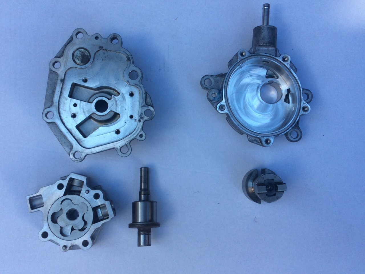

    What to do? Well, fortunately for us, the 2GR-FKS is not the only engine to suffer from this problem. There are several performance engines on the market that utilize additional oil pumps to scavenge the heads and return this oil to the sump. One such engine is right in Toyota's product line... the 5.0 2UR-GSE V8. I think we can borrow that scavenge pump and help solve this issue one and for all.
    Here is a drawing of the pump and system as installed on the 2UR-GSE. The pump is belt driven just like a water pump, has two rotors (one for each head), and draws oil from the front.
    Incorporating this system, as designed, into the 2GR-FKS, would be a nightmare. Additionally, since it pulls oil from the front of the heads, it won't solve our issue. The cars that run this engine do fine with this system as their oil issues come from high G cornering. A little poking around the much maligned V6 does show a possible solution...

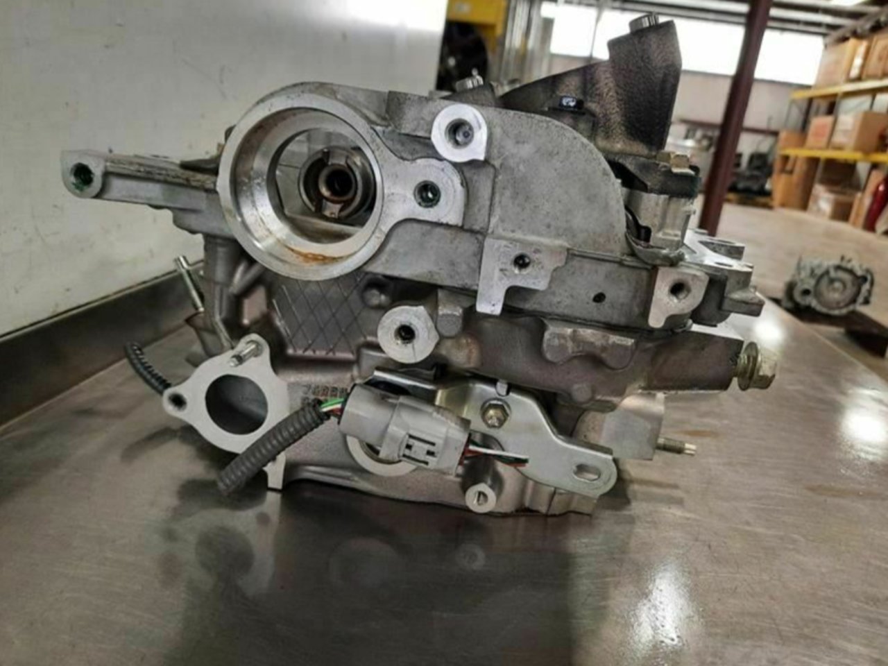

    So the passenger side cylinder head on the 2GR-FKS has a location on the back of the cylinder head that drives a vacuum pump via the camshaft. The pump is only on some models, but all have the mount and cam drive. My thought is to drive the scavenge pump from this location, and extend tubes to rear of each cylinder head to pull the oil and send it down to sump.
    Problems. Can vehicles w/ the vacuum pump eliminate it, and still maintain consistent brake assist? Does the Atkinson cycle necessitate the pump? Some tunes eliminate it. The scavenge pump is over driven as installed on the 2UR-GSE, it will be driven at 1/2 engine speed on the 2GR-FKS as that is what the cams are driven at.... the V6 supplies less oil and our problems lie at lower RPM, so it may work. Testing will be required. Thoughts?
    For now, here are the scavenge and vacuum pumps. Some custom work is obviously required to mount the scavenge pump to the head, but nothing outlandish is needed.

    Rear of the cylinder head showing mounting location and the slotted camshaft for driving the pump.
