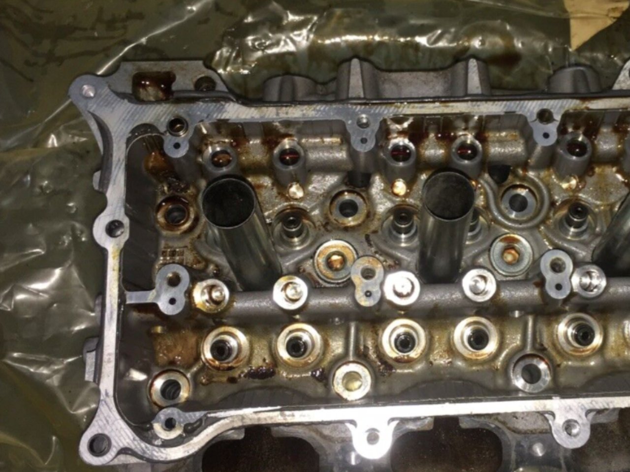

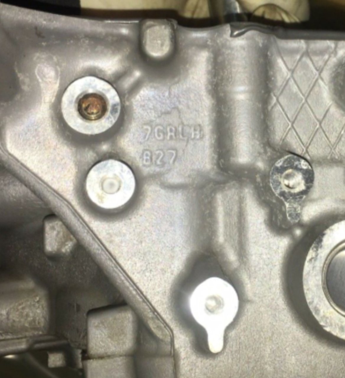

    Do you happen to have any pictures of the rear of this head? Possibly with the valve cover off as well? To be able to tell is a threaded AN bung could be tapped in/welded on?

    Yes, in this pic, upper left corner of the head is the rear most low point.
    Looking from the backside, where the 7GR is cast could work. Or maybe one the bosses or nubs...

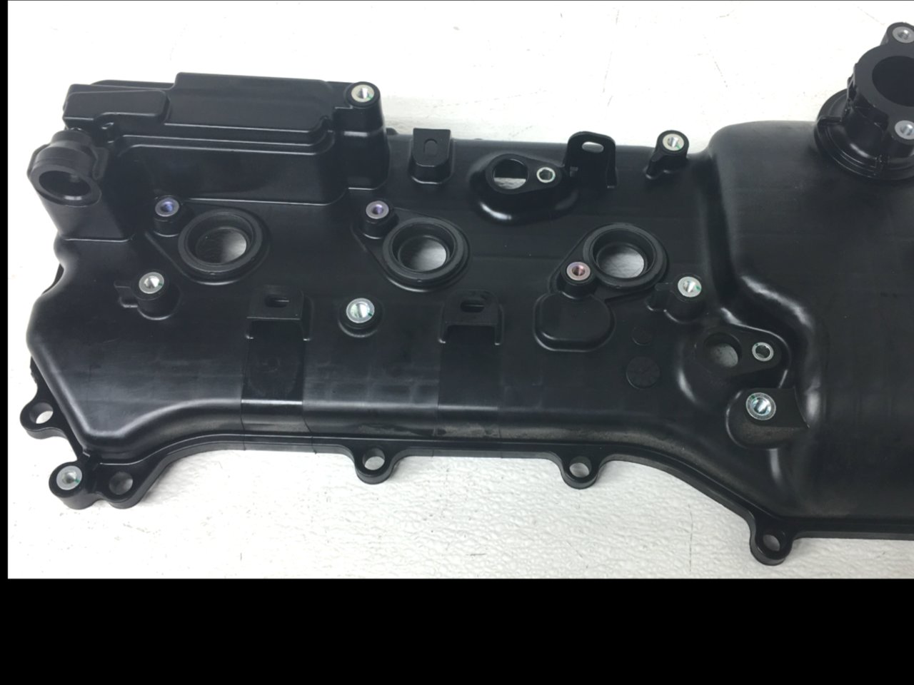

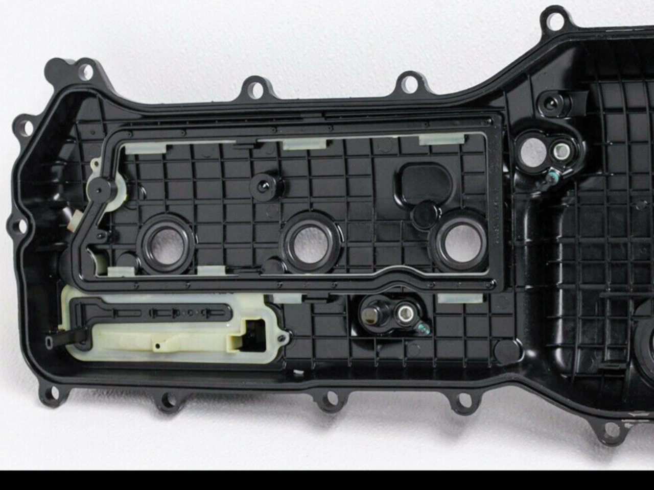

    Whats the valve cover itself look like in that area? Id figured one would want to do this on the exhaust port side of the head or in / around that area on the valve cover so you wouldnt have to remove the head / motor to simply drill n tap a hole.

    In the photo above, the upper left is actually the exhaust port side. I'll admit, it is a weird angle for the pic... from the middle of the engine looking out.
    The valve covers are the fiber reinforced nylon plastic, and a bit of a nightmare. The breather, which is a large part of the original problem, is directly above the ideal location... this pic is from the same view as above.
    They also have the camshaft oil spray bar incorporated into them. The spray bar can be eliminated and cam lobe spray can be taken care of by using 2UR-GSE cam followers/rocker arms, which have spray jets... but cost, cam removal, and we still don't have the right spot.
