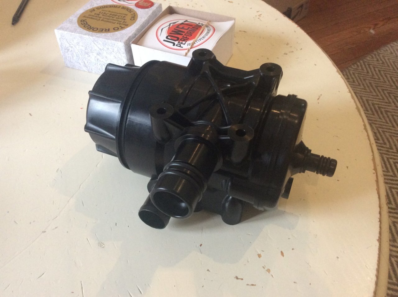

    Yes, catch cans with oil returns are available. Here is a unit that Hino supplies on some of their diesels. The drain has a flapper valve, presumably to keep oil flowing down.
    My thoughts at this point.... There's a reason Toyota/Yamaha chose this solution... constantly forcing the oil back to the sump is a superior way to continuously accomplish the task at hand in all situations from mild to wild. It's a vetted OEM system that has seen millions upon millions of miles of use in both street and racing environments.
    With that said, a big thank you to those that have contributed, including those w/ different solutions... and by all means keep discussing them, we have no where to go but up (or should that be down?).

    E36 has that as well. Good technology, rarely used by OEM's, and some of those cars were manufactured more than 20 years ago.
    Jowett[OP] likes this.

    Forgive my ignorance, but what about a catch can with a two way check valve(s), combined with a zero pressure drain valve leading back to the oil filler neck. It might alleviate some concerns about the catch can filling up (they're super close in proximity). Although, might not address OP's concerns about conflicts in the head.

    No hard data on angles or oil flow exists at this point, at least that we can access. When I get my engine on the stand for building, I'll gather some to the best of my abilities.
    The catch cans are lightly discussed above. They can save the day, and yes, probably employ some type of drain back.

    I was thinking some kind of float valve. Once the catch can is full of liquid the float would rise and close off the outlet and would also uncover (open) a bypass to ? (insert location here)
    This still wouldn't fix the problem of all the oil staying on top of the heads and possibly running the sump dry.
