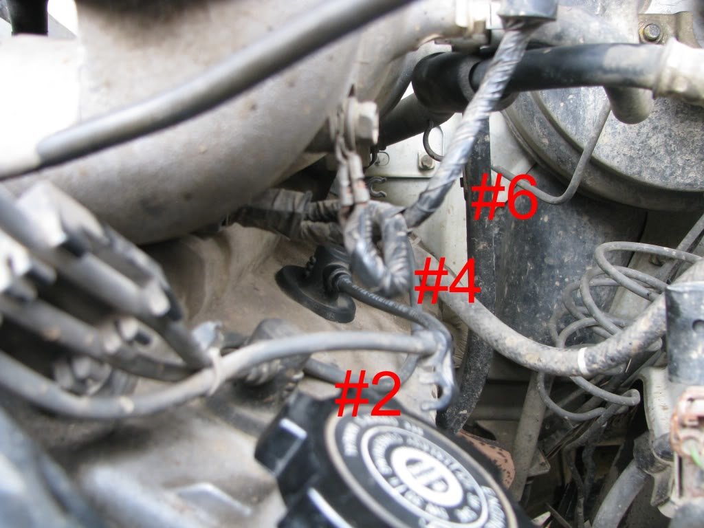

    On my 02, looks like I have 3 coil over plugs with dual plugs. Each coil over on the left side of the engine has a wire going over to the right side of the engine where it connects to a second cylinder.
    I was going to try to swap as mentioned, but at this point the problem seems intermittent.
    I haven't been able to reproduce the problem by just starting the vehicle. It only happened once so far on the hwy at about 90kmh

    Crap, I should have mentioned I have the v6, and it is coil over plugs on 6 of the 6 plugs.
