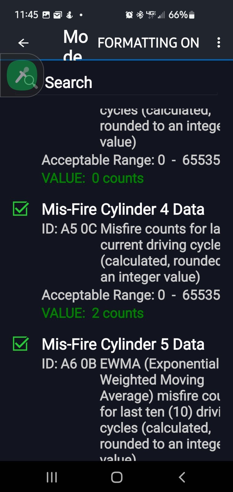

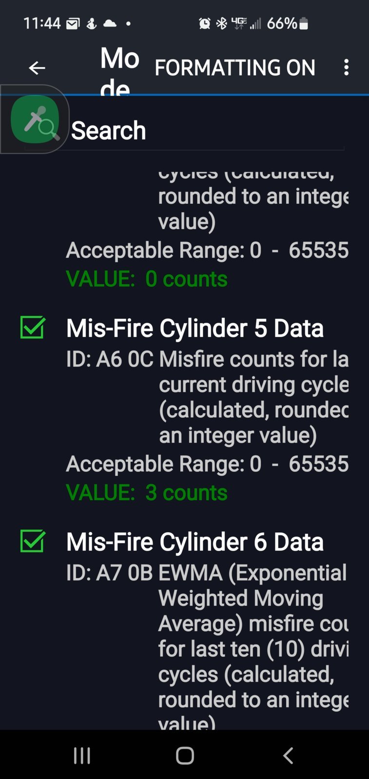

    Does anyone know if I should be concerned about my truck having misfires in specific cylinders?

    Whats total for the drive cycle? It is under A1

    What do you mean? If your asking time, maybe 10 minutes when I read the data.

    A misfire here and there is normal. As long as it's running smooth and not setting a check engine light you should be fine.

    These numbers are normal.
    When you cold start the engine, you will see somewhere between 3-5 misfires registered across all 6 cylinders.
    Typically you'll see around 10 total misfires on cold startup driving cycle.
    Less than 5 on hot engine cycle.
    Start worrying If you see misfires in double-digit territory for a single cylinder.

    I concur, nothing is perfect and especially off a cold start you may see a handful of misfires.
    If you don't have any misfire codes and the engine runs smooth then take this as a baseline reading and carry on
