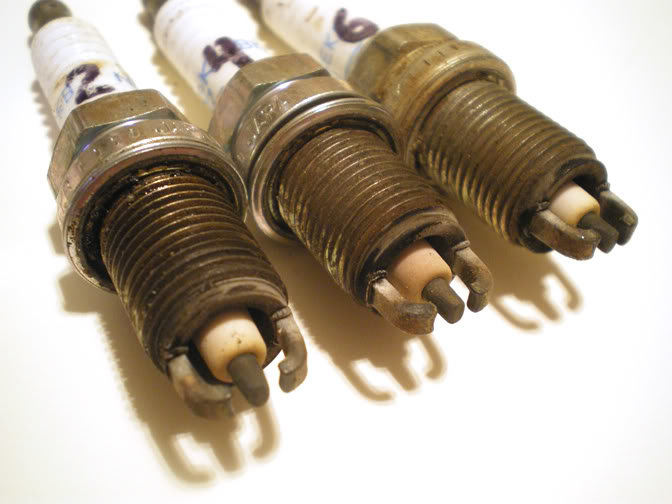

    When I replaced the spark plugs I numbered them according to which cylinder they came out of and noticed that numbers 2, 4, and 6 plugs which line up on the driver side all seem to be burning lean. 1, 3 and 5 seem to look as they should. I know that 1, 3 and 5 are on a separate fuel rail or fuel map than 2, 4 and 6. What would cause the even side to run leaner than the odd side? Could this cause my truck to idle rough?
    I'll post pics of the spark plugs as soon as I can...

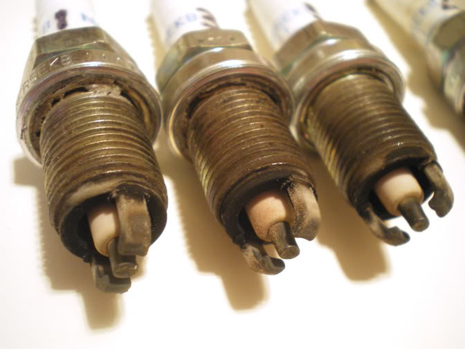

    Here are plugs 1, 3 and 5
    It may be hard to tell but the rim of the plug is black which is normal wear on a set of plugs.
    Now here is 2, 4 and 6. Notice how the rim on these are not as black as 1, 3 and 5...
  3. Feb 2, 2011 at 10:12 PM
    tostidos
    tostidos Well-Known Member
    Dec 24, 2010
    #48149
    4,761
    Apple Valley, CA
    07 LT 6spd
    maybe you have a peice of debris in your fuel rail on that side that would cause a rough idle and the spark plugs to be off. they dont look too bad.

    Thanks for the advice. At this point I have arleady invested close to $200 in what I have already done to alleviate the annoying sporadic rough idle...

    It may be just the angle of the plug, but it seems as the electrode on plug #1 isn't worn the same as the others? Do a good fuel system clean first.

    I ran two tanks of Chevron Techron fuel system cleaner and ran the truck another month before I pulled the plugs in the picture out.
    I have a new set of plugs and the truck still idles rough.
