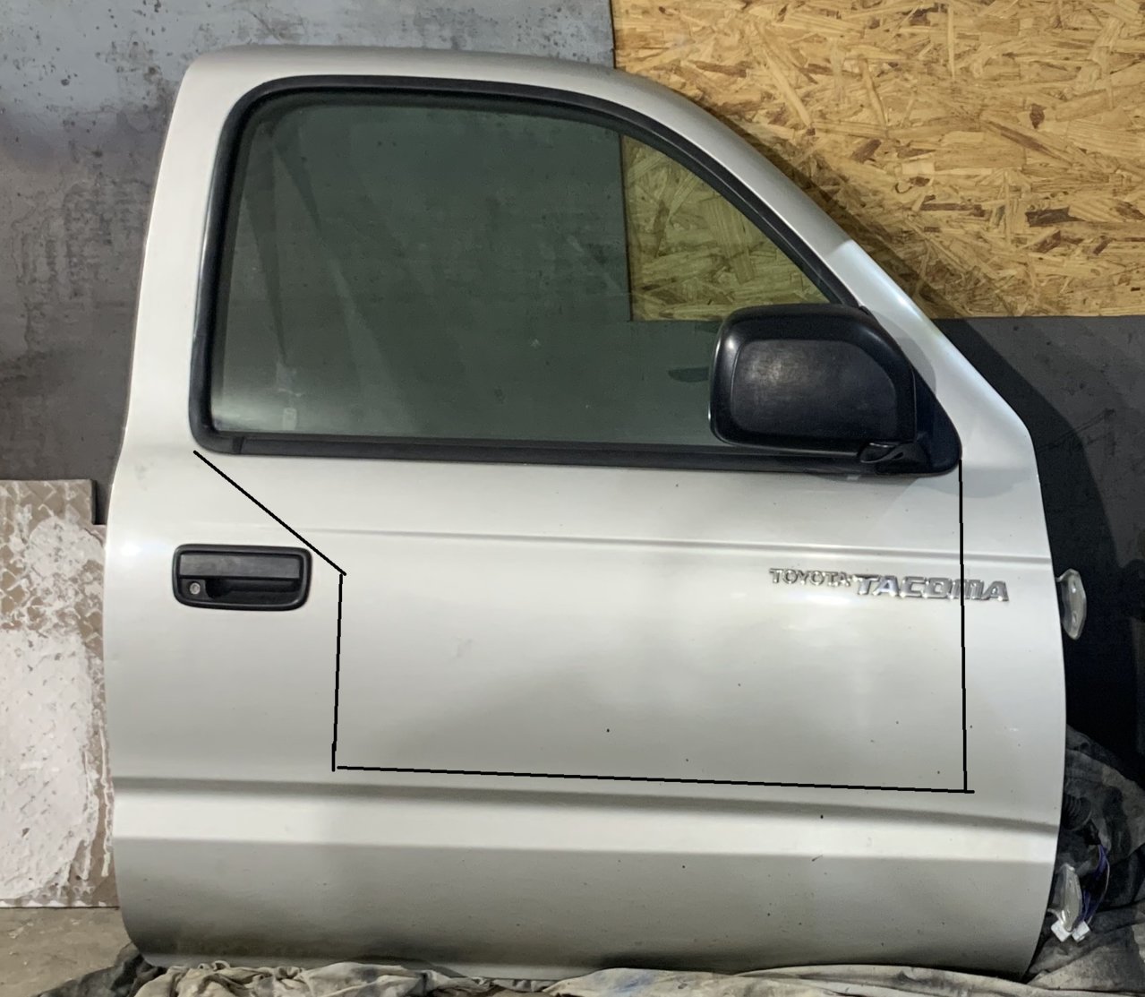

    Some lessons learned from my half doors. I would have cut it a bit deeper for more visibility, something like this. I also sewed together some windows with a heavy duty fabric and clear vinyl and used some softopper snaps to connect it to the door. I wish I hadn't done that. Instead, only use clear vinyl and some industrial velcro around the entire border. That way it's easier to make the windows and also totally seals it off.
    Here's how I have my door hinges modified to aid in taking the doors on and off. Super easy doing it alone. I think for first gens you can even get a QD kit from 4xinnovations.

    My plan is basically to copy @ToyRyd04 on his, I like his depth. I don't think he had issues with leaking either but I can see how like snaps in corners and maybe velcro the whole top might seal a little better. The only thing I want to improve on is potentially using the door itself to store the fabric door when the fabric is off. Doesn't have to roll into it or anything fancy, just a little hinge setup that lets me get the fabric in there.

    Yeah maybe velcro on top, I get a few drops, but nothing much. Velcro on the full thing might not hold up, especially at highway speed, or when it gets colder, the clear vinyl will shrink some and pull the velcro apart. This is where tarp snaps hold up well as they'll hold tight. I've had the snap in windows on doing 90+ and works great.
    PM or give me a call when you get that far, dont just layout the snaps and punch them into the windows.
