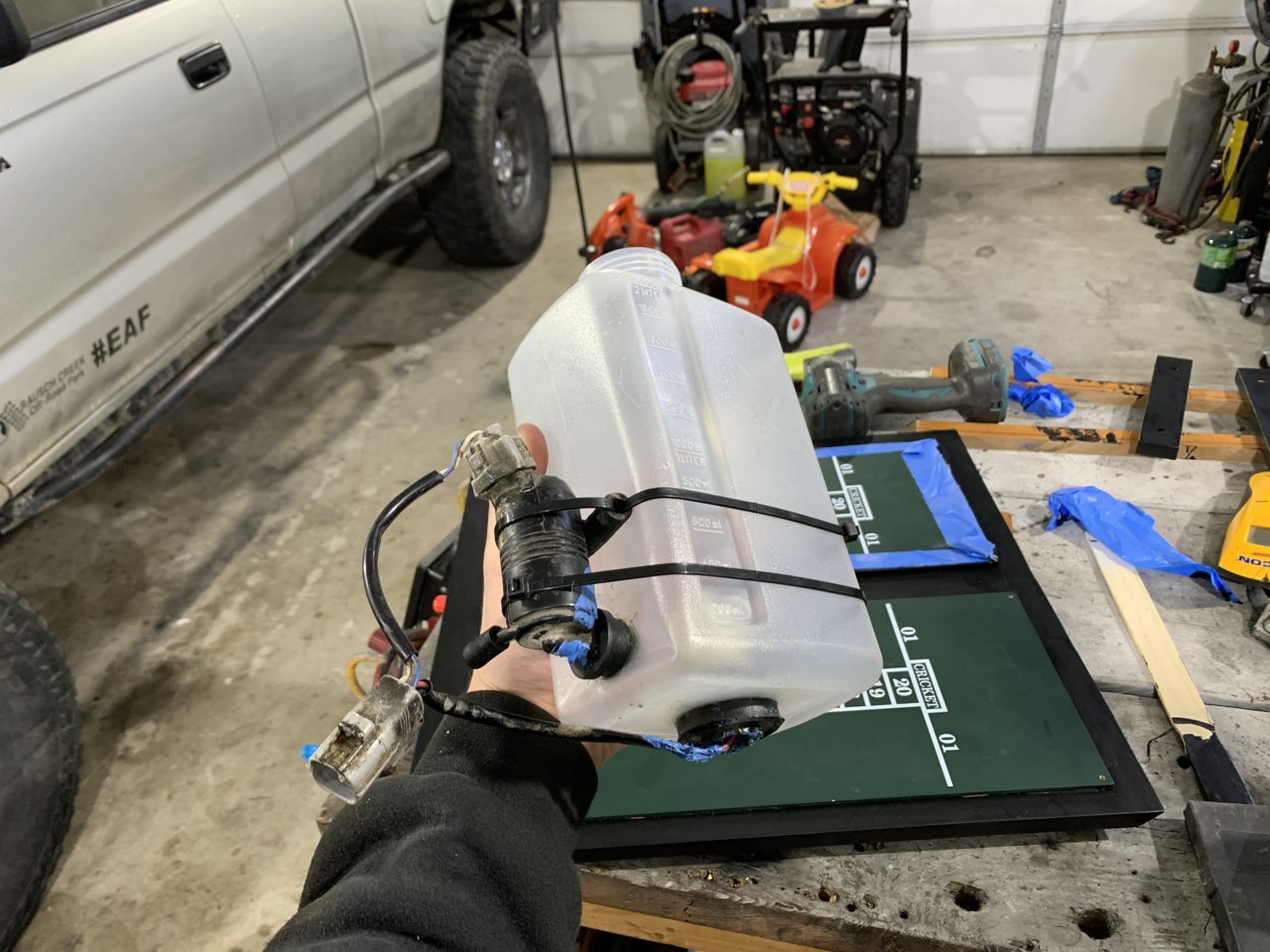

    Maybe third times a charm.

    Apollo 13 crew invents a windshield washer bottle. :D

    So far so good on the new washer res holding fluid as well. Hope this one holds up a little better now.

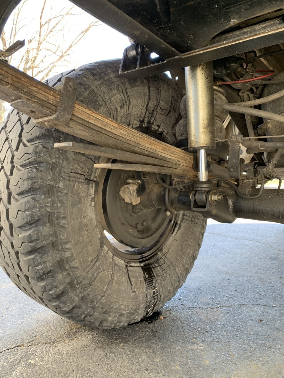

    Really hoping this was due to a frozen and clogged breather line.
    This side was fully rebuilt in July 2019.

    I do not miss that shit!!

    Yeah I can't wait to go full floater to never deal with this again. Going to check the breather, brake clean the tire and run it, see how it performs. Then assess from there. Been working on the house so trucks just sitting lol.

    Oh don’t worry, the full float Sterling in the back of my F250 found a way to do that to me too

    Replacing the seals are heck of a lot easier in a FF. Same thing with the bearings, plus they last longer since the hub is independent of the axle shaft and doesn’t carry the vehicle weight.

    Spend 3/4 the time to save 1/8 the price. Sounds good but you have to be committed to the bearing anyhow.

    So you're saying don't replace a bearing?
    You should check to make sure the bearings didn't get their grease rinsed out by the oil. New seal on its own won't always be the long term solution.

    I agree unfortunately there’s no real great way to check the rear bearing is screwed without replacing the bearing. That’s the downside to the SF axle

    if you can tell me a way to check the bearing is good without having to remove the hub let me know, otherwise by that much wasted time you may as well just replace it.

    Dude what side of the argument are you on? I suggested replacing the bearing and turning the outer race / spacer the opposite way to get the flat side contacting the seal upon reinstall, not the tapered side as instructed by the FSM and simply removing the shaft you can check for excessive play. I need a nap - probably missing your point lol

    I did not see where you recommend replacing the bearing, only turning around the seal retainer my apologies. But you are already into the pressing activities to get the seal retainer off so I think while you are in there it would just be easy enough to replace the bearing while you're at it yes. I know for my bearing failure there was no excessive play but the inside was rusty as hell and looked terrible, didn't know until I got into it.
