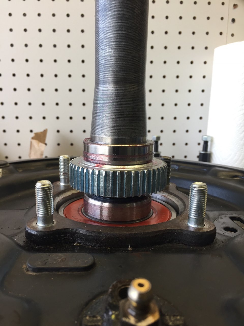

    Actually the flipped direction no longer matters for me as I don't need to have a tone ring lined up in a specific location anymore. And IIRC that retainer doesn't even get pressed up to the tone ring either way. Flipping it does nothing if you get the seal to ride dead nuts center regardless. What I did/do when I do these jobs is I mark the retainer with a sharpie and reinstall the axle, spin it a bunch and verify exactly where the seal rides.
    If it still is leaking I will pull the axle out, replace the seal, pop the bearing cover off, repack it with grease and see how she goes.

    Do you guys have serviceable bearings? Damn another reason to get a 1st gen LOL

    Hell no, but if you are careful you can pry that red cover off above ^ I have done it in the past when I damaged an old cover and swapped it from the spare bearing I had.

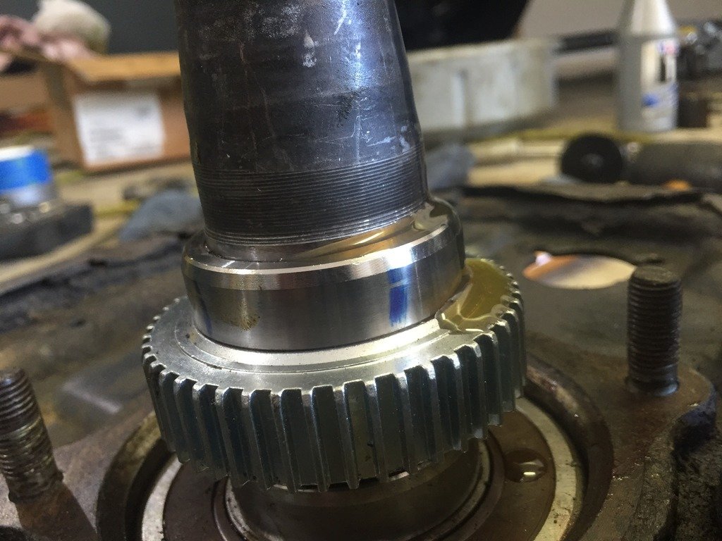

    This is the other side I did a couple years ago. This is where I can see flipping the retainer would be helpful because I guess it does actually help hold the tone ring on. But since I don't have a tone ring i can and did place that retainer where I needed it to be.

    Gotcha, yeah definitely want to spend the $40-50 to replace the bearing if you’re pulling it off and doing all the work. In fact as soon as I saw a blown seal my mind is already at bearing replacement since you might be at it again if you don’t replace the bearing right away.
    Yeah letting the seal ride on the full OD gives you a better chance at keeping the seal in contact with the retainer.

    I did the grease trick and it worked out great. I also flipped the retainer, but I’m not sure I really needed to do that since I made sure I was centered up on the seal face.

    The whole reason I figured I wouldn't flip the retainer was so I would have less risk of damaging the seal taking the axle in and out. Might be negligible though. I think flipping it does let you put the retainer further down the axle shaft and have better contact. I wish the retainer didn't have a bevel and you had a larger width to work with.

    I was a little worried about losing that beveled lead too. In hindsight, I’d probably just do it in its normal orientation since I’d use the grease trick to dial it in anyway.
    Regardless, here’s hoping it was just a blocked breather and your seal and bearing are still ok.

    I just remember that I was battling the retainer potentially contacting the inside of the axle housing and binding when I was trying to dial it in too, so potentially the flipped route is the better route to go. The more we play with this shit the more we learn on what works and what doesn't so I always welcome the discussion lol.
    Thankfully if I do need to replace the bearing again I have all the tools needed to do it. Though I think my press tool is in @Wheelspinner 's hands. Shit.
