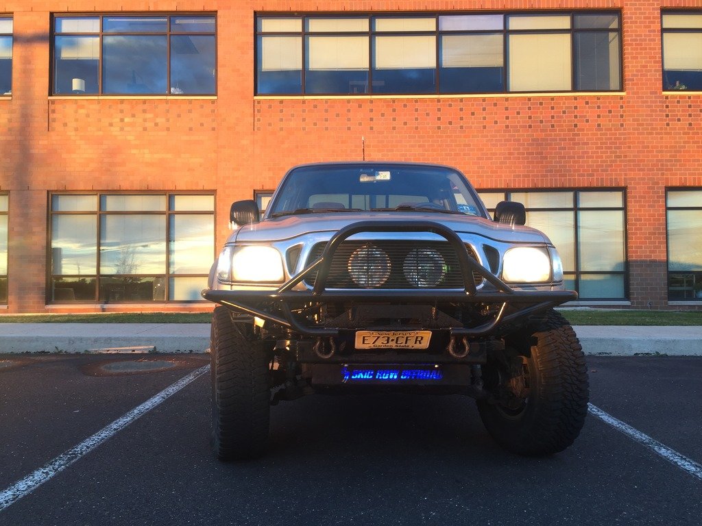

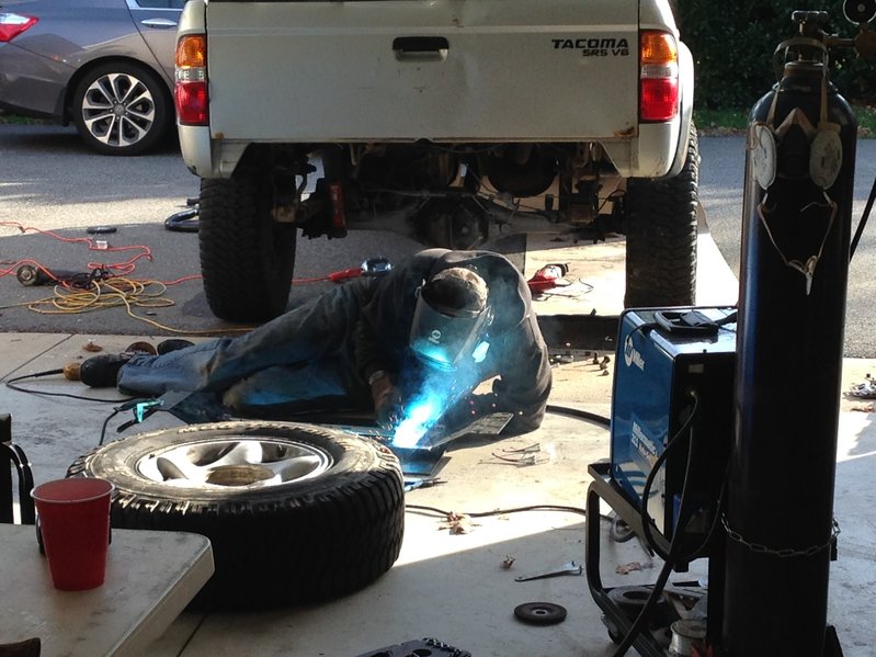

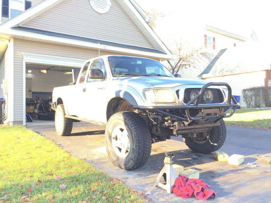

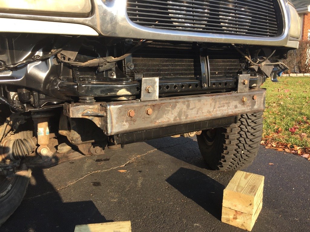

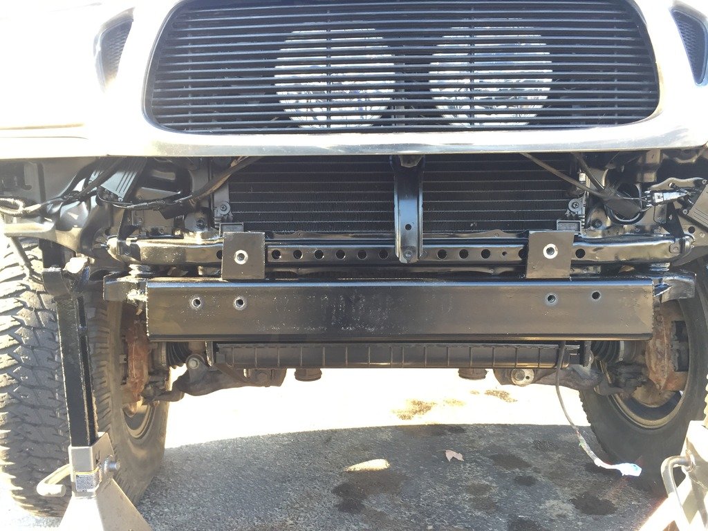

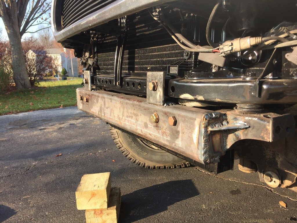

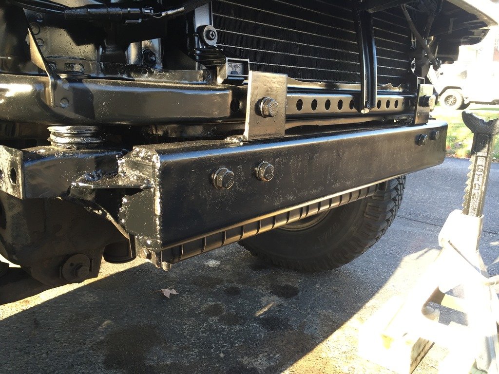

    Better shots of the front crossmember:
    Painting:
    Back on:

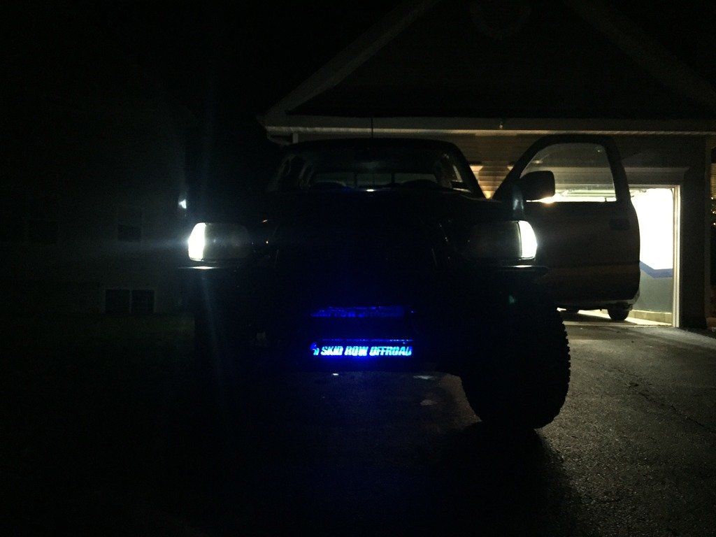

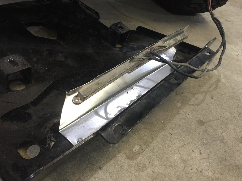

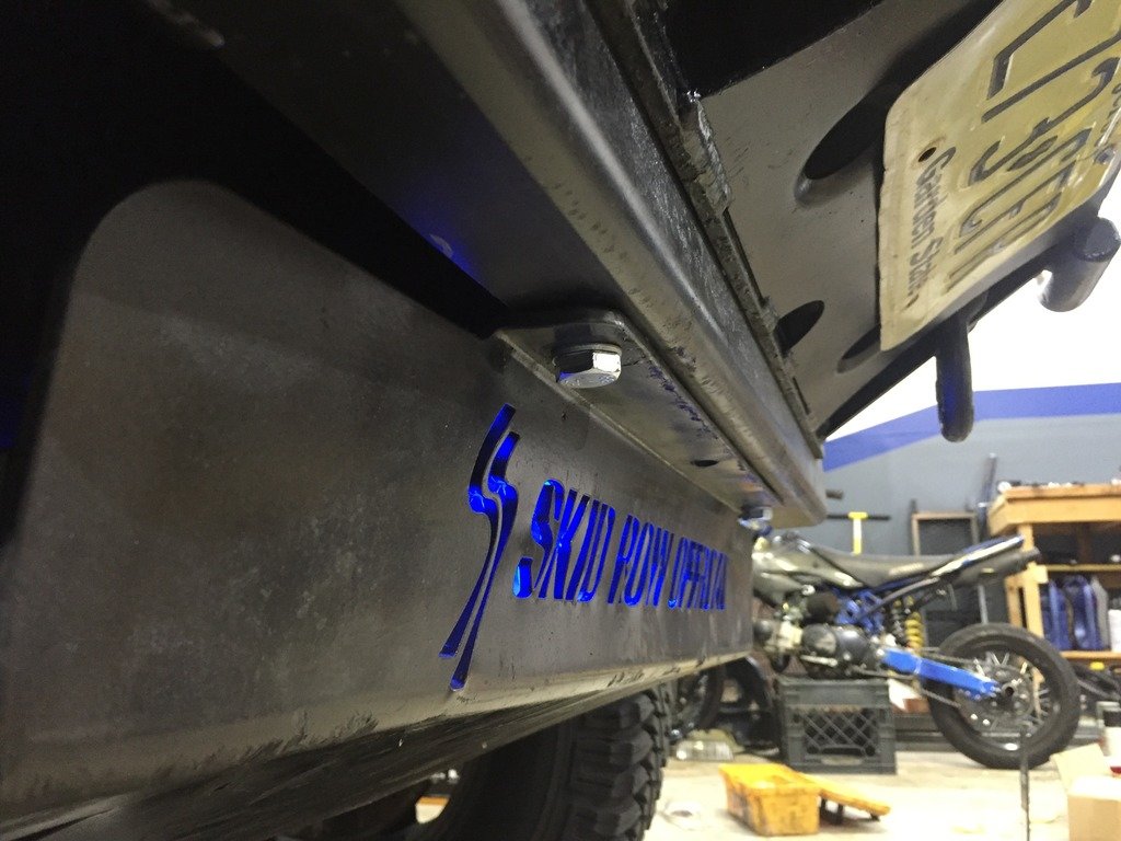

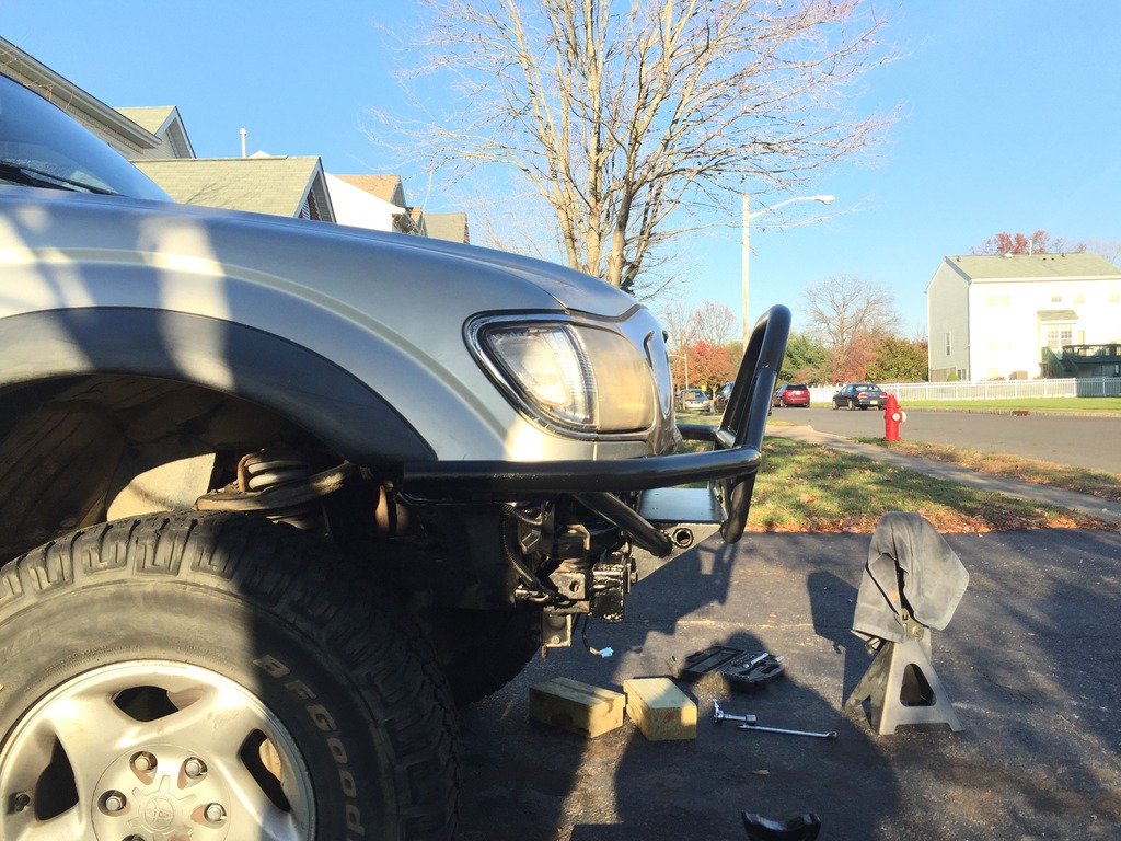

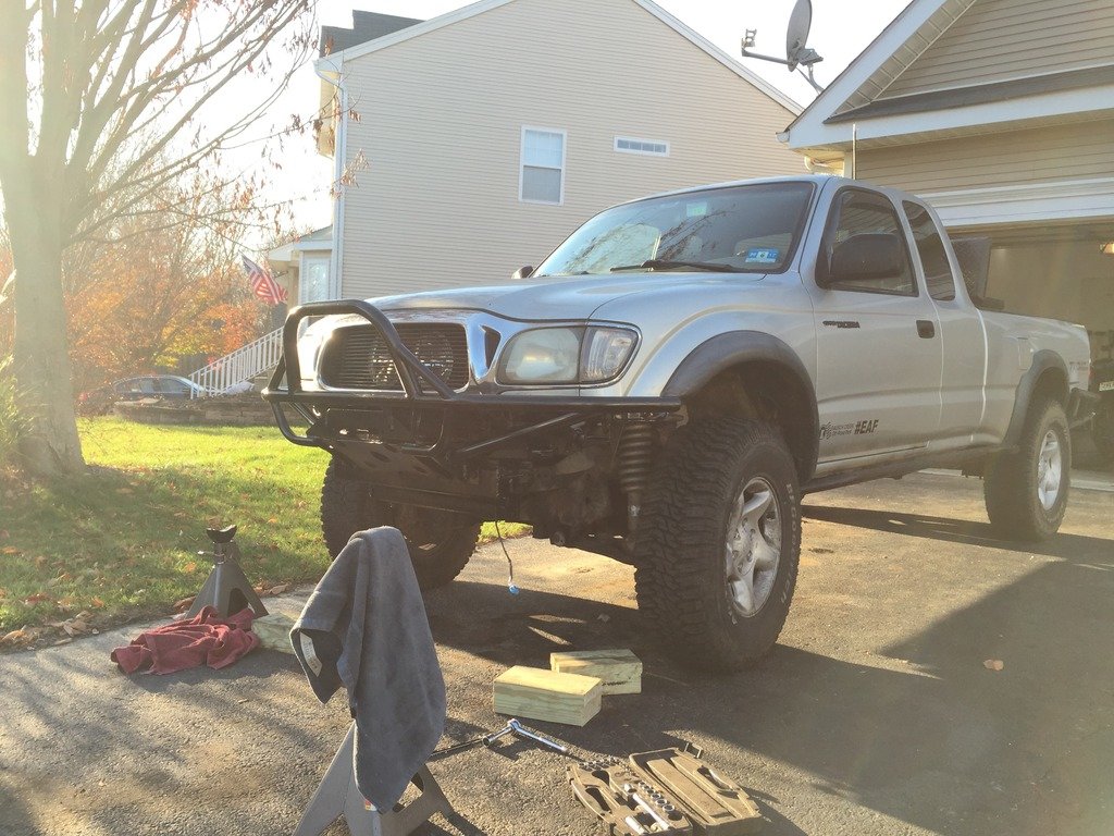

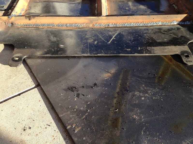

    Got the IFS skid back on kinda. Need to find a way to hold the center nut in place, can't get a wrench in there to hold it and cant tack weld it anymore either. Was thinking quick steel.
    Also might need to re-drill new holes for the rear mount or maybe work with BPF on new mounts. I kind of have a lot on his plate still for him to do so I may just drill for now.

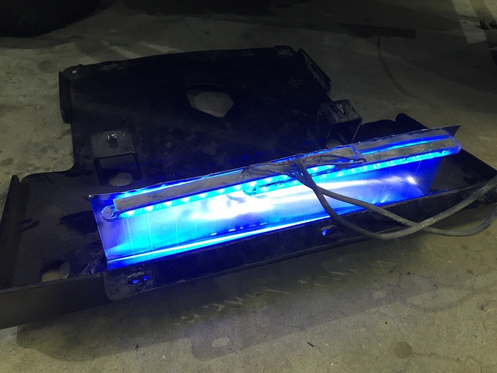

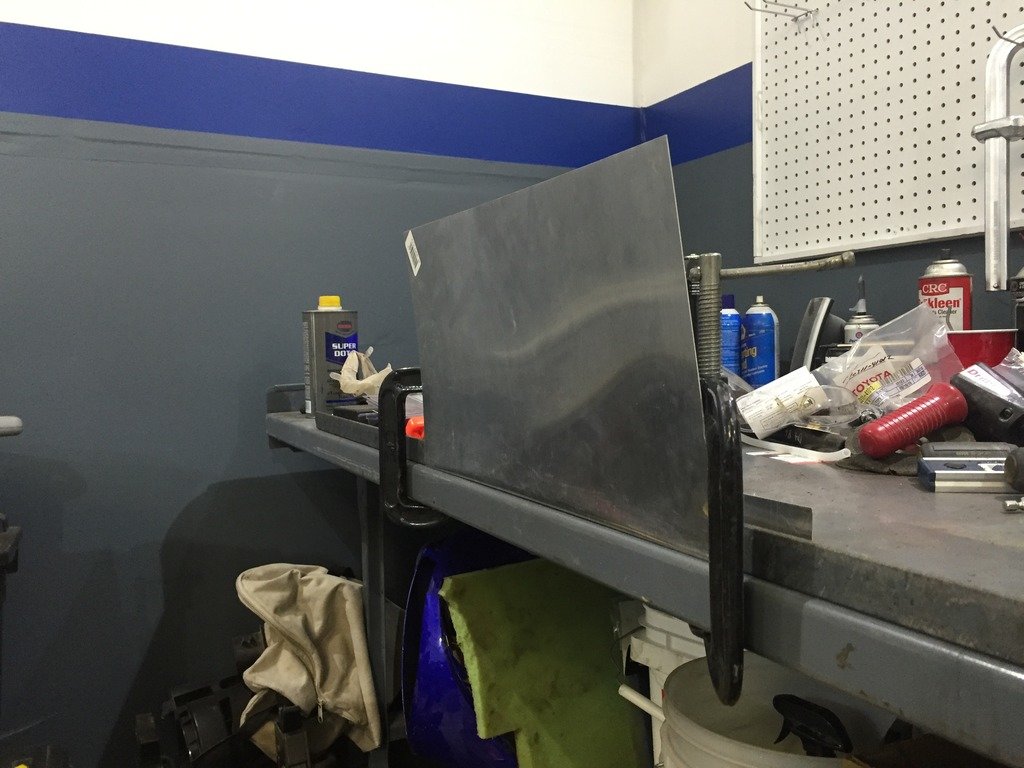

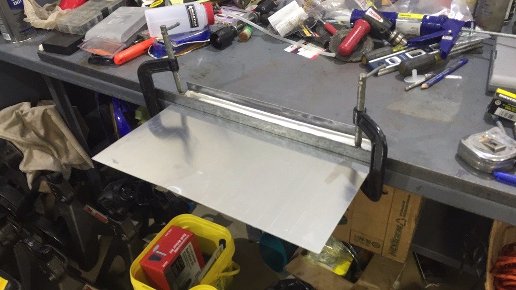

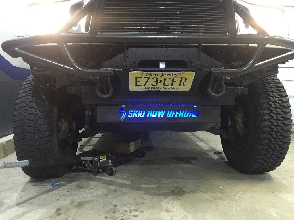

    Also re-did the blue light behind the skid to use a SS reflector I made. Made a super ghetto brake to bend it up ha.

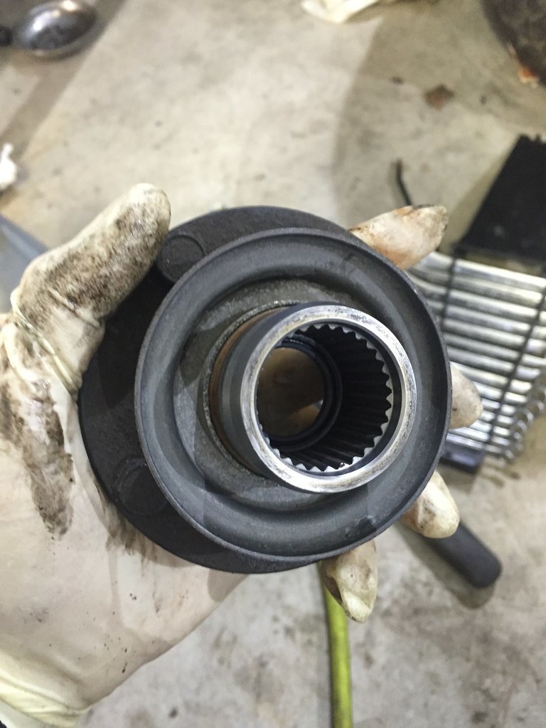

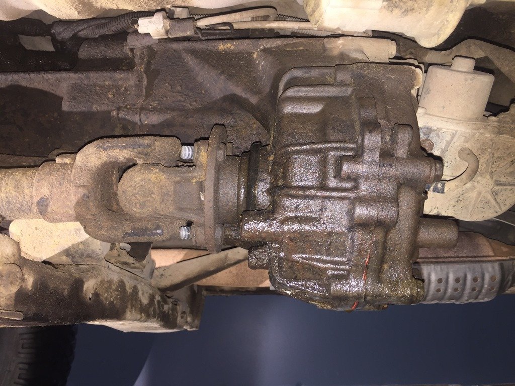

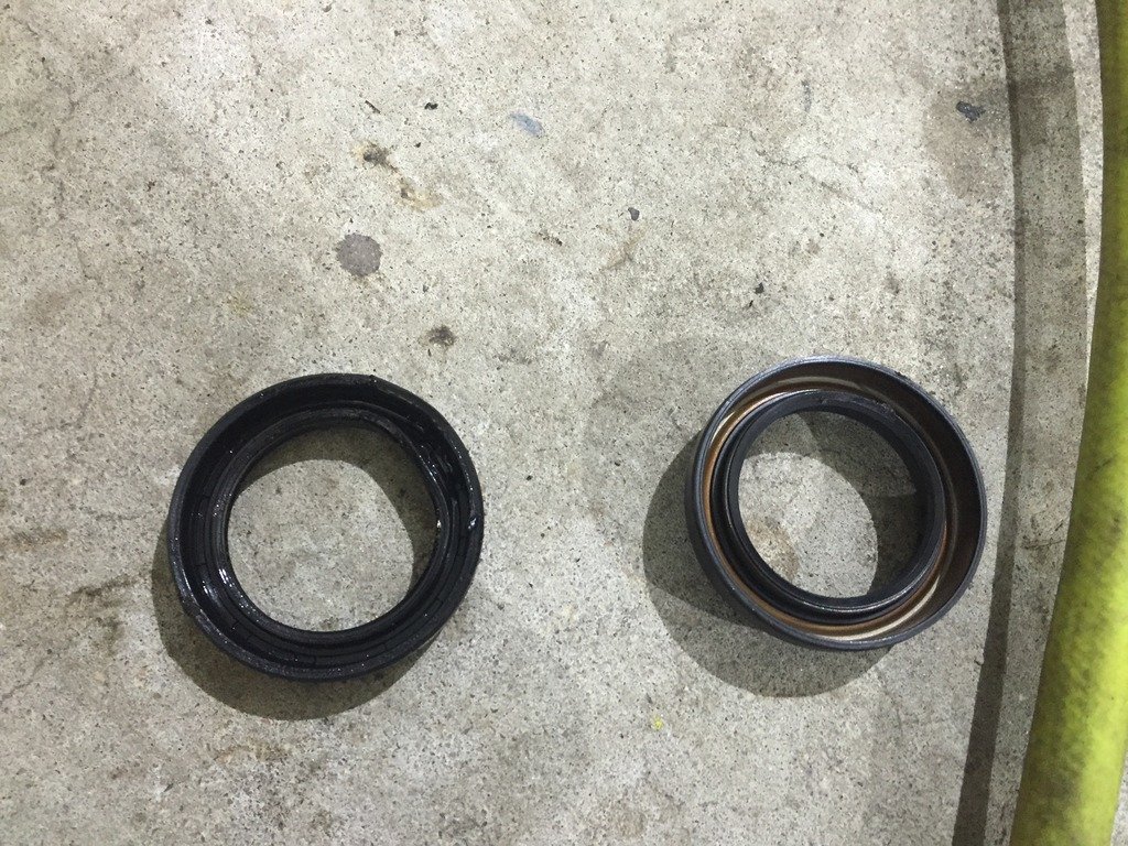

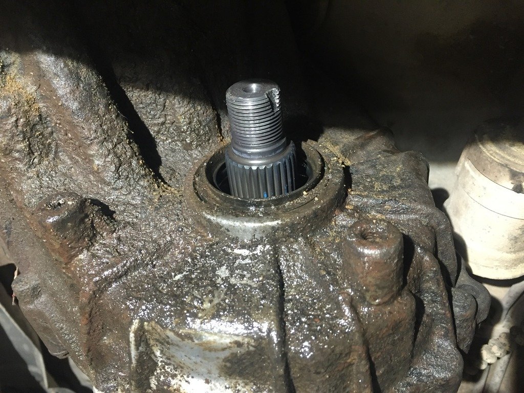

    Welp finally fixed my leaky front driveshaft. Used as my guide. He stated that the toughest part was going to be unstaking the 30 MM nut and he was right. Shit was a bitch and a half with the crossmember right in my way.
    Leak symptoms:
    In order to collapse the drive shaft you gotta take the grease fitting off and squeeze the shit out like toothpaste.
    So sand. Much oil. Wow.
    Old vs new:
    Cleaned up the companion flange real nice. The outer seal was dry as a bone so I left it alone even though I bought it just in case.

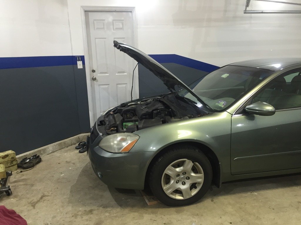

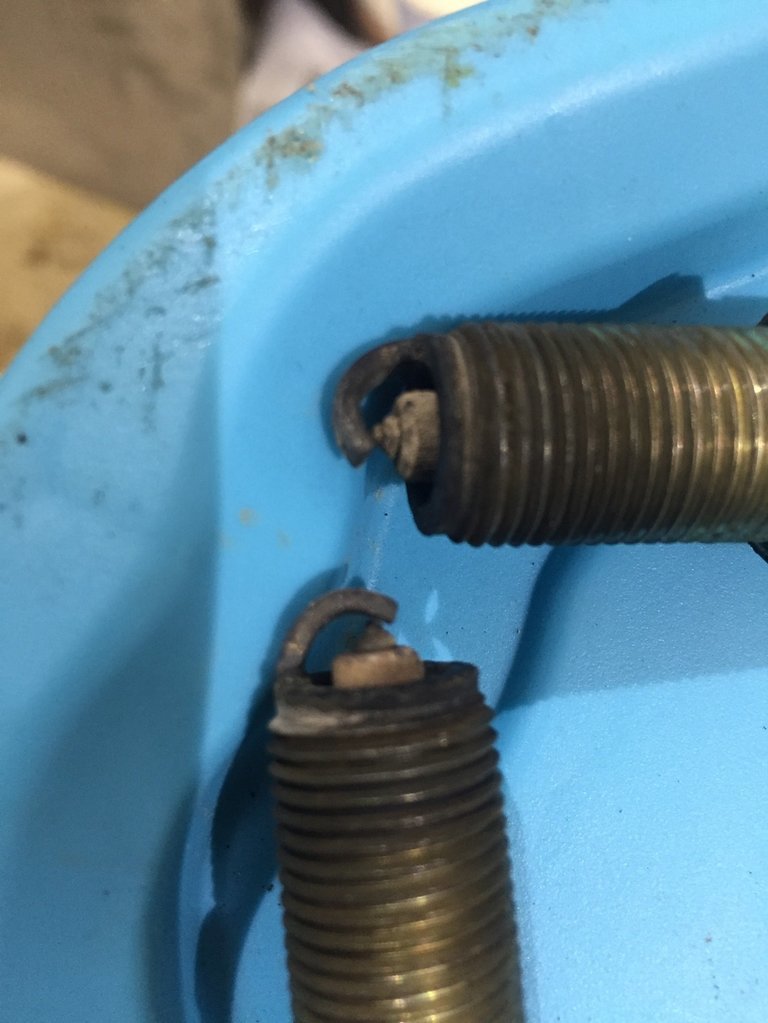

    Mid way through my wife came home telling me her car was bucking. It was idling very rough as well. The last time this happened it was an ignition coil so I thought it was that but it turned out to be the plugs. There definitely is a larger issue I need to figure out, current theory is that deposits destroyed the plugs.

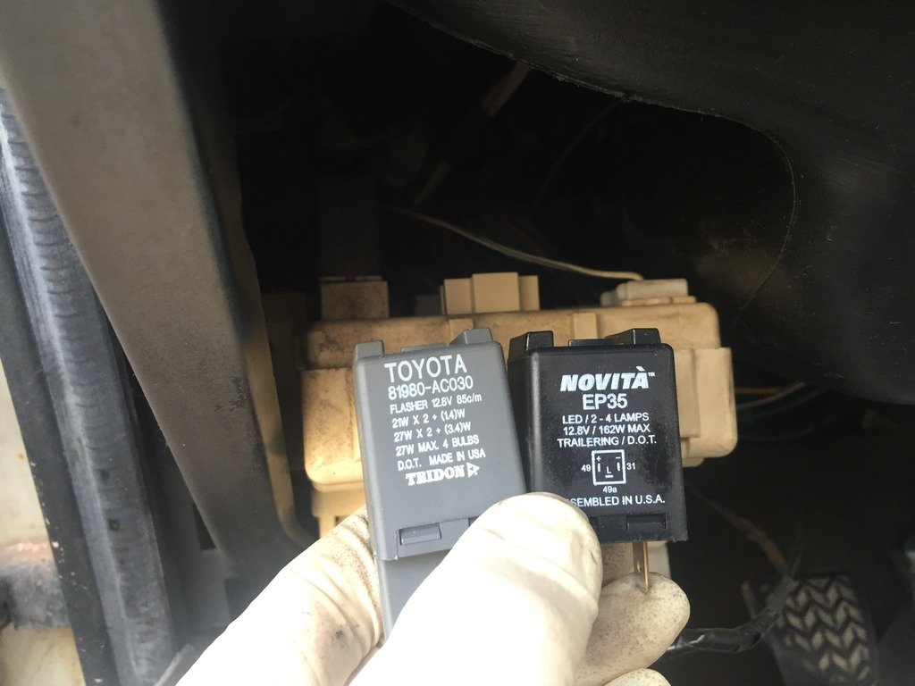

    Sooo I was taking advantage of the glorious weather we were getting in December last weekend to get some painting/mods done. First up was getting rid of the really annoying fast blink on the turn signals since I installed LED's.
    Super easy relay swap that took maybe 20 minutes. Hardest part was removing the rear bolt to get the fusebox out.

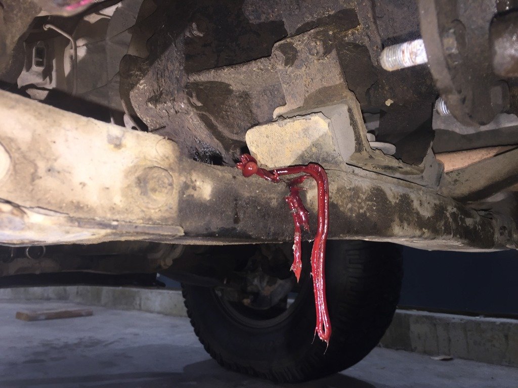

    Bright side is I went to Toyota of Langhorne this week and had them inspect the frame. They gave me this to drive in the mean time:
    Many cupholders. Such tampon holder. Crushing disappointment slush box. Wow.
    Got a call from them saying the frame will be replaced! Fuck yeah! So now I'll be tearing all my shit off and prepping for it to get the frame replaced. I really want to make it as easy as possible for them. Talked to the two techs who do the work and they showed me a 2nd gen in progress. Was great talking to him, expressing my concerns, and letting him know of all the prep I'll do for them. I'll use the opportunity to re-strip and paint my sliders, touch up the rear bumper and re-work some electrical shit on it. Signed a release and took the truck back in order to do all the work. I am bummed all the work @PSU Taco85 had helped me with needs to be re-done now but I am going to try to salvage as much as I possibly can. I really am happy I am getting a new frame though which will solve my seized LCA bolt issue and knowing I'll be able to start from scratch on a frame and keep it as good as possible for as long as possible.

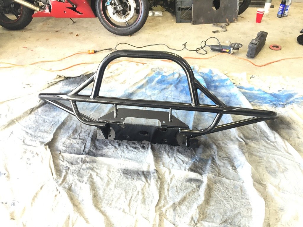

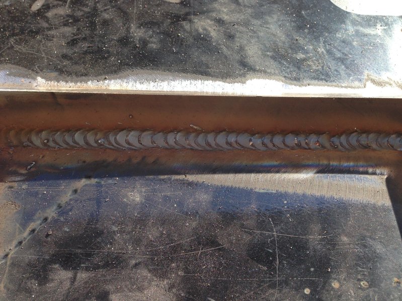

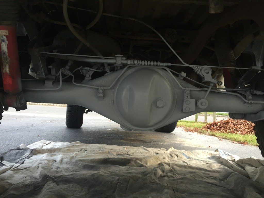

    Since I still had a nice day to work with I prepped and primed the rear diff with some weld thru primer in preparation for another appt at BPF to mount my diff armor.

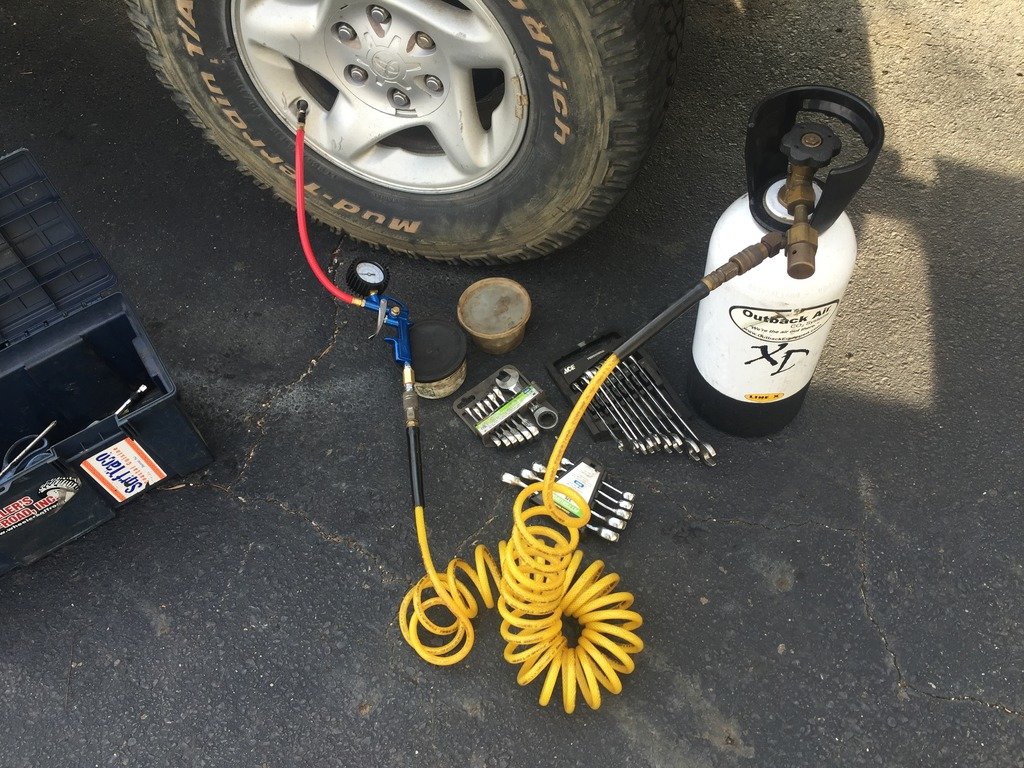

    And got an air chuck/gauge from Amazon to finish my CO2 setup.

    I have a couple PC places really close to me. It's very tempting to have them do both bumpers while I wait. I rather have that than anything. This is how I got the slidah's looking when I got them last time:
