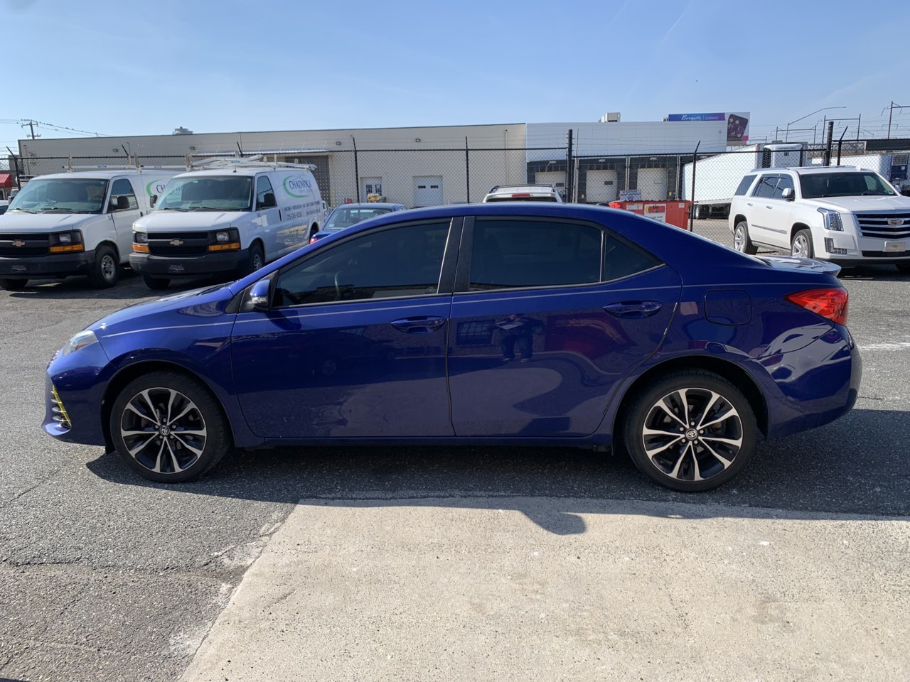

    No more fish bowl for the DD. Hoping it makes it easier on my son in the back now that the sun stays low ish all day in the winter.
    I’ll probably use the same guy for the truck. His dad does upholstery and will fix my rsx seat for a reasonable price.

    I use this in the Tundra because poor dude was getting fucking wrecked by the sun even with tint. If you apply it properly (windex, apply film, squeegee) then it's on there good enough that you can still roll the window up and down. The best part is that it's static cling so no worry about adhesive residue or anything.
    https://www.amazon.com/gp/product/B00UTZCHUW?ie=UTF8
    And I use this on the rear window because I want to be able to easily remove it when I tow for better visibility. Also static cling, also great at blocking the sun. Easy to transfer between vehicles if necessary.
    https://www.amazon.com/gp/product/B08RSB2FHW?ie=UTF8

    To be honest I would be really surprised if he still has issues after this. The difference was night and day. Good to have in my back pocket if it doesn't though. :thumbsup:
