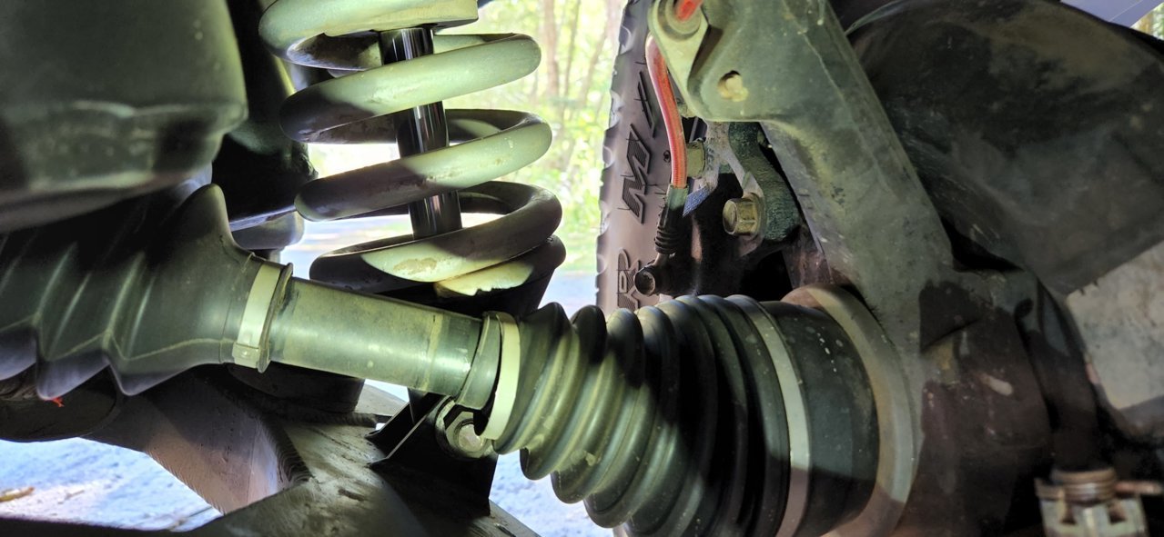

    @TMFF I think I need to order those misalignments from you soon. I thought by getting rid of my hose clamp style clamps this would fix this but it seems to keep happening.
    Though maybe it's a combo of the boots not having enough travel and these shocks? Never happened on my 5100's with the boot slide mod but I also never mobbed the truck the way I do now either.
    My go to combo on anything I rebuilt was using OEM outers, and SDHQ inners with the boot slide mod.
    https://sdhqoffroad.com/products/sdhq-built-direct-replacement-cv-boot-kits?variant=12249935740963
    But now I am not so sure. Tearing the boot at the end has become a pretty common occurrence lately though.

    Do you think you're rubbing the boot on the coil - is that why the misalignments (to move the coil away from the boot just a touch)?
    I wonder if you're drooping too much (over-stretching the boot), and perhaps limit straps are in order. Edit: I don't know if you really can over-stretch the boot at full droop, so this could be totally dumb.

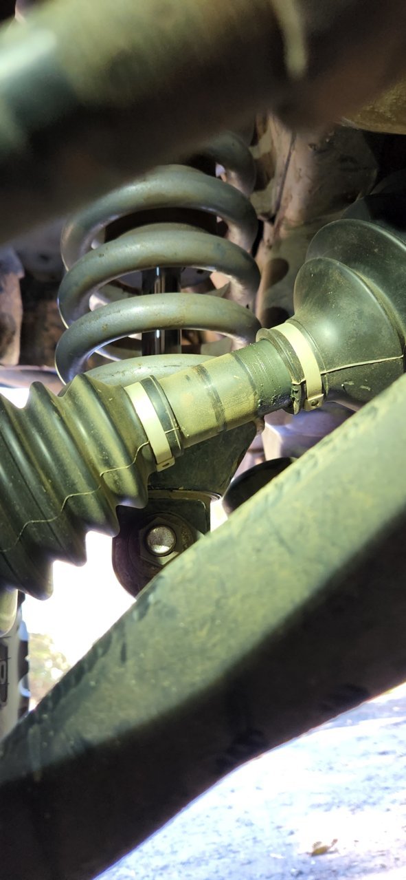

    Less rubbing, more slamming like in this other failure:
    [​IMG]Untitled by Michael Halat, on Flickr
    You can even see the chunk of bare metal on the coilover. But that was when i still had the hose style clamps on there. I assumed when I switched back to the standard clamp this issue would be resolved. And I mean I guess anything is possible? When I do the boot slide mod it's stretching the boot about a half inch, and being fastened to the shaft while the other side of the boot goes to the cup for the tulip. The cup stays in one spot as the shaft moves in and out. Maybe I just eliminate the boot slide mod?
    I remember when I had Tyler build these shocks I asked him for the most travel the truck was capable of. I ended up taking full droop and full compression measurements to the point where the CV's would bind. After I gave him my measurements IIRC he gave me what their standard first gen setup was because the measurements were close to that already. He always told me that if I ran limit straps it would negate the "top out protection" built into the shocks and he did not recommend it.

    Oh wow, I couldn't see that chunk in the last photo - that's crazy. Wonder why you're running into that and others (well, me, hahaha) aren't. The rest of this probably doesn't apply given your situation, but since it's the internets, I'll say it anyway ;).
    I wonder what Tyler was talking about when he mentioned "top out protection" built into the shocks - when I took mine apart, there doesn't seem to be any "protection" there. All the parts are solid metal. Regardless, I put the straps on to protect the shock tower (see this post where I diagram out the forces), after Mike @Digiratus blew his up (he and I believe, from having the shock itself act as the droop limiter).
    Insides of my shock (a rear, but the front internals were mostly the same): (more photos of the internals)
    Here's the internals of the front coilover, all on the shaft:

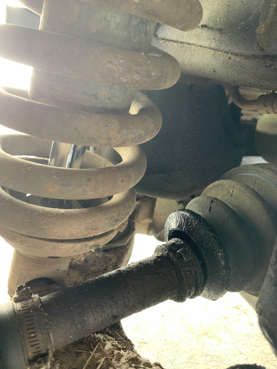

    This is apparently an issue with 1st gens and 2.5 CO's. I thought only with fox's, but I guess ADS as well.
    You are the only other person I've seen talk about it online.
    for me it's not the boot that hits, but the shaft itself. Not sure where in the travel it contact, but you can see where it does on the shaft of my CV's. I believe it actually popped off the clamp on passenger side CV on my new RCV's. They have their boot stretched out on the shaft a bit more than stock.
    I called accutune (where I got my CO's from) and talked to Ryan about it. He said that they have seen this before and that both they and fox are aware it's an issue. Long story short, there isn't a solution to fix it. Fox did have a redesign on the lower coil perch in 2020, but the problem is still there. And from my understanding, the misalignments already put the coilover as far forward as possible in the lower mount. I also have the Solo LCA's so you would think that would give you more clearance between the CV and the CO with it putting the LBJ further forward.
    I've wheeled my truck like this for quite some time now and haven't broken anything because of the contact, so I guess that's what I'll continue to do since there's nothing I can do about it.
    If I were you, I'd get rid of the boot slide mod and see if that helps with it at all.

    Yeah basically there is supposed to be a spring that when the shocks reach full droop (with force) it compresses another 1/4", pushing back on the piston (I think?). It has been discussed in here a couple times a long time ago when I first got the shocks. And the other theory is that this spring when I am at full droop is always robbing me of around 1/2" of travel at the wheel in slow droop situations because that spring has enough force to keep the shaft from being fully drooped out unless it's got some force going against it that's more than the weight of the tire statically hanging.
    Yeah unfortunately all my spare CV's have been rebuilt with the boot slide mod incorporated, but when I swap this one I will rebuild this one without the boot slide mod. Worth a shot to get the misalignments to get more space either way since it won't negatively hurt anything either. Might as well service those spherical bearings while I am there anyway.
    We definitely aren't the only ones who dealt with it though, seen other threads discuss similar issues but mostly revolving around using the wrong type of clamps.
