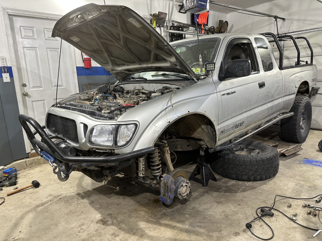

    Been doing stuff and things.
    took it to the pines one last time for a while with the kiddo. Rode my bike while he rode his and @JLink and the fam joined up a bit too.
    Not it’s under the knife for some much needed maintenance.

    I wanted to write down a list of all the shit I'm addressing while the truck is down for my mental clarity.
    Starting at the motor:
    Replacing valve cover gaskets, half moons, and cam seals, and plug seals.
    Replacing injectors
    Replacing FPR
    Replacing fuel line under the plenum
    Replacing the coolant hoses under the plenum
    Replacing 3 coils and new wires
    Replacing the spark plugs
    Replacing pcv valve
    Replacing all vacuum lines with the silicone kit I have had for 3+ years now
    Clean MAF
    Clean throttle body
    Clean plenums
    Outside of that at the motor:
    Replacing the AC idler AGAIN. Got an OEM unit this time.
    Bang and smash the skids for reinstallation. (Going to start planning my tube skid concept too)
    Swap the fluid in the front diff with all the pines trips lately.
    Suspension:
    Grease UCA's and upper ball joint.
    Check tolerances at LBJ's
    Replace misalignments on the lower coilover mounts to push them further from the CV's
    Replace the drivers side CV with the boot that's been torn since Takeover in July.
    Reboot and rebuild the removed CV.
    Misc:
    Figure out why the reverse lights have been intermittent. Going to start at the switch on the case since I just had that off when the transmission was out. Then check under the seat since I tapped into that for the reverse cam not to long ago.
    Rotate tires
    Touch up armor
    Touch up wheel paint
    Swap clutch spring and bushings
    Fluid film the frame after painting is done.
    Hopefully that's it? :rofl:

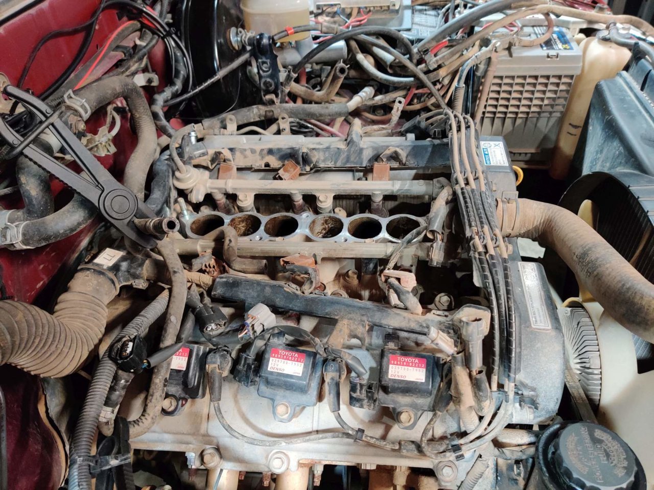

    Probably 8+ hours in at this point with 6 being just cleaning the motor.
    Started like this:
    [​IMG]Untitled by Michael Halat, on Flickr
    And got it looking like this:
    At this point the valley is as good as it's going to get and the area around the lips of the valve covers are clean enough to remove them soon. I noticed when cleaning that some liquid MAY have seeped past the injectors so I plan on hitting the valley with electronic cleaner again, and then removing and cleaning each injector and port one at a time. While they are out I'll vacuum out anything that may have fallen in, and then slap these injectors back in until the valve cover gaskets are swapped and back on. Then I can rebuild the fuel system in what should now be an extremely clean environment.
    Thankfully this truck isn't my DD and I work remote so there isn't much rush to get this job done minus trying to give my wife a warm garage to park in. Hoping to be done by end of January the latest.
    Oh and the ironic part is that my potential cylinder 3 misfire was from a loose electrical plug on the coil. But I also got pretty drunk cleaning the one night so I couldn't remember if I had loosened that connection or not.

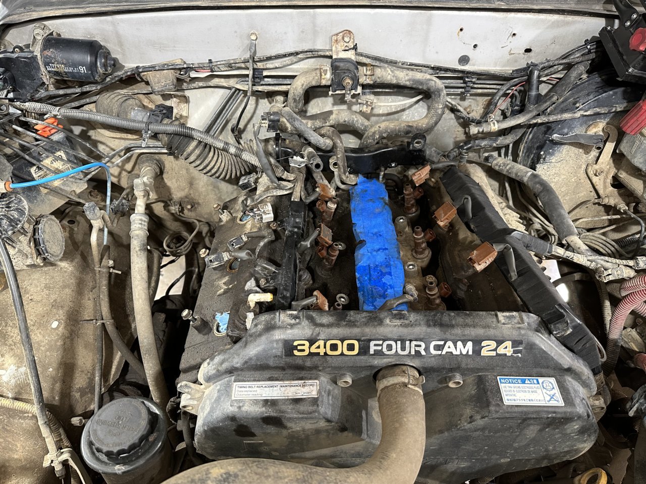

    2002 XtraCab TRD 4x4 SCv6 AutoTrans With Lots of Mods ADS COs w/Compression Adjusters Camburg Uniball UCAs Whiteline Lower Control Arm Bushings Kartek 7" Limit Straps Plastics Guy Front Bumpstops Total Chaos Sprindle Gussets Custom Alcan Springs +800 lbs +3" ADS 10" Stroke Triple Bypass w/Resi Rear Shocks Custom Rear Shock Relocate All-Pro U-bolt Flip w/Timbren Bumpstops 4.88 Nitro Gears ARB Front Locker ARB Twin Compressor Black 17x8 Konig Countersteer Type X 285/70r17 Falken A/T3w Gunmetal 16x8 SCS Ray10s 255/85r16 Maxxis Bighorns Limited Edition (Relentless) Elite Front Bumper Smittybilt X2O 10K Winch Diode Dynamics SS3 Sport Selective Yellow Fog Lights in the Bumper Diode Dynamics SS3 Pro 4,000 Kelvin SAE Driving Lights with Clear Lenses on the Bumper Morimoto D2S Projectors XB35 Ballasts + 4300K Bulbs Badland Sliders FrankenFab Tire Carrier Swingout bumper w/kitchen BudBuilt Front & Bellypan Skids BAMF Rear Diff Skid Dometic CFX 55im Fridge/Freezer Alpha II Hardshell RTT Badland Custom Bed Rack Denso 210-0461 105 amp alternator Dual Northstar 24F AGM batteries BlueSea 7622 ML-ACR Battery controller Peak DBI Dual Battery Voltage Monitor Haltech IC-7 Display with Mako Dash Insert Haltech Elite 2500 Standalone ECU Magnuson MP62 Supercharger w/URD 2.2" Pulley Doug Thorley Headers Denso 650cc Fuel Injectors Aeromotive Stealth 340 Fuel Pump TransGo A340F Reprogramming Shift Kit OEM ECU Delete Full A340F Trans Control with the Haltech 2500 ECU 2.5" Magnaflow Hi-Flow CAT Magnaflow 18" Muffler w/Vibrant Resonator 13WL Brake Calipers with OEM Rotors & Pads Braided Steel Brake Lines Kenwood TM-71A Dual Band Ham Radio STI-CO Flex Whip VFH/UHF 1/4 Wave Antenna Midland MTX275 GMRS Radio w/Roof Mount Antenna Pioneer DEH-P9400BH HU Alpine Amps & Type R components (F) and coaxials (R) Wet Okole Seat Covers Weathertech Digital Liners Deck Plate Mod 1" Diff Drop Carrier Bearing Drop
    Mine did not have near the oil residue that Mike's does. It was mostly dirt and mud on mine. :rofl:
    Before:
    After cleaning:
    Speedytech7[QUOTED] likes this.

    Yeah, mine has fairly new valve cover gaskets because the originals had started to make a mess.
    I see that your harnesses are wrapped in tape. Is that so they don't fall apart?

    Yeah I was warned that they get really brittle and fall apart. Mine actually were in pretty decent shape but might as well wrap them up nice and tidy anyway.
    I was going to plastic staple the mounting tabs back together but honestly I like @1997tacomav6 's solution on the NAPA clamps more:
    https://www.tacomaworld.com/threads...-4-v6-damaged-wiring-harness-solution.576633/
    Shout out to @ToyRyd04 for letting me know about all this shit since he's been researching the project and going to do it soon too. We've been texting back and forth on the shit I am running into that he may or may not need to deal with too when he digs into his.

    Alright well this is taking me FAR longer to even get the valve covers off than I expected, but mostly that is because I have been extremely anal with cleanliness. Because of how aggressively I had to clean the valley at the top of the motor I knew that the seals/injector ports was going to end up having gunk around where the injectors seat. The injectors did a great job keeping the majority of water and grime out of the valves/cylinders but the ports still needed cleaning themselves. After discussions with @Speedytech7 in the first gen thread and @ToyRyd04 over a bunch of texts it seemed the best way was to pull the plugs and manually crank each cylinder to the top of the stroke and clean each injector port one at a time. While I did this I used the opportunity to clean any carbon build up (barely any) near the valves themselves.
    The process was as follows:
    Manually turn the crank for whatever the target cylinder was and use the plug hole to figure out the piston position.
    Remove the injector and do a dry wiping/clean of the injector port.
    Open up the intake hole for that cylinder and shop vac the intake while simultaneously using my air attachment on the compressor to block the injector port and force air into the valves.
    Spray starting fluid into the injector port and intake and wipe away whatever carbon deposits/grime that could not be reached when doing the process dry.
    Vacuum/force air again to remove the starting fluid that pooled on the valves.
    Wipe the intake again as it has now brought dirty starting fluid back onto the walls if that intake.
    Clean injector and put back in/cover that intake hole with a towel and move onto the next one.
    Do that to all cylinders and do one final vacuum from the spark plug hole for anything that may have dropped into the cylinder, but really nothing should have.
    This shows how grimey the injector ports were:
    And clean:
    My cleaning method that worked extremely well:
    You can see the valves look really good considering the mileage.
    THis was the condition of the plugs:
    Unknown mileage. I never replaced them in the 10+ years, 100k I've owned the truck.
    The next time in the garage I'll finally be pulling the covers off.
