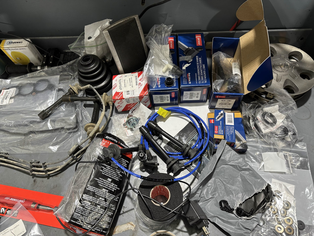

    It's less Tacoma and more mod
    Those plugs were done haha, thats a huge gap even for this engine
    slander likes this.
  2. Jan 6, 2023 at 6:42 AM
    #2322

    Jesus maybe you found the misfire LOL
  4. Jan 6, 2023 at 7:02 AM
    #2324
    Speedytech7
    Feb 20, 2014
    #123587
    58,231
    FCQM+VG Cheney, Washington
    Was he chasing a misfire? I'd absolutely believe any one of those could be too far gone to spark, that's a testament to how long these engines can run without maint. The dual electrode plugs certainly did their job if they made it over 100k

    I thought he said he was. Either way it shows why I only toss OEM parts at my Toyotas, yea you pay extra but they last forever!

    I'd make a little side bet that #3 was the one with the main misfire, and maybe its companion cylinder because it's wasted spark. But #3 has a perfect vertical carbon track up the ceramic insulator... he needs to replace wires and coil boots too since the plugs started tracking.

    Ding ding ding, was cylinder 3. Part of why I wanted to track what plugs were what and making sure I actually found the culprit.
    Obviously new wires are going on, you can see the full list of shit a page back haha, it's a lot. What do you mean by tracking though?

    Gonna need three of these guys
    https://www.rockauto.com/en/moreinfo.php?pk=2194396&cc=1375343&pt=10150&jsn=12142
    and a new wire set too.
    Carbon tracking is what's left behind when the spark escapes from the insulator and the plasma burns the shit on the surface layer of the plug and boot (carbon tracking unfortunately is conductive and makes the misfires even worse as it burns the insulator and plug boot)

    Way ahead of you:
    https://www.tacomaworld.com/threads...01-build-thread.290011/page-116#post-28225077
    Thanks for the explanation/link :thumbsup: that's really interesting. I am interested to see how she runs after all is said and done.

    Oh cool, you got all new coils too. Save your old ones, they're good trail spares. I bet it'll be like a new truck, must've been pulling timing for ages with gaps like that.

    Yeah I heard the coils are good to have as spares and rarely fail. Figure I'll save the ones off 1 and 5 and toss the one off 3 just in case. Although there is probably a test I can do to verify it's working well and just replace the boot, but having 3 spare coils feels excessive.

    The coils are probably good still, I'd toss new boots on em and sell em or keep as spares. Running with excessive gap is hard on them but they'd have died already if they were gonna, toyota coils are pretty hearty. I keep a single coil pack and the longest coil wire (can reach any cyl necessary) as a trail spare. Just one of my originals with a new boot and a good used wire.

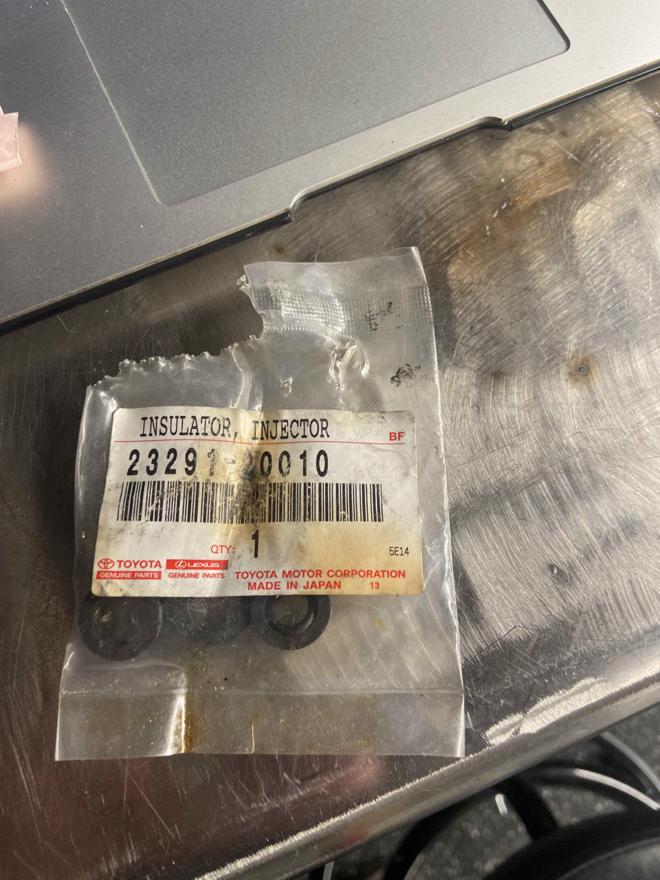

    If you need, I have 4 injector seals that I will never use if you want me to send down to you. I know they are like $4-5 each.

    I don't really NEED them since I have reman injectors from Motor West with new orings and seals but I have no problem hoarding spare parts. If you want you can put them with that cluster if you are still hanging onto that for me. :cheers:
