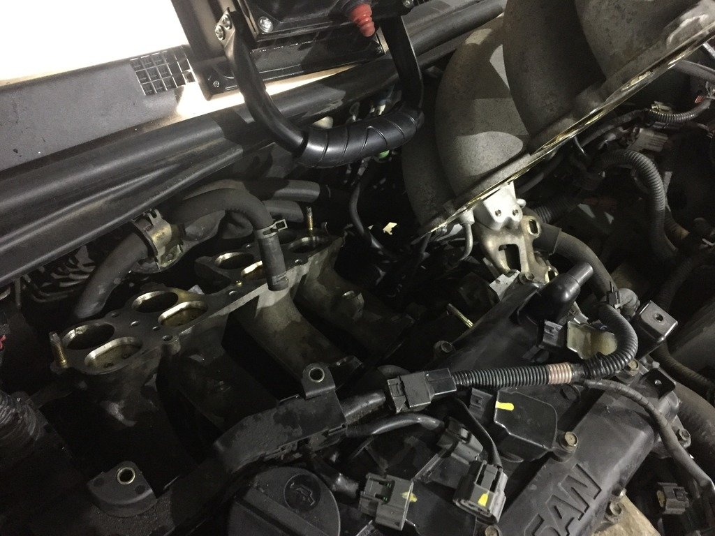

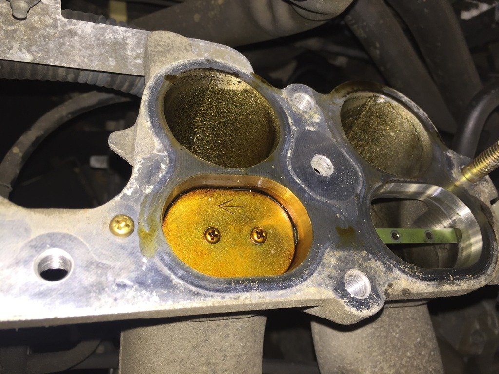

    First started digging into the wife's car
    based on the symptoms and the issue @ToyRyd04 pointed out that could have been the issue.

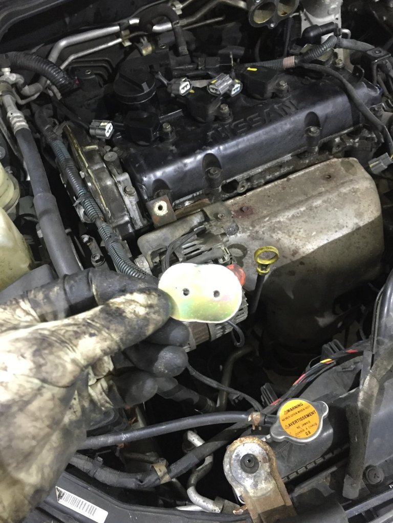

    Took off upper intake manifold to find the one power valve was missing:
    Fuck. So the plugs got bent up due to 2 screws bouncing around the cylinders. Wonderful. Hoping they got sucked out the exhaust valves. The this valve itself I knew had to still be in there though so I took the lower intake manifold off which also made me take off the fuel rail and smelled up the entire garage and house with gas.
    But I fucking got the bitch!
    Damn mess.
    Now I gotta order a new valve since this one's all bent up and take apart at least the upper intake manifold again next week.

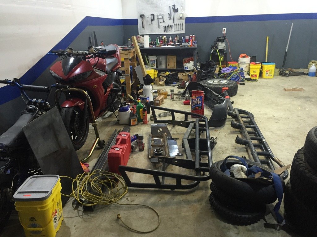

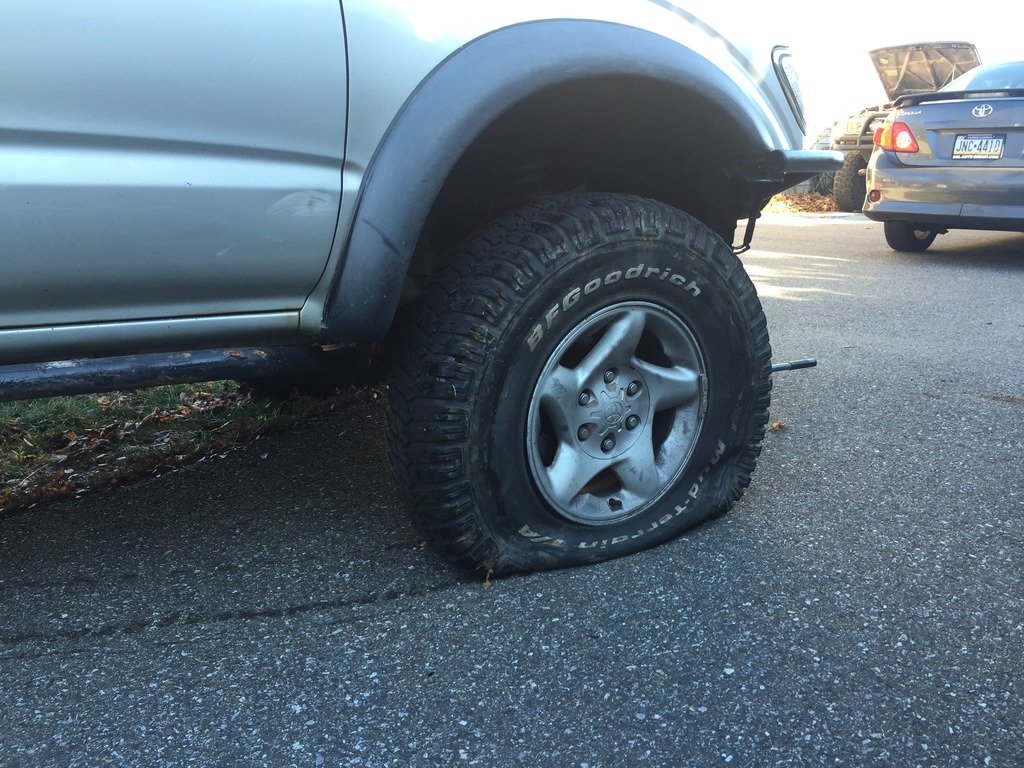

    Hungover as fuck the next day was spent fabbing and cutting. Woke up to a random flat:
    Started cutting the sliders off to prep for the new frame. I highly recommend the diablo carbide tipped blades for the sawzall. Used a combo of a grinder/sawzall to get it done.

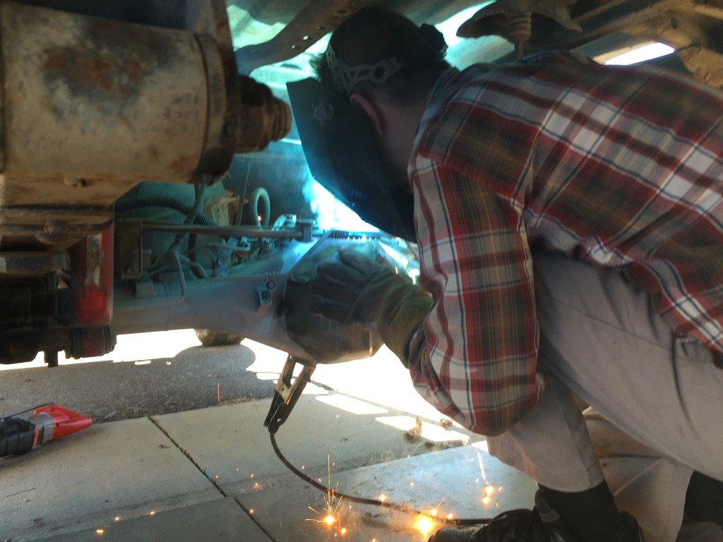

    Meanwhile Ant went to work welding on my diff armor and Q went and removed the rear bumpa:

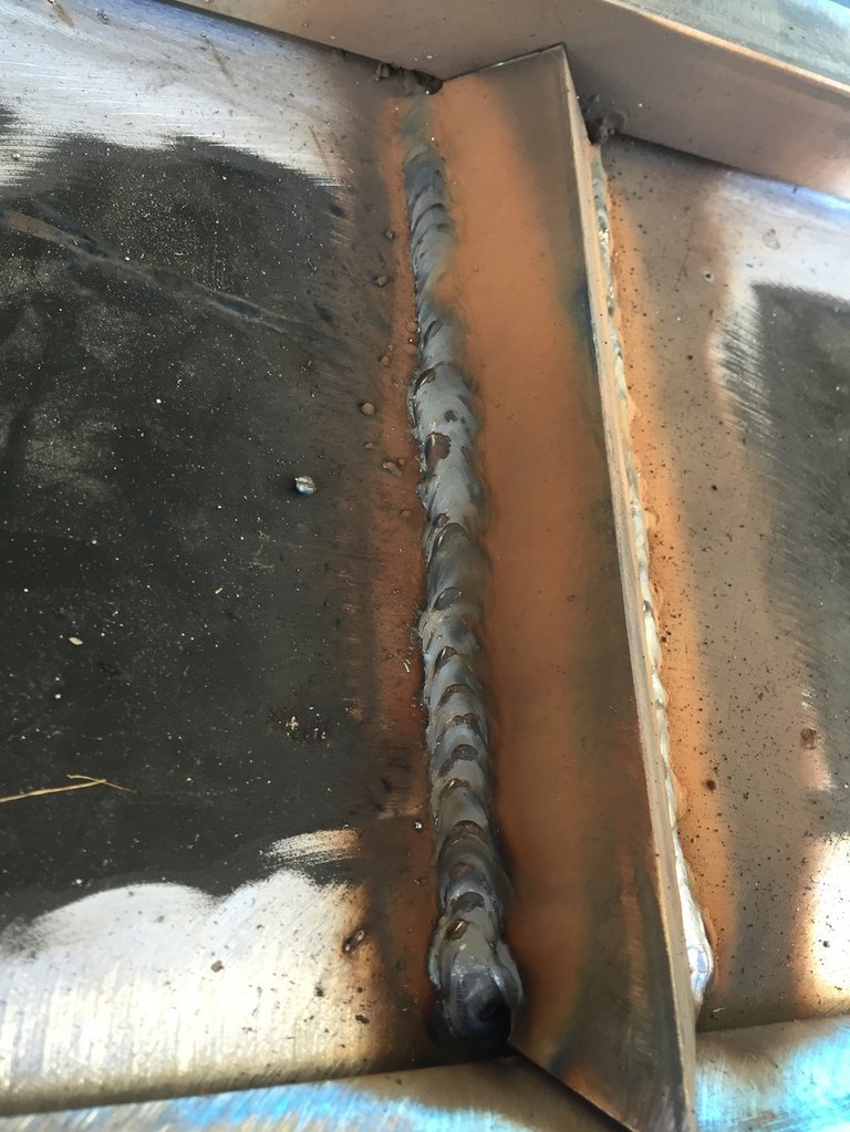

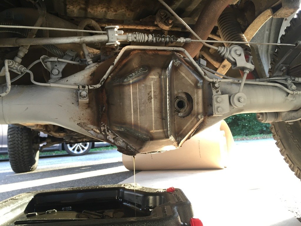

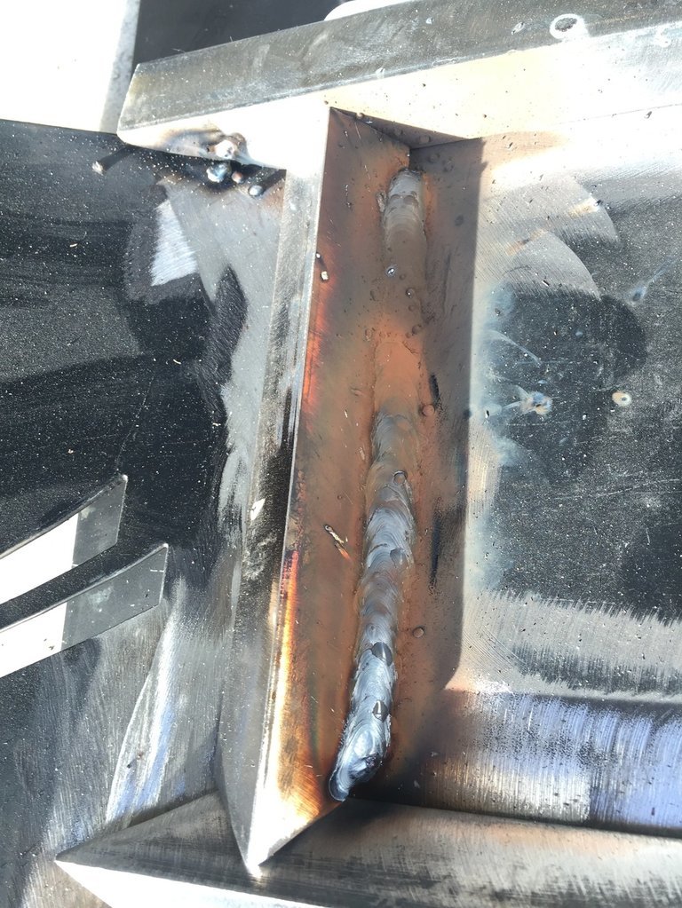

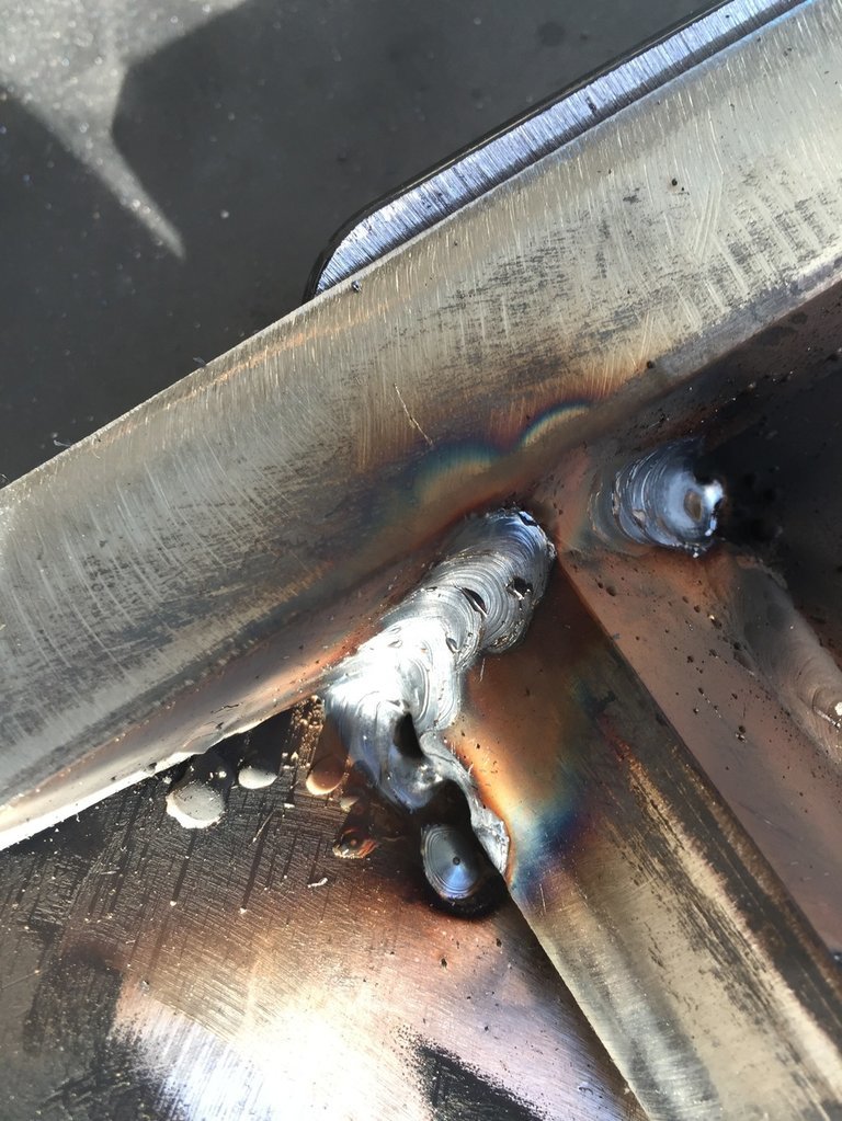

    He let me take a whack at welding the reinforcements to the t-case skid.
    First welds in ten years since I was in high school:
    Ant took over and finished up the welds on the rest of the skid so I could continue cutting.
    I highly recommend anyone with a skid row t case skid to do this. Mine bowed up so badly that it was rubbing the t-case and now has about an inch between the skid and t-case.
    Diff was drained and filled with fresh fluid:
    Half my armor off:
    Still gotta pull the tool box, front bumper, and front cross member.

    So much awesome! Nice beads too :thumbsup:

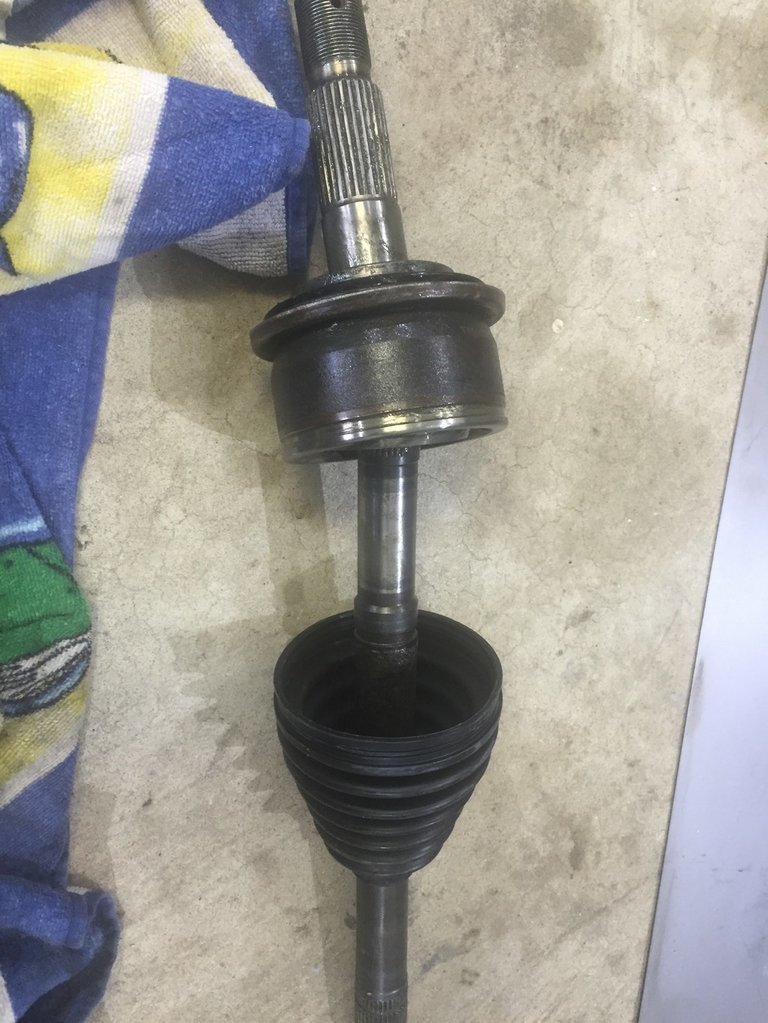

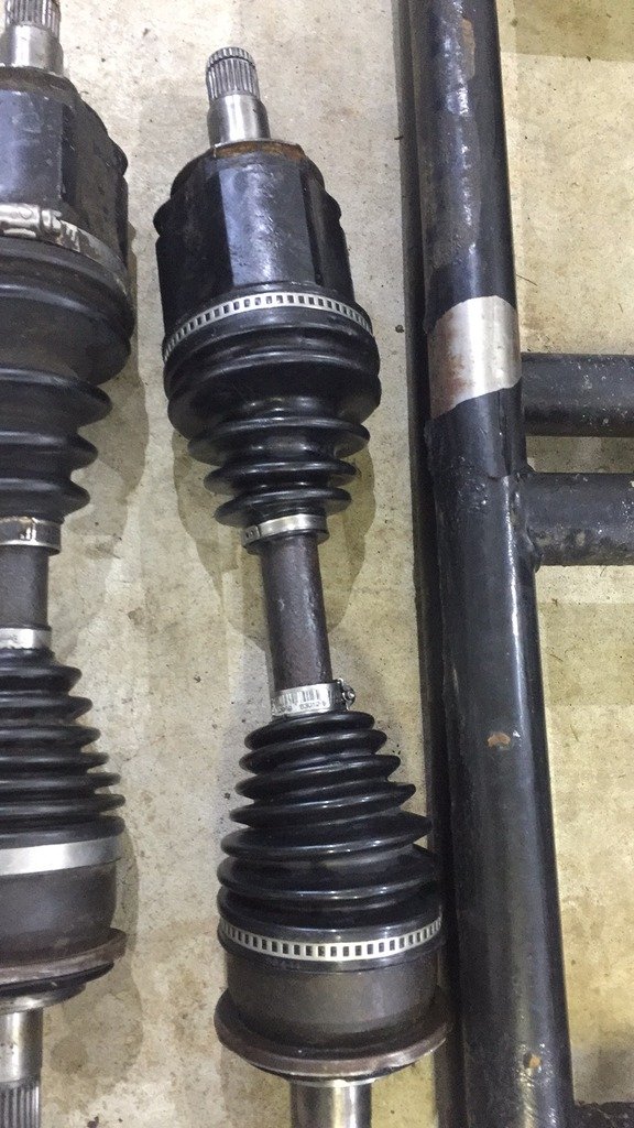

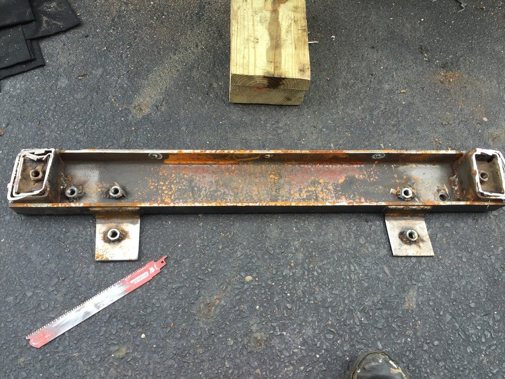

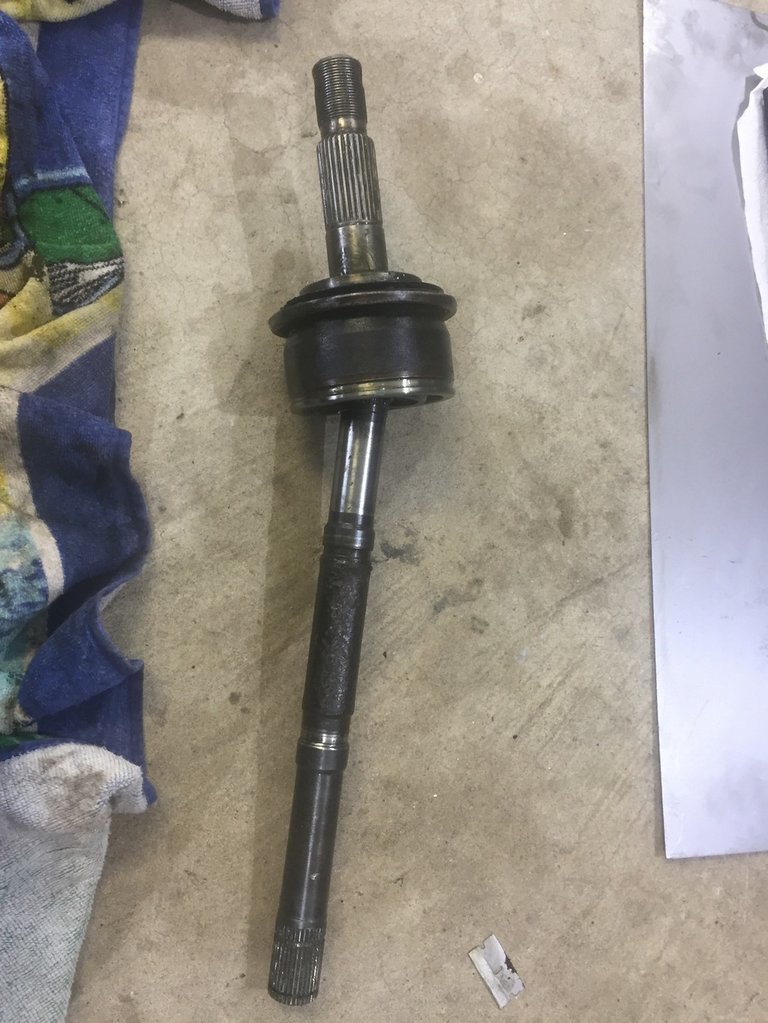

    So I finally finished stripping J0hnny5 for the frame swap. Gonna shoot over to Langhorne Toyota at lunch to drop it off. She's looking pretty damn sad right now.

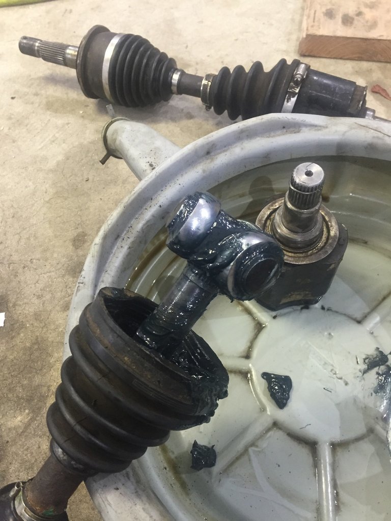

    Since both CV's I have on the truck now have torn boots I rebuilt the CV's I got from Greg to have the techs install when they have everything apart. Aside from the one pain in the ass c clip, it was a pretty easy process, just messy as hell.
    The boots are the SDHQ boots they sell. I am disappointed they don't include new smaller clamps in the kit like the OEM boot kit does.
    Also celebrated Christmas and my wife put a bow on the bumper she got me:
    Which was on for like a day till I finished stripping it all. :(
    Gonna try to salvage this crossmember:

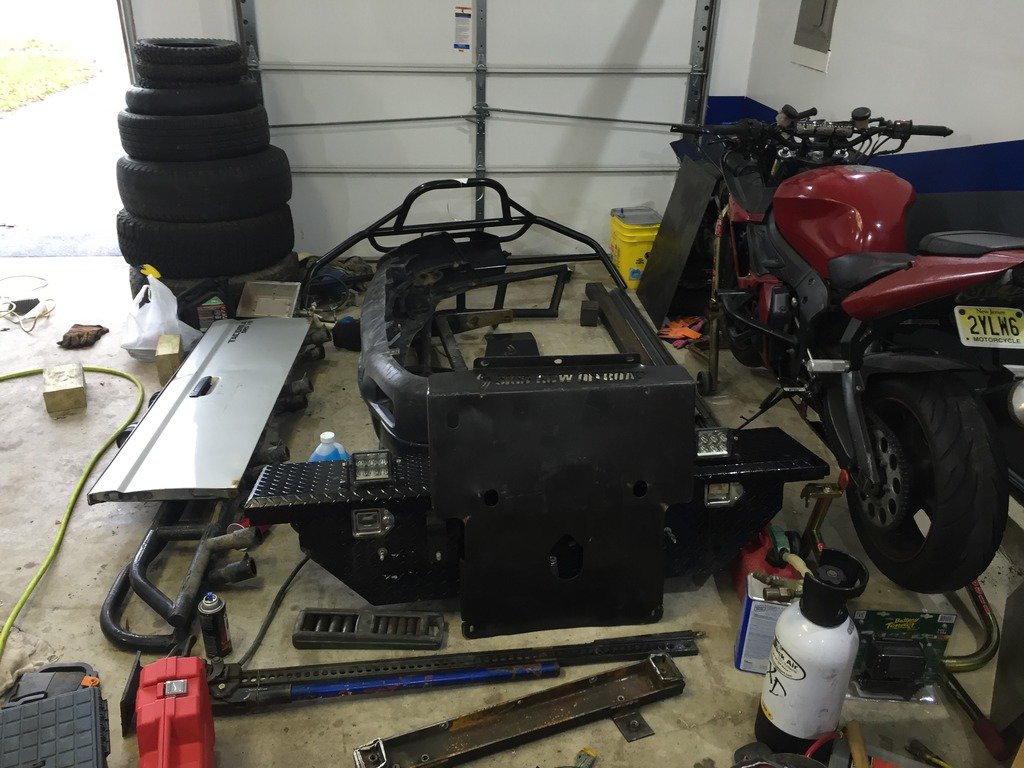

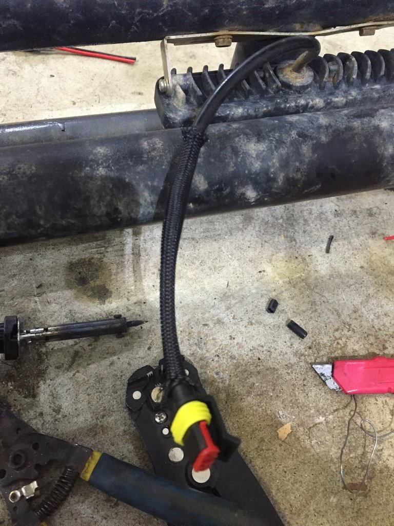

    Slowly working on the mess in the garage and prepping everything for when I get the truck back so that I can get it back to where it was relatively quickly.

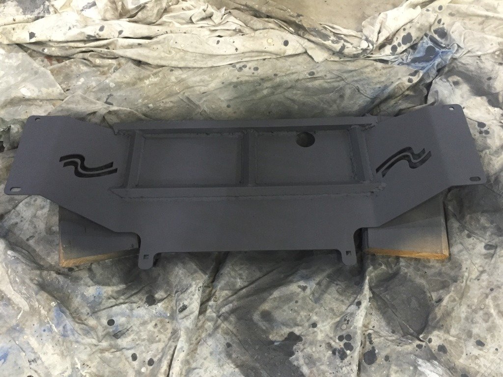

    Painted my t-case skid:
    Added quick disconnects to the rear bumper:
    Now I can remove the bumper and easily disconnect the aux lighting.

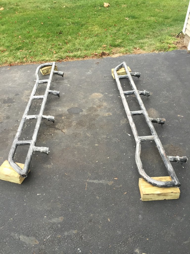

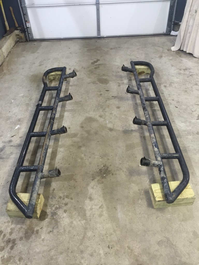

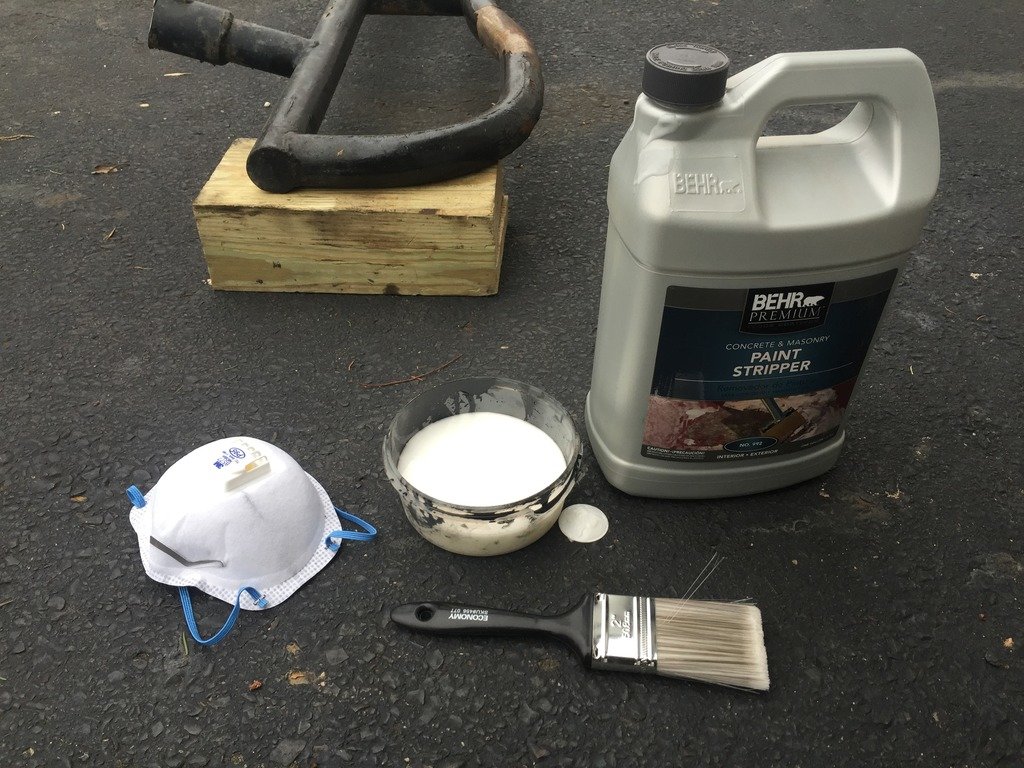

    Also started prepping the process of stripping the sliders. The paint was holding up well where it wasn't being scraped underneath or on the pinch weld of the truck, but holding up well anywhere it wasn't rubbing on.
    This is what I'm starting with:
    Trying this stripper that's similar to the reccomendations @ToyRyd04 gave me:
    Letting it sit overnight and see how it works.

  12. Jan 10, 2016 at 11:28 AM
    #232
    PcBuilder14
    PcBuilder14 Well-Known Member
    Jun 19, 2011
    #58522
    23,311
    Brent
    Nor Cal
    2018 Tacoma TRD Off Road 4x4
    Interested to see how well it strips off the paint as well... :popcorn:
  13. Jan 10, 2016 at 2:00 PM
    #233
    TIPICOTACO
    TIPICOTACO Well-Known Member
    Nov 22, 2010
    #46556
    2,231
    Tyler
    nw nj
    '01 DC 4X4 TRD "RAD BARON"
    Some lift, some armor, some scratches..
    Oi! That is a nasty messy process! Hope u got a good set of gloves! Keep the wire wheel on the ready, but hope the stripper does it for ya
  14. Jan 10, 2016 at 6:50 PM
    #234
    cynicalrider
    cynicalrider [OP] #NFG
    Jul 25, 2012
    #83399
    17,069
    Jersey
    01 SR5 TRD 4x4, '23 Bronco Wildtrak, 2017 HSQV FE350
    Drop bracket lift and booger welds
    Wire wheeling will still need to happen I'm sure but it's bubbling up pretty nicely. My big thing is getting it started to where the bond was extremely tough.

    Check Out My Builds
    Did you make the quick disconnects or buy them? I've been needing to make them for my busman box but have been too busy

    :thumbsup: Just be weary that it may be 20 AWG instead of 16 like some people in the reviews are saying. I used them for all little LED things. Can probably find a heavier gauge somewhere out there maybe.
