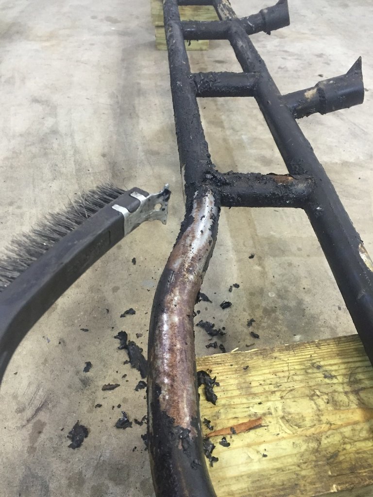

    WTF photobuckets not letting some pics show up.

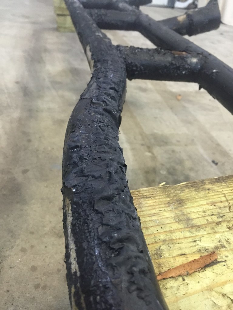

    Also got one slider stripped yesterday.
    Shows the bubbling of the paint:
    15 seconds of scraping or so:
    Wire wheeled:
    Stripper helped a ton. Took 1.5 hours for one slider when the last time I did this it took 4.5 hours.

    Looks like that did the trick :thumbsup:

    Hell yeah! Thanks for the heads up. :thumbsup: Never doing it without chemicals again, and I still have a ton left with what I bought.

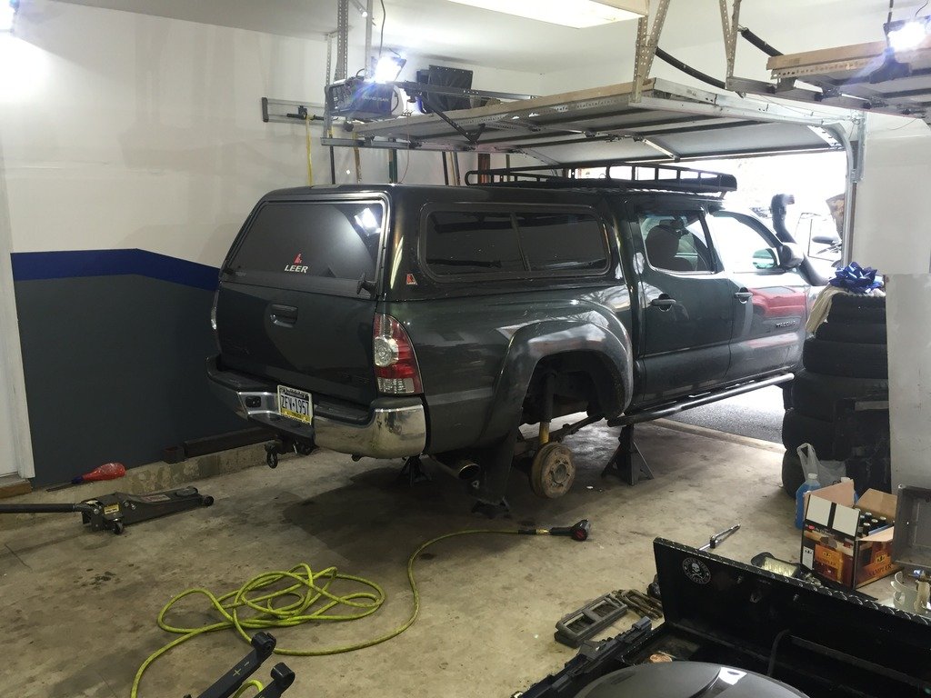

    Welp no truck means slow build unfortunately. I have been working on things in preparation for getting the truck back.

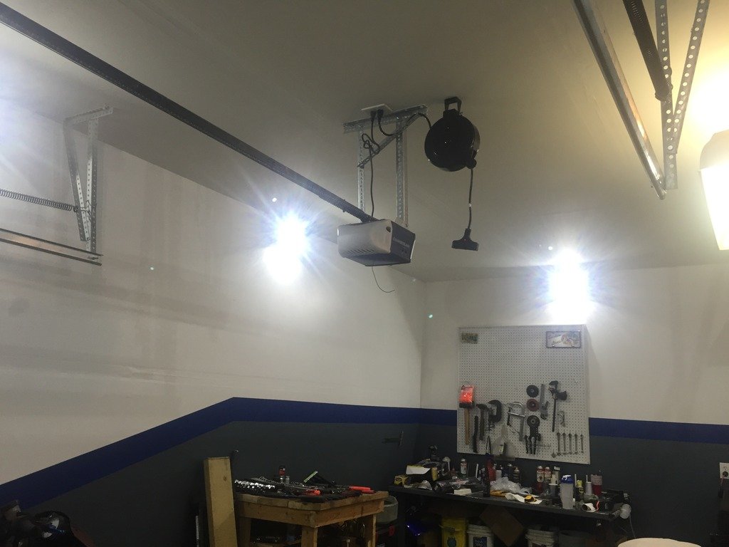

    Garage update:
    Big thanks to my SS @Joe D for my retractable extension on the one side of my garage. Can never have too many outlets! And considering I only have one ground level, and 2 ceiling outlets in it I need these bad.

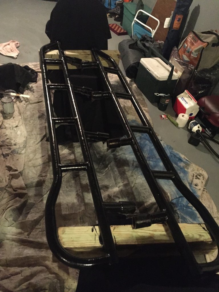

    Also been painting my sliders:
    Got a coat on each side with with gloss black, going to finish it with VHT chassis black to make sure I didn't miss anything brushing on.

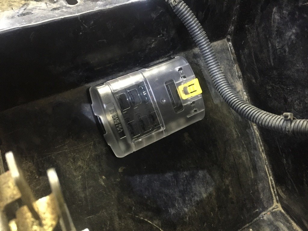

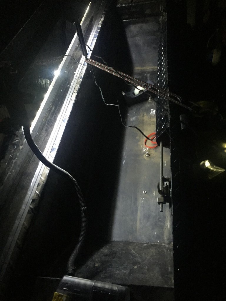

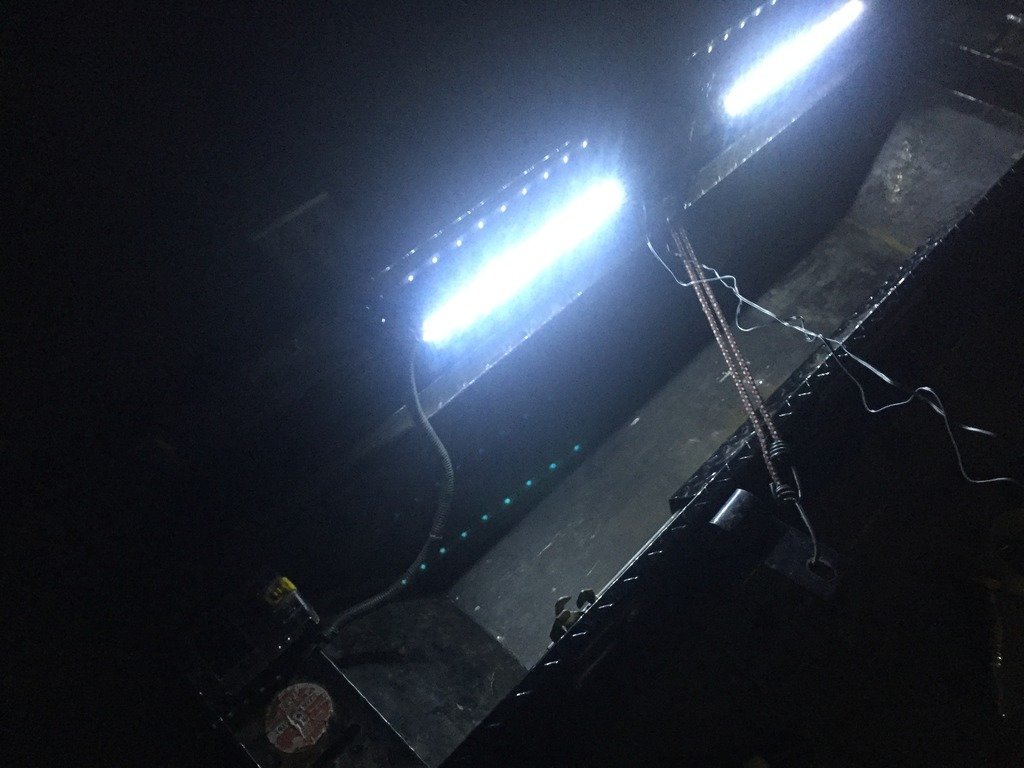

    Next up was redoing my bed/tool box electrical. Another thing @Joe D hooked me up with is a blue sea. Setting that up in the tool box to control the tool box light, bed lights, and rear lights. Want all of it to be available to be turned on without needing a key in the ignition so always hot. Going to put a 50 amp breaker on the main hot going to the blue sea as well as a big quick disconnect in case I ever need to take the bed or tool box off. The whole frame replacement thing has me putting disconnects everywhere now.
    Next was tool box lighting. I couldn't decide if I wanted this way:
    Which would project light into the box but also into the bed and I also would feel fuck up my night vision.
    Decided on this way:
    Want to put another strip of lights to fill the shadow as well. Should get the job done nicely.
