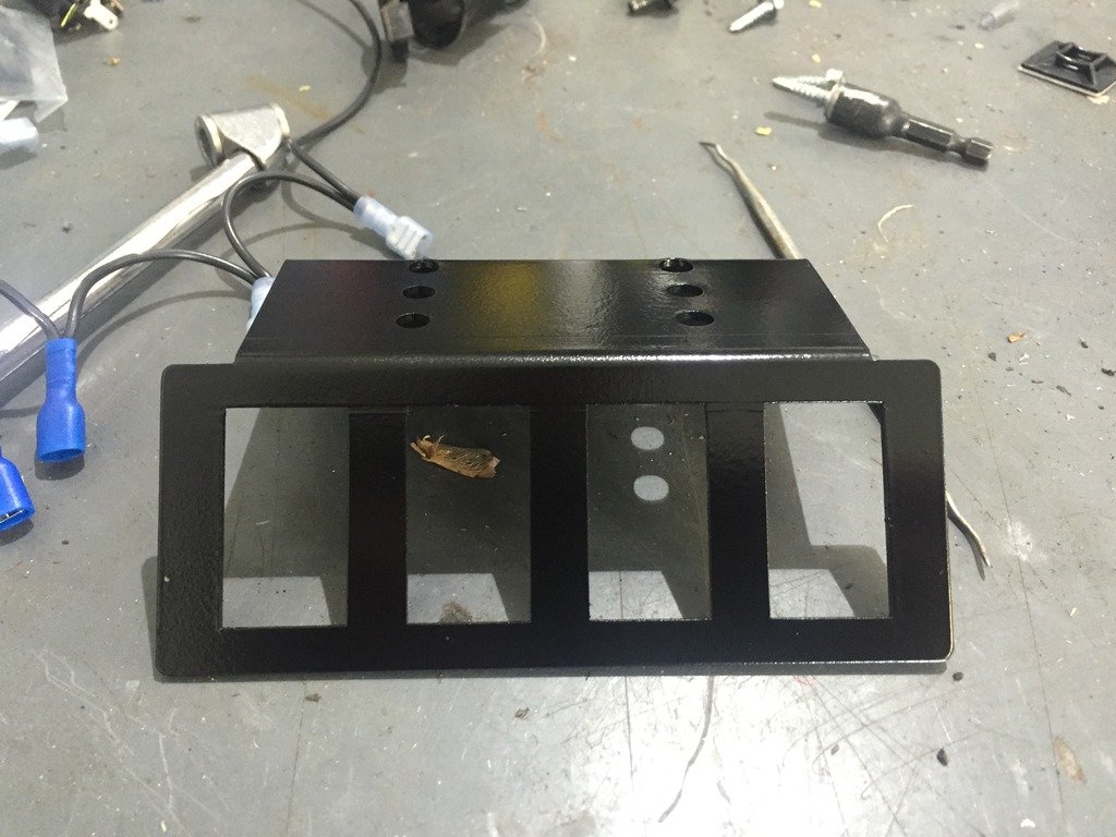

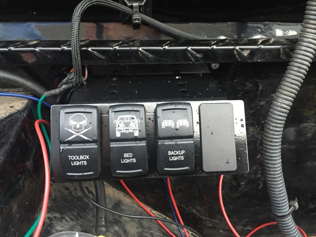

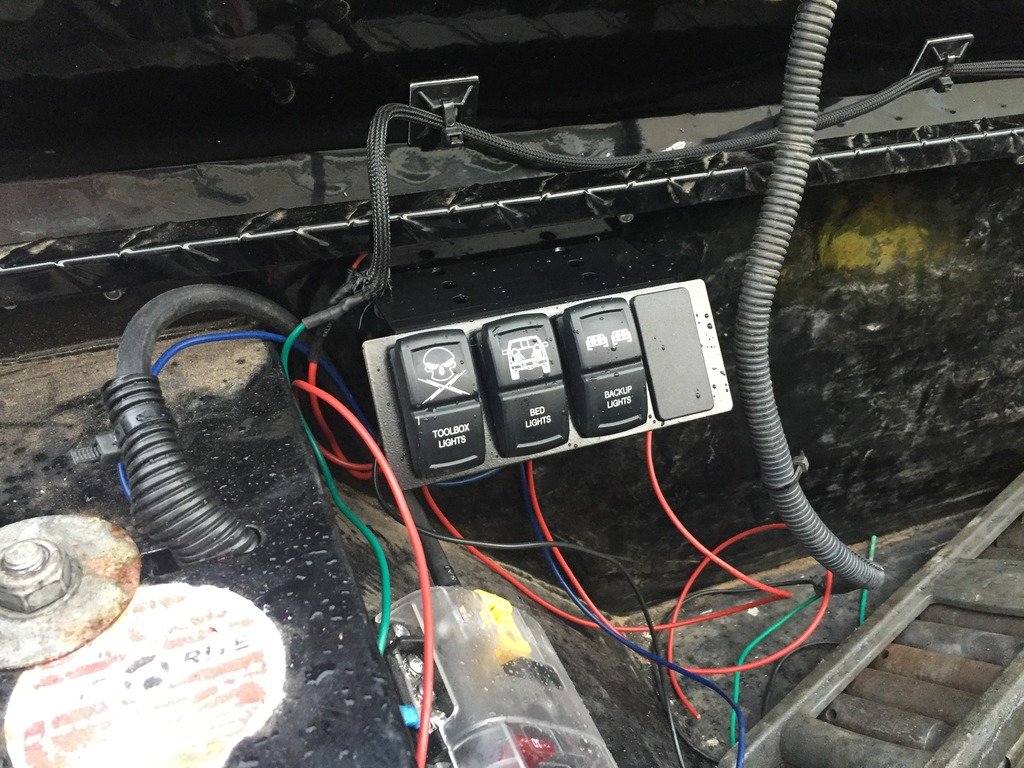

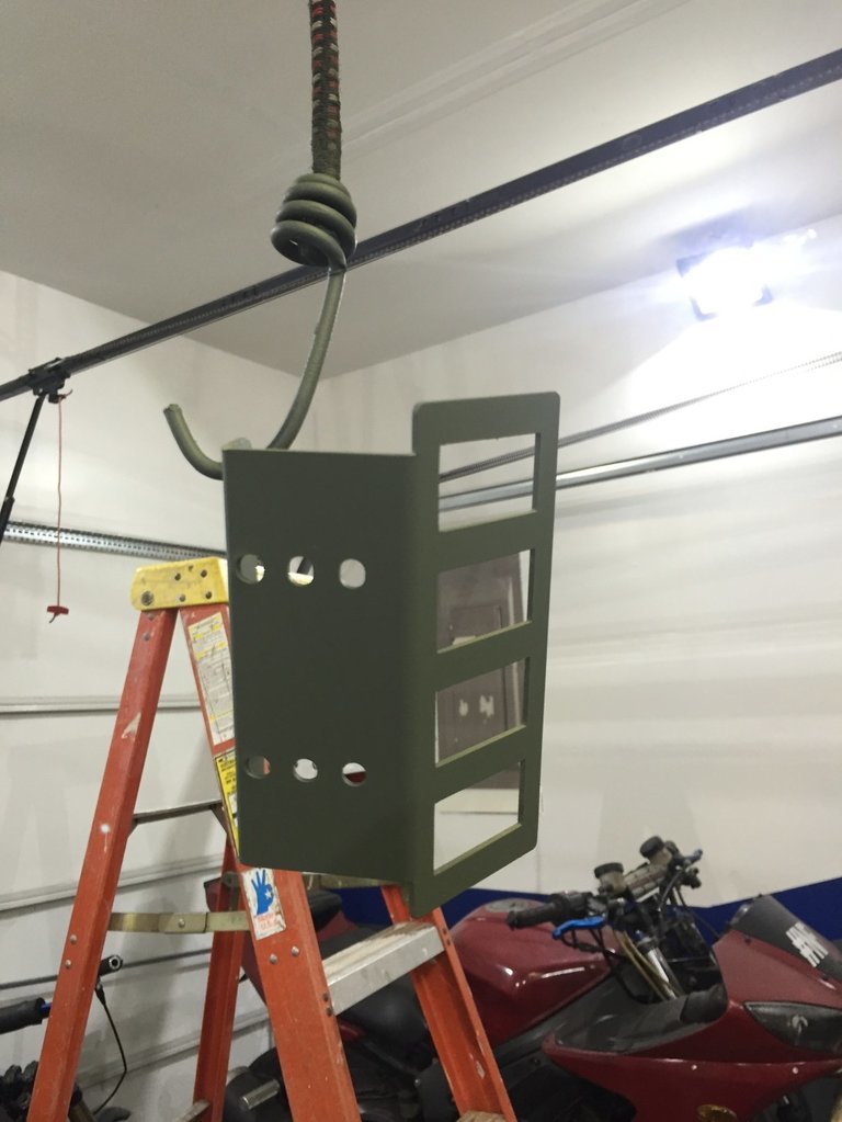

    Drop bracket lift and booger welds
    Primed the bracket with self etching primer and painted with chassis black.
    Then final mounted it into the tool box.
    Just waiting on the pin switch now to make it fully functional.

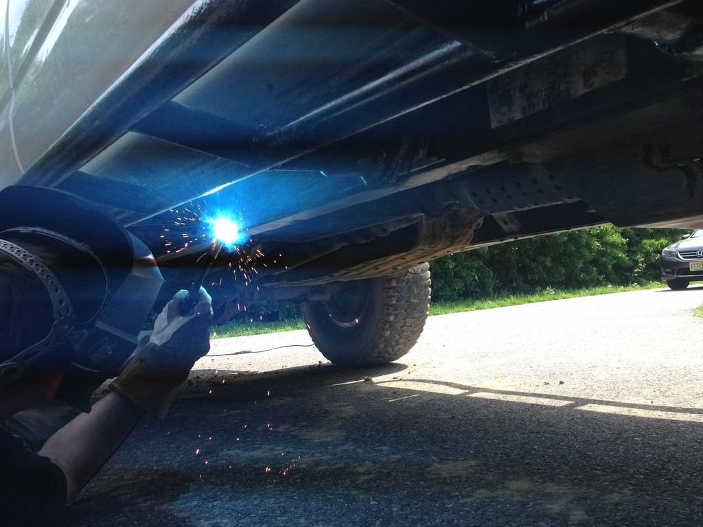

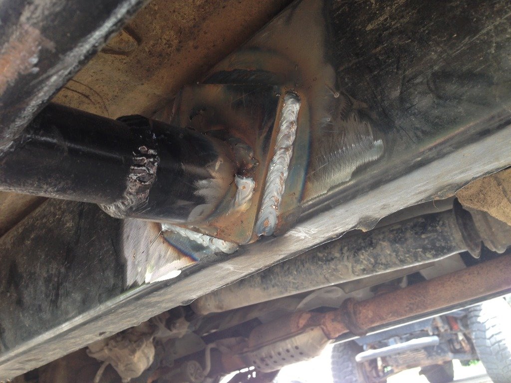

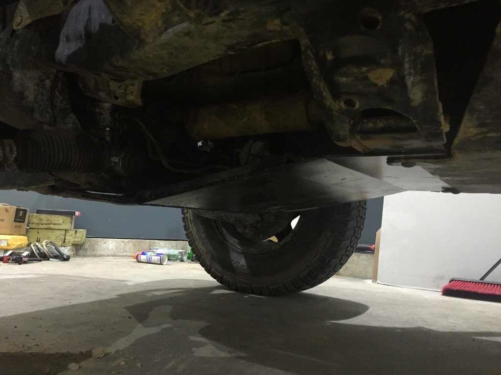

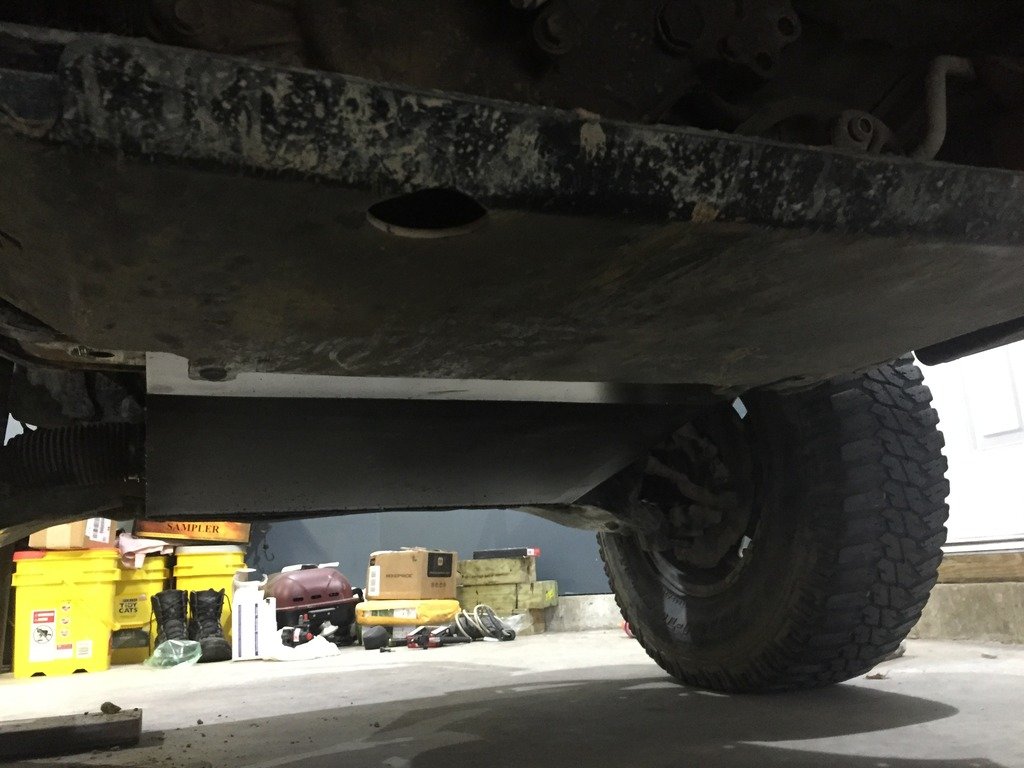

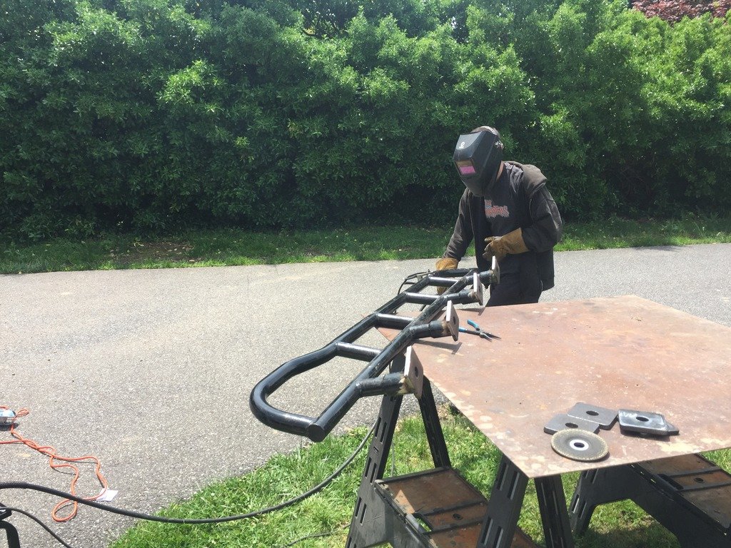

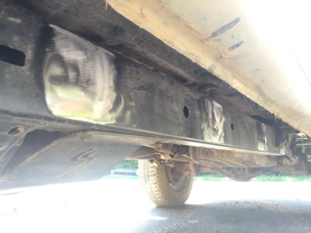

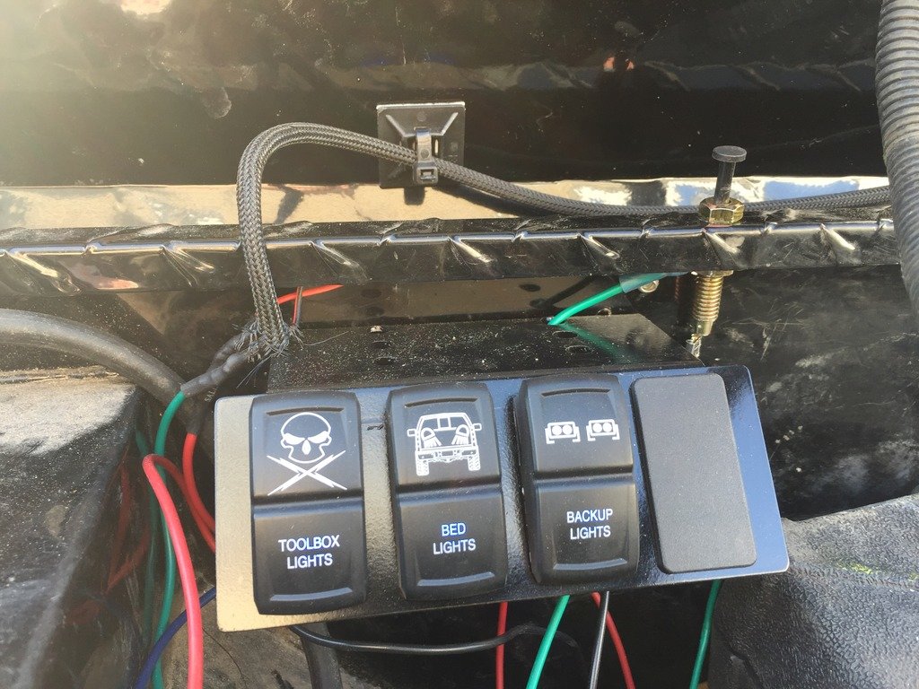

    Some solid updates thanks to @PSU Taco85 . We got my sliders welded back on! Now I can really wheel the fuck out of my rig again.
    We also tackled welding all the supports for the transmission skid too. This was the first thing that was pretty much fully welded by myself. And it shows. :anonymous:
    But it was awesome practice at least.
    We also worked through hooking up my relay for the two way switch. I'm glad I asked for help on this because I was confused as hell. And I hooked up my pin switch this morning so now the switch lights don't turn on until the tool box is opened.

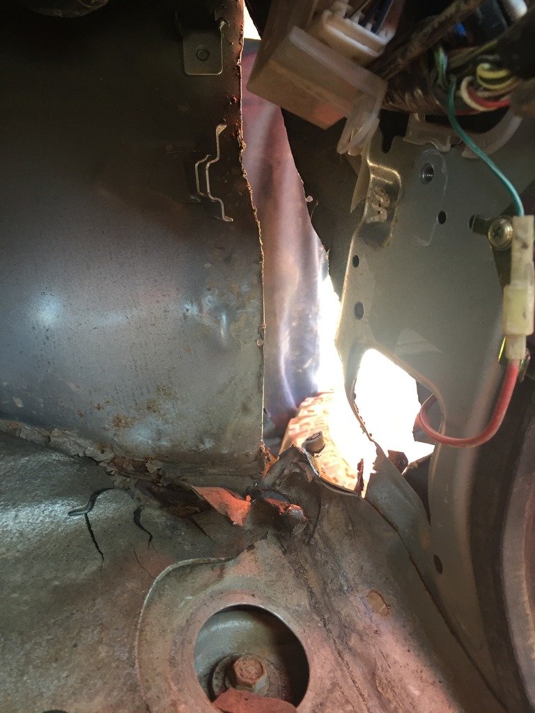

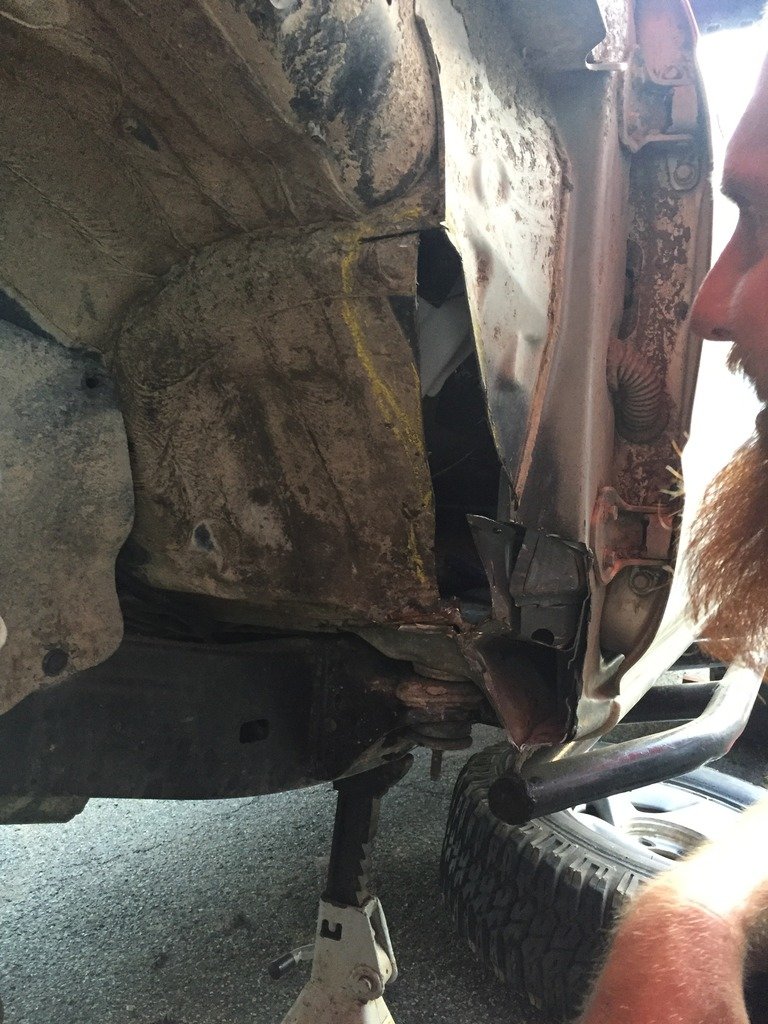

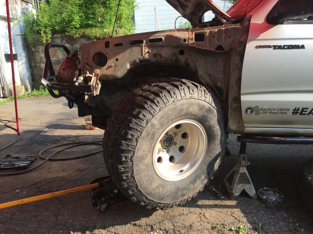

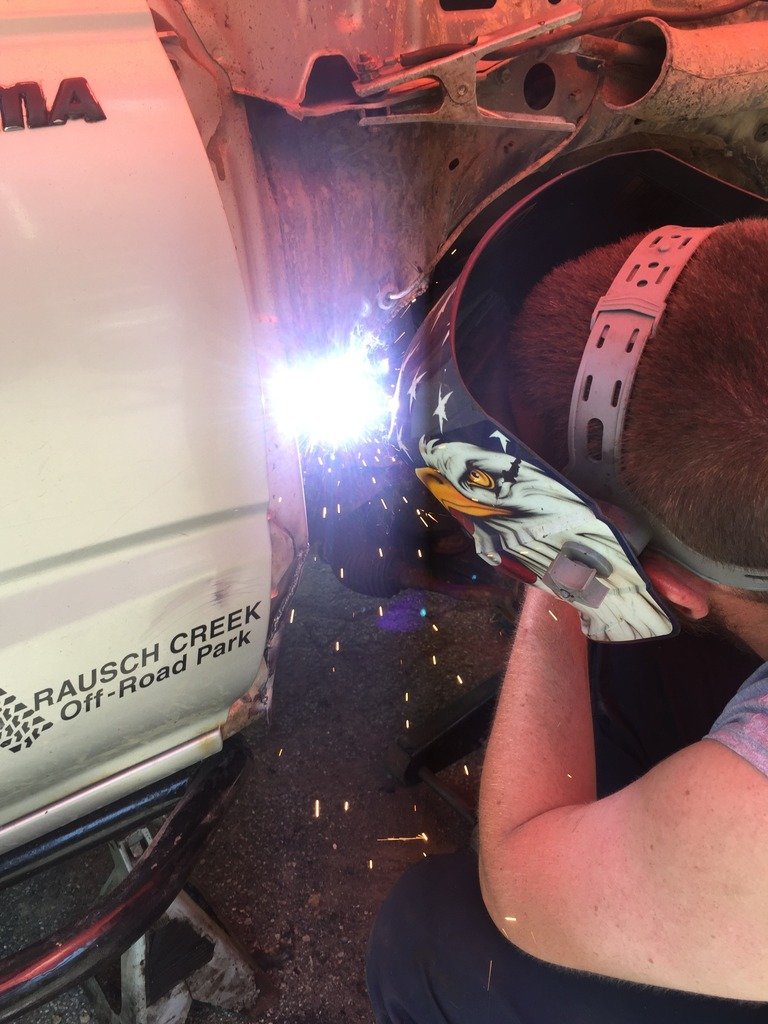

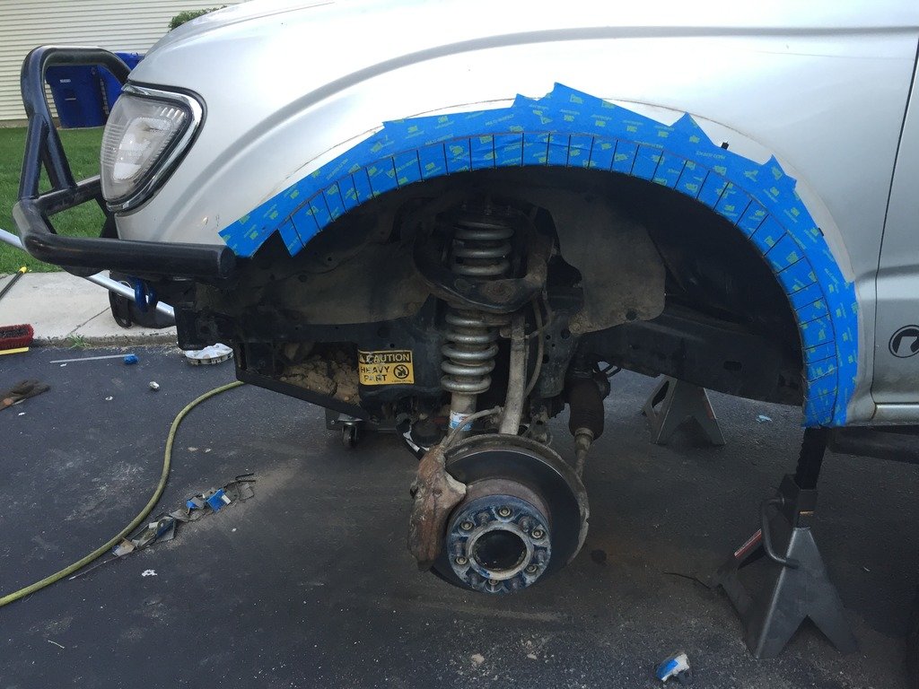

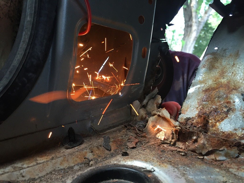

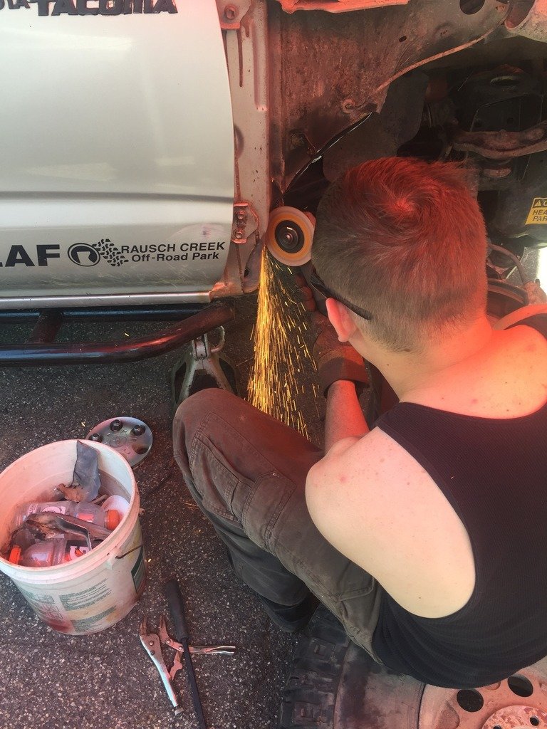

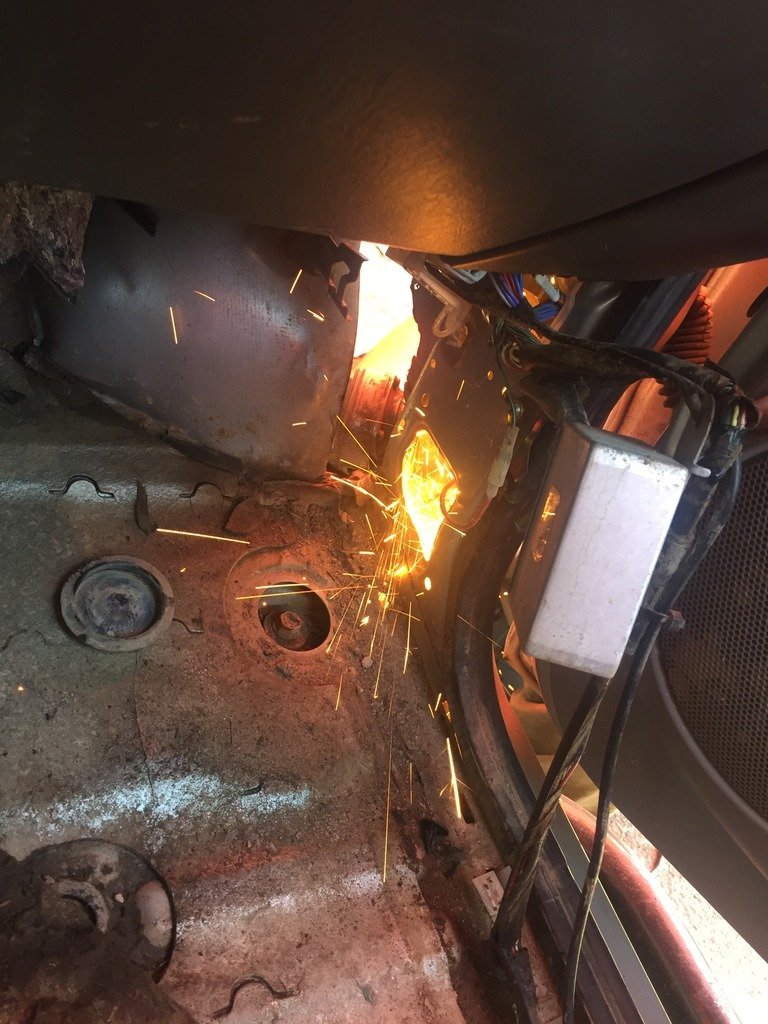

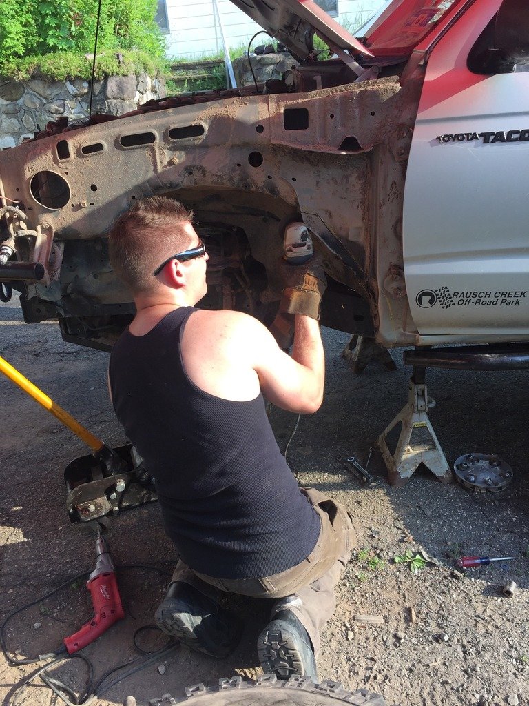

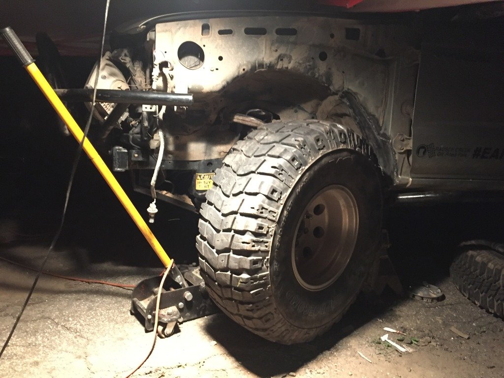

    And the time has finally come. I set an appointment with Coco customs AKA @Wheelspinner to tub my firewall.
    I got there around 5:00 Friday and we went to work and got one side done at about 9:30 PM.
    Since there are already a bunch of awesome write ups out there I won't really post in that fashion. I followed @Blackdawg and @mrbeggins write ups and photos as well as some links that were posted in Monte's build.
    The only thing that Steve suggested to me that I don't think we saw in the other builds was that once we saw where we need to cut out, before we cut we drilled holes almost like a road map of where to cut and see if we would fuck shit up on the interior if we did cut there.

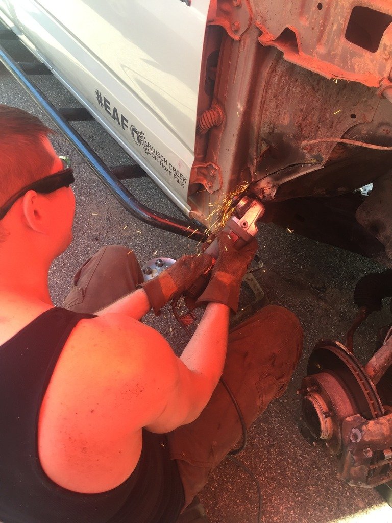

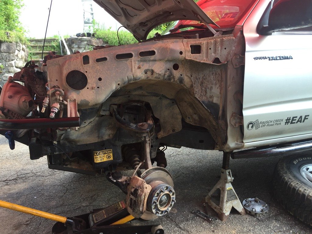

    Side one, removed coilover, made marks and started cutting:
    Final hole:

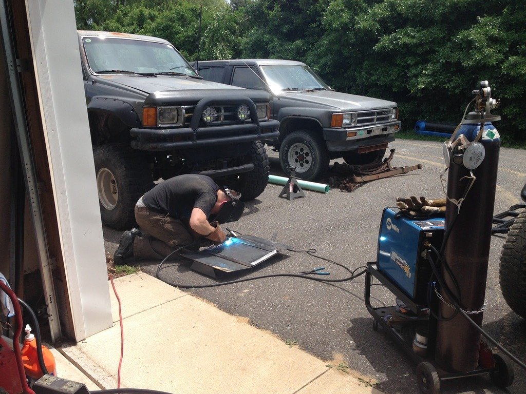

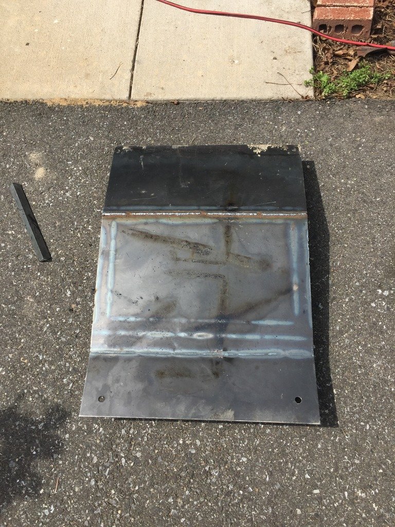

    Next up was making the template and cutting the 20 ga. to go in.
    The nibbler I got from Eastwood made easy work of this.
    https://youtu.be/3w1QdyR1dEc
    J5 was a sad mess at this point.

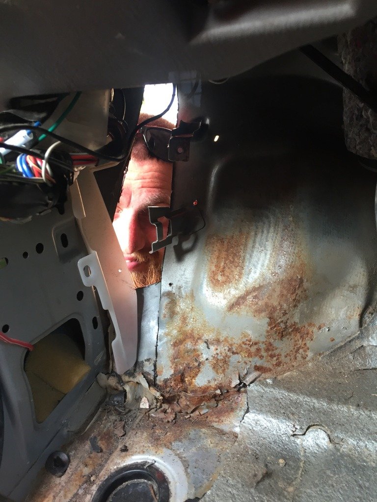

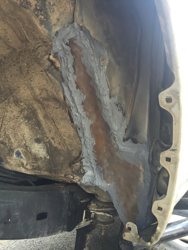

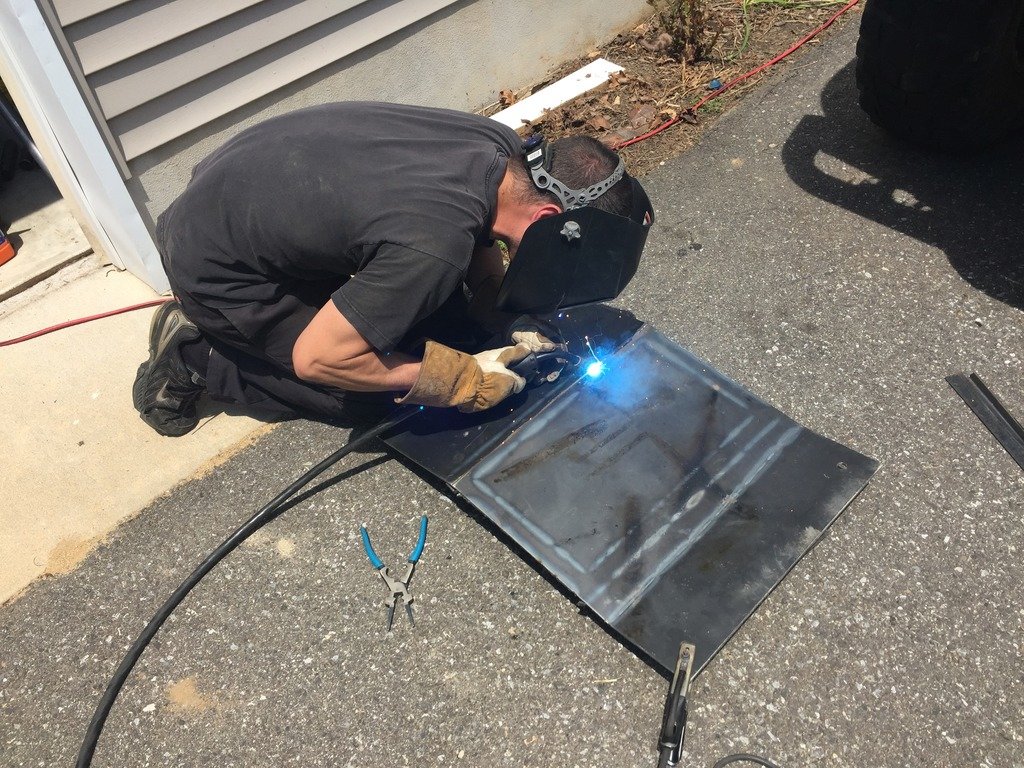

    After we got the template made it was time to weld. Since I was inside on fire duty and Steve was welding, not many pics came from this till completion.
    Success! One side done.
  5. May 29, 2016 at 4:05 PM

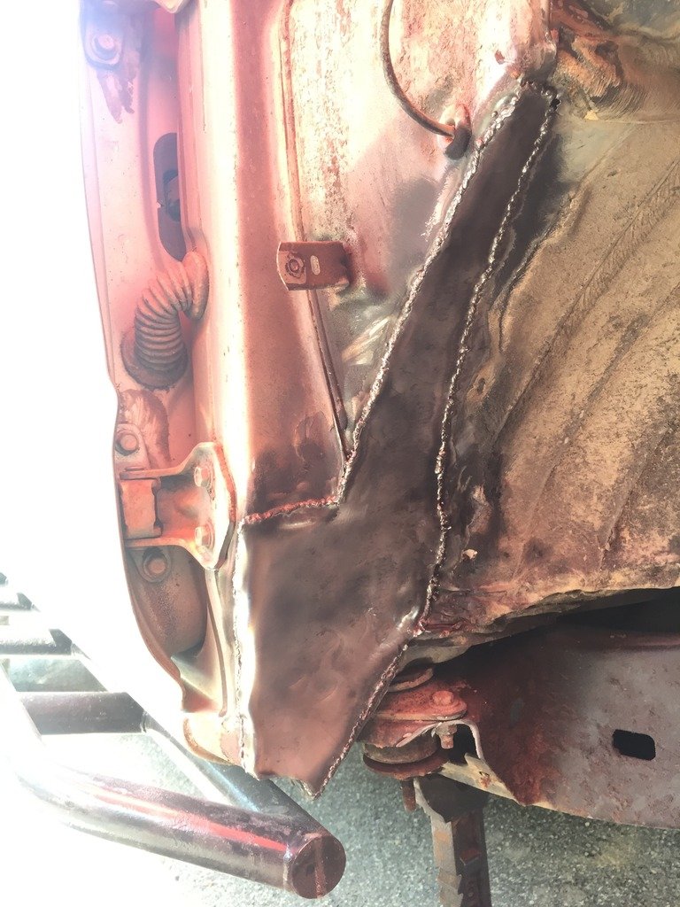

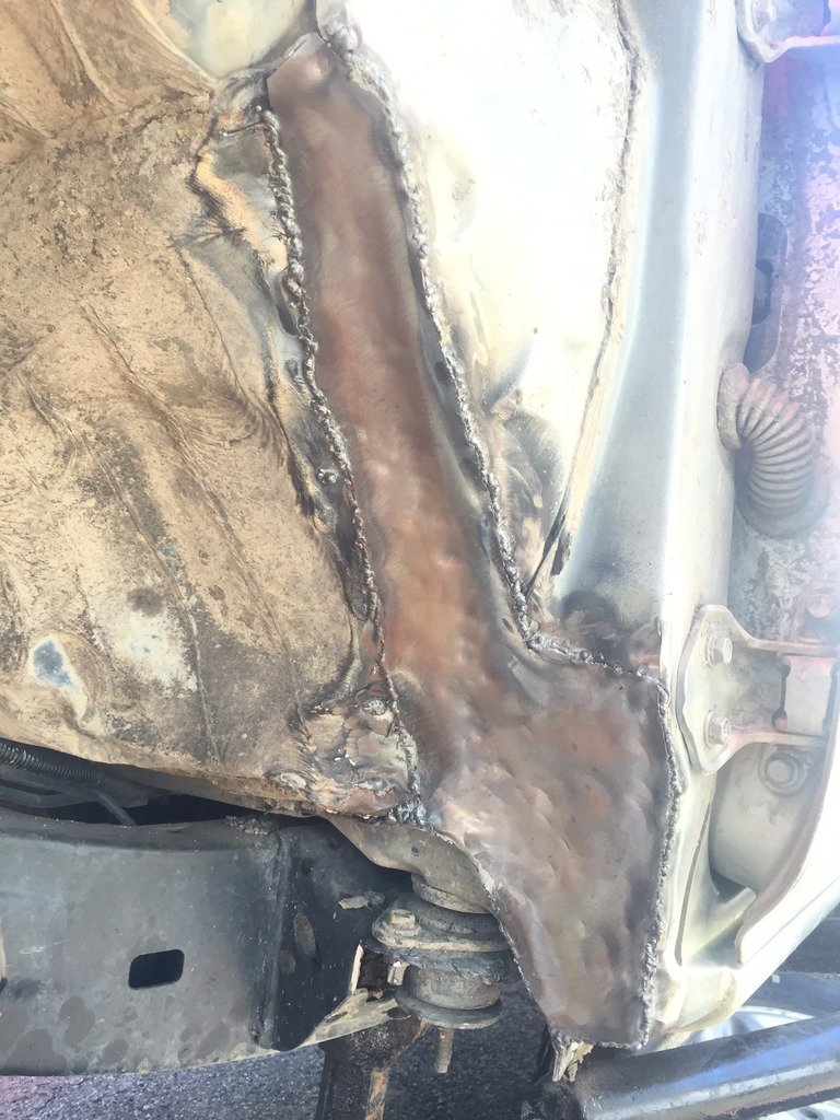

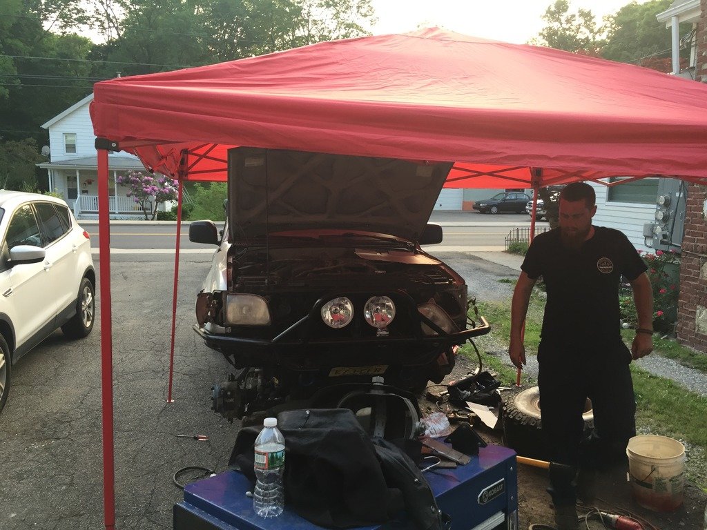

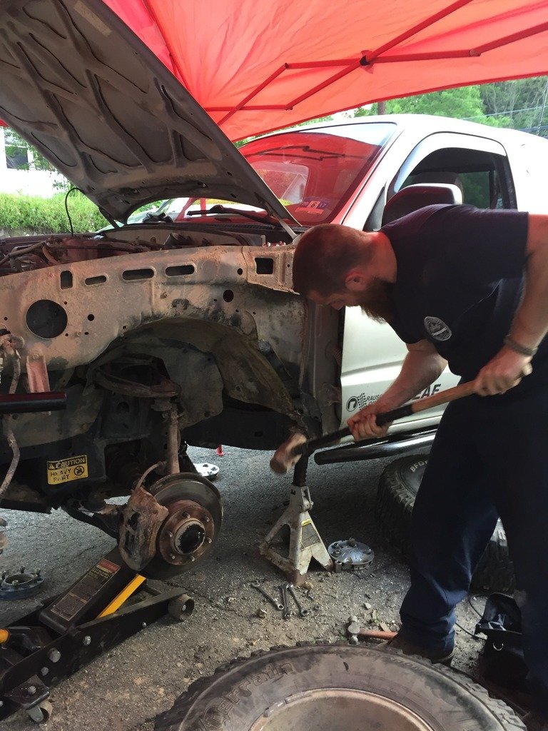

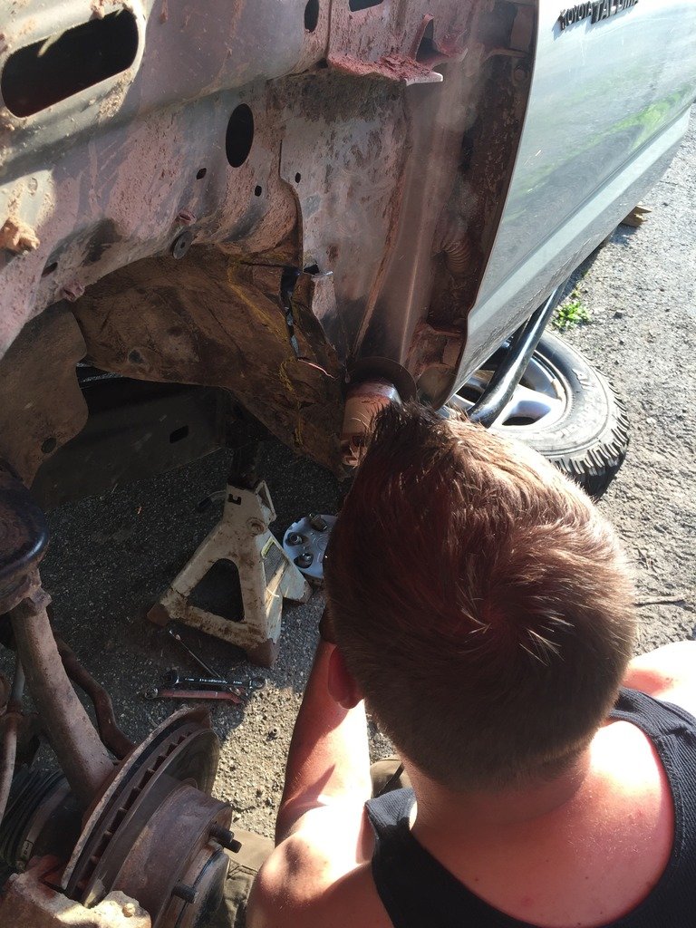

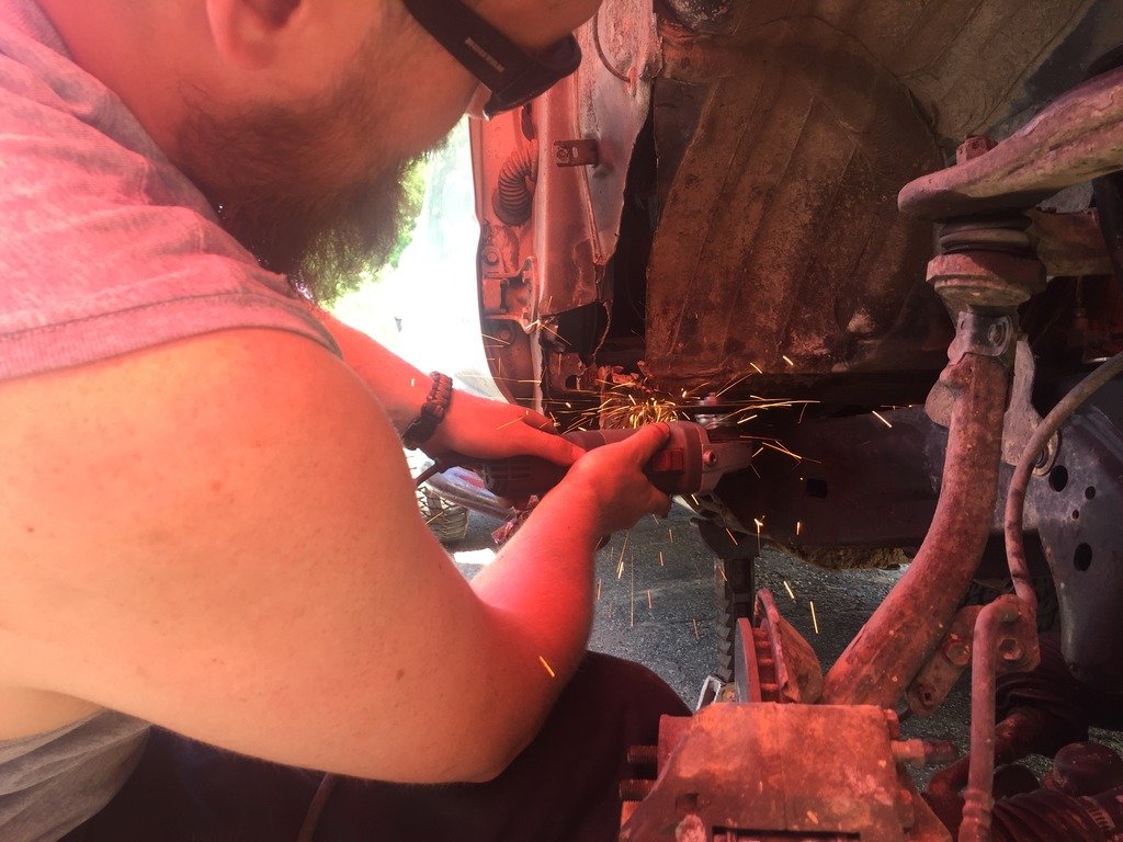

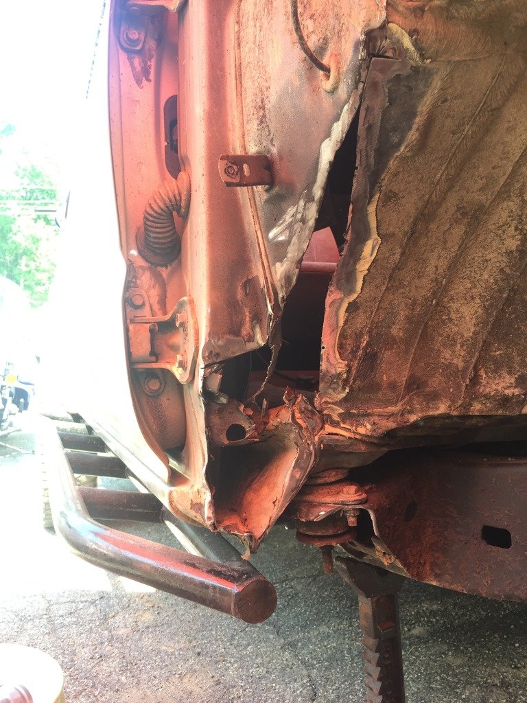

    Started the next day at 8, went into town got some cut off wheels and coffee and went to work around 9.
    Same process, pull coilover, test, cut, test, cut, test, make plate, weld, test, bang test, etc.
    Day pic of first side:
    Full cut out of second side:
    Steve welding away:
    Second side came out so mint:
    Seam sealer:
    @TIPICOTACO and @V5ioV stopped by.

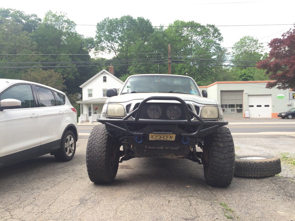

    Test fit with 2 35's. This is with an additional 1" BS than I will have.
    So. Fucking. Beast.
    Next up is fender trimming.

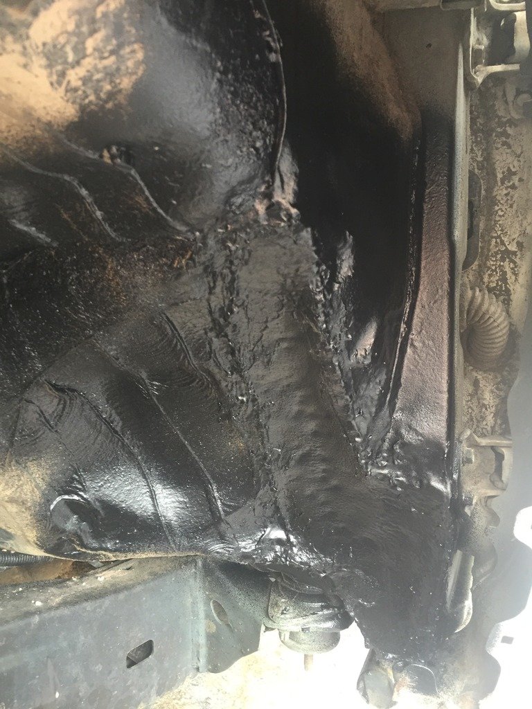

    More work done.

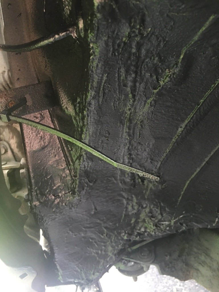

    After the seam sealer I wanted to be 100% sure everything was sealed up. Steve already welded shit up real nice so there wasn't much to seal but I rather over seal anyway.
    Primed/painted the inside and primed/flex sealed the outside:

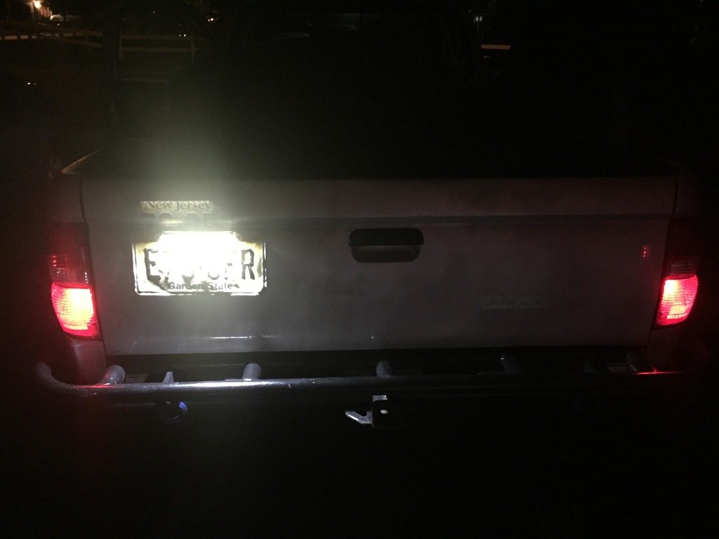

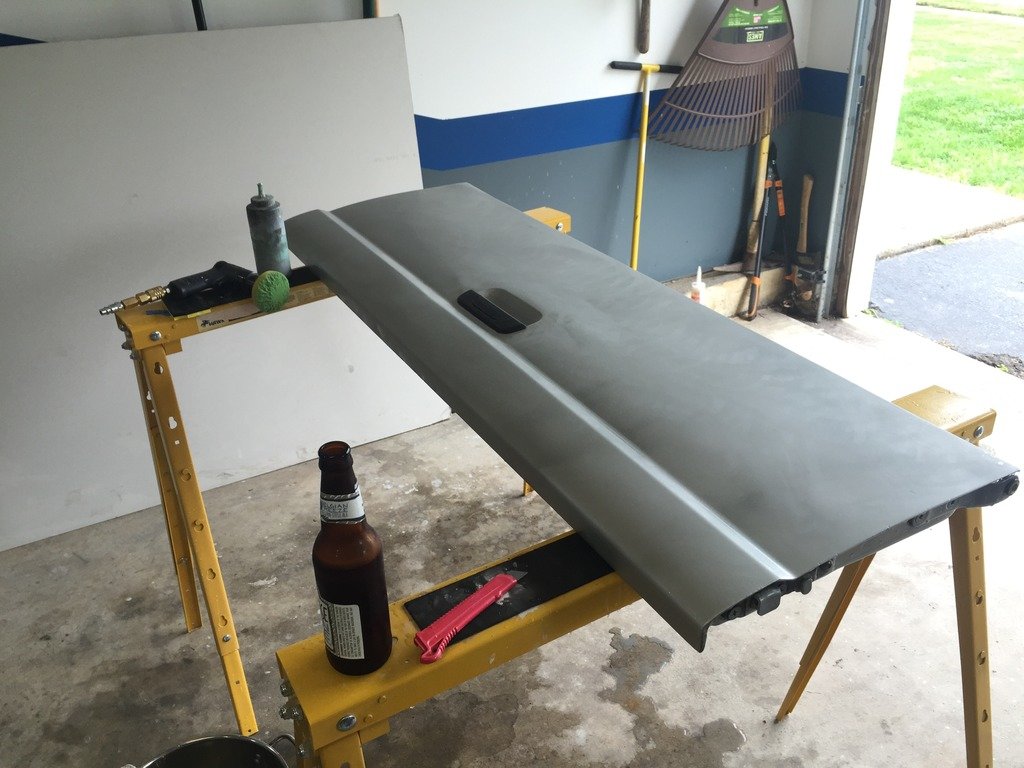

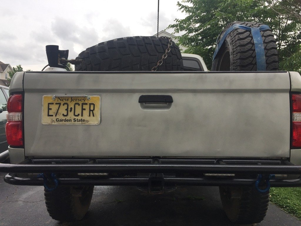

    Then went to finishing the never ending saga that was my tailgate project. Never doing body work again, fuck this shit.
    Wet sanded and buffed the tailgate thanks to @HomerTaco letting me borrow his buffer while he's heading to Moab.
    Then waxed it and final mounted the license plate and new light. The biggest thing was getting the plate off the bumper where it would drag or get removed from aggressive #NFG wheeling.
    Tested at night and damn it's bright!
    So glad that project is finally done. Next projects will be cutting the fenders or installing the head unit.

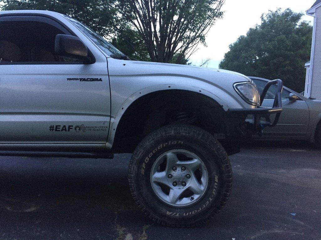

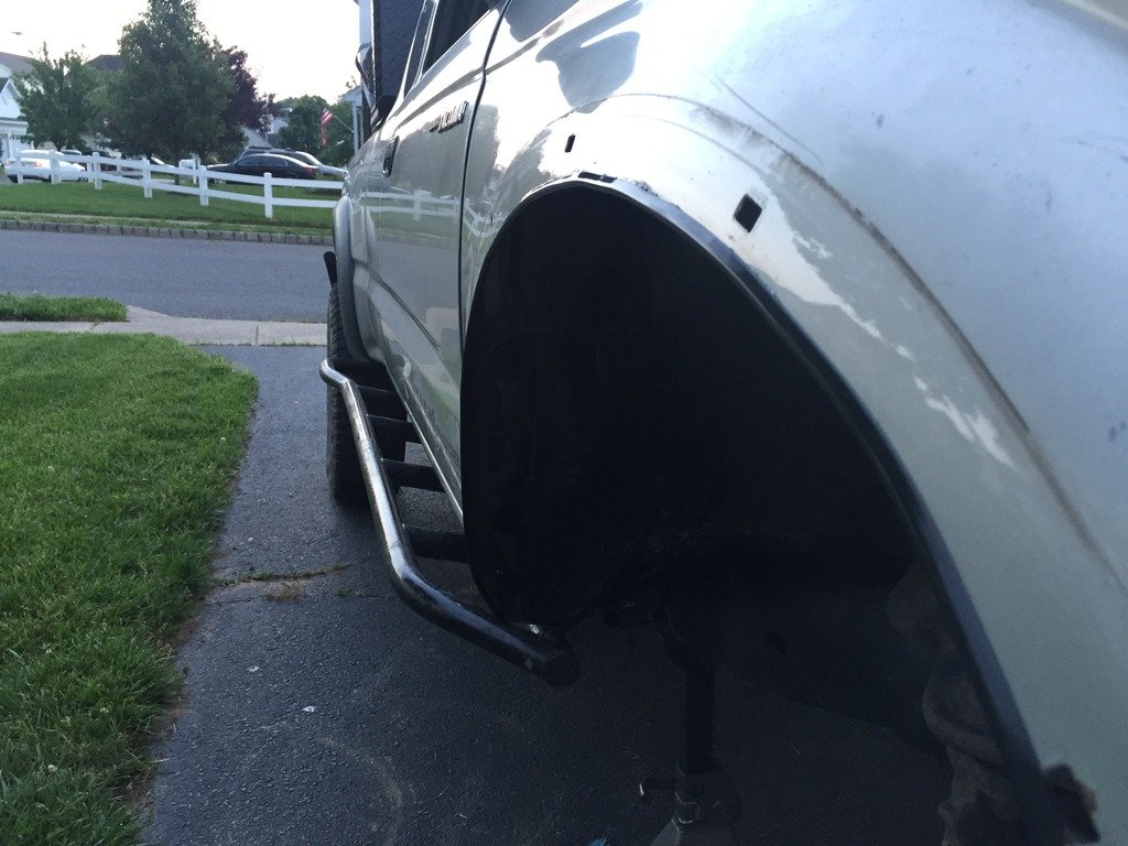

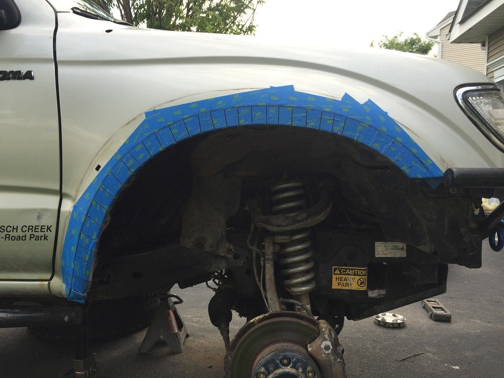

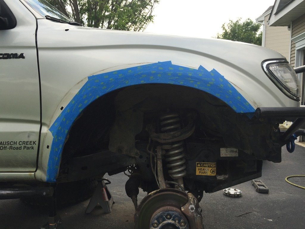

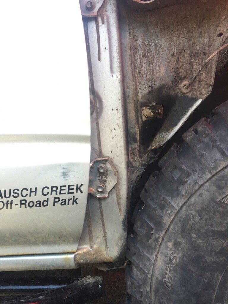

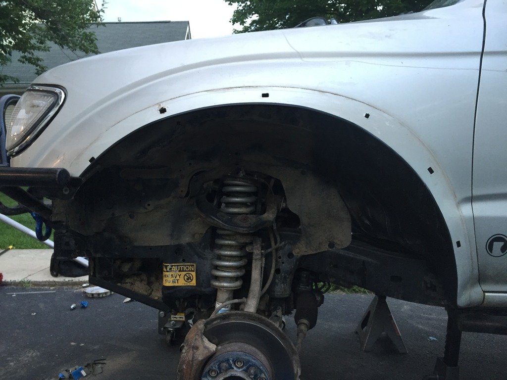

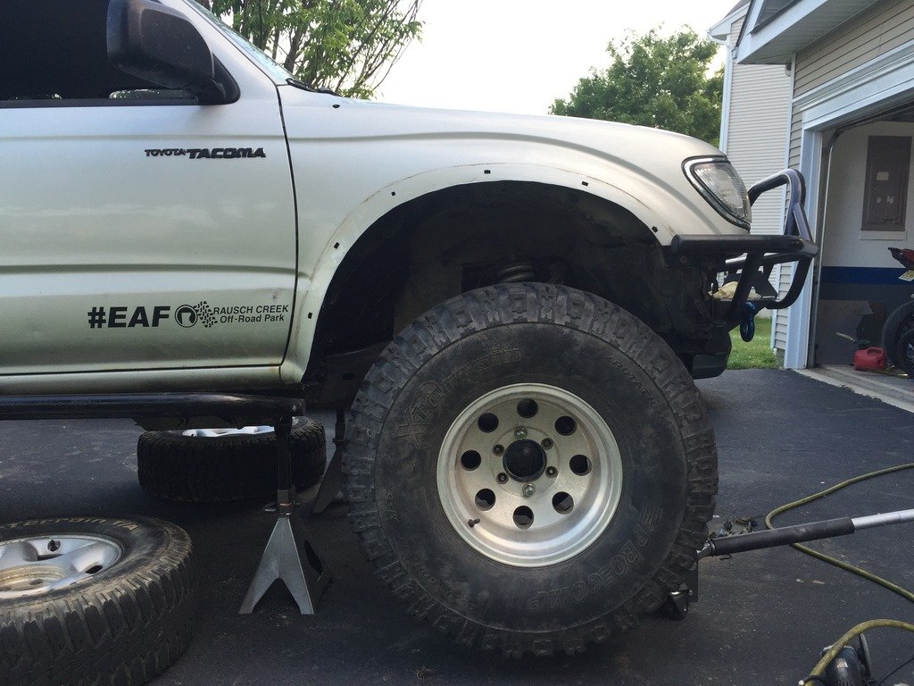

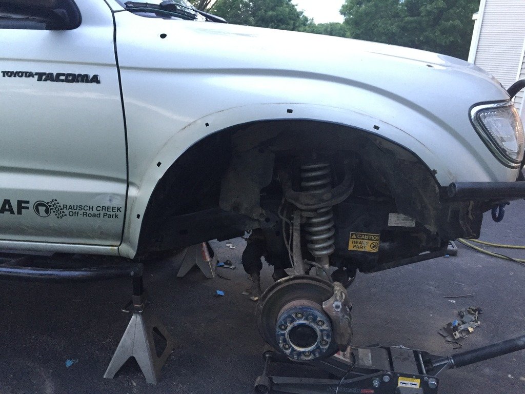

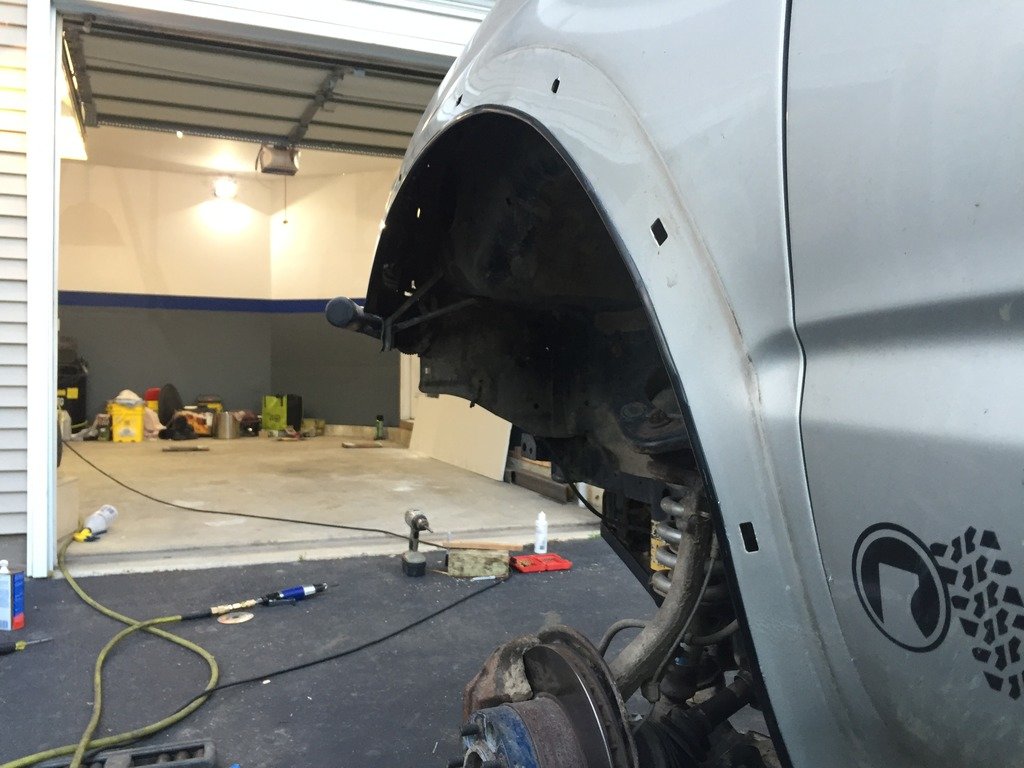

    Got the next step done to stuff 35's, chopped front fenders. Rear's I gotta get some help with since I gotta take the bumper off just to get the flares off. Not much to it, used a combo of the angle grinder, body saw, and pnuematic cut off wheel. Took 2" off all around.
    Got some trim at pepboys and even though it said it had adhesive in it, I used emblem/trim adhesive as well anyway.
    Gotta get some goo gone on the line and decide whether or not I'll plug the holes.
    Now that I cut, the 265's look tiny as hell lol.

    I'd plug em and color match what ever you plugged them with. Make it look cleaner

    Yea it seems like most people do that by grinding down the stock clips. I want to hopefully sell my flares with the clips so I gotta find other clips I can use. I kind of hate how high I had to cut so I am hoping to get fiberglass flares in the near future.

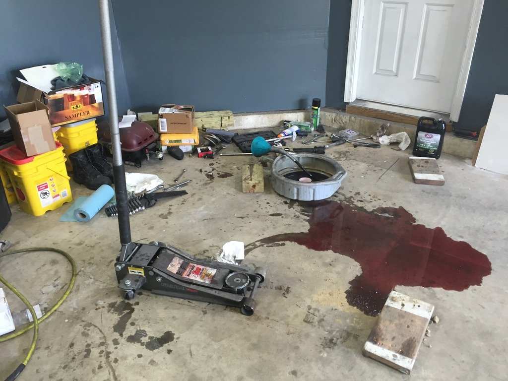

    Got the painted mid skid on, and replaced my PS pump with a warranty replacement. The one before didn't even last a year...
    And I always forget to plug the return side of the res when I flush. :anonymous:

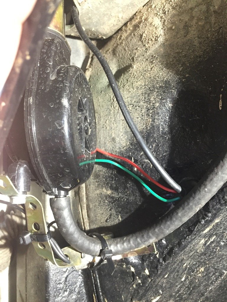

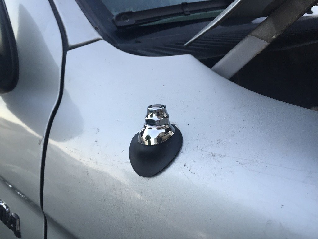

    Finally hooked the power antenna up. Put it on a switch so I can turn it off when wheeling but still have the radio on for Pandora.
    The breather it came with was a dinky little piece of 6" hose that kept falling off so I extended it into the engine bay with some spare fuel line.
