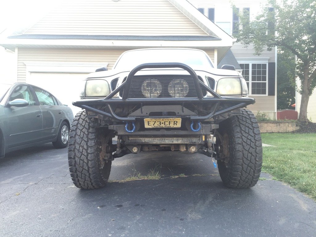

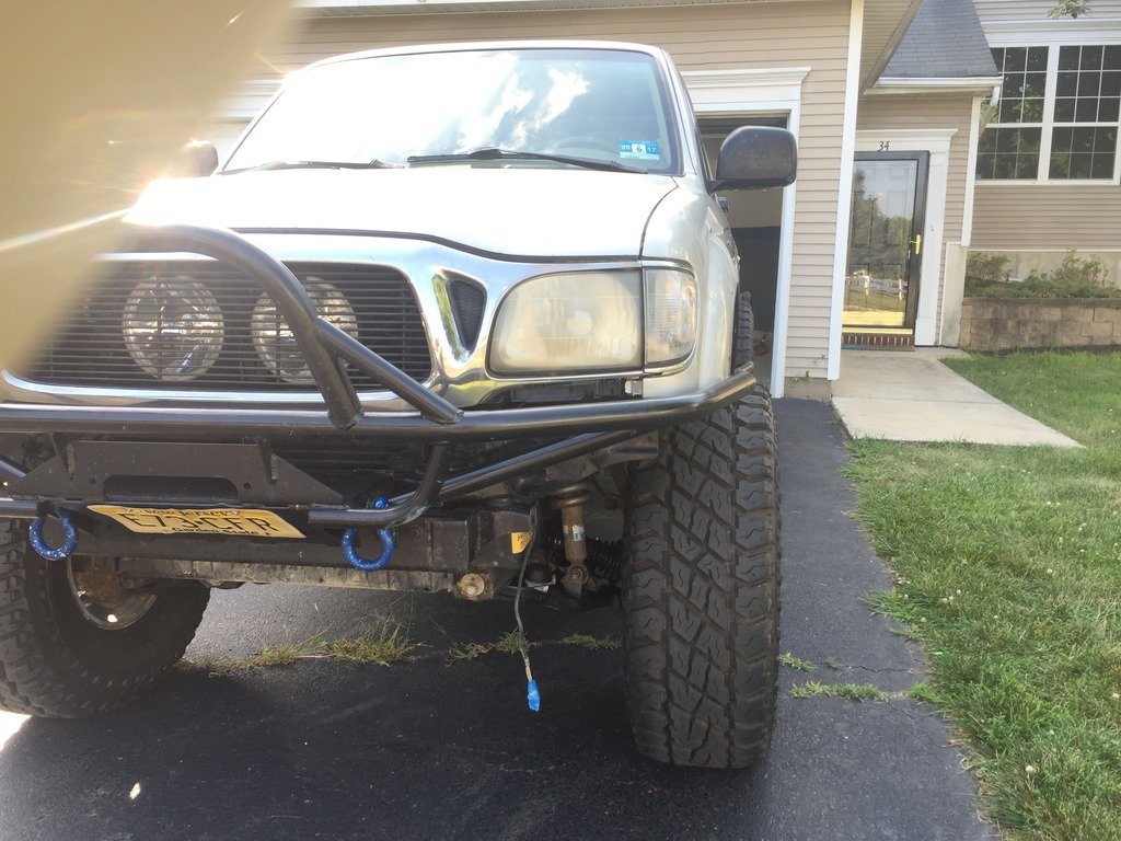

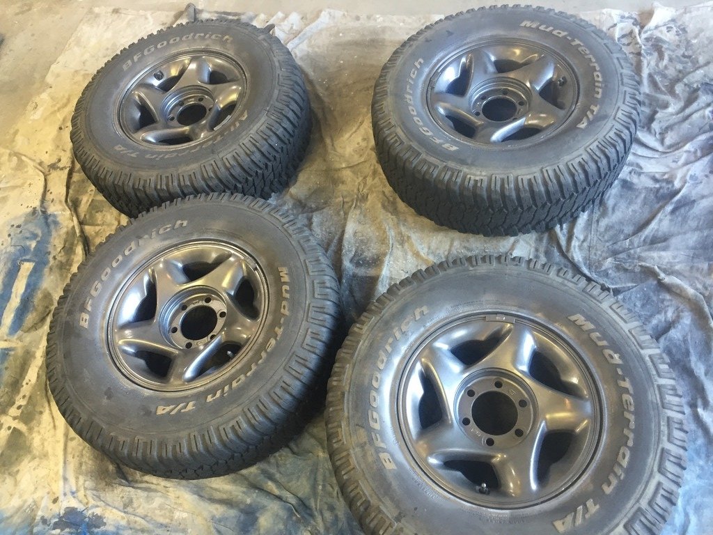

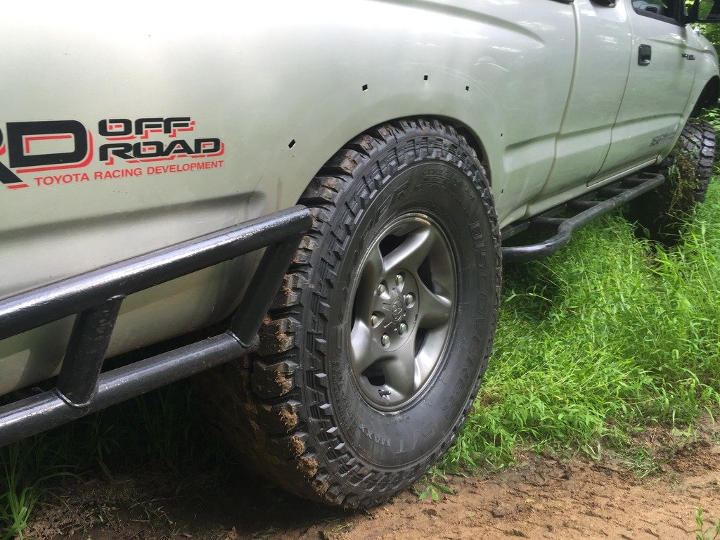

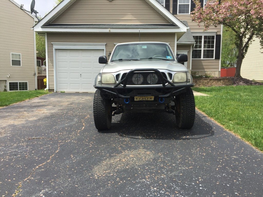

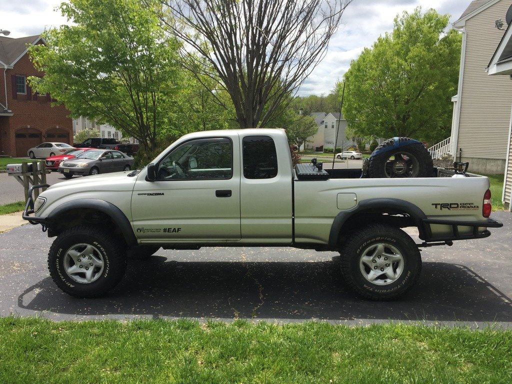

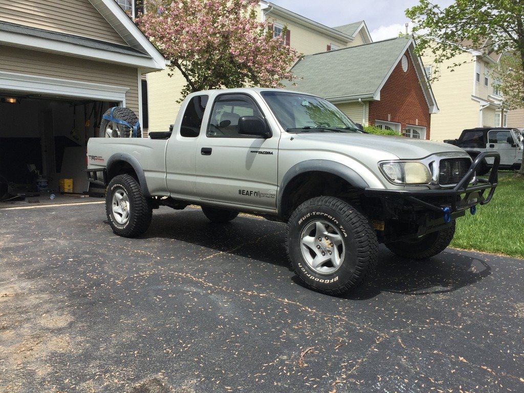

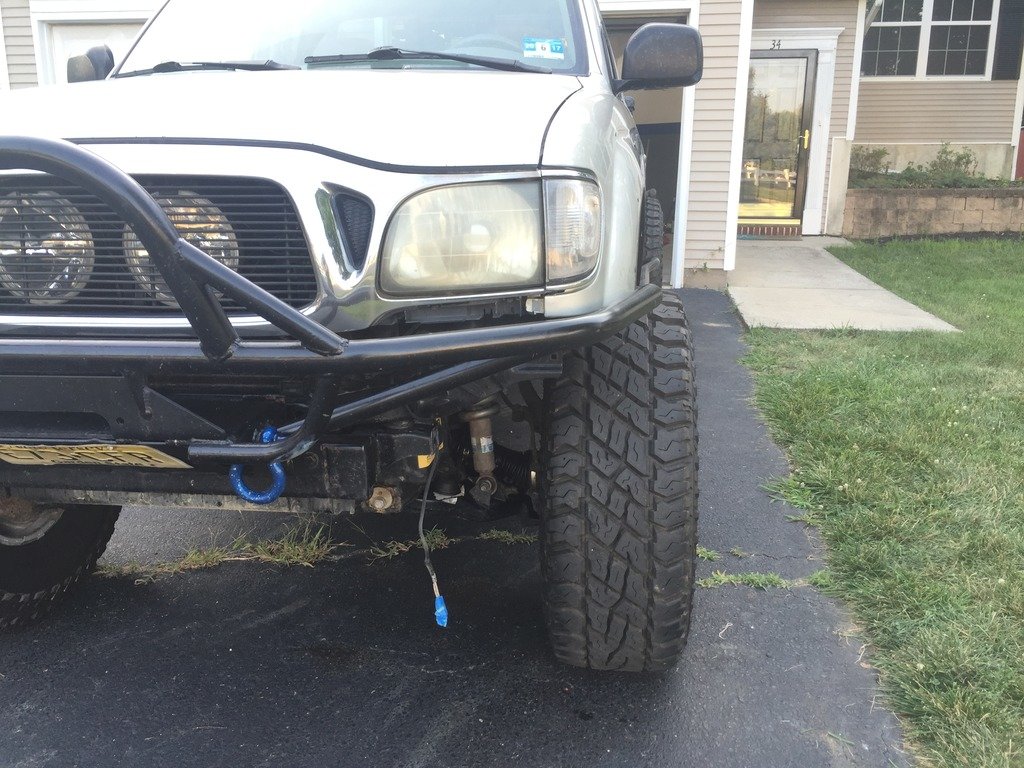

    And J0hnny5 finally got some new tires!

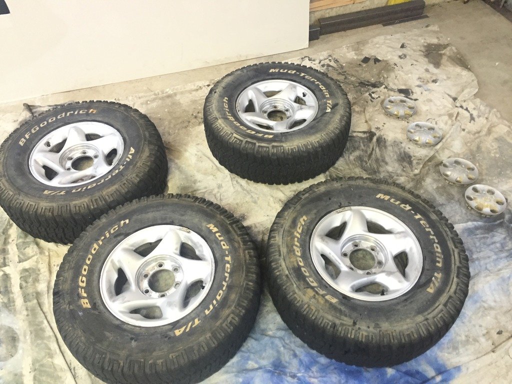

    I knew this would be my best opportunity to paint the wheels without caring about over spray so I painted them with dupli color's graphite wheel paint.

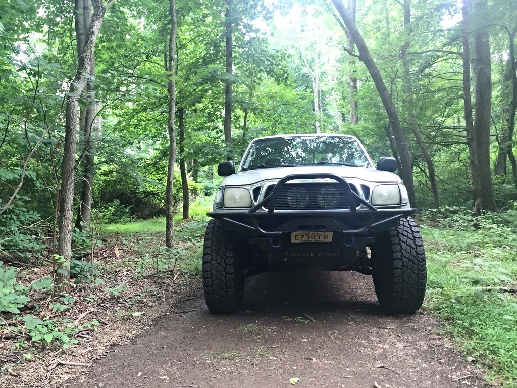

    Got the call from my buddy that my tires were in so I rushed over to get them mounted. I went with 315/75r15 Cooper S/T Maxx. I love them so far. Definitely takes a bit more to stop and get going but they are SO QUIET. Speedo is about 5 mph off right now according to an app I have.
    Anywho here's the pics and direct comparisons with the old tires.
    Right now I am rubbing the frame pretty hard at full lock. Also rubbing the plastic near the washer res but not the washer res itself yet. Going to borrow @V5ioV 's bigger wheel spacers and see how I look.

    Hey friend! I love watching all these 1st gens get 35s
    Imo you should ditch that resivoir. Im going to make one out of pvc using the motor and sensor out of the old one.

    Haha you and me both. First gen's on 35's are sick. I do plan on making one but for now I don't plan on dealing with it until I have to. I have a big trip coming up at the end of the month so I gotta figure out the fender chop in the rear and the wheel BS before I deal with anything else.

    Looking good man!!:bananadance: Have you trimmed the rear at all? It looks a little tight back there. Also, are you running wheel spacers?

    No rear trim yet, gotta pull the bumper to do it so that's happening next week.
    I am running 1.25" spider trax and picking up my buddies 2.25" bora's since I am rubbing the frame something nasty at full lock. Another next week project. Running out of time quickly to get it all wrapped up before a trip at the end of the month.

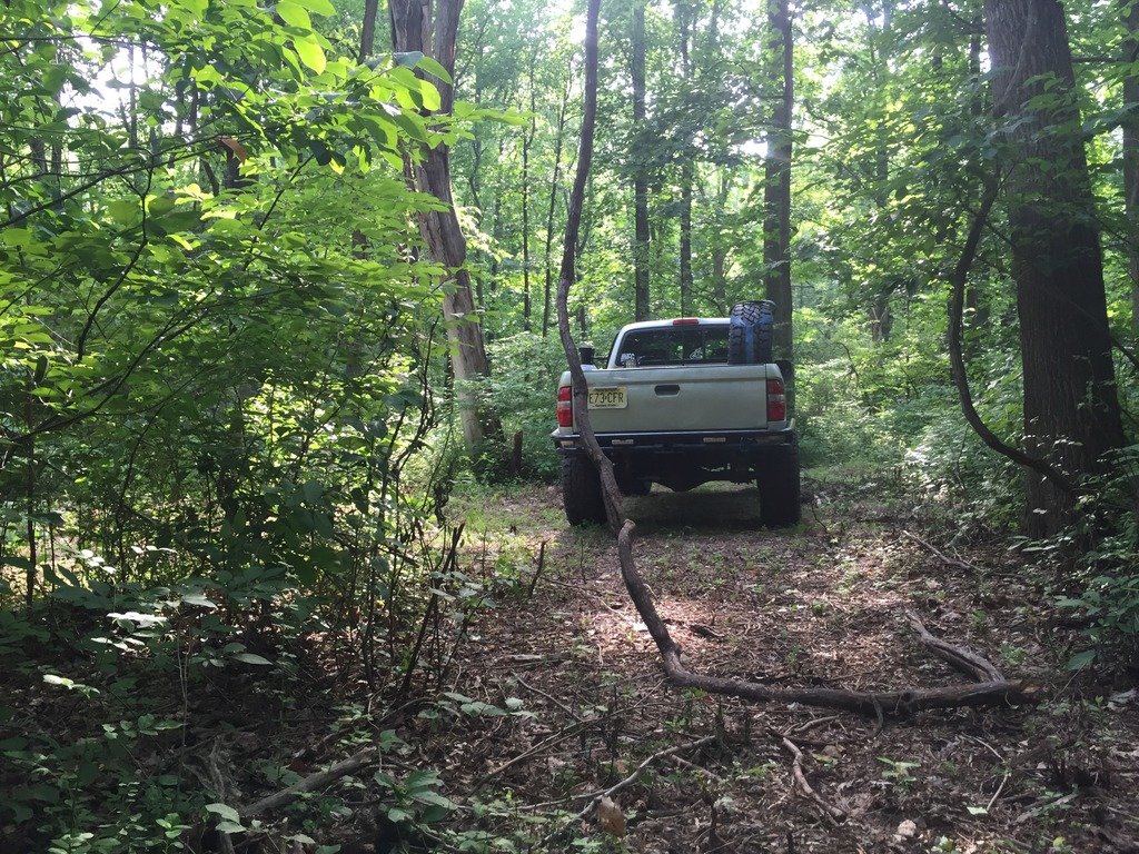

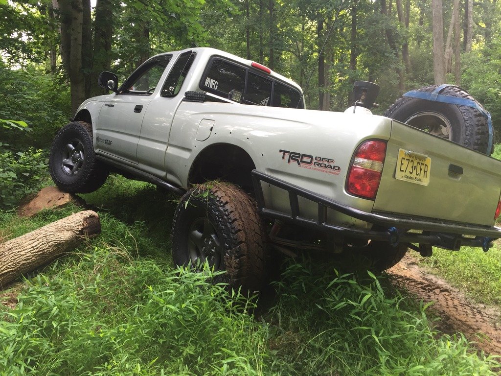

    No :( not for a while anyway. Went on a trail (if you can even call it that) by my parents house. Stuffed it and saw how bad I need choppy choppy.

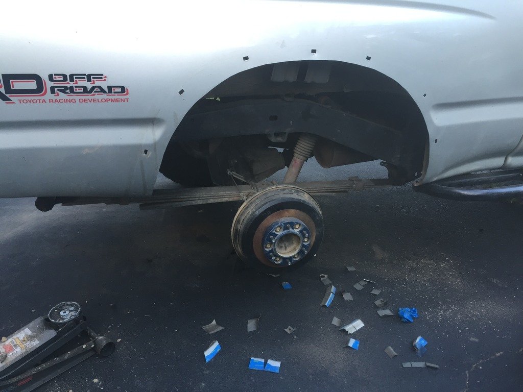

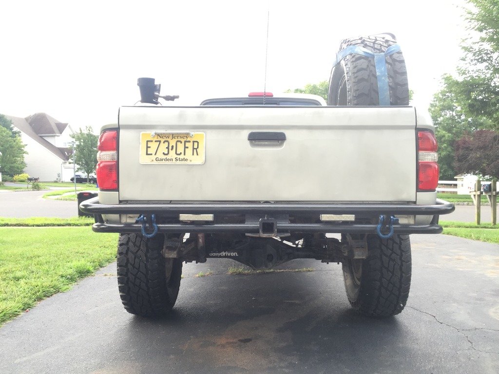

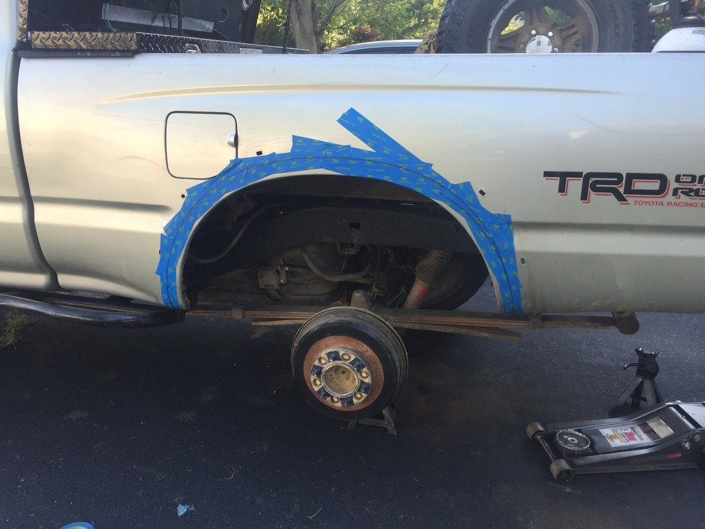

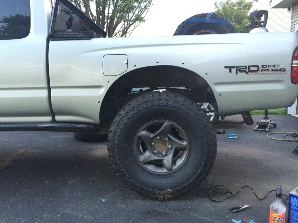

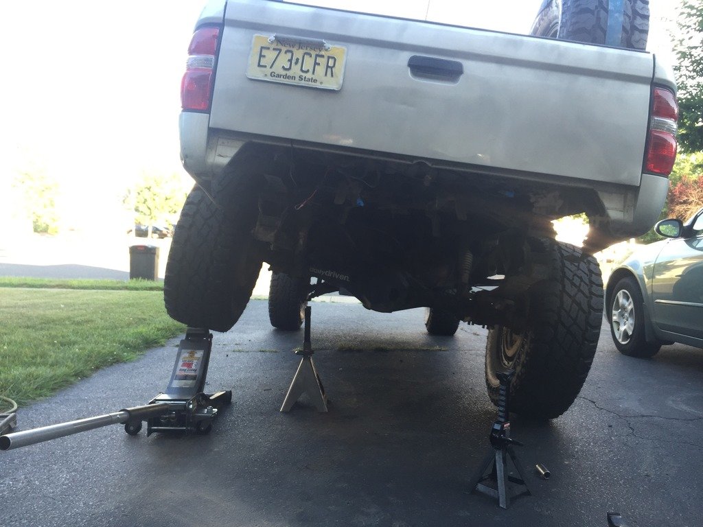

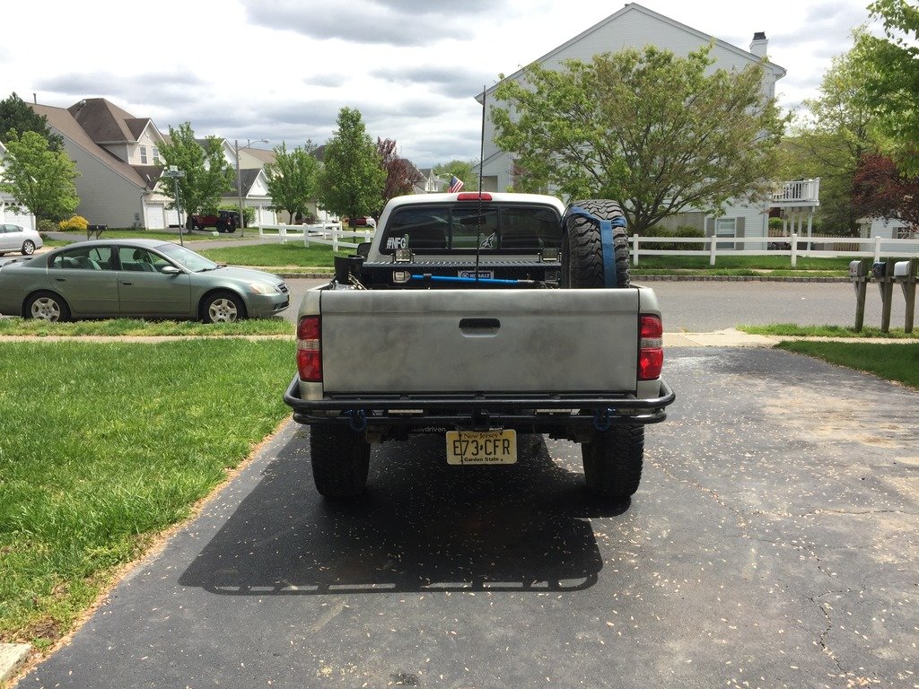

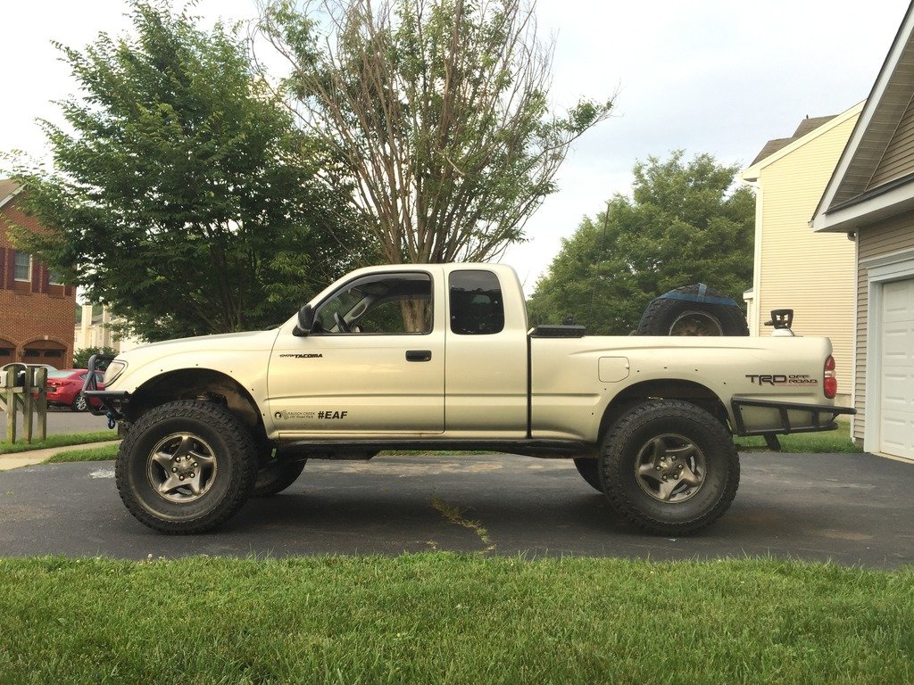

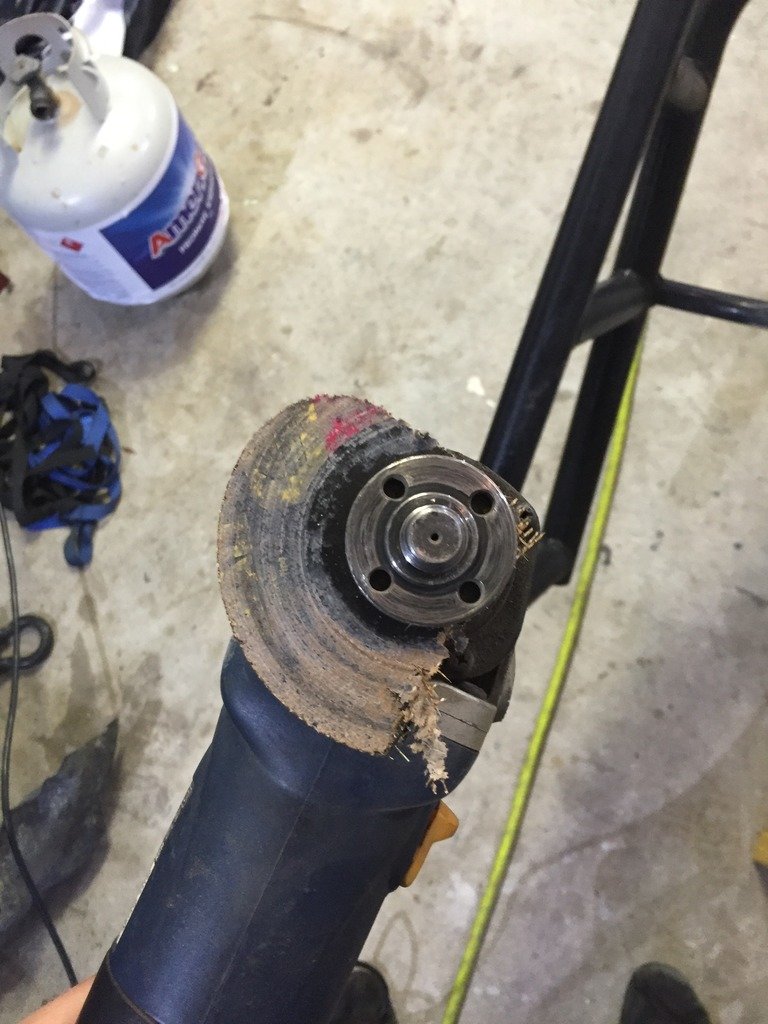

    Finally got to chopping the rear fenders. Came out pretty good and went fast since I already went through it on the front. Took somewhere between 1.5" to 1.75" off the rear.
    Tried to driveway flex and test clearance. Couldn't get it to compress to the bumps but the distance between the bump and top compared to tire and fender were pretty damn close. I should be alright I think. We'll see next week at Takeover. :p
    Side 2:

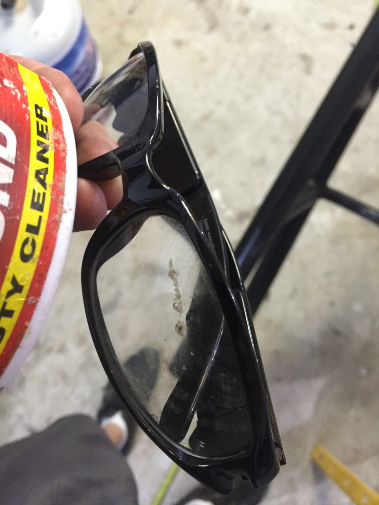

    Also had the cutoff wheel explode on me. Lesson here, wear your glasses kids! Left eye took the brunt of the hit, I've got bruises and swelling all around the eye it knicked on the glasses. Cheek was just a grazing I think.

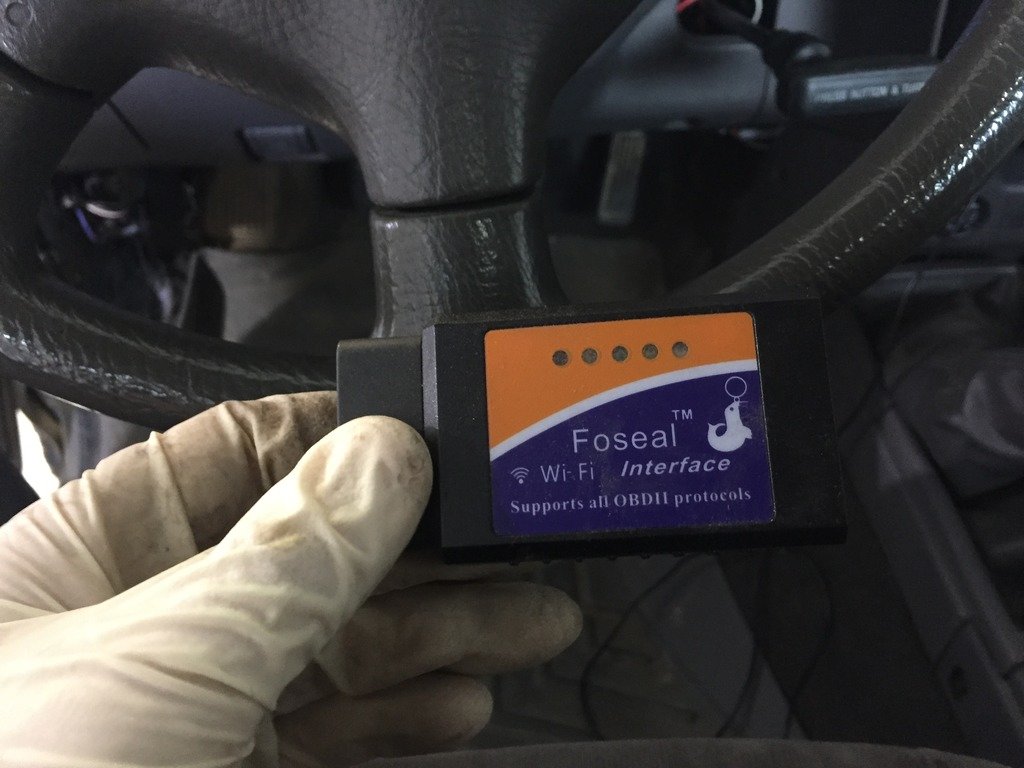

    Also tested this thing out to clear my CEL:
    Worked great for $20 and a free app.

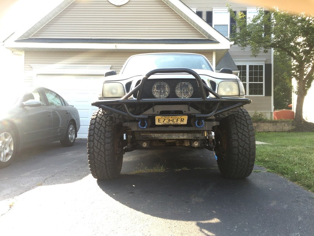

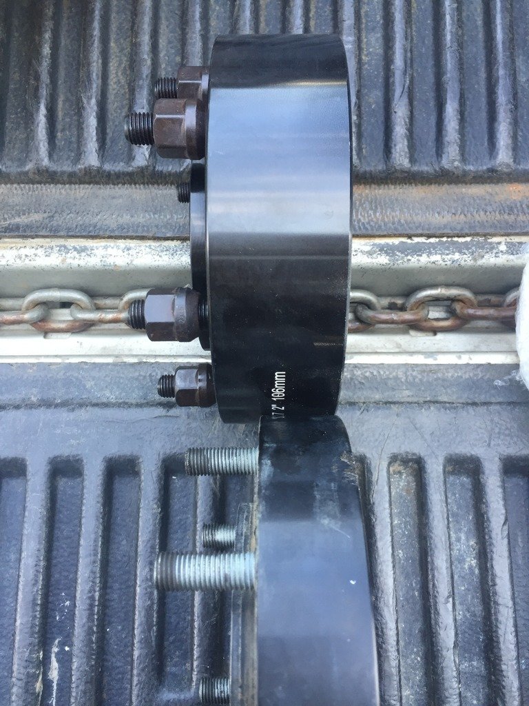

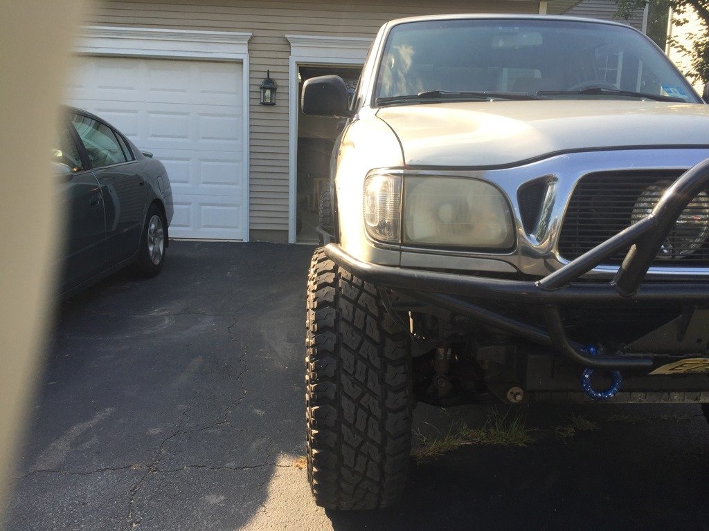

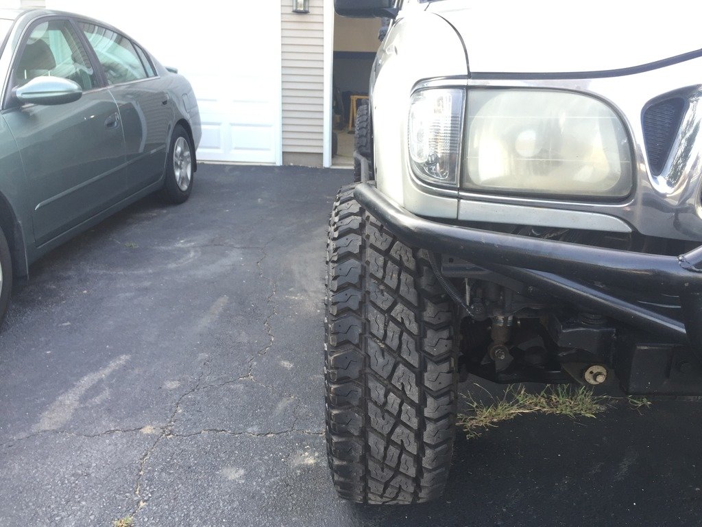

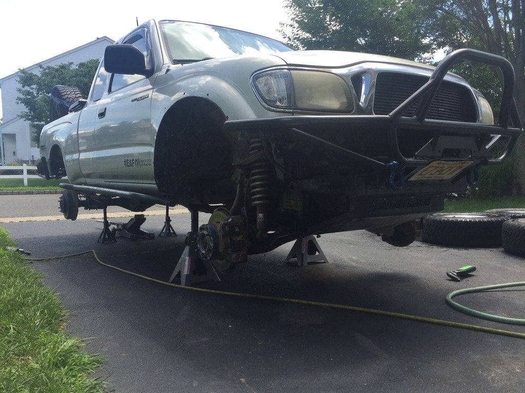

    Well of course I am a week away from the NTC Takeover trip and I am still rushing to get last minute shit done. The new tires threw another issue at me, frame rub. Rausch has some pretty tight trails and losing any turning radius will make the trip much less enjoyable. I am already running 1.25" spacers so what's needed to run stock tires and 35's is 2" spacers.
    Really only a minimal increase but made all my frame rub go away. Some before and afters:
    Also got an alignment done and got a little more caster than before.
    Sub-Zero and ToyRyd04 like this.

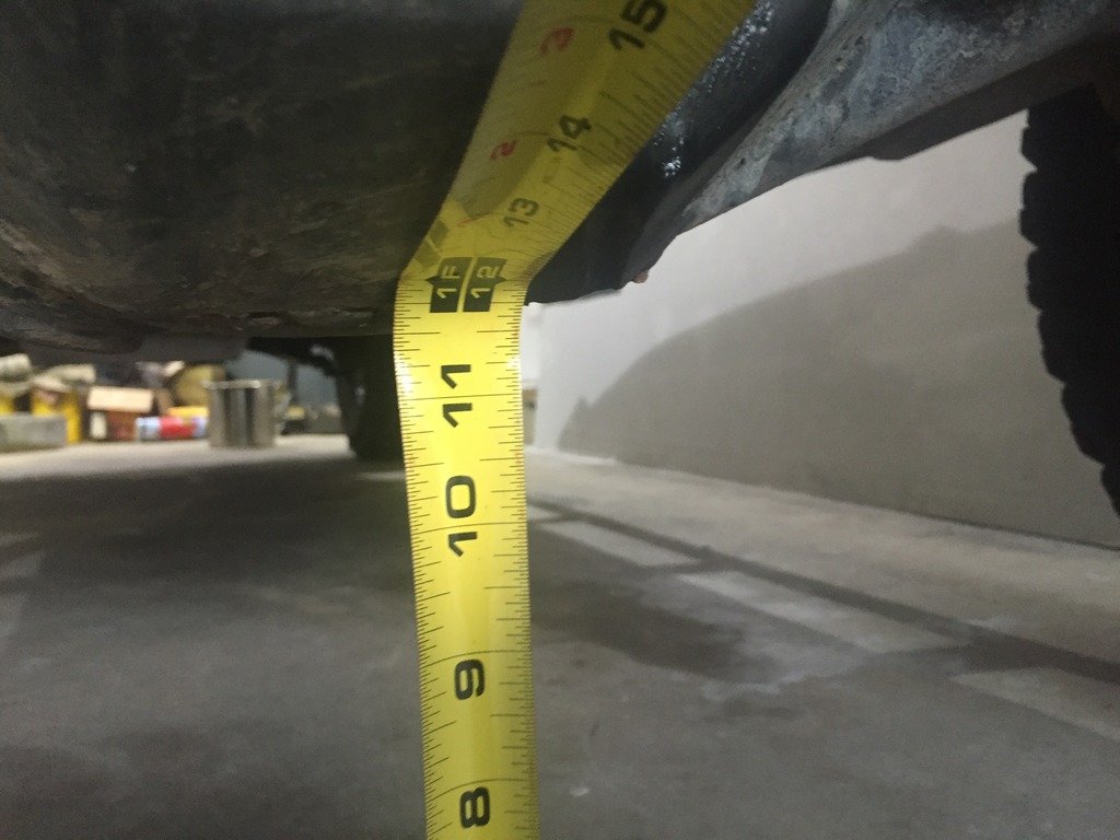

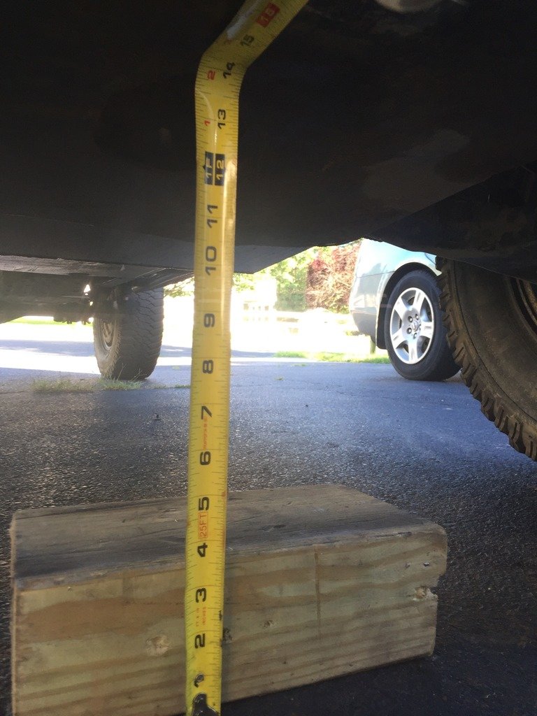

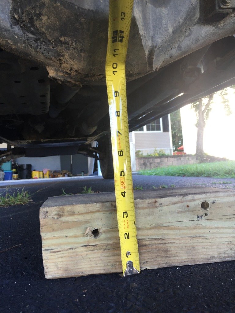

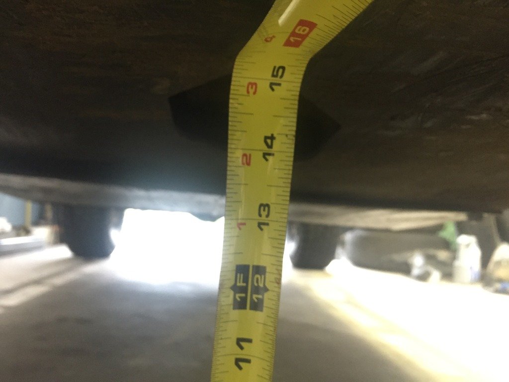

    Got final front skid and rear diff measurements showing the height difference in 265/75r16 to 315/75r16:
    Gained about 1.25" up front and nearly 2" in the rear.

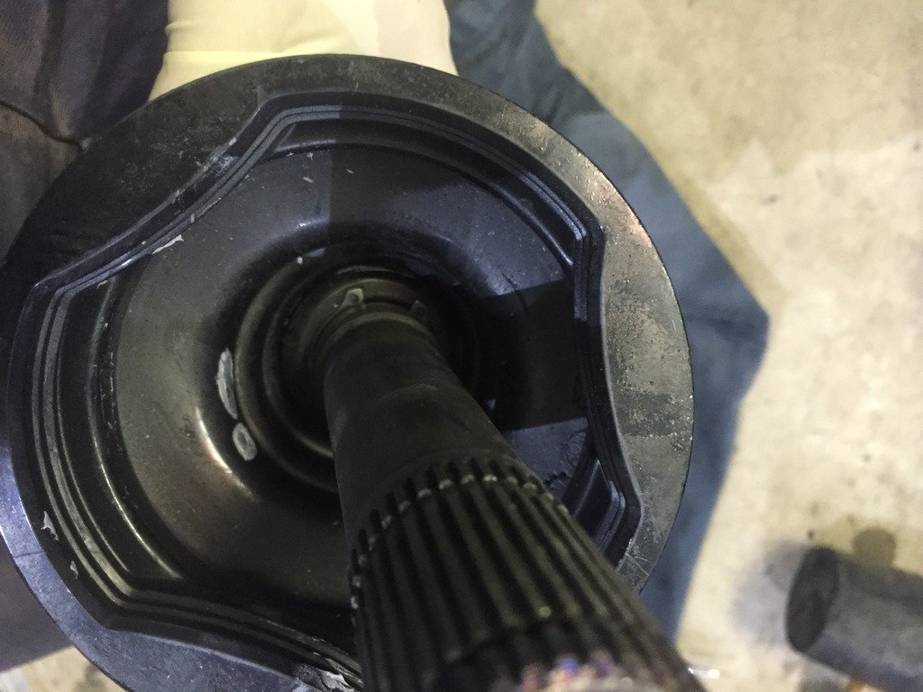

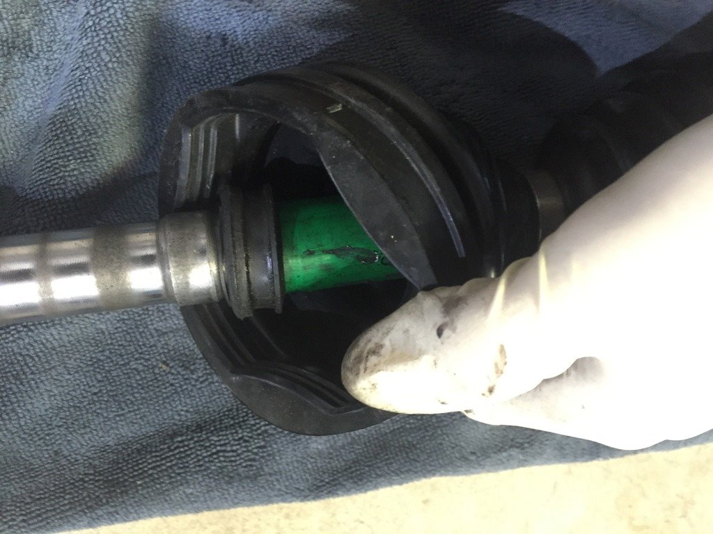

    Also rebuilt my spare cv and did the bootslide mod for takeover.
