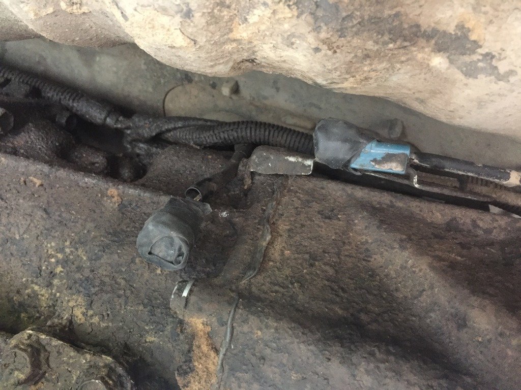

    Ah I never melted anything back there
  2. Oct 24, 2016 at 9:46 AM
    #422
    cynicalrider
    cynicalrider [OP] #NFG
    Jul 25, 2012
    #83399
    17,207
    Jersey
    01 SR5 TRD 4x4, '23 Bronco Wildtrak, 2017 HSQV FE350
    Drop bracket lift and booger welds

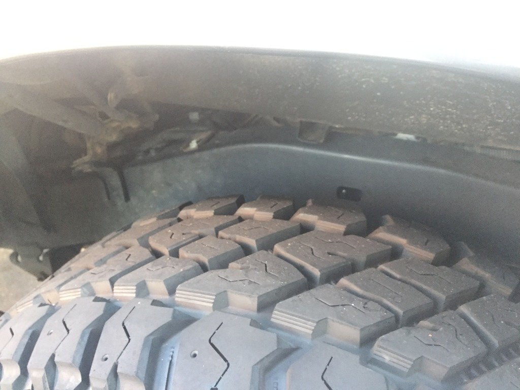

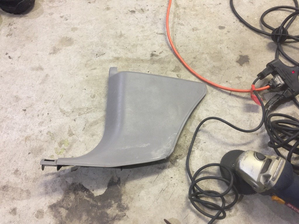

    Don't use a map gas torch :anonymous: your best bet is a stick lighter and using a breaker bar to push in on the plastic while its mallable. You can see it in this pic:

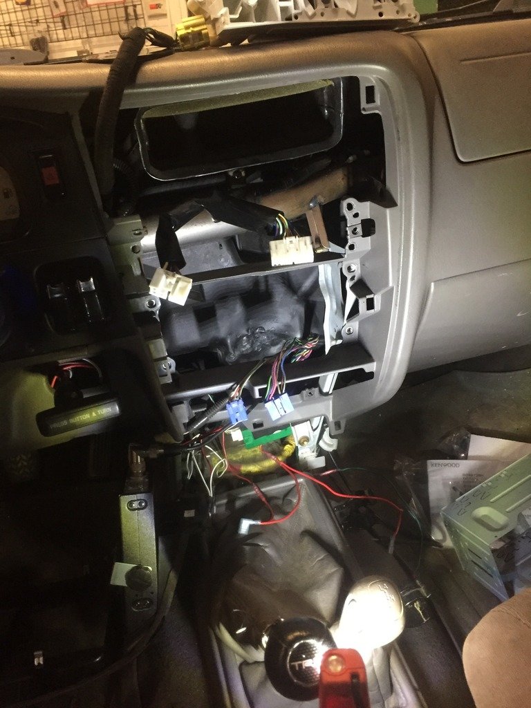

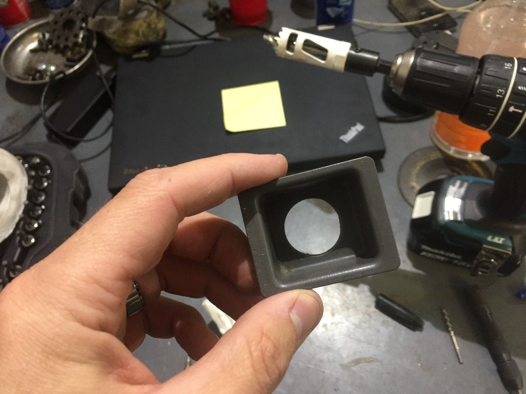

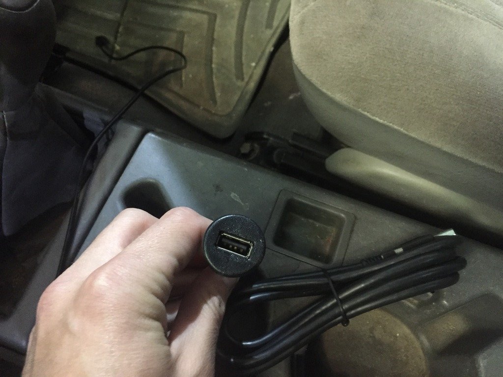

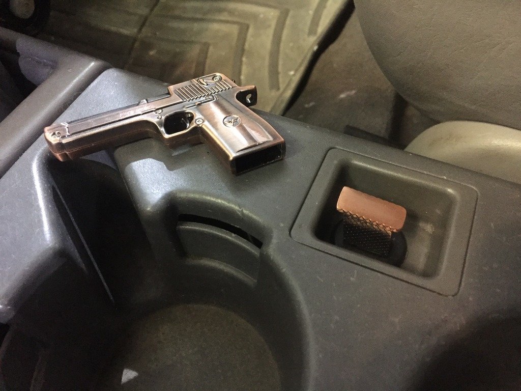

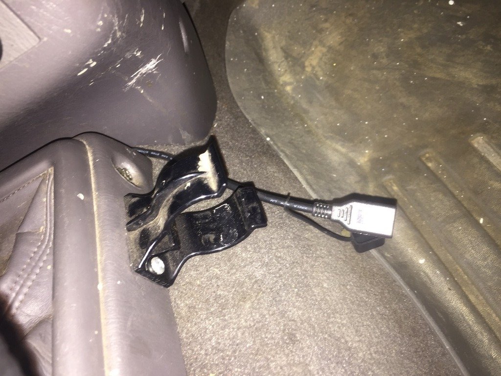

    Installed my USB extension so that the USB for the head unit can be in a more convenient and useful location using an idea I saw in @PcBuilder14's build.
    The USB cable that came with it was actually pretty long. It came out just below the bottom trim area.
    Going to put it in this location since it's otherwise pretty useless IMO.
    My hole saw bit kit made easy work of the drilling. A step bit would have let me be more precise though.
    I routed the wires and glued the piece in and voila.

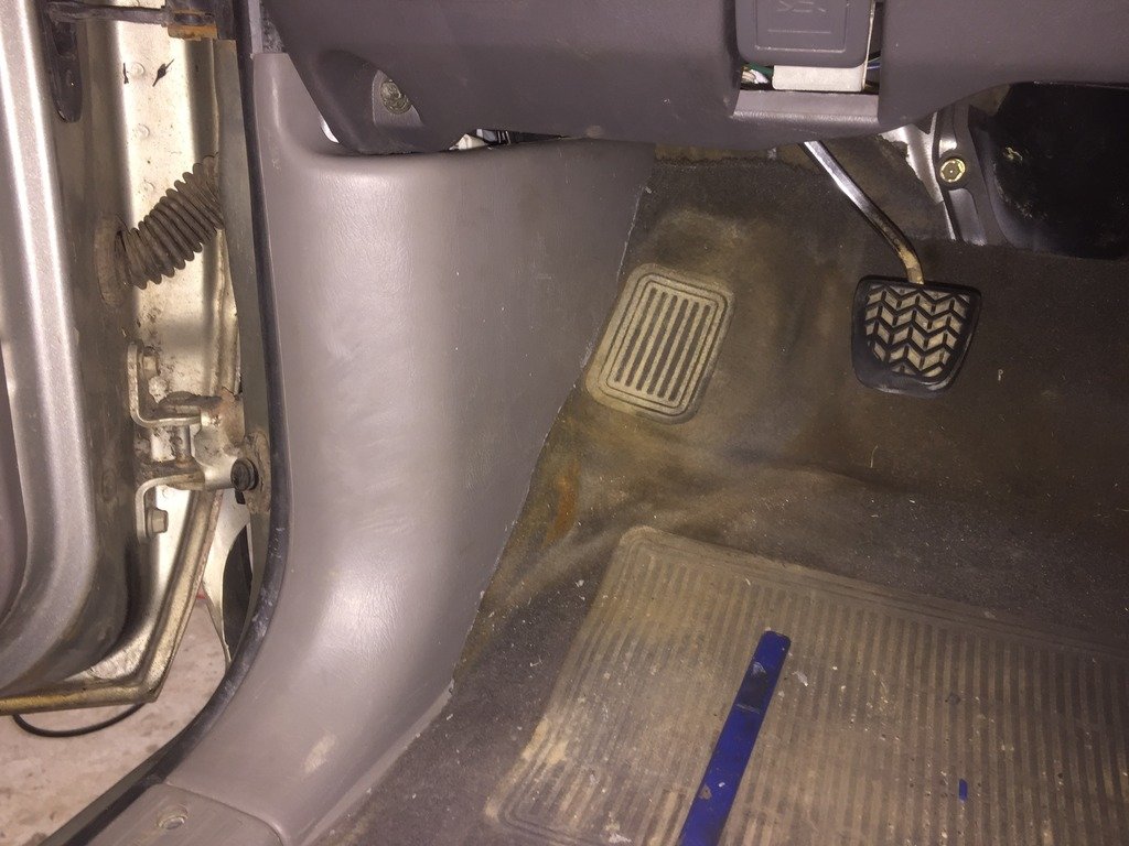

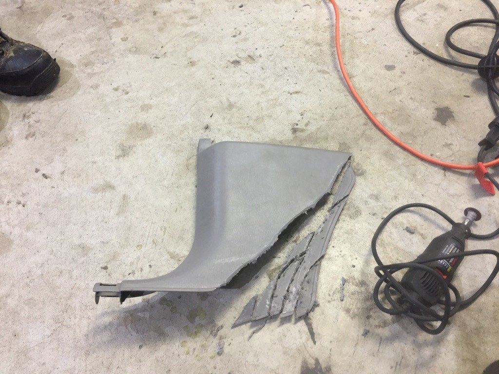

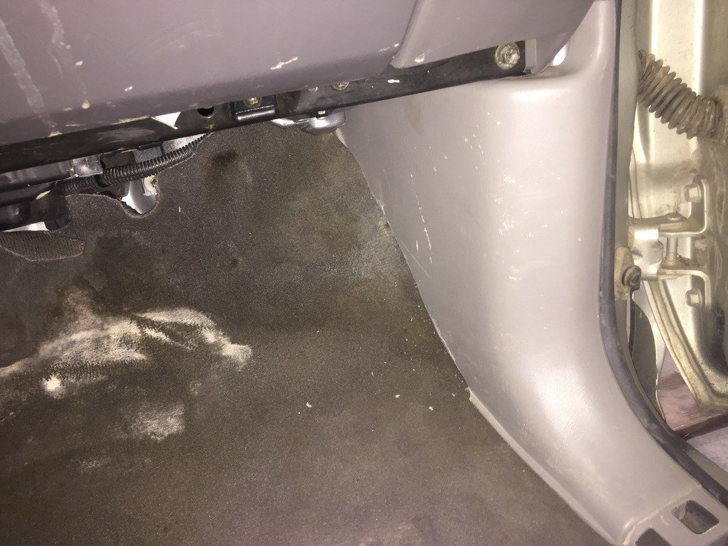

    Next I went to trimming my interior kick panels to fit. They don't fit anymore because of when I tubbed for 35's.
    Lots of marking and testing but it came out nice.
    Also found mold under the one weathertech. Gotta address that now.

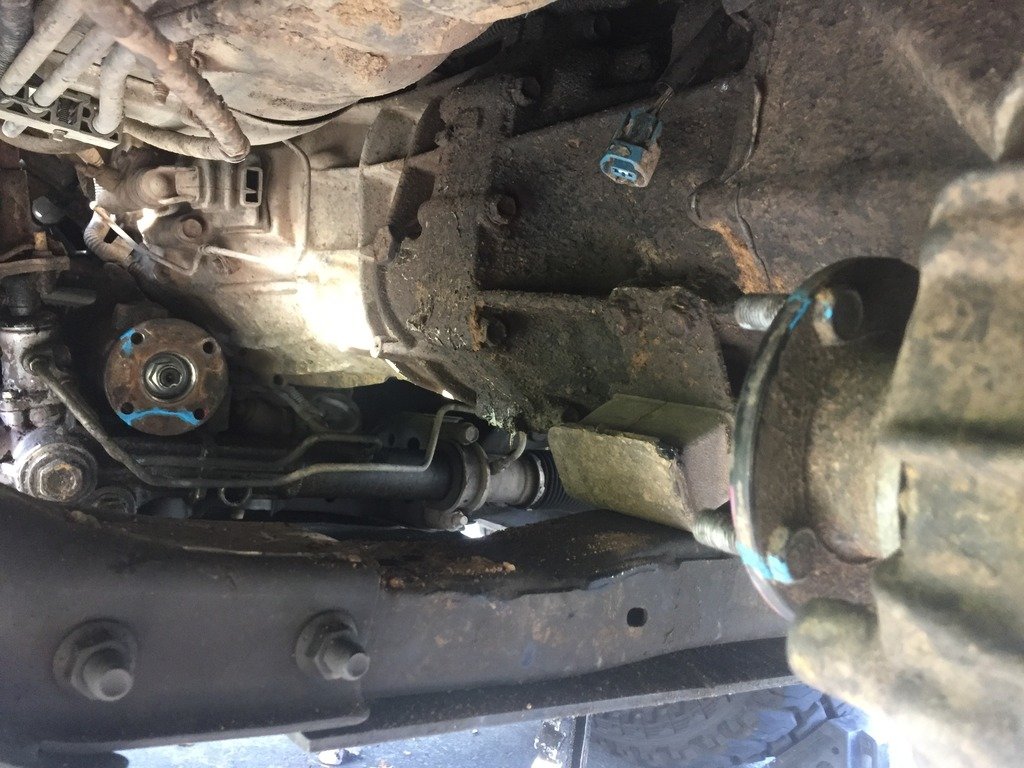

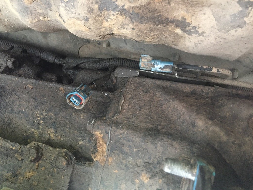

    Prepped for an overlandish camping trip coming up by removing the front drive shaft and finishing the 2 low mod with some weatherproof electrical wrap.

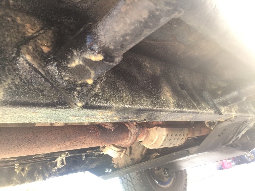

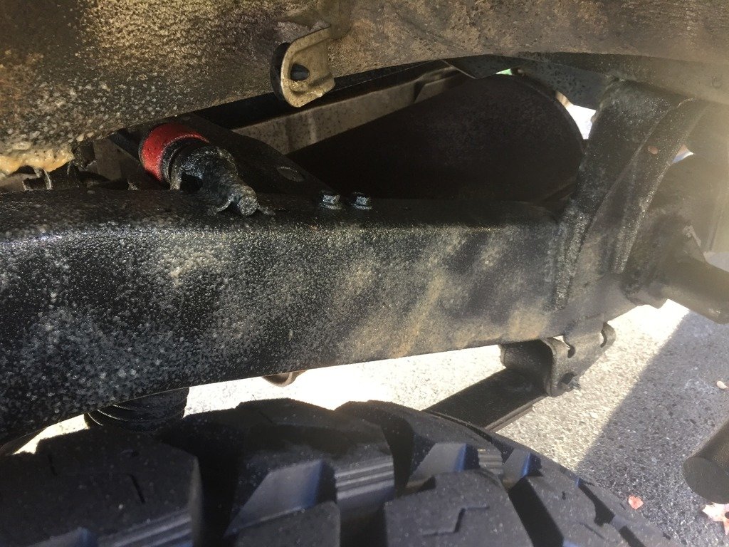

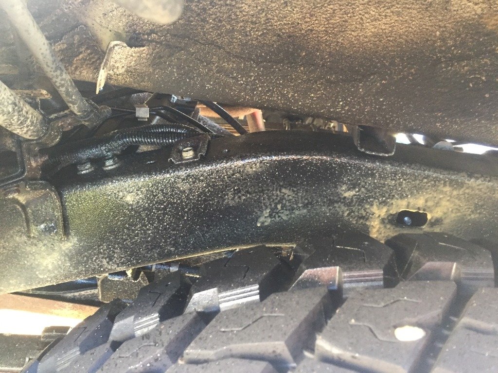

    Fluid filmed the frame to prep for the winter.
    Gonna do whatever I can to make this one last.

    Hey Mike, u used a spray gun for this? or just the can stuff.
  8. Nov 10, 2016 at 11:11 AM
    #428
    cynicalrider
    Jul 25, 2012
    #83399
    17,207
    Jersey
    Just the cans, but will probably go spray gun next year. Much more economical.

    Cool. I tried the rustproof formula 3000 with the spray gun. looked legit at first, but I see it coming off in some places, and it hasn't even been 1 winter. gonna try FF for next year. my frame just like urs was replaced few months ago.
