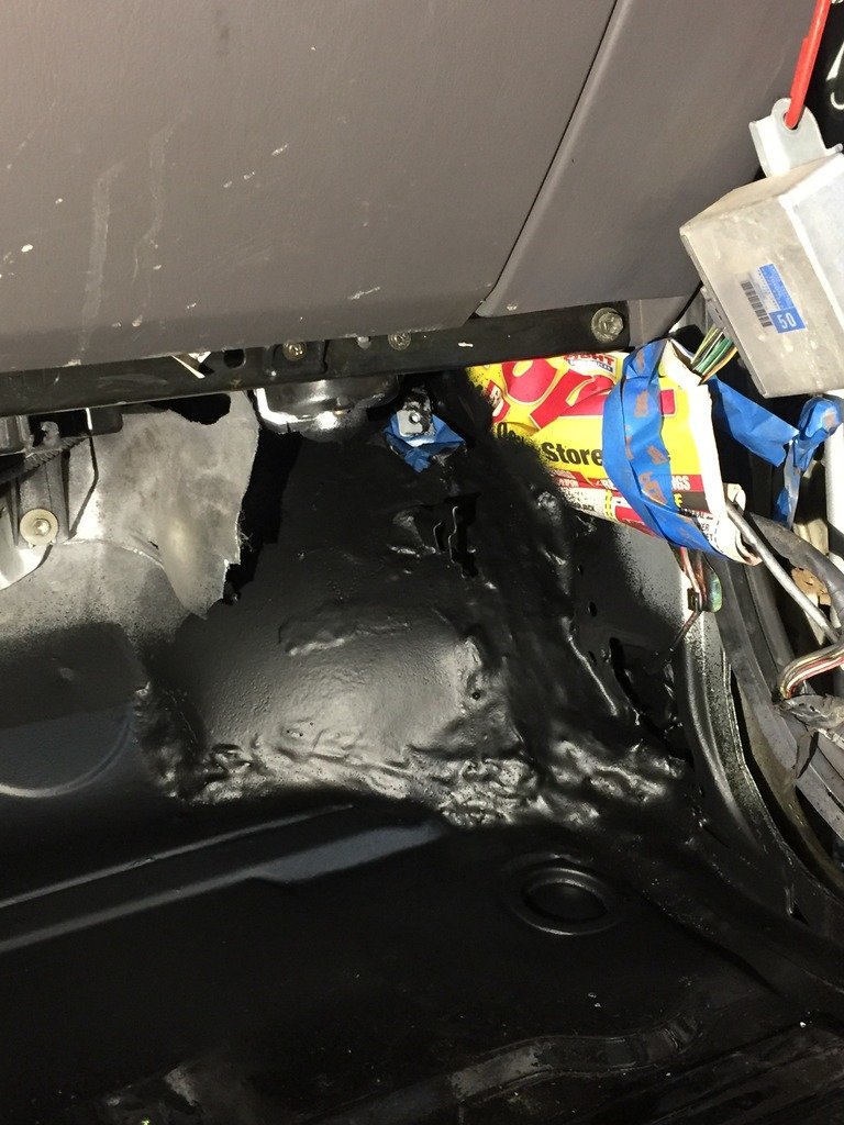

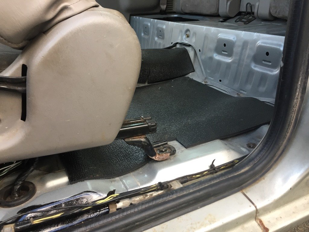

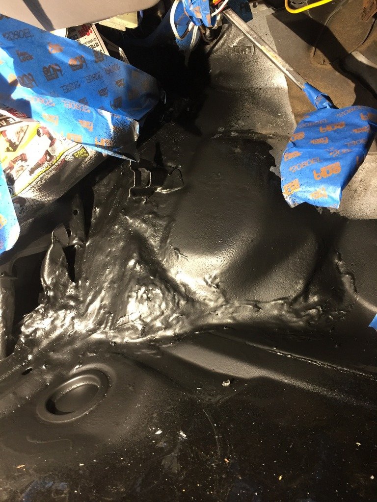

    Finished everything involving the final sealing of the tub. After letting the seam sealer cure I did two coats of flex seal on both sides and a ton inside the cubbies too.
    Only sealing left is going to seam seal all the "drain holes" since if you have that much water in the cab and need to pull the floor anyway, I doubt the "drain holes" would even help much. And also a another round of seam sealer on the grommets that come out of the back of the cab. My cb wire comes out out the one on the passenger side and the ground for the blue sea comes in on the one on the drivers side.

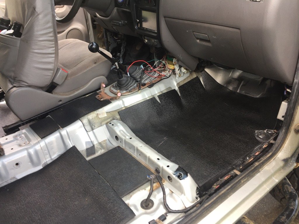

    Next up will be cutting and gluing the matting in place in preparation for a warm enough day to put the vinyl floor in. Getting a little sick of this particular project and just want to finish it but I'm too anal to rush it.

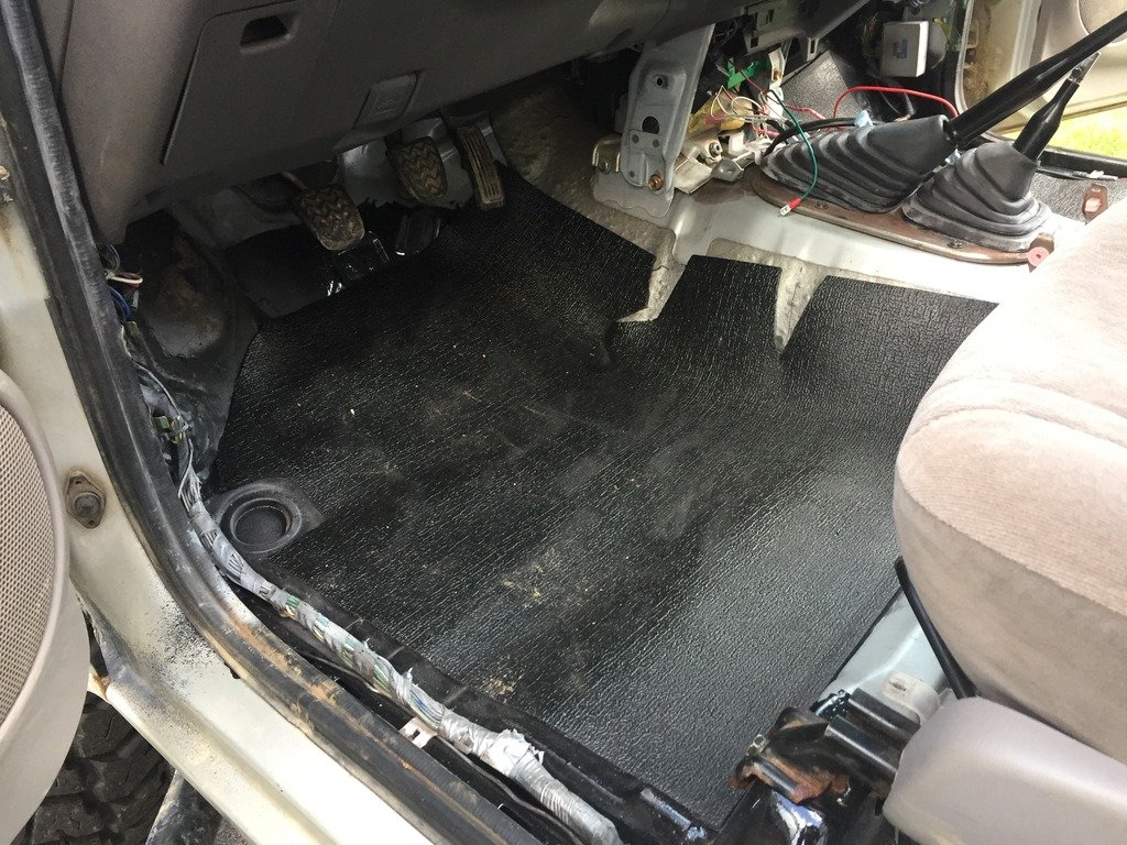

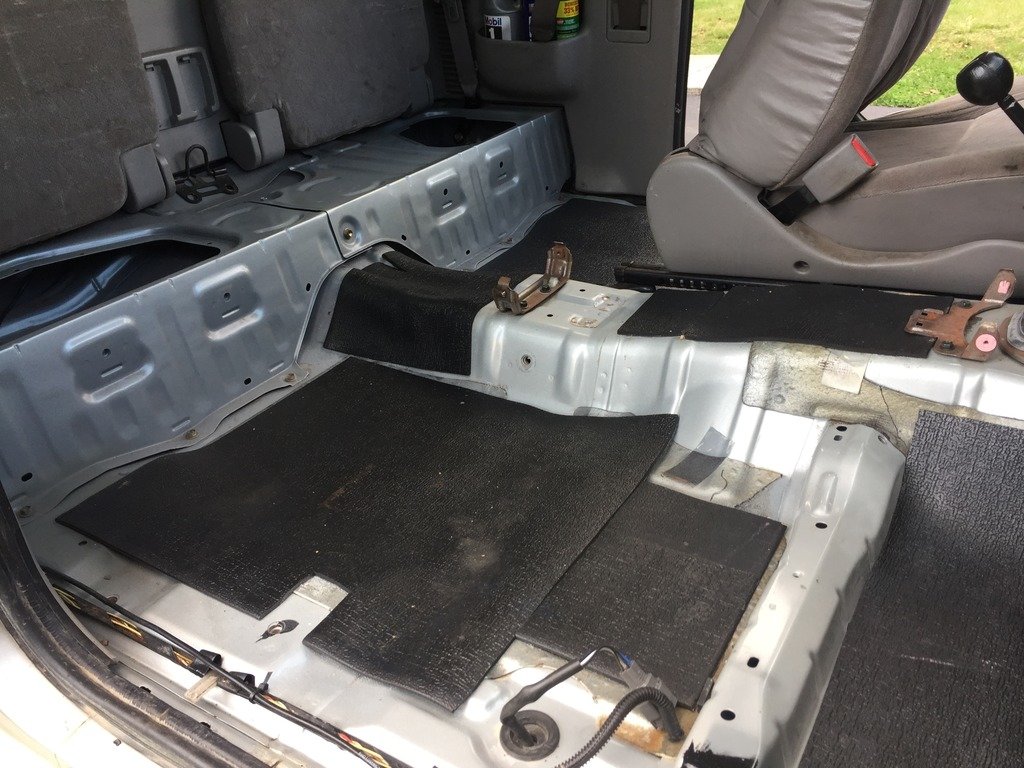

    Build is slow going, waiting on some stuff to be done. Got some stuff to prep for my front end refresh.

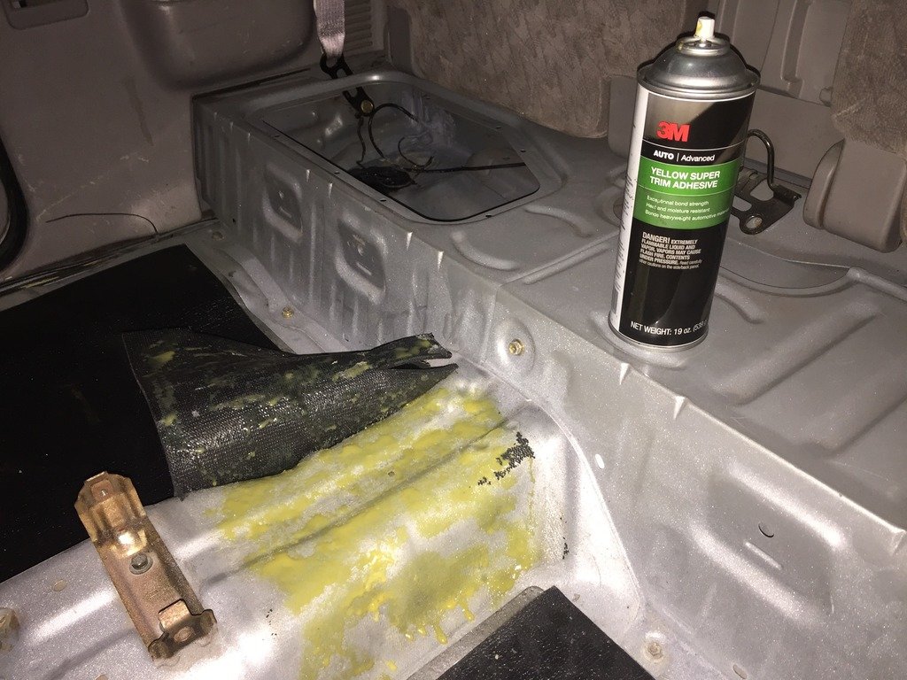

    I cut this up and used 3M super 77 to glue it down. I bought some heavier duty glue automotive grade glue today because some spots were coming up. Only downside is that it's $25 a can.
    https://www.walmart.com/ip/Gold-s-Gym-36-x-78-Equipment-Mat/21672521
    I got it for $5 on clearance.
    Hoping to install the vinyl next week.

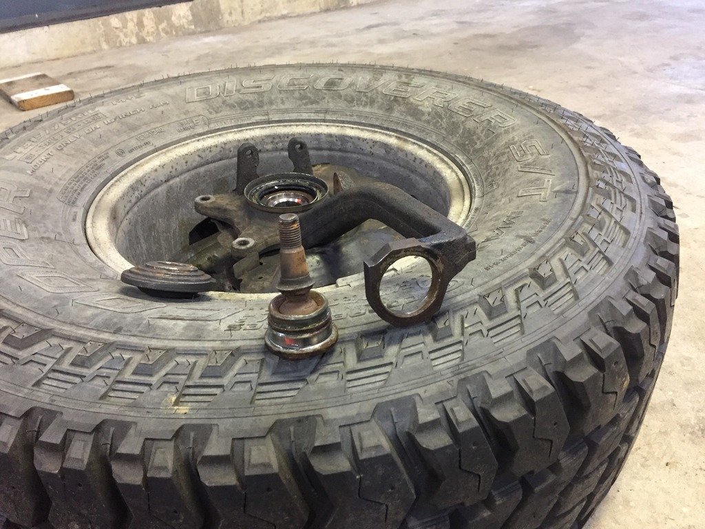

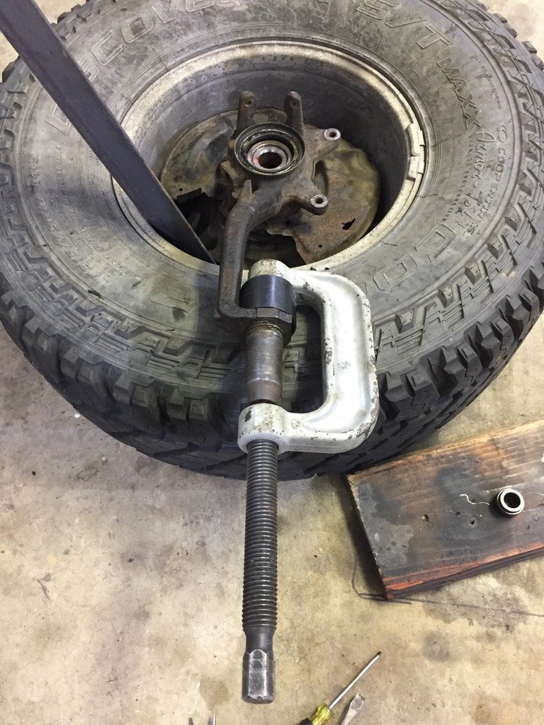

    Then prepped my spare spindles for some gussets by popping out the OEM UBJ's. The one was completely fucked but the other I am keeping as a spare. I have 2 brand new kits ready to go in as well as fresh bearings and seals. Hoping to not need to fuck with anything spindle or bearing related for another 200k.
    Rented the ball joint press and an additional adapter set from autozone. The adapter set was definitely needed so I'm glad I got it as a precaution.

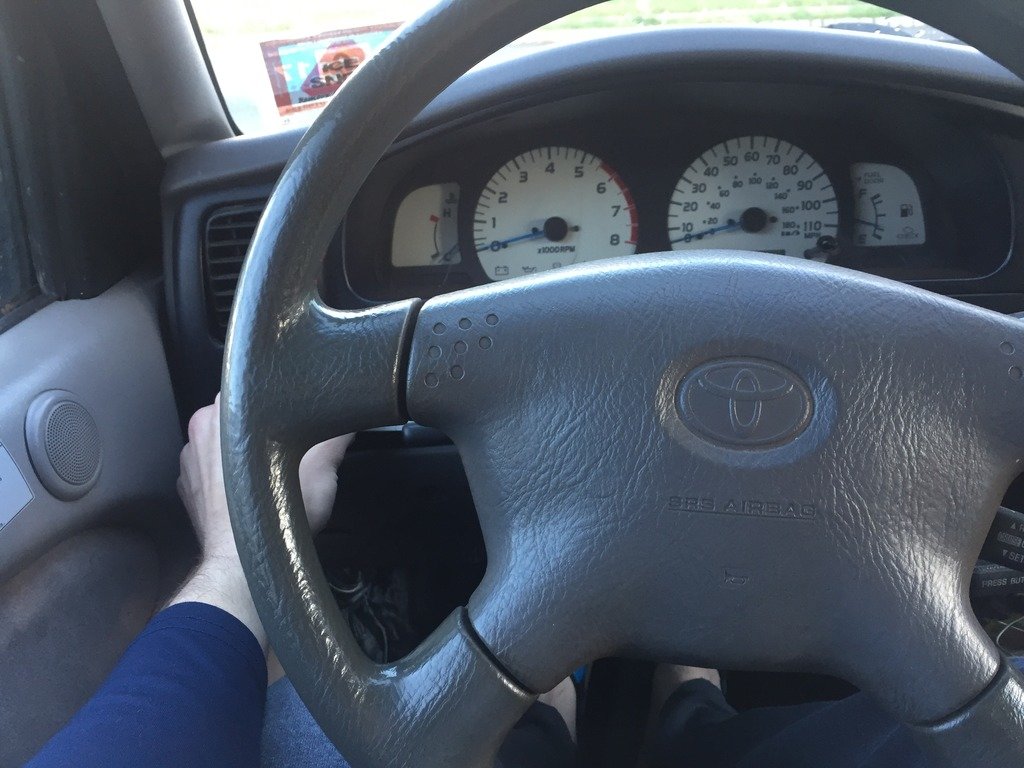

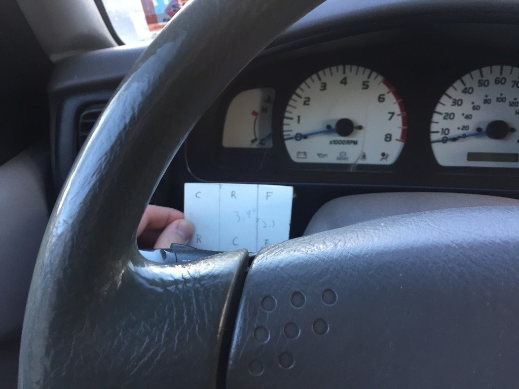

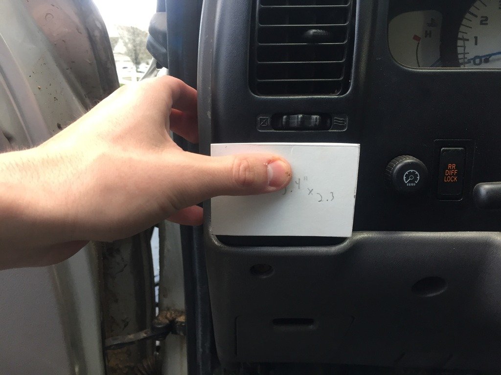

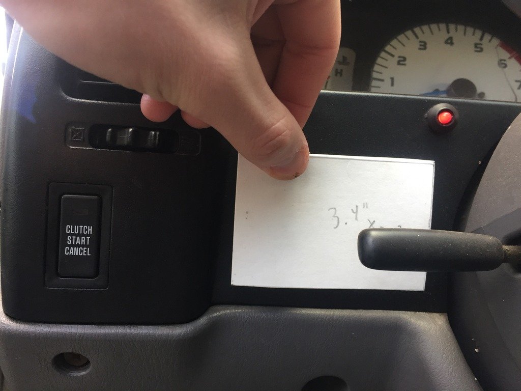

    So after some switch theorizing in @jubei777 's thread, this seems like the route I may go.
    Originally I wanted to put my FR and RR locker where our clutch start cancel switch is, move the clutch start cancel to where the locker switch is and call it good. BUT this would need me to find a home for a compressor switch. So I thought I could fit all 3 in that clutch start cancel location.
    Nope.
    Way too big for the space.
    Next I thought, okay move the dimmer next to the clutch start cancel switch and put the locker switches here:
    Perfect! But what I hate about the current locker location is how I can't see it when I sit at the wheel.

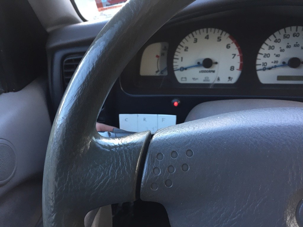

    So I figured maybe I can order them in a way of most to least important. Let's face it, FR locker is absolute emergency use, and the compressor only gets used airing up (done from outside of vehicle anyway) or when using the rarely used front locker.
    So these are the two orders, and the first pic depicts what I see if I lean up a little bit to look at the top of the switches too:
    So the orders are Rear Compressor Front (Order of use typically)
    or Compressor Rear Front (Keeping lockers together)
    Not sure what to do now.

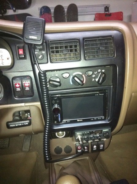

    uhh..better idea..
    Both locker switches where the clock is..
    put the compressor switch where the rear diff lock OEM switch is.
    Done!

    I like your first idea.
    The rear is what is gonna get used more often than not, so I wouldn't want that switch in between the other two.
    Totally personal preference, though.

    Two switches in the clock already. :p Those were my first I ever installed.
    R C F you mean? The other option is my first first option, 2 switches in the clutch start cancel spot, and temp locate my compressor switch. Ideally I will do an overhead 5 switch panel like @sander1036 (except mine would be wired to some shit unlike his :p) when I redo all my electrical but that's at least a year away.

    R on whatever side works best for you. Just not in between the others that don't get used as much.

    Double din and 520xl in the ash tray. :p
    Looks like a 95.5 or 99 dash, that doesn't match mine Steve. :p
    But no answer is a wrong answer! Keep the ideas flowing.

    Currently a tiny switch for my antenna. I know Jason put some switches in that spot vertically but fitment was much to be desired IMO as seen here:
    And I'm not a fan of running them horizontally. I'll have to take another look at that spot in the morning though. It would def make my antenna switch look cleaner too since I can swap that for an otrattw one. Also thinking about a paranoid fab bracket mounting under my cb similar to how I used his bracket in my tool box. I also thought about the left side of the steering wheel again but high up so it's just under the dash. I would need to put in some sort of plate to block the old holes from the old switch location and dimmer knob though.
