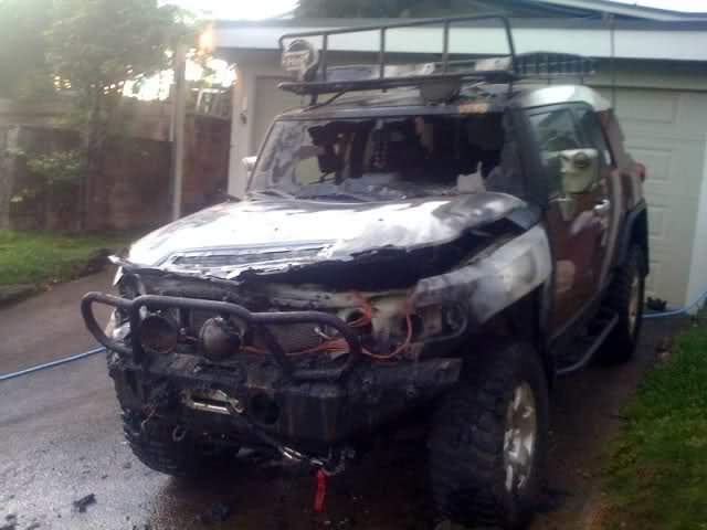

    I'd suggest it no matter what or definilty install a fuse in the power wire for the winch. That pic is what happens when large gauge wire shorts out

    Also. If the winch solenoid acts up and engages while your driving or the truck is in the garage while your at work it will run until it binds up then over heat and with direct feed from the battery it will have enough juice to start a fire. That's why I chose shutoff solenoid over just a fuse.
    @Reh5108 had some experience with this
    jubei and Reh5108 like this.

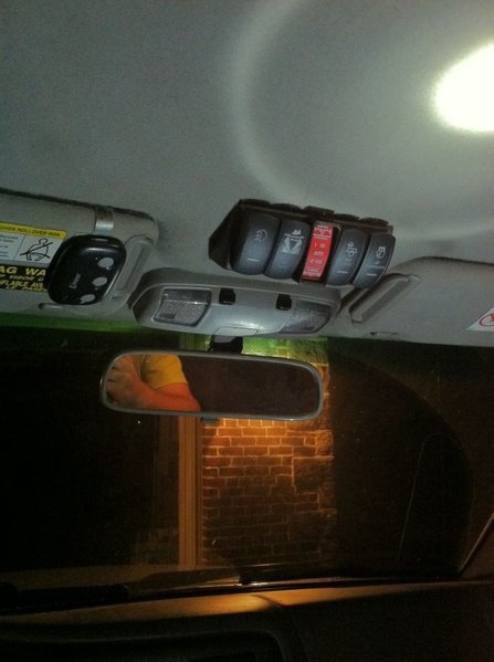

    So then new mapping would be:
    Panel Left in old clutch start cancel location:
    Rear locker | Front Locker
    Panel overhead similar to Steve's:
    Light Bar | Ditch Lights | Battery isolator | Rock lights | Winch power
    Clock:
    Spots | AUX Reverse
    Paranoid panel:
    Compressor | Antenna | Blank | Blank

    My wireless receiver shorted out and engaged the winch. Luckily the winch was not engaged. I really need to add a power switch. But until then I'll just keep the winch disengaged.

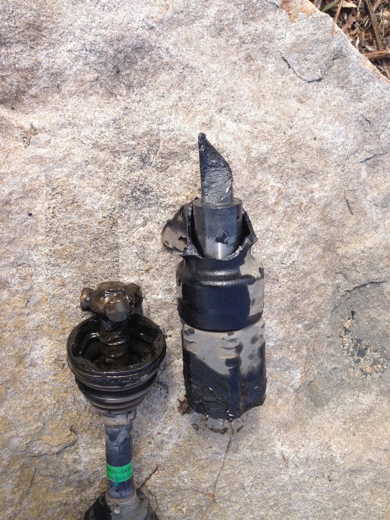

    Ant broke his ADD tube when he had one of his wheels locked inside a rock on yellow jacket.
    2427325B-CBB6-4224-9C06-5F3EDFA4F842_zps_c8943eddcd04c88ef7b44f211dde85247cf05afb.jpg
    And seen some NE first gens blow CV's, I'd have to dig up the video. I know he was goosing it though. I also know it's typically when a wheel is turned that a CV will go since it's binded up. When did you blow a CV?
