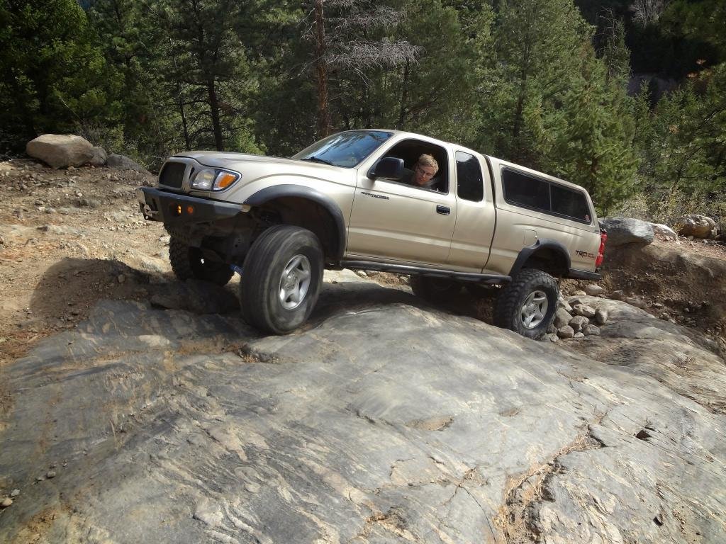

    A foot to the left and I wasn't getting anywhere but then I found the sweet spot.
    @Squeaky Penguin did you say you made it up this open before?
    So Sunday we bang your skid out quick and go play?
    Sorry to clog your thread Mike!

    No. I've always had a rear locker. No idea if I had to use it there or not. I took a very different line though:
    Reh5108[QUOTED] likes this.

    This is another reason why i like the ARB/Harrop over the OEM elocker. Instant engagement. I never lock mine until its needed. Instantly locks. Try it again..go right over. unlock it.
    A lot of the factory elockers take a bit to engage so that isn't really an option so people will lock it just before the obstacle.
    Not a bad way to do it..just different.
    I don't have a front locker so can't say about using it more then the rear. But considering what it does to your steering..that isn't always the best option in some situations. But I can see it being super helpful vs the rear.

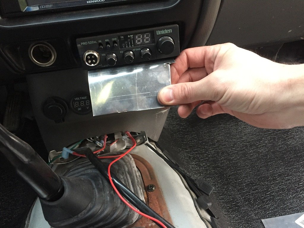

    So I did some quick prototyping on my switch situation. Ideally I can mount the paranoid panel right to my CB. It's already in there super tight, and can even beef up the mounts holding it on as well. The only downside is that it would block the speaker which I am okay with, I can get an external speaker then which I have been wanting to get and mount on the pillar behind my head.

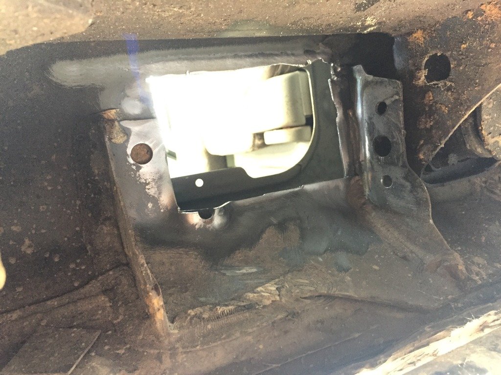

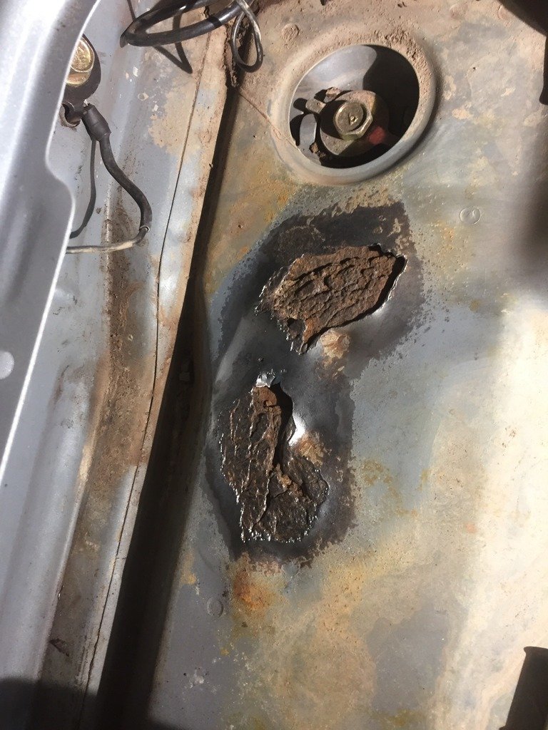

    Did some work with @Sub-Zero yesterday thanks to his welding skills. I may not be able to weld but I can cut holes into my truck and grind like a mofo. :p
    I had really bad rust in the cubbies in the back of the cab. Apparently under the cab there are gussets for the body but there are pockets where salt and water can get trapped in, hence the rust. This is what I found originally.
    So we were going to just cut the body skin but the entire gusset was fucked. I cut it all out to try to get rid of all of the rust. We decided 3/16 plate can be used to bring strength back to the gusset. We were going to skin it with 20 ga afterwards but Ryan sealed it all up really nicely so we decided it wasn't necessary.
    Next I'll prime and seam seal it all just in case.

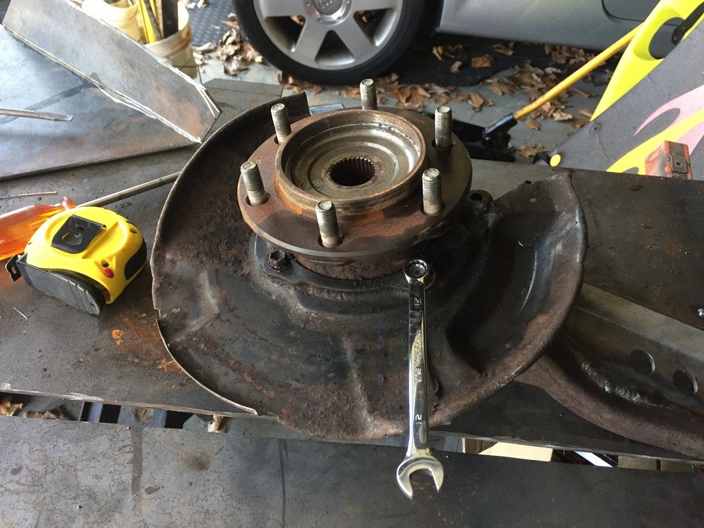

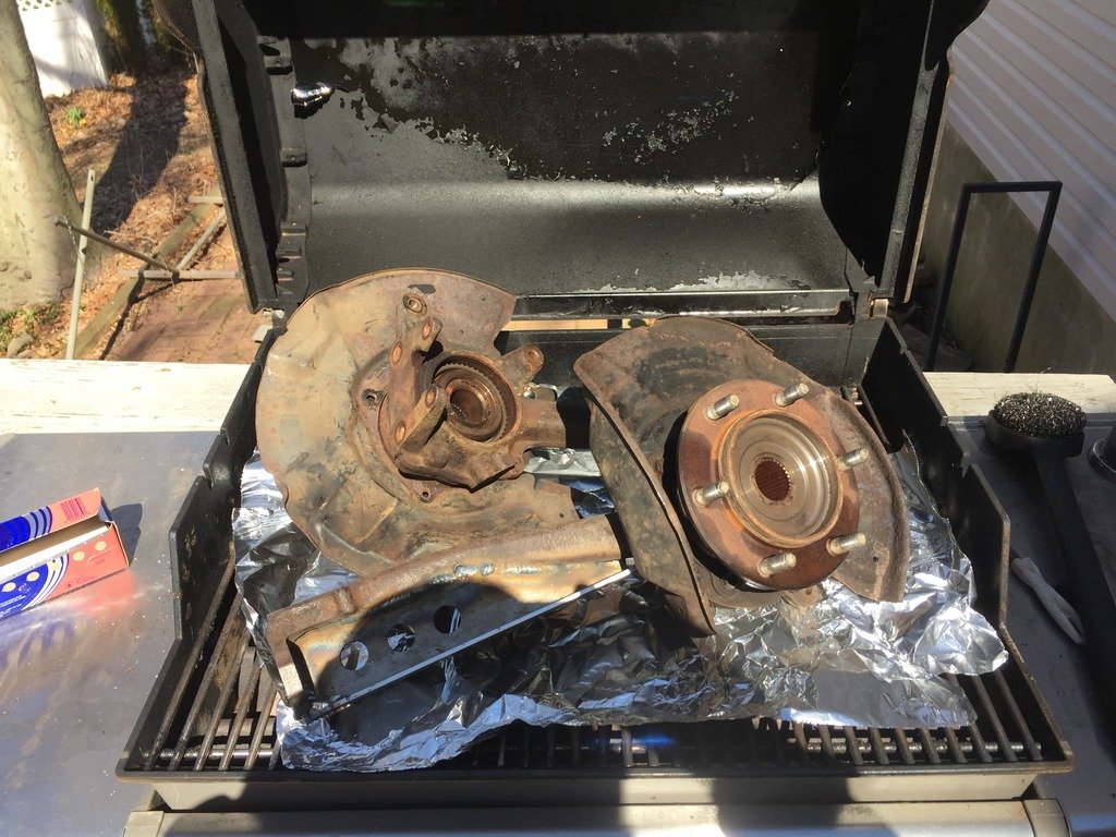

    The other thing we did was my spindle gussets. We took out the outer seals from the bearings and threw everything on the grill and let it heat up to 500 degrees. I'm sure this fucked the inner seal and burned the grease out of the bearings but I have fresh sets of everything waiting to go in.
    They came out great!
    We then preheated the grill again and put the spindles back on and turned the heat off. They cooled slowly inside the grill.

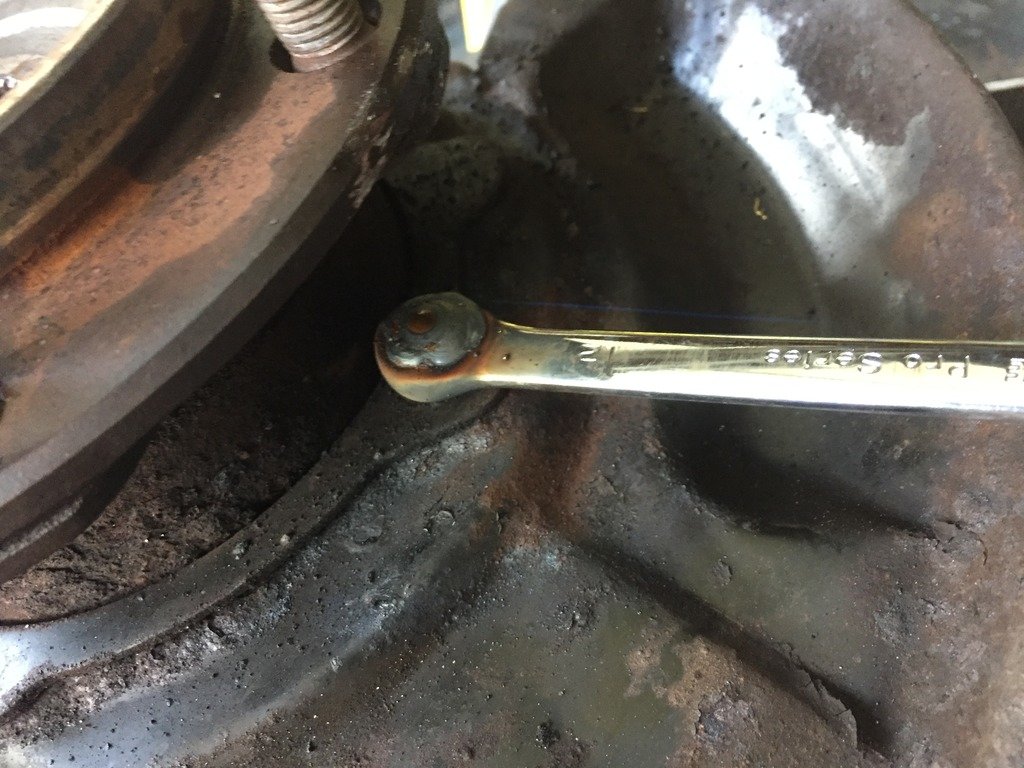

    I rounded one of my bolt heads on the dust shield so we sacrificed one of my 12mm's to get it out. It worked awesome.
    It broke free and then we cut the end of the wrench off and it spun right out.
