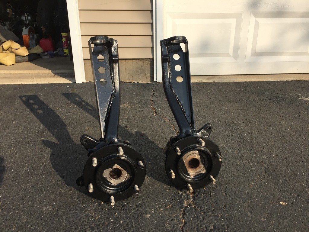

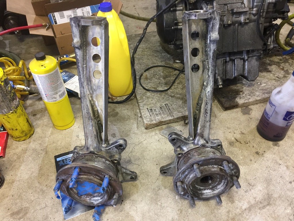

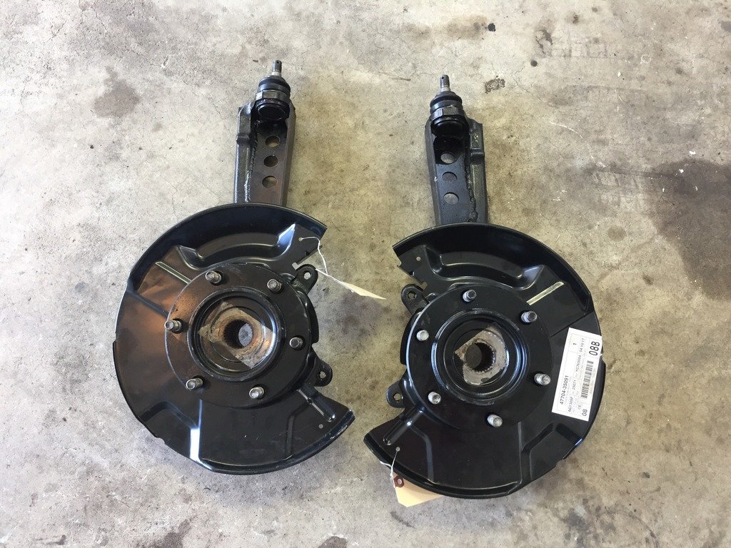

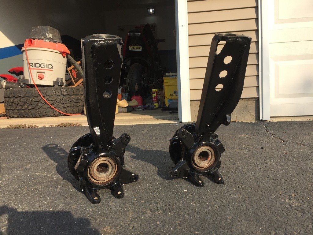

    Some progress.
    Wire wheeled the fuck out of the spindle and prepped it for paint. Hit it with some phosphotizing too.
    Primed and painted.
    Dropped it off for final assembly.

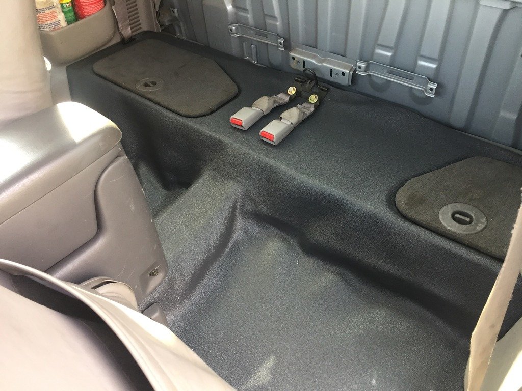

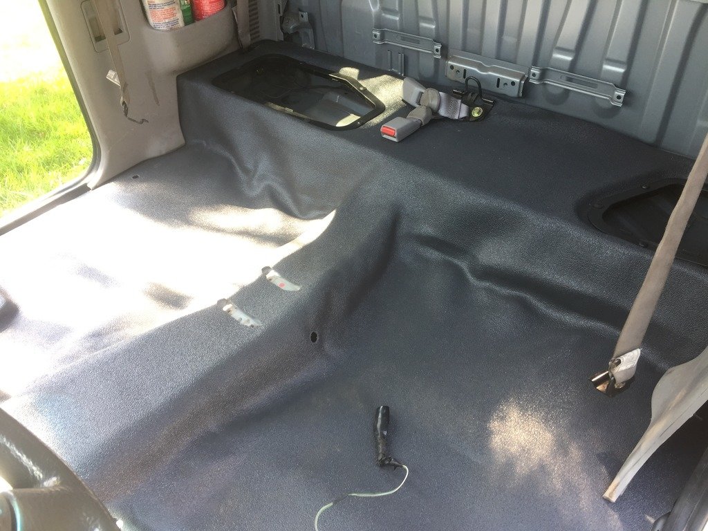

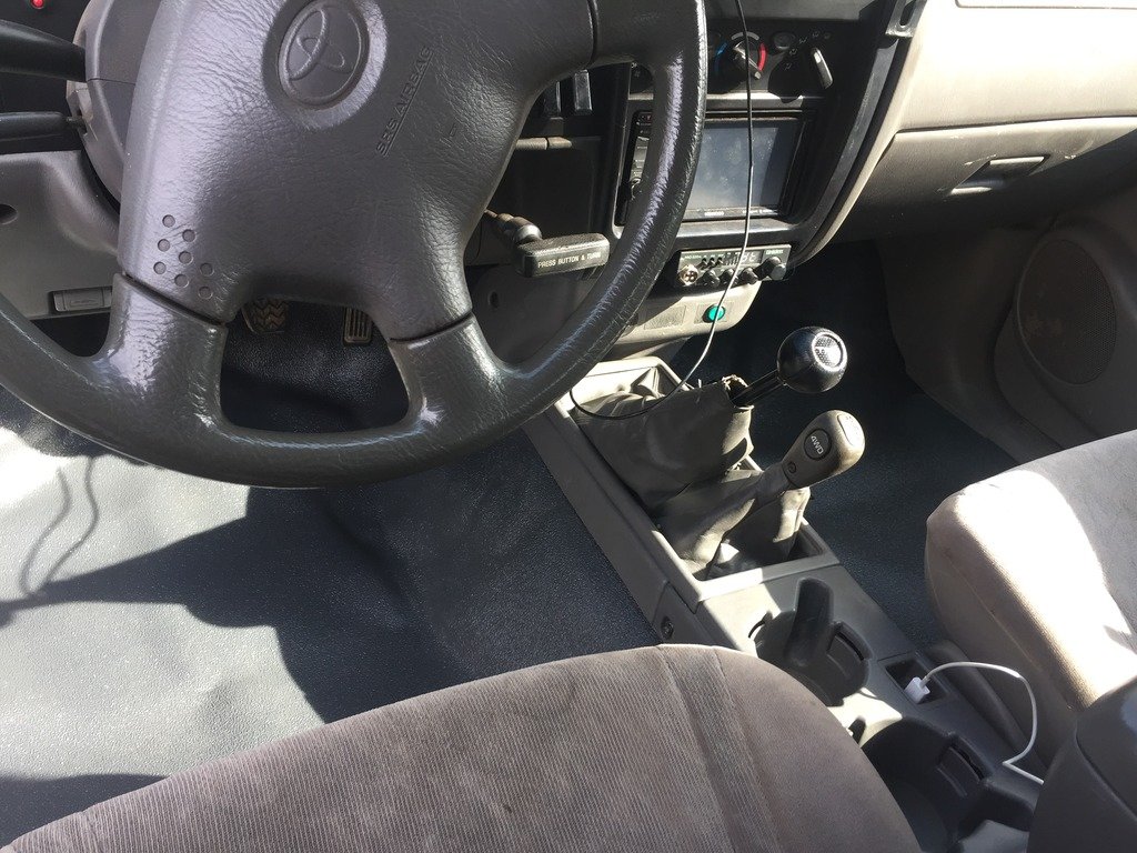

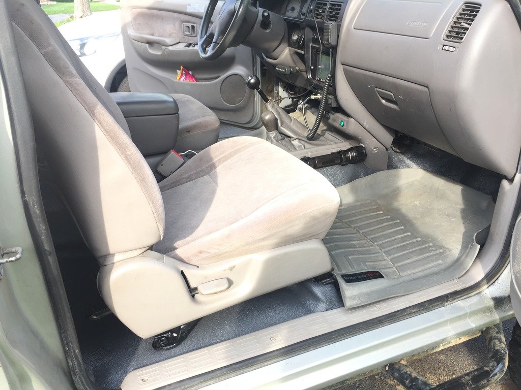

    Next up was finishing my vinyl floor install. This was a huge pain in the ass. Even though it's "molded" to our trucks, getting everything to line up is a bitch. Also they give you excess and you need to cut it to fit perfect. Also there are no holes so you need to make all your own. I am not 100% happy with the fit but it's the best I got it.
    This is how I had it sitting before I started reassembly.

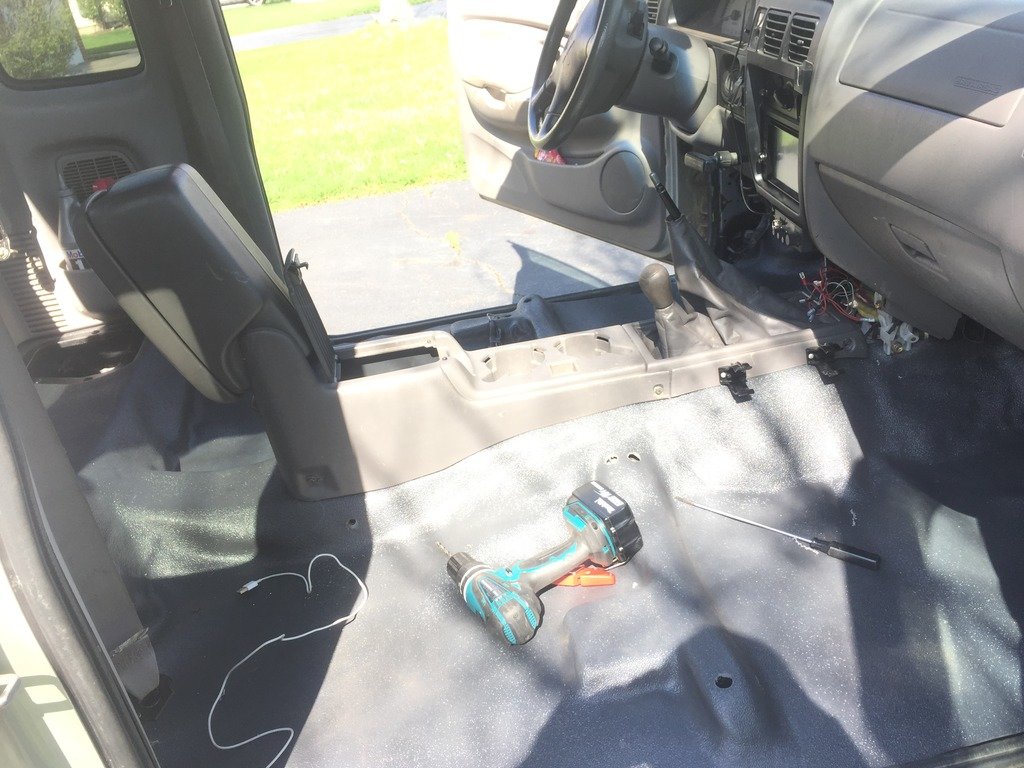

    I had to do a bit of work to get the center console stuff to sit lower. Mostly grinding plastic/metal and drilling new holes. I had to do this because I had no jute padding underneath like you would for the carpet and i didn't want a shit gap and have everything floating an inch in the air.
    I still need to do the lid covers.
    This side is all buttoned up. Drivers side is waiting on another project.

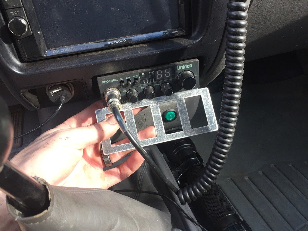

    Got my second paranoid panel today. Thanks @paranoid56 ! Going to actually mount it to my CB for my future switches.
    I compared it to the switches I have in my tool box and the buttons should clear the CB controls nicely.

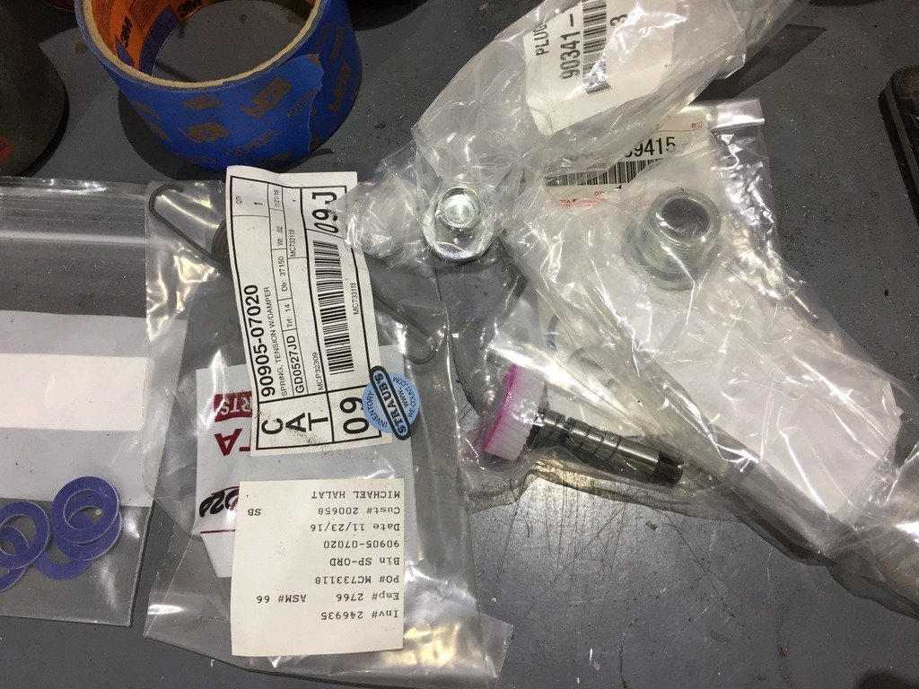

    Also got my 33 tooth and new front diff drain and fill plugs from Toyota in preparation for my diffs!

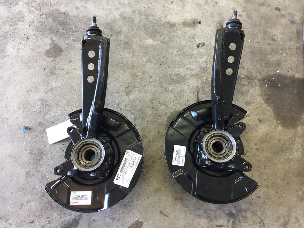

    Jersey
    01 SR5 TRD 4x4, '23 Bronco Wildtrak, 2017 HSQV FE350
    Drop bracket lift and booger welds
    Spindles now have all new OEM UBJ's, shields, bearings, and seals. Hoping to be good with this setup for 100k miles of dirt.
