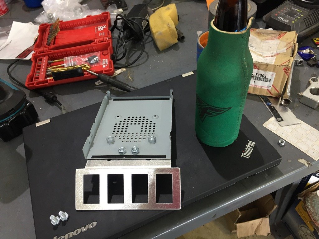

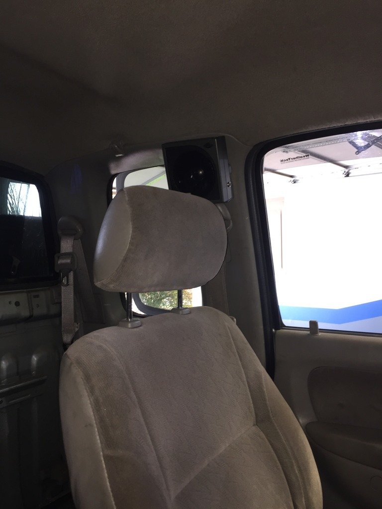

    Agree on the 4.5" not a 6 or 7. I've done almost all my work with a 4.5" and even then I save my tiny wheels for tighter spaces. If anything is needed smaller I break the dremel out. But I don't think I have ever been in a situation where I wished I had a bigger grinder. Maybe if I start fucking around with square or round tube that would be the case but I feel a chop saw would cover most of that.
    Did some work yesterday. Got the external CB speaker mounted. They had little phillips head screws to use to mount this thing. I was like fuck that, especially for something near my head.
    The speaker cable was a smidge too short, had to buy an extension this morning. 10 ft cord my ass. I do like that it also has a headphone jack too though.
    Also mounted my temporary wiring solution until I can do a nice bussman next year. Figure this panel will be good for the compressor since it pulls a max of 9 amps under maximum load.
    I discussed it in the what did you do today thread, but will also post it here. The way my wiring is currently setup I have straight runs to the OEM panel, my tool box aux, alternator, and starter on my positive terminal. The way the OEM panel is being powered is through the original outgoing wire at the bottom of the panel. There is currently nothing on the post in the OEM panel, so my theory was that if I use that post, I can power my aux panel. Well that was no bueno. The alternator was shorting and getting hot causing the belt to squeal like a mother fucker. I have no idea why. I pulled that hot off the post and hooked it directly to the battery and it was fine.
    This is how it is now, straight to the battery. The short really has me freaked out, afraid I somehow damaged something or messed up the alternator. Nothing shows signs of that but still worried.

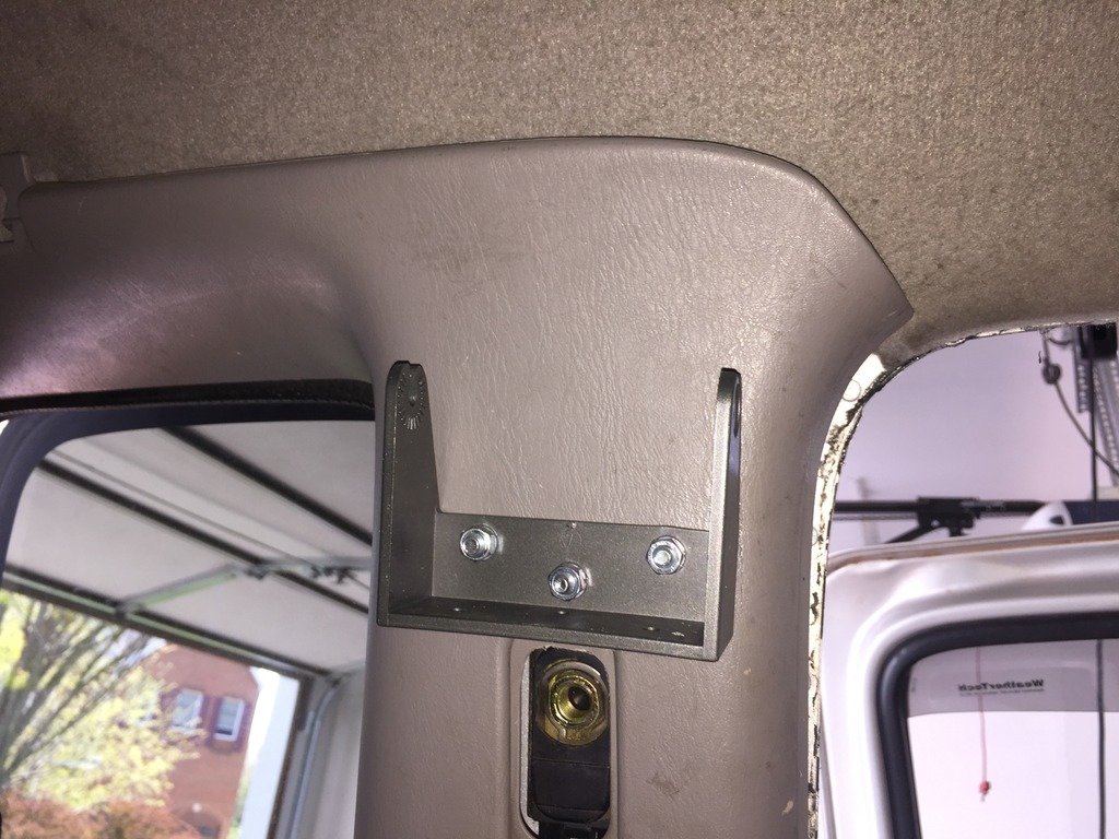

    I also started working on mounting my paranoid panel to the CB. I took the center dash apart, took the CB apart and worked on a mounting solution. This should be plenty strong.
    Looks like the speaker wouldn't get entirely blocked by panel, but oh well, the aux speaker is already in lol.

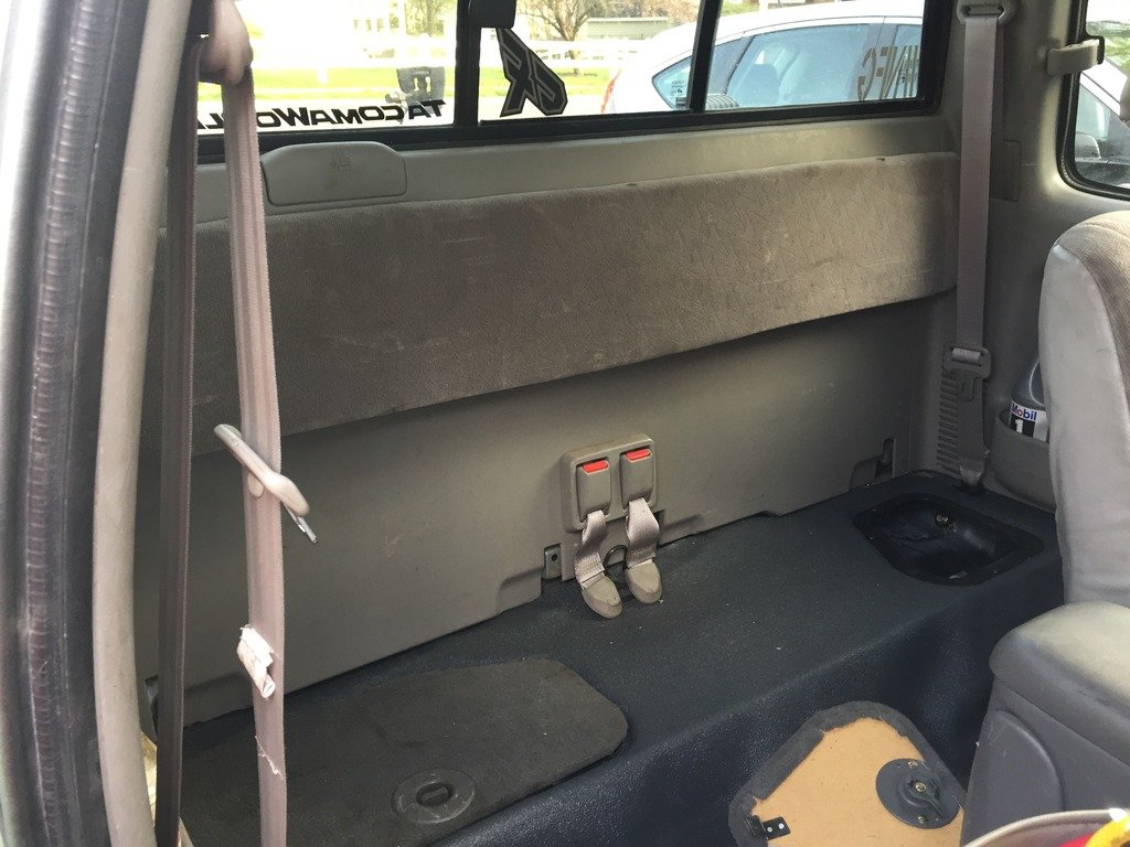

    Since I got the side panel shit done, I was able to reinstall the back wall. I left the jump seats out though, they were useless IMO and took up space.
