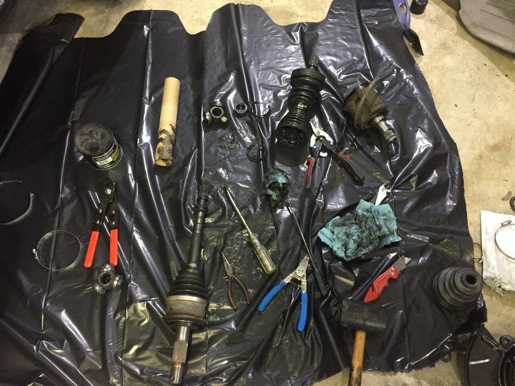

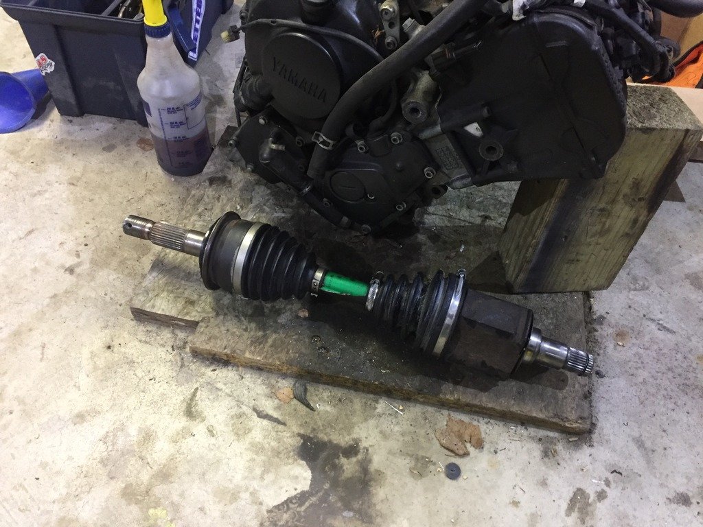

    Also did a little work to prep for the diff install. I took my one CV with a torn boot and started pulling it apart to put the new boot on and do the boot slide mod. Well the one of the tulips decided to explode and throw needle bearings everywhere when I touched it so I used the tulip from the CV I cut when I broke my diff. Starting to hoard C-clips and parts now lol.
    Definitely cut my CV build time down, but God is it a fucking messy process. I still have enough parts to build one more good CV for a spare, but I'll deal with that another day.

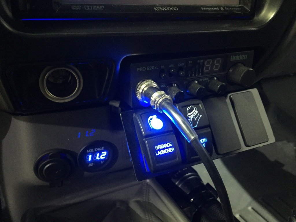

    No the locker is being run off the mini compressor, CO2 is only for airing up the tires and air tools. Speaking of which, got that wired up last night, still gotta get the dash back together.

    Prepped for my diff install day by getting the compressor wired up and tested, wiring up the switches, and testing everything all out. The center console section is a fucking bitch to take out and put back now with all the crap I have going on, but I am so happy with the way it looks and how it came out.

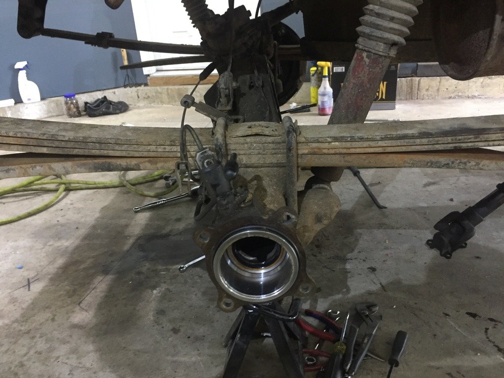

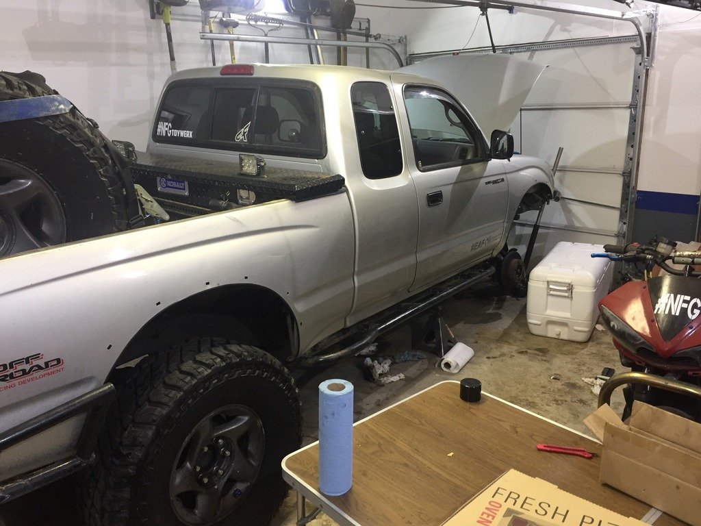

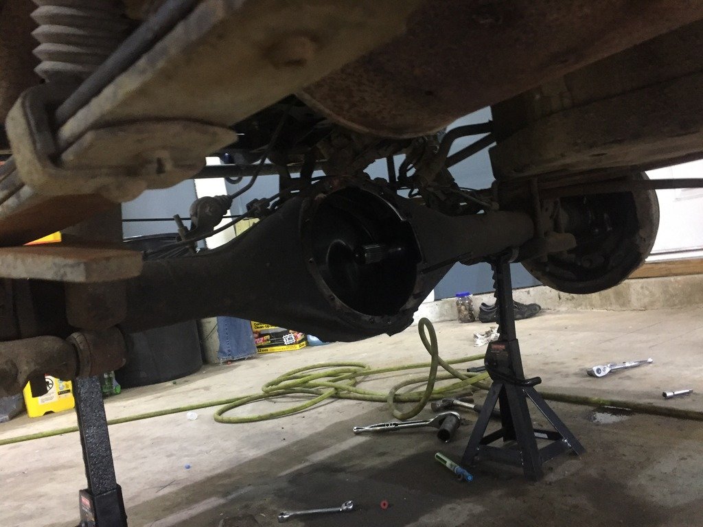

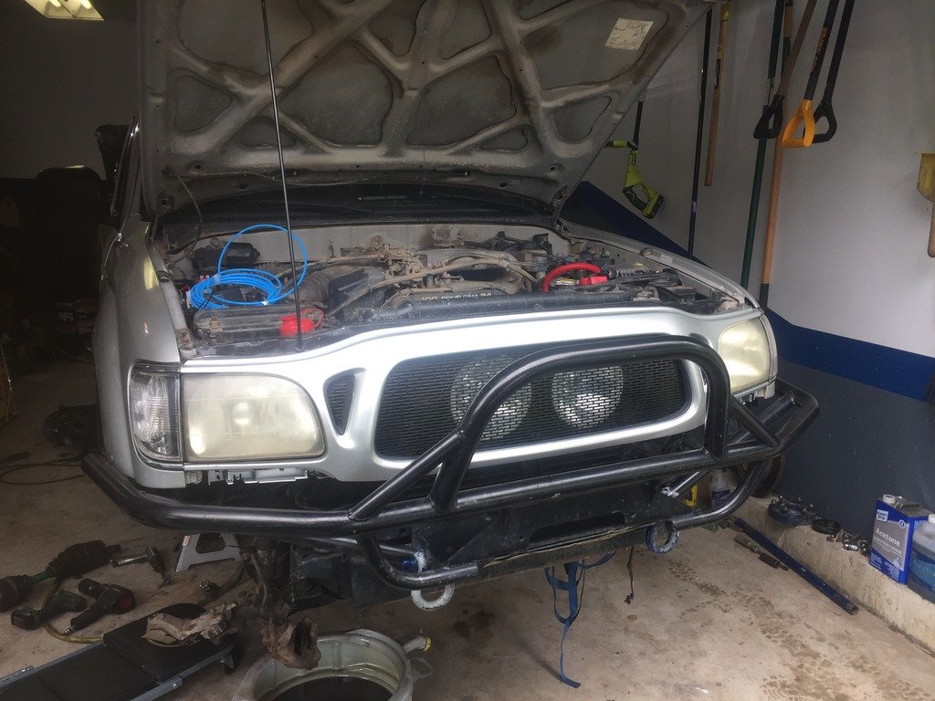

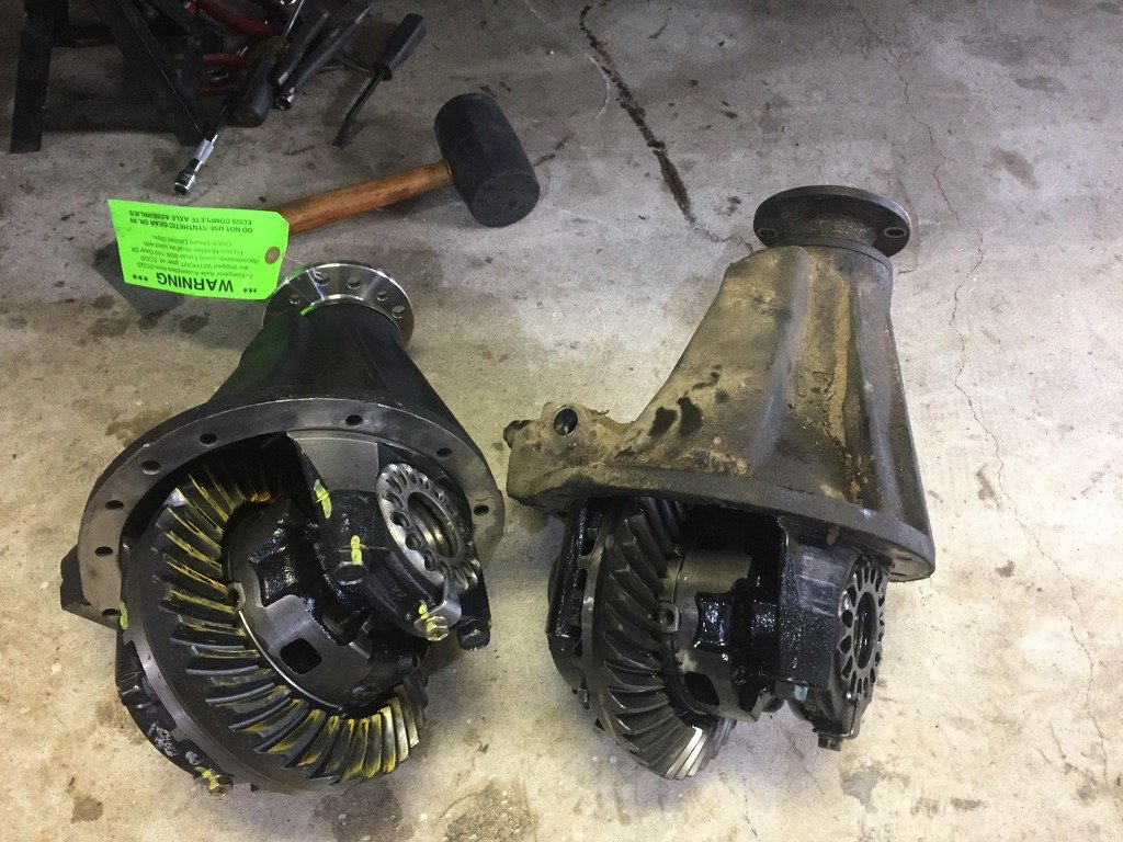

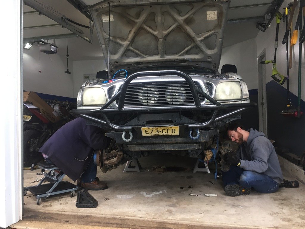

    So yesterday was a busy fucking day.
    The goal was to get both front and rear diffs installed, while also installing the new gusseted spindles. What I didn't expect was @HomerTaco coming by and hooking me up with a grill for my birthday! So stoked to get a famous Toywerx grill from the man himself. Also a huge thank you to @Sub-Zero and @MY50cal for the help today. I seriously couldn't have done it without you guys. Honestly most of it is buttoned up, everything in the rear is all torqued, just need to fill the diff. Up front I gotta torque all the suspension components, run the air line, and fill the diff. Not many pics cause we were going ham. Also getting that front diff out originally was a bitch.
    How it was left.

    Are you not running bump stops?
  20. May 14, 2017 at 7:06 PM
    #720
    cynicalrider
    cynicalrider [OP] #NFG
    Jul 25, 2012
    #83399
    17,207
    Jersey
    01 SR5 TRD 4x4, '23 Bronco Wildtrak, 2017 HSQV FE350
    Drop bracket lift and booger welds
    I am on one side. That other side rusted off at some point. Gotta get new ones when I get dakars.
