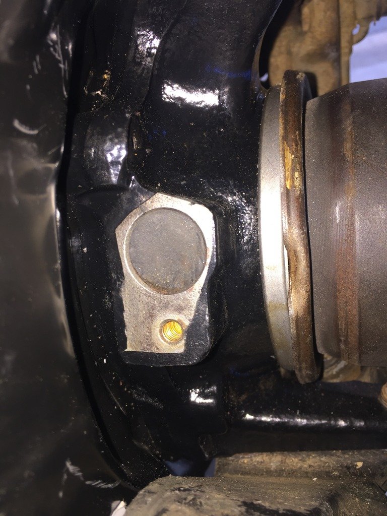

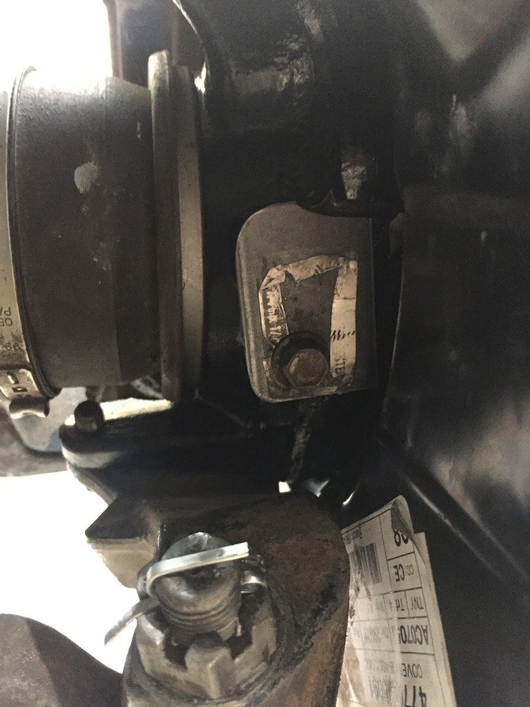

    Alright well diff's are packed and ready to go to ECGS.

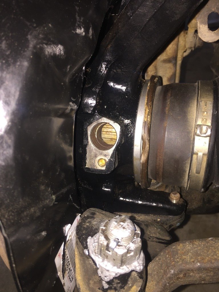

    Everything is torqued and the diff's are filled. Last step was to create block off plates for the ABS.

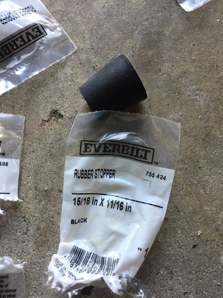

    I got these plugs from Home Depot as well as a piece of 1 1/4" 1/8" thick steel.

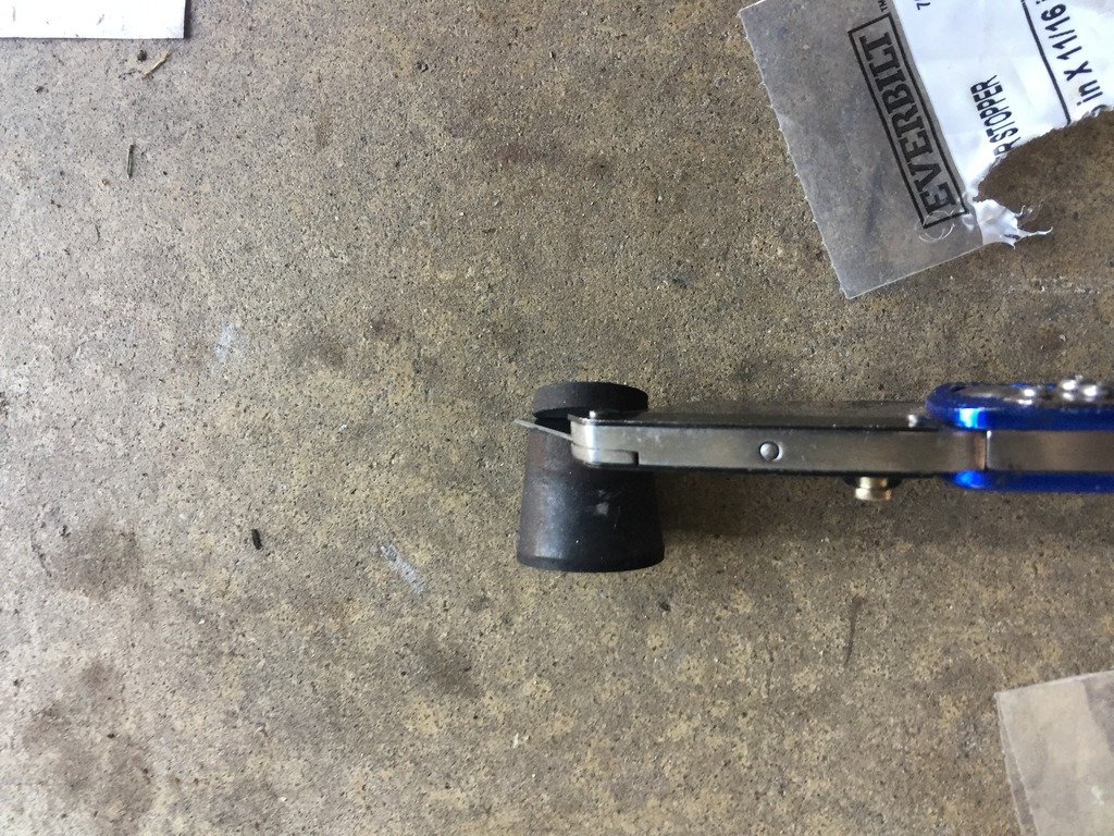

    I measured how deep the inner ledge is inside and cut the plug so it's around that length as well as trimmed the stopper that will be too small or two big for the hole.
    Then shoved it in both sides:

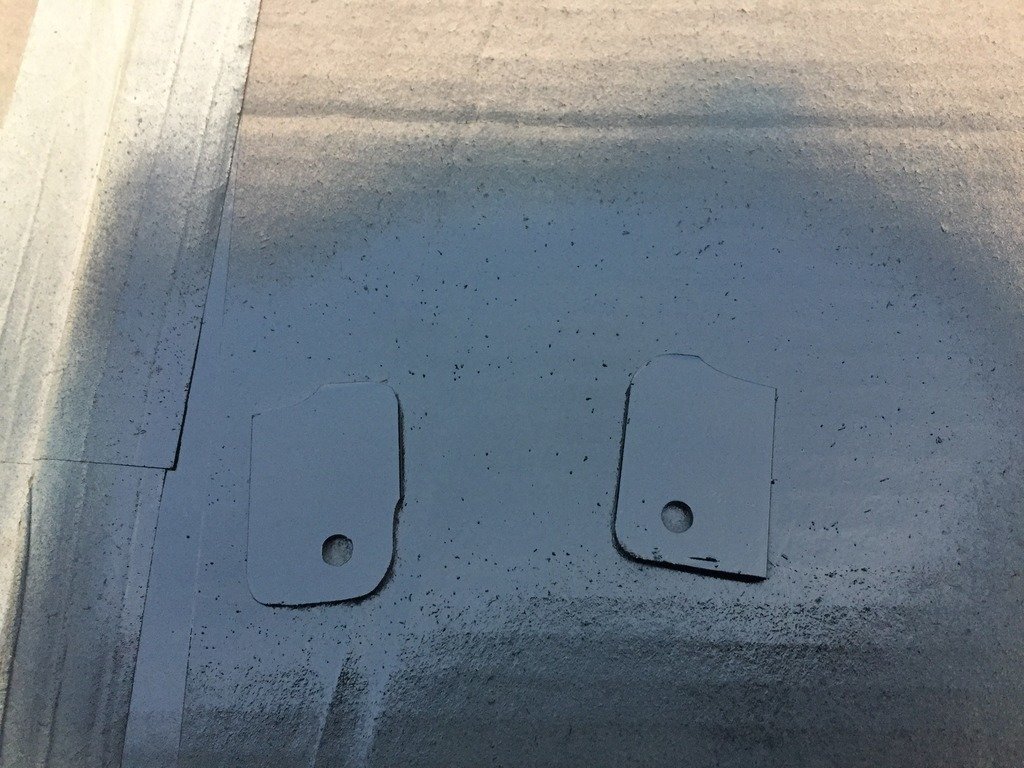

    Next step was fabbing the plates. Really wish I had a bench grinder for this lol but an angle grinder did pretty well.

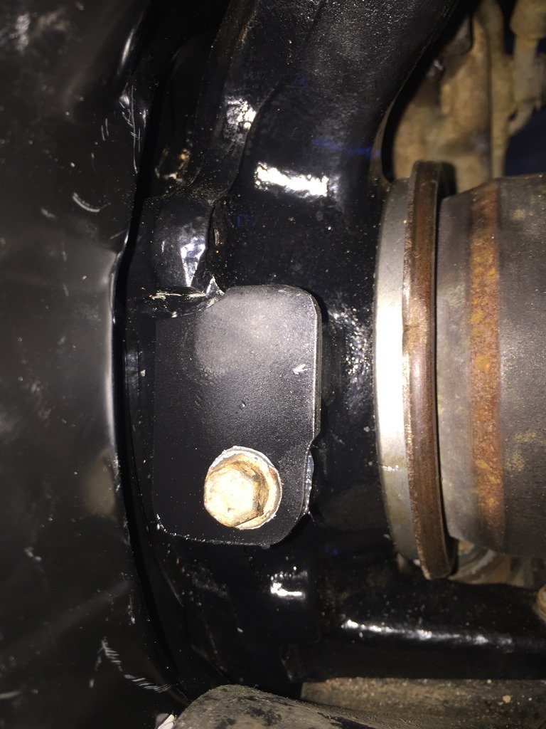

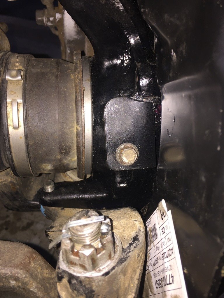

    I cleaned the plates with denatured alcohol and primed and painted the top. I left the bottom bare so the adhesive can go metal to metal.
    Applied the adhesive and also filled in the top of the plug with adhesive RTV.
    Then bolted the plates down.
    Should hopefully do the trick.
