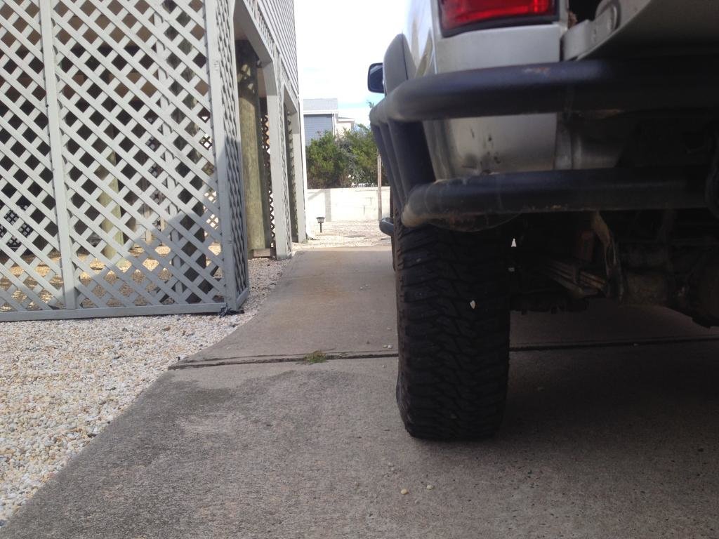

    Coming from you that's a big compliment! :cool: She's getting there, slow and steady.

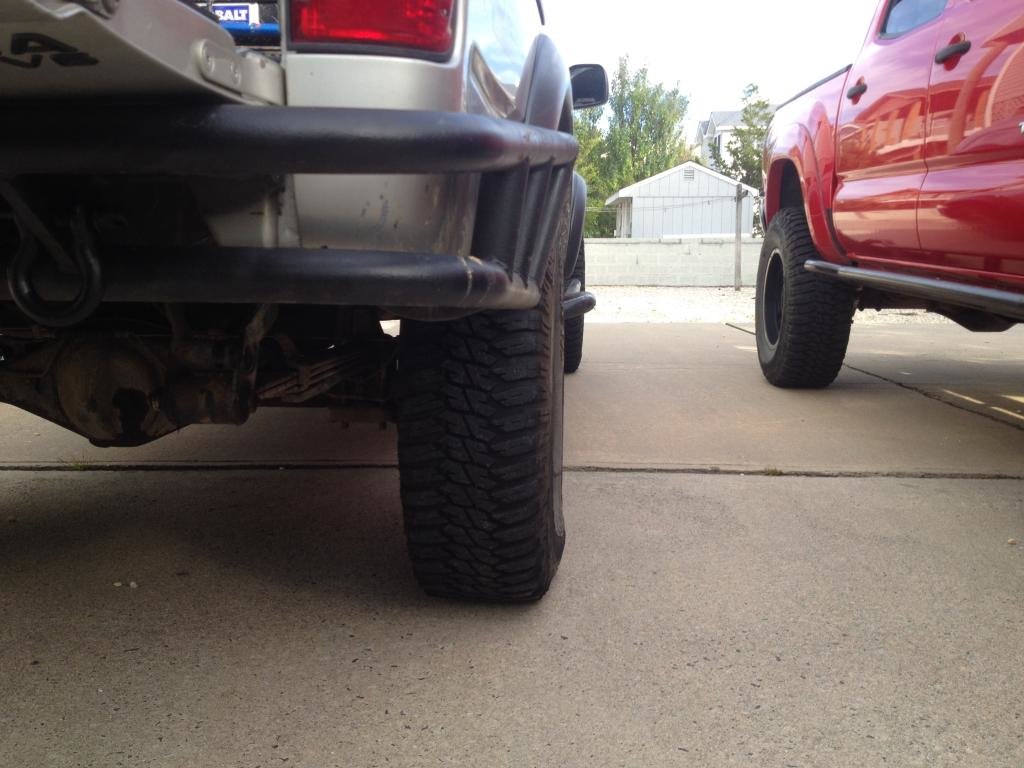

    I do but very minimal. Maybe an inch in either direction which doesn't concern me much. I think the tire barely taps the bedside on the hardest turns. I was trying to find a wide strap like you had until I got lucky and came across this.

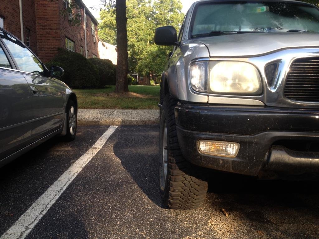

    Alright way more than an inch, 3-4 on non bedside side, but always returns directly to vertical.

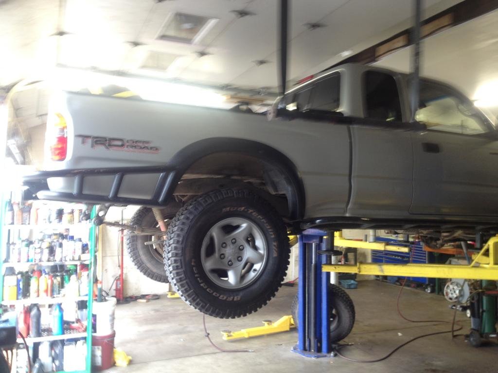

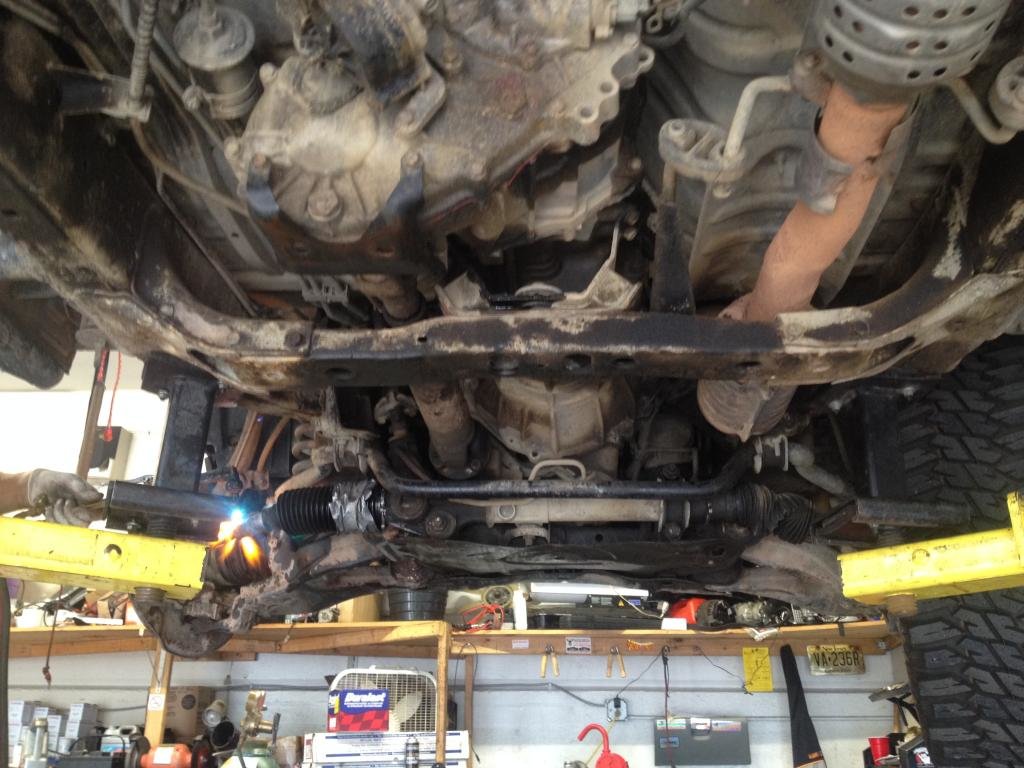

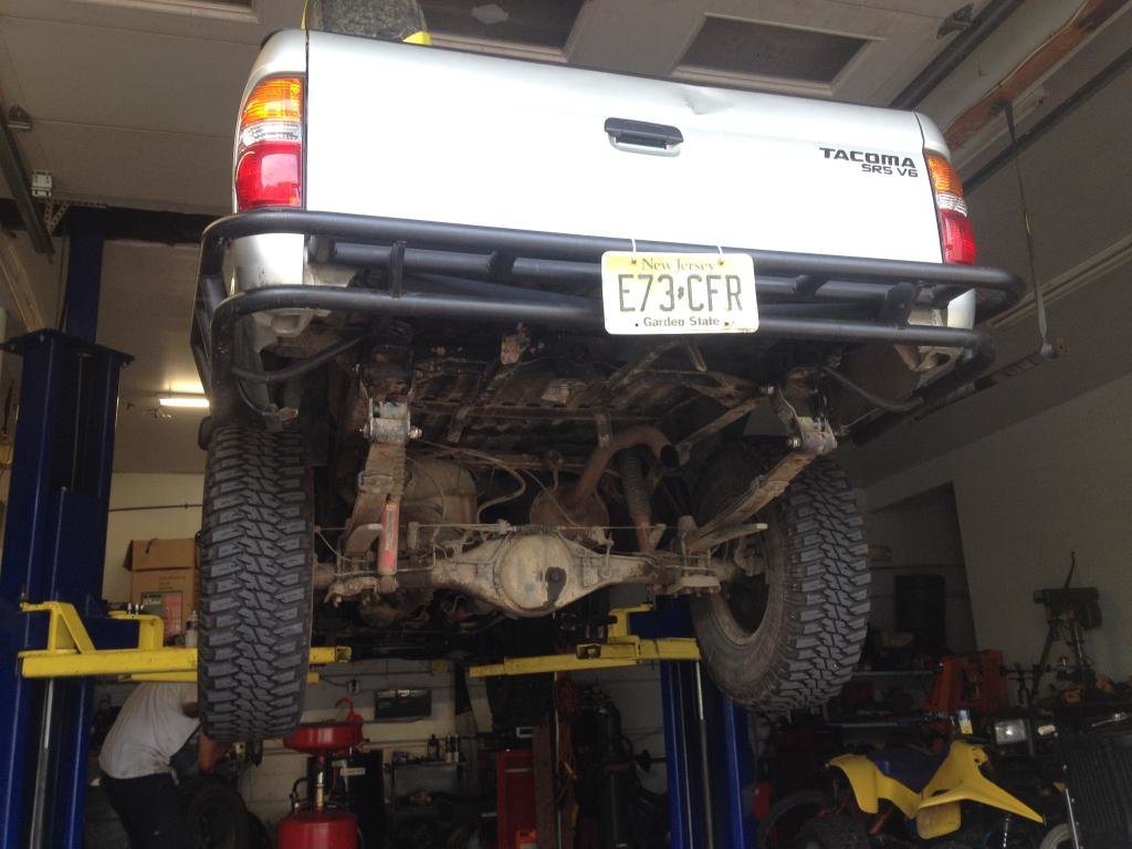

    Did my front axle seals today at my cousins shop. Also greased my shackles, main eye bolts, and both driveshafts.
    Some pics on the lift:

    Also for anyone planning on doing the axle seals, the passenger side axle seal has only a tiny lip to sit on and can be pressed in too far. In order to avoid this we actually put the seal on the axle before installation.

    Nope. See the fire in the second pic? Lmao there was no way the OTRE was coming off without us damaging it. Duct tape mod will have to do for now till I can at least afford to replace the OTRE's.

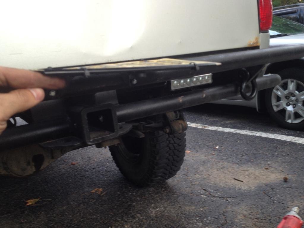

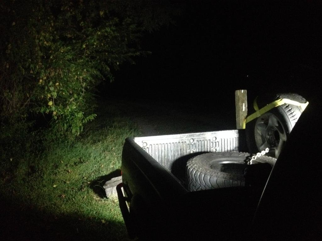

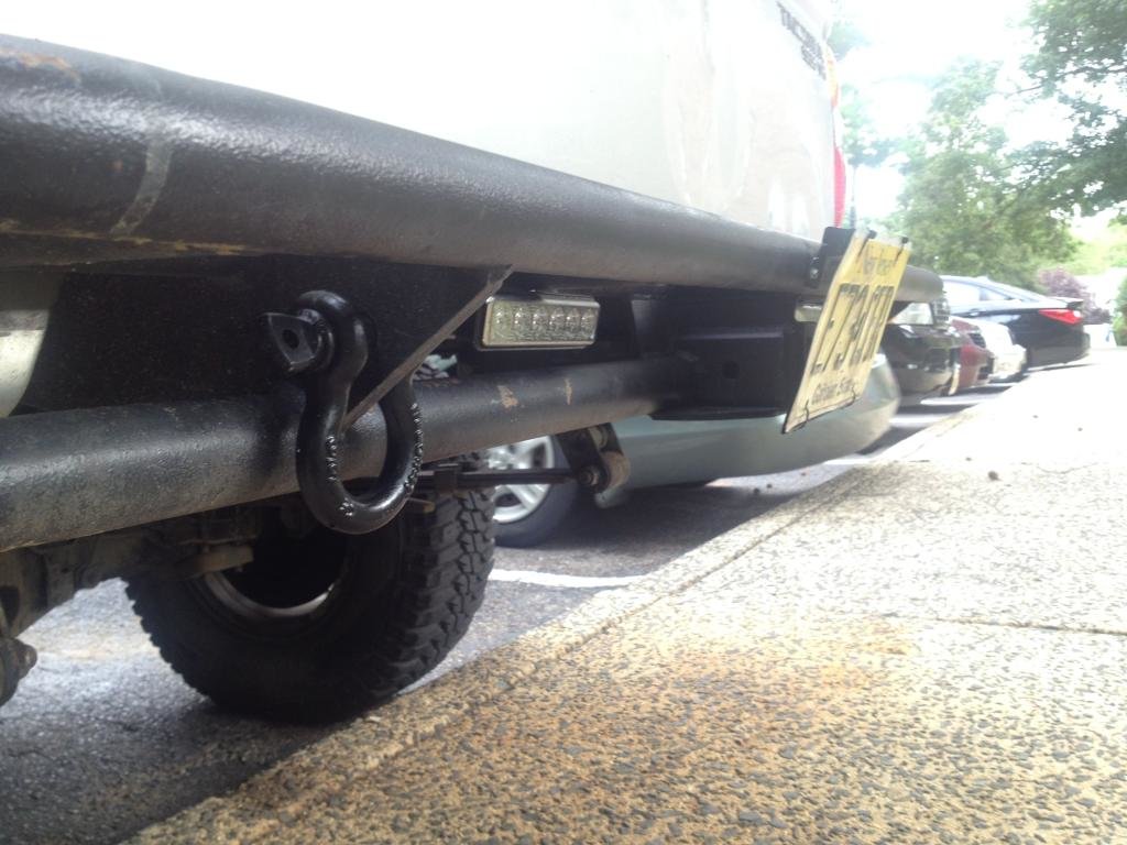

    Now that all that is over, I can finally put a little money back into the truck with some bumper mods I had planned. When I put the tube bumper on I was left with no way to mount the license plate. I also had no recovery setup, and ever since switching to LED reverse lights, I had some reduced night time visibility in reverse.
    The LED lights projected straight back which is all well and good but visibility directly behind the truck was much to be desired, and my tool box lights has a ton of blockage due to the spare tire mount and the tail gate.
    Here are my solutions to all these issues:
    2 5/8" shackles placed in the locations 4xinnovations made holes for.
    Flip up license plate bracket:

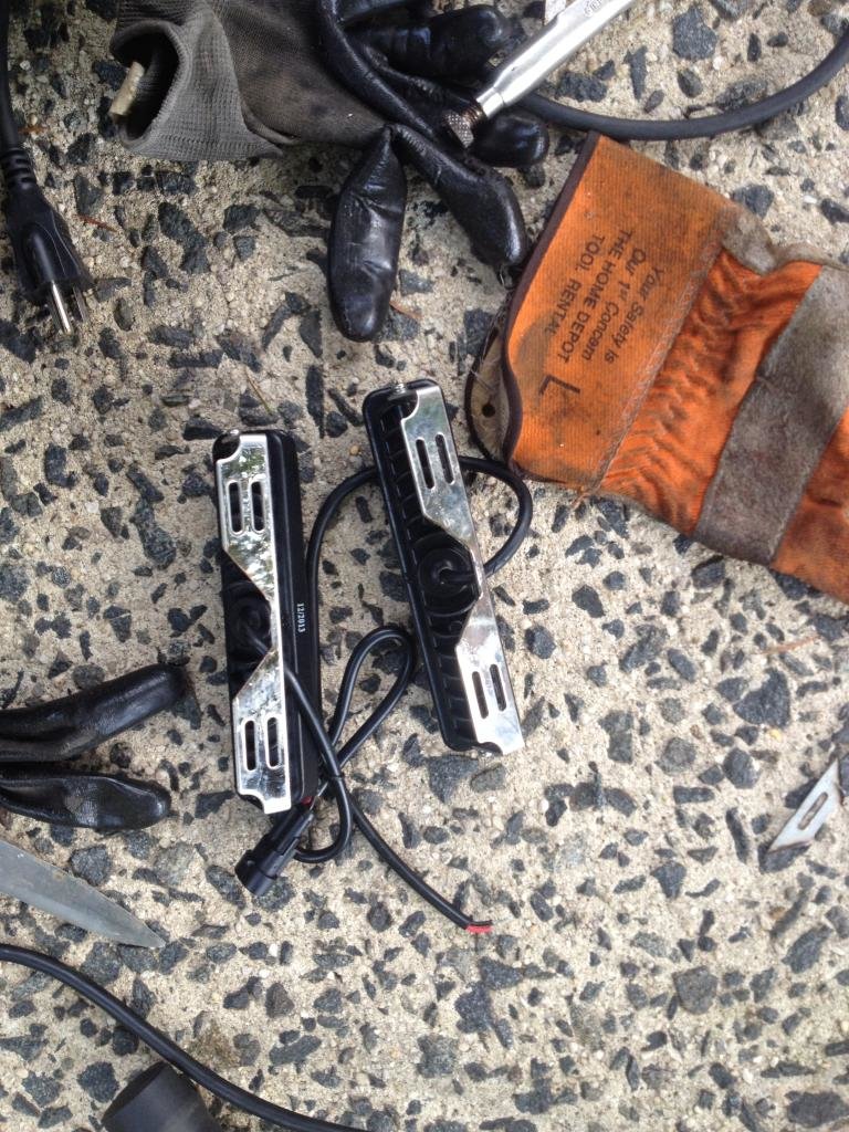

    Here is the install process on the blitzpros:

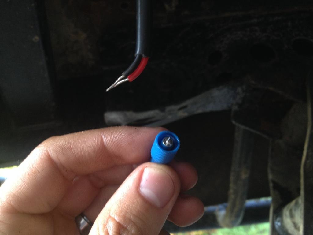

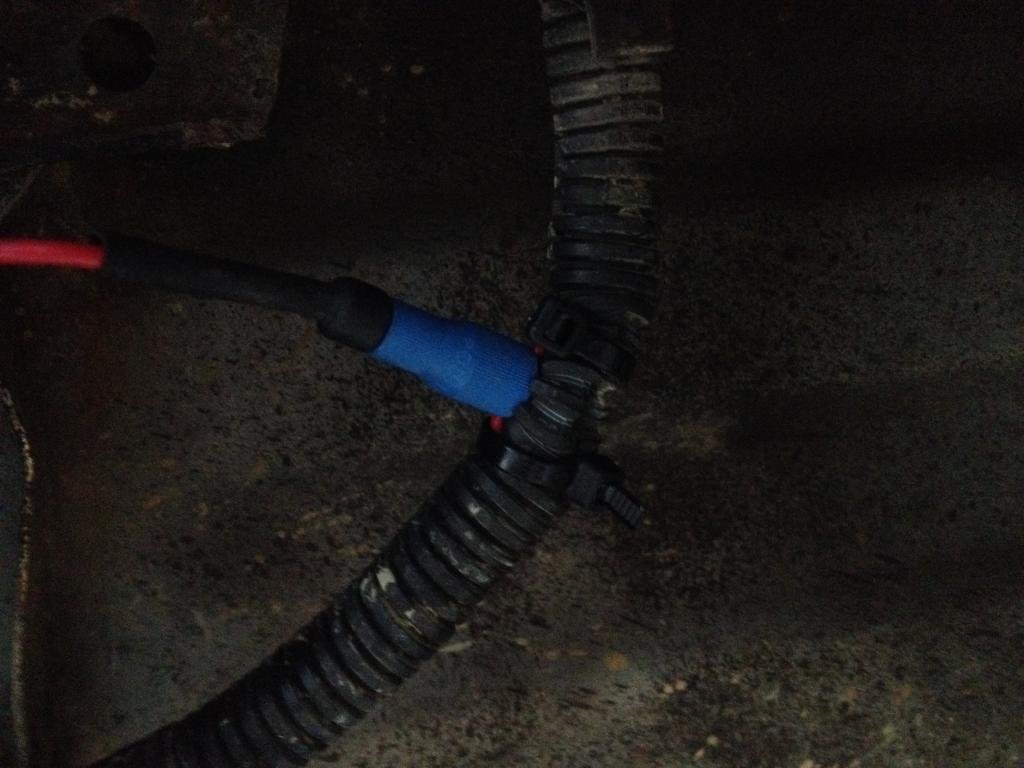

    For anyone looking to tap into the hot leads for the reverse lights, they are this red and black wire in the harness:
    I used a new to me product called a posi-tap. It sends a little pin through the hot lead to safely and cleanly make a connection.

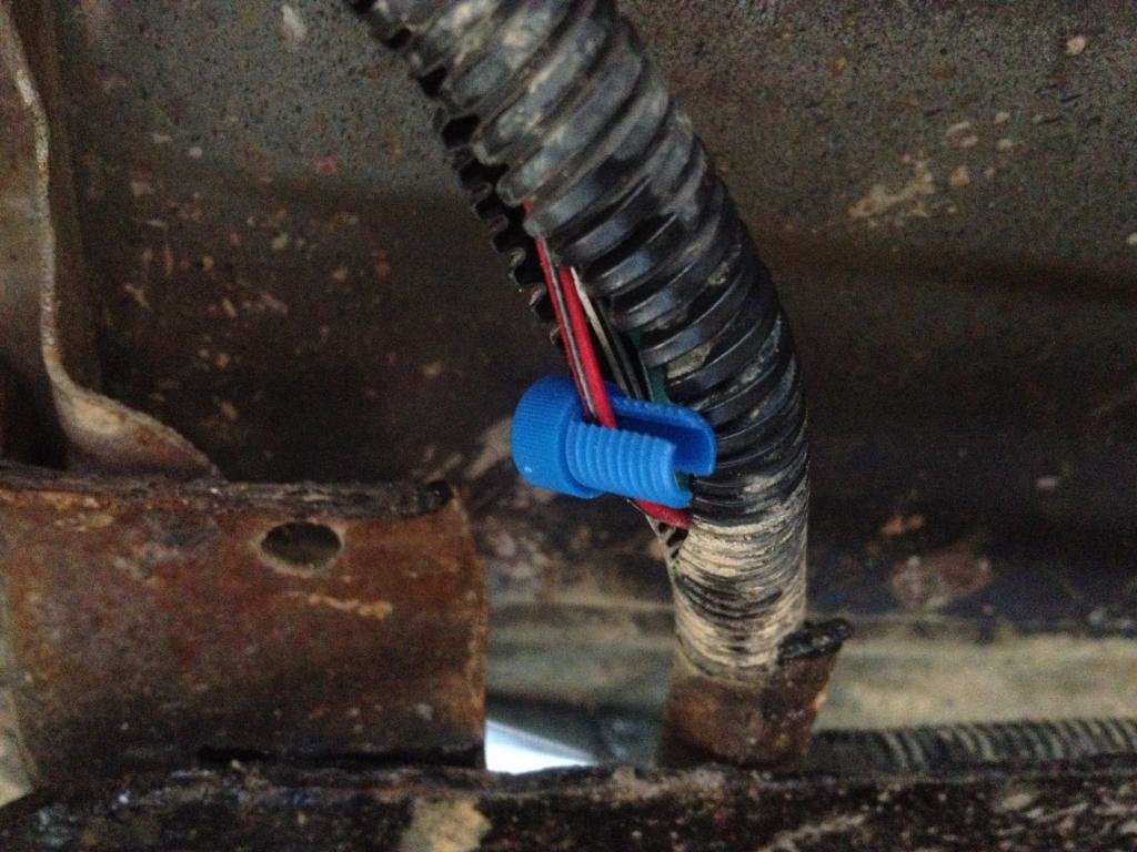

    Here is the tap in the harness:

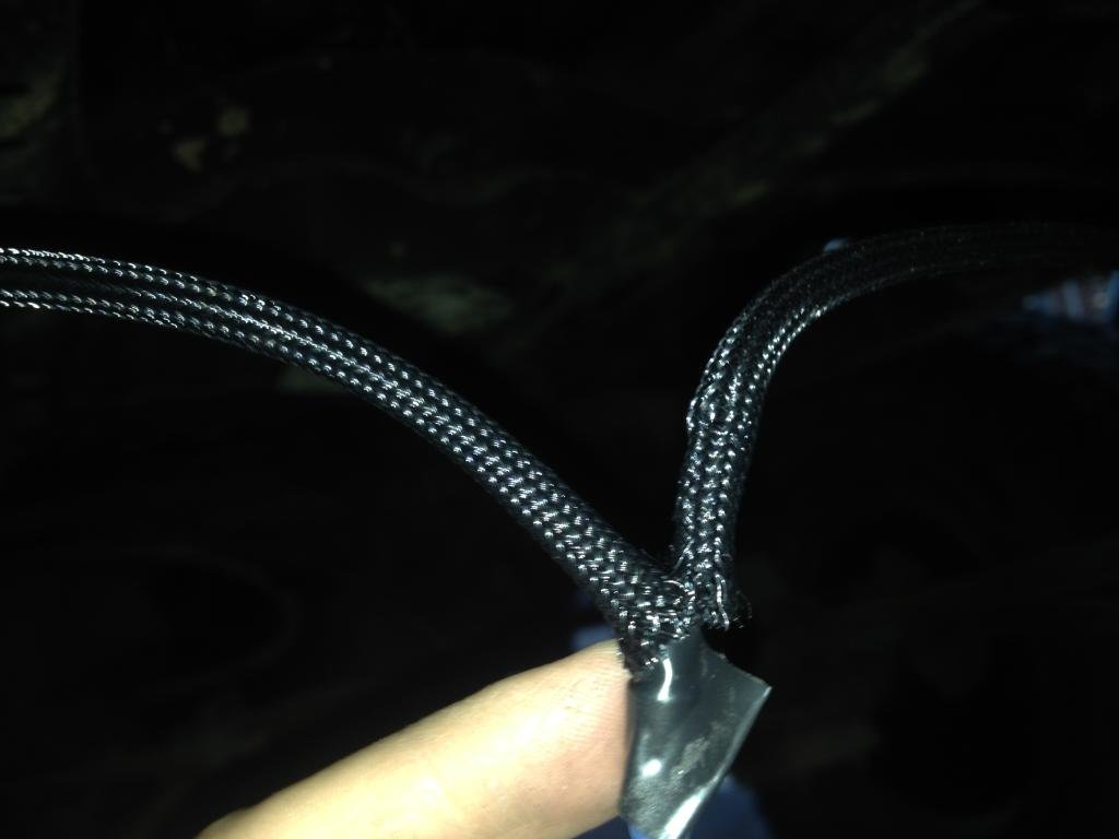

    I also wanted to make sure the wires were properly protected so I did this with some tech flex:
    I always try to heat shrink everything too but due to it getting dark and poor planning I had to use a combination of heat shrink/tech flex/ and some electrical tape to tidy it all up.

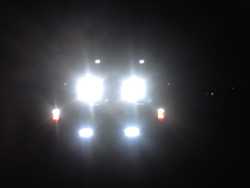

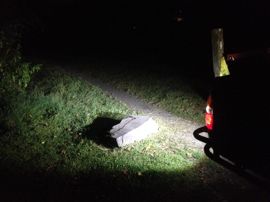

    I was very careful when mounting the lights to put them in a location that will be away from possible damage when wheeling as well as in a location where it would not blind drivers when I am backing out at the mall or something.
    I cut the brackets so i could work around the welds on the bumpers:
    And this shows how nicely tucked the lights are:

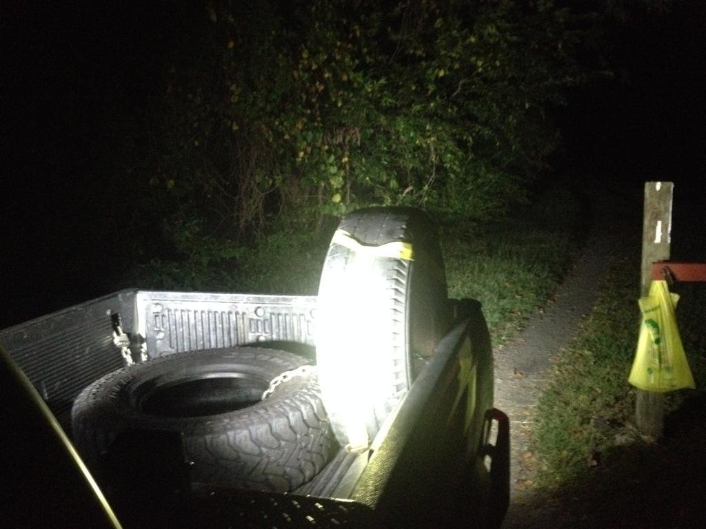

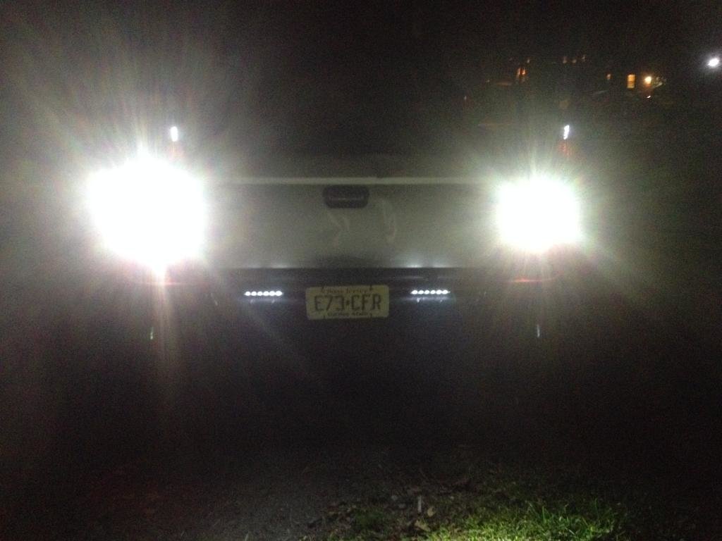

    Standing directly behind the truck, you are not blinded by the lights:

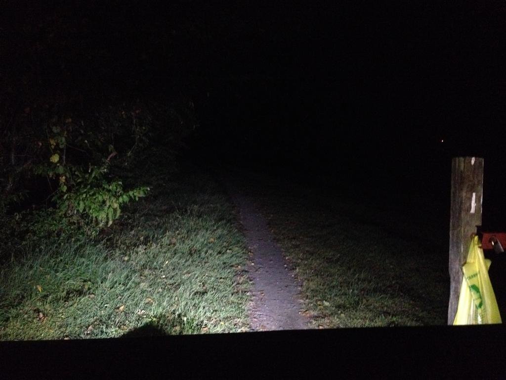

    This is with the new lights, it shows the area lit up by the new lights:
    And with the tool box lights on at the same time:

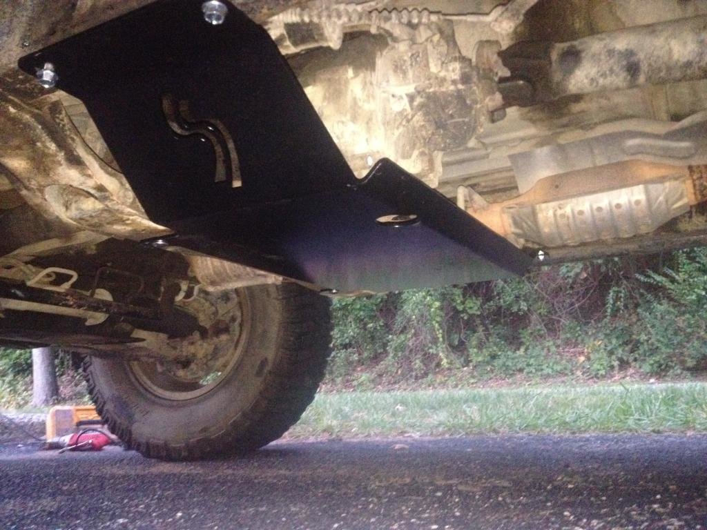

    Also installed a skid row tcase skid:

    The TC skid just screws into the bottom of the frame?

    Yeah drill 4 5/16" holes into frame, screw in self tappers, two bolts in the crossmember and done. :cool:
