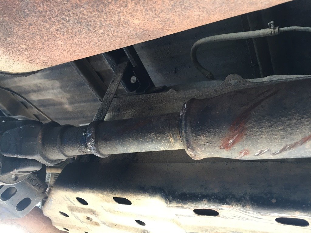

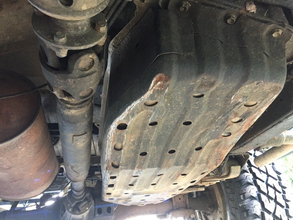

    So assessed the damage from the last trip and it really made me re-think some things. First, rear suspension went up on the priority list, as well as re-enforcing the gas tank skid. I got dangerously close to destroying mine, and did a number on the skid itself. Also never going to Rausch without bringing my spare DS, as well as happy I even got one in the first place.
    Going to go with Dakars, Nitrochargers, and wheelers super bumps in the rear. Really want to do it all the right way the first time, but I just don't have the time or cash before Moab. This is a tried and true setup that I can get a couple of years on anyway.
    Next up will be storage/camp gear. Already have a plano case, a plano sportsman trunk, and another trunk style option all ready to be bought off Amazon. Ideally I can start putting stuff in better weatherproof options so I don't always need shit in the cab. Also Hoping to organize shit quite a bit.
    Also I heard a heat shield rattle when I was wheeling and thought nothing of it. I found this when I got home, no nuts to be found and the heat shield barely hanging on the stud. Now I know why my check engine light is on. :anonymous:

    That gas tank tho.......Pizza Rock carnage?

    Not sure if it was that or the ledge on 20 at 6:45 in the video. I was definitely beating on it much more then than when i was on pizza rock.
