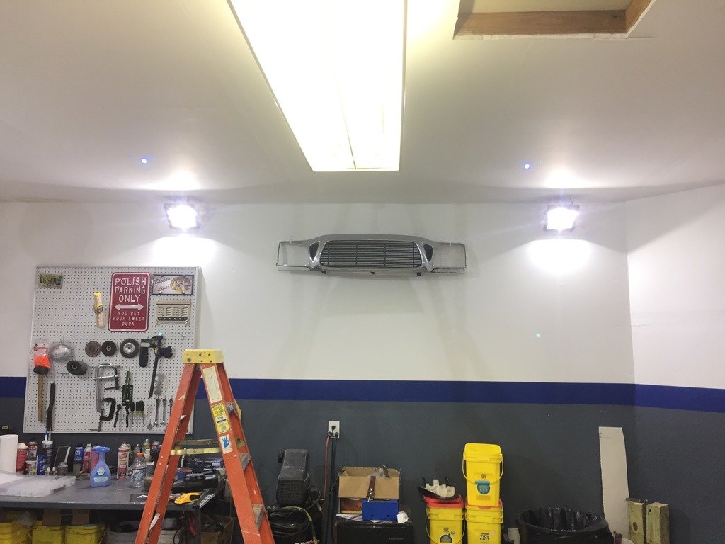

    So now that I had a sexy new @HomerTaco Toywerx grill I had my old grill left sitting idle. This grill was the first mod I ever did to my truck and I have a soft spot in my heart for it. Luckily my cousin suggested to me an awesome idea for a way to use it.
    Looks damn good in my opinion.

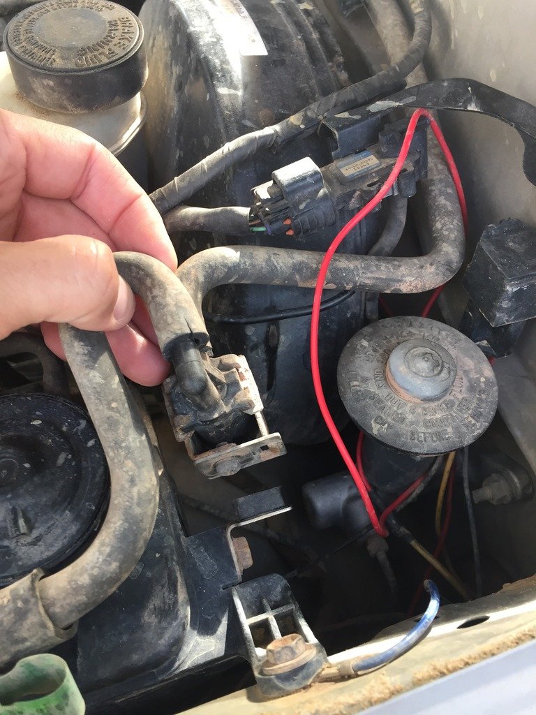

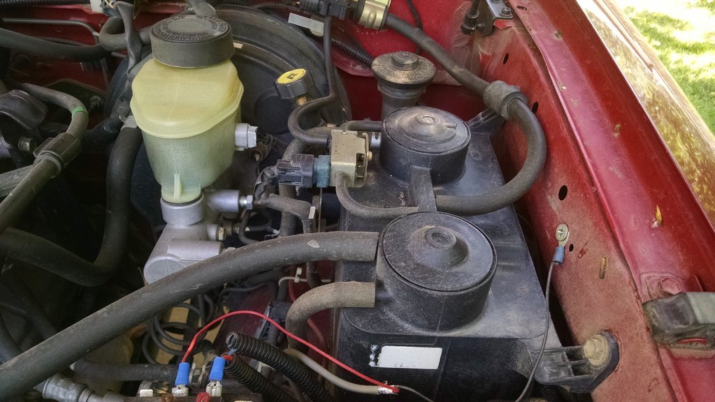

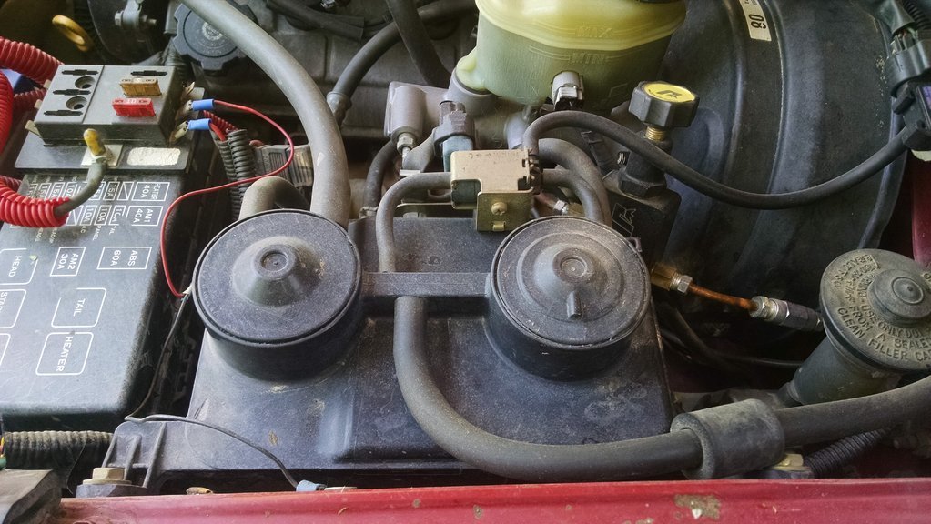

    Also can someone with a 3.4 with the charcoal canister in the bay show my how the little box on this hose is mounted?

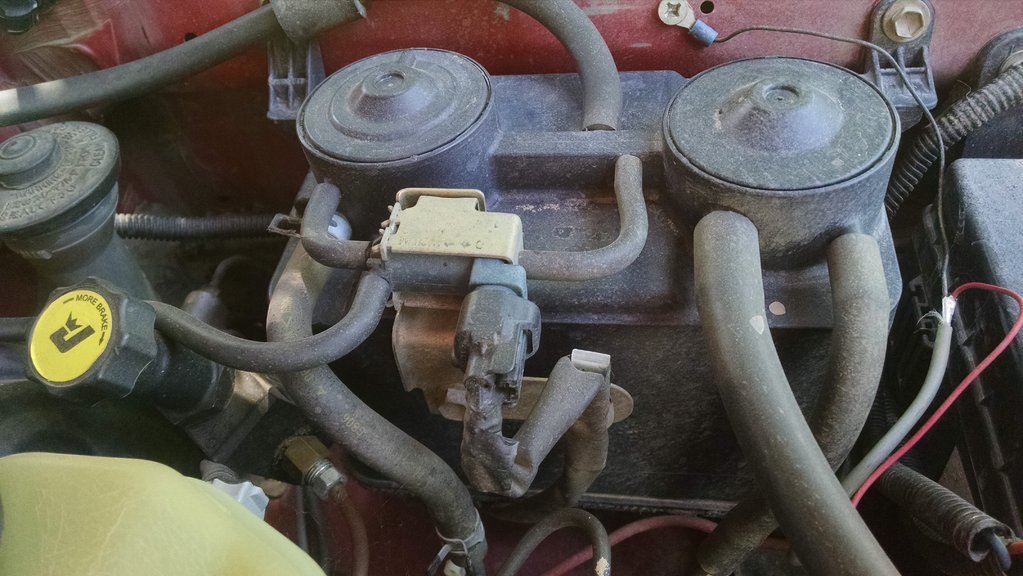

    You'rs looks a little different, not sure if this will help.

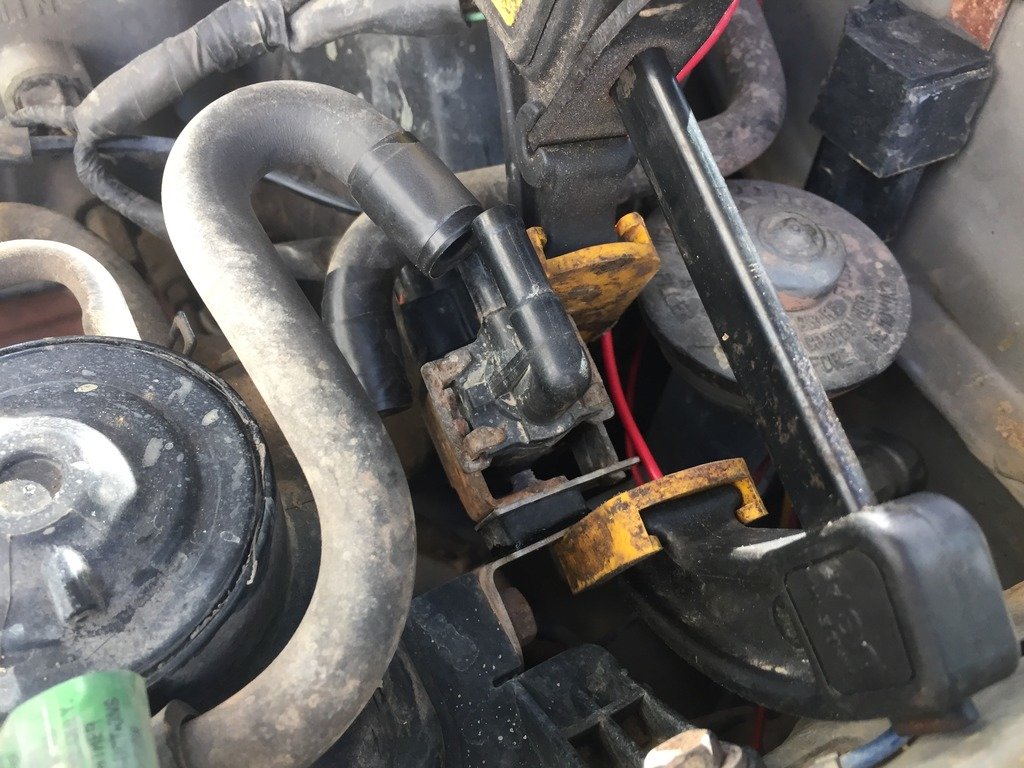

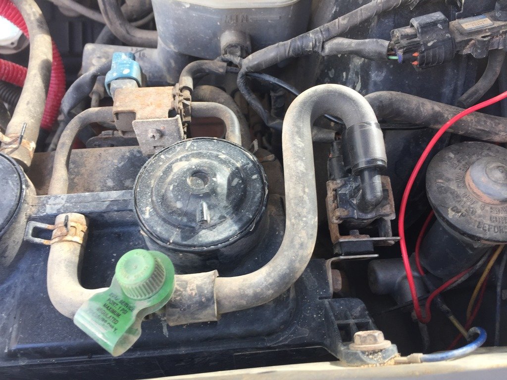

    Thanks Brett, it looks like yours is setup differently than mine like you said. It looks like this one relay or whatever the fuck it is is just attached with glue to the rubber isolator.
    Looks like it busted off when I was wheeling which made the tubes bust off since they are all old and cracked as well. Wrapped the tubes in electrical tape and re-glued the isolator with some super glue. We'll see how that holds before I go replacing shit.

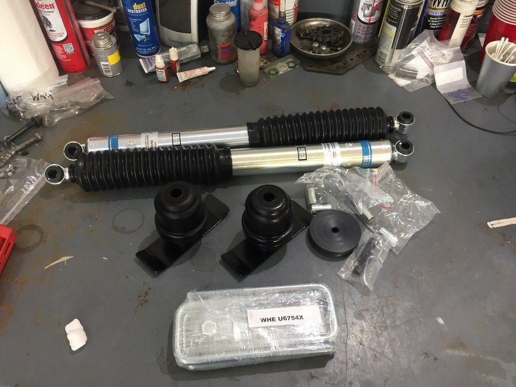

    Also had some parts come in. 5125's with 9" of travel, wheelers super bumps, u bolts for dakars, and super bump spacers just in case.
    Just waiting on the Dakar's now.
