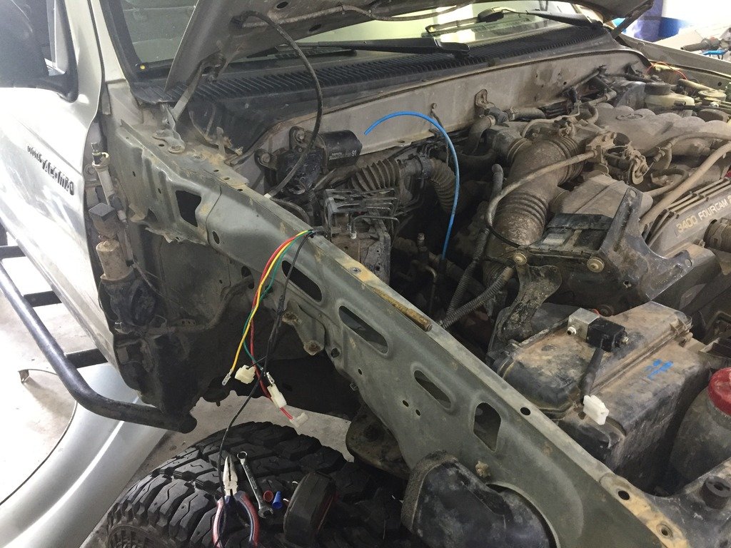

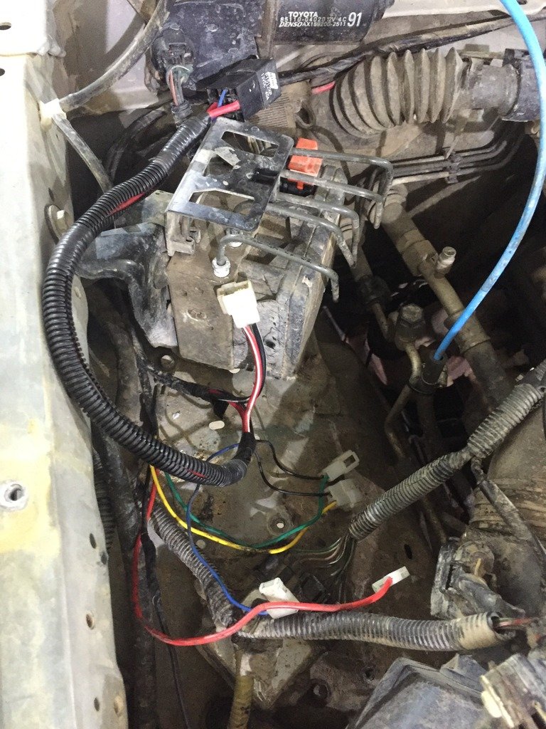

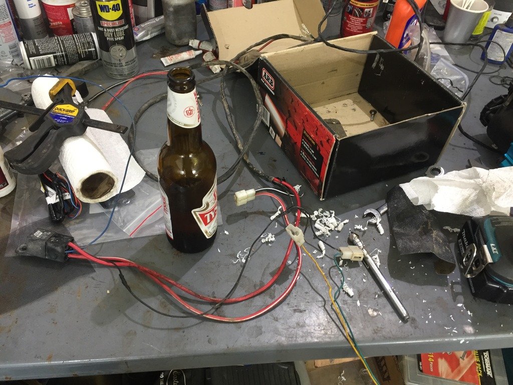

    Turns out I'll be doing both. When I merged/researched the harnesses the CKSA-12 had power going from my blue sea, through the switch, and straight to the compressor. The CKMA has power going straight through to the compressor, but there is still a hot coming from the blue sea, to the switch, and to the relay. Other than that merging the harnesses was easy, I didn't need to fuck with the switch at all, or pull wires through the firewall. I just removed the leads from the one harness and moved them to the other harness. The only thing I didn't do was move the ground that's going into the cab. That was on a ring terminal coming into the engine bay so I left that as is, and the other harness is grounded via the main harness it's on.
    Old harness:
    New harness opened up:
    Successful merge:

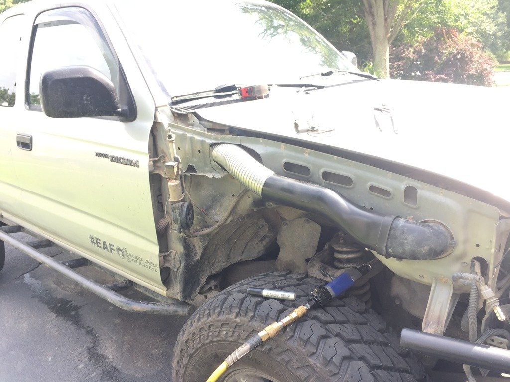

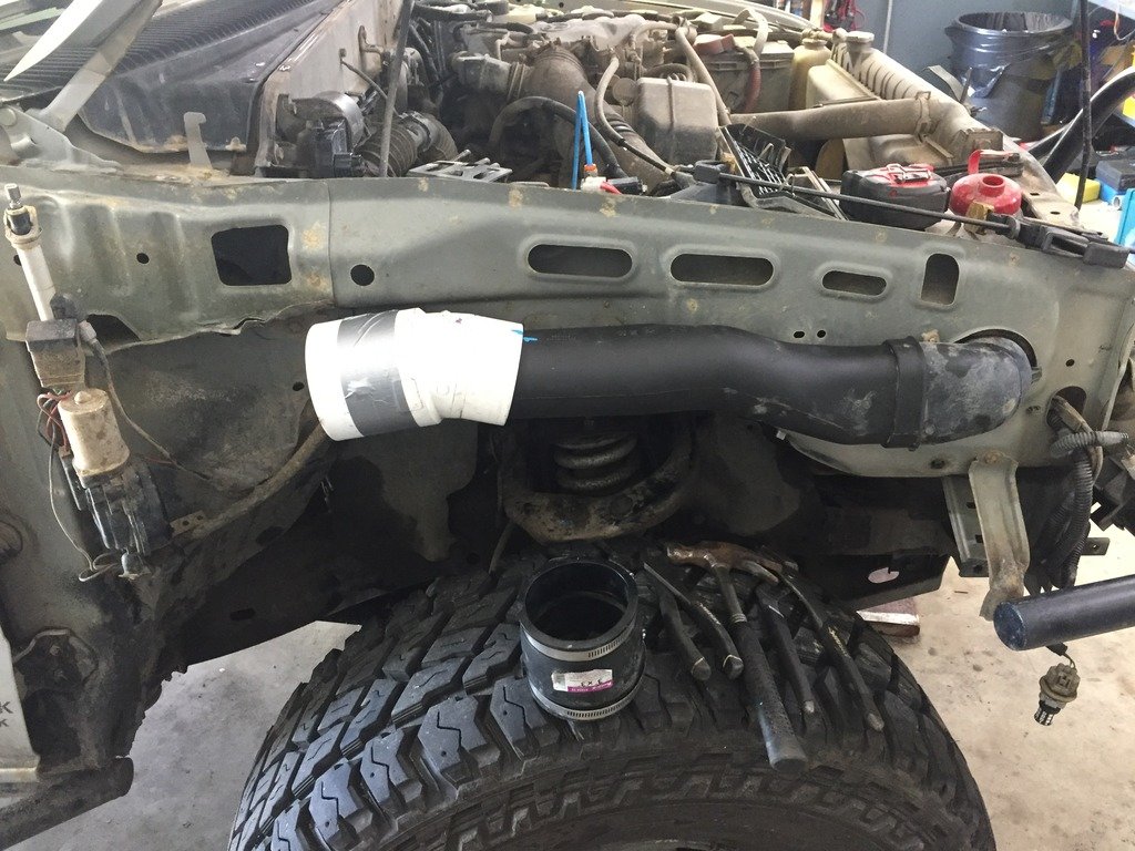

    Other than the compressor project, got a couple other projects in the works. Tried to make a Box Rocket style in fender snorkel, but that won't work without glass fenders like he had.
    This was my solution (will be glued and sealed obviously) in the works.
    End cap will have holes drilled into it and a mesh screen. Basically trying to eliminate an the massive gaping hole with something the should block at least some dirt/water. Another member showed me how he used exhaust tube to go under the windshield cowl, might pursue that next instead. That would definitely be more protected than my PVC solution and tighter turns can be achieved with the exhaust tube.

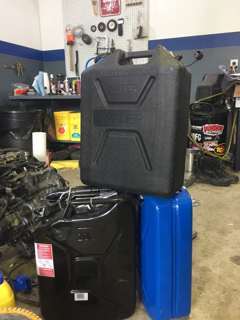

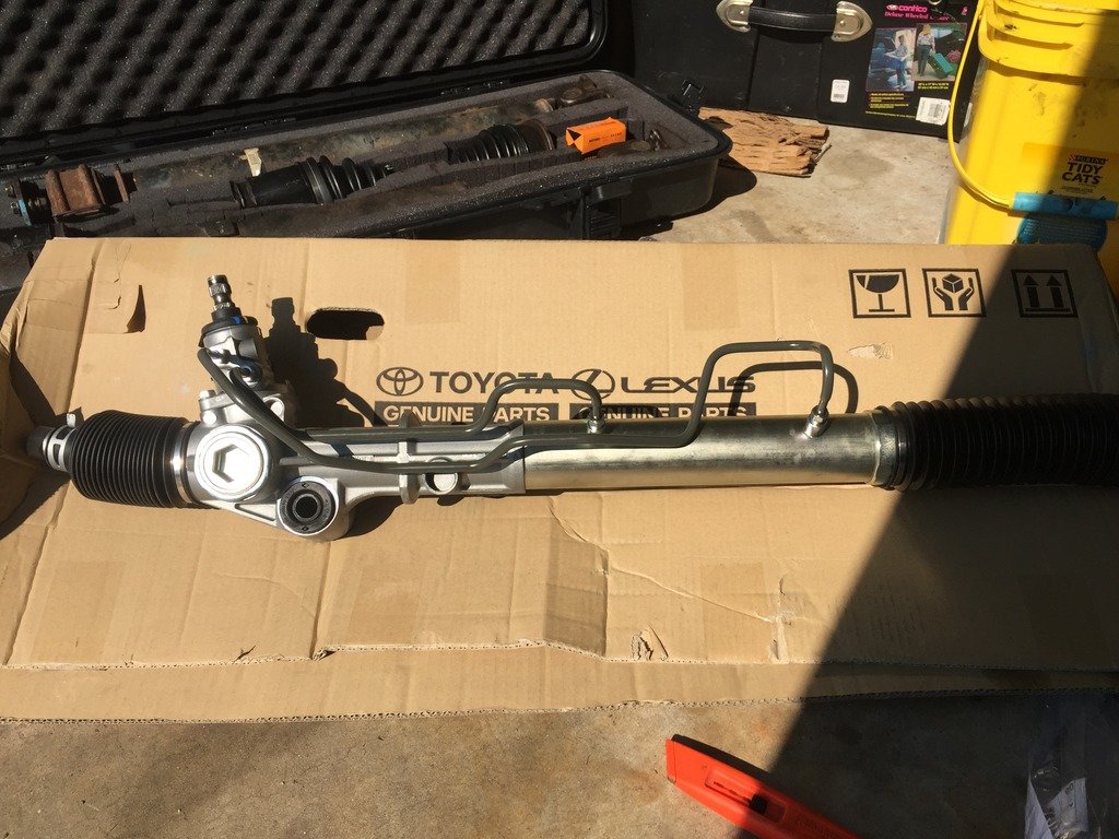

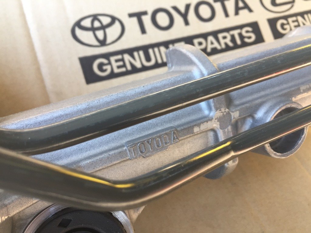

    Also got some goodies for upcoming projects. My water jerry came in to start my pressurized can project and my brand new OEM steering rack came in.

    I think they delivered the steering rack to the wrong place :boink:

    rngr Aix sponsa
    Jan 13, 2015
    #146258
    9,244
    01 SR5 4x4 2.7L
    TOYODA ??? :notsure:

    That's the original spelling

    You wish! Though since I go to this dealership a lot, I get employee pricing. Cheaper than camelback even. Got OEM OTRE's waiting to go on too.
    https://en.wikipedia.org/wiki/Akio_Toyoda

    Still not cheap though. Still $502 just for the rack, but cheaper than I have seen online by like $40.

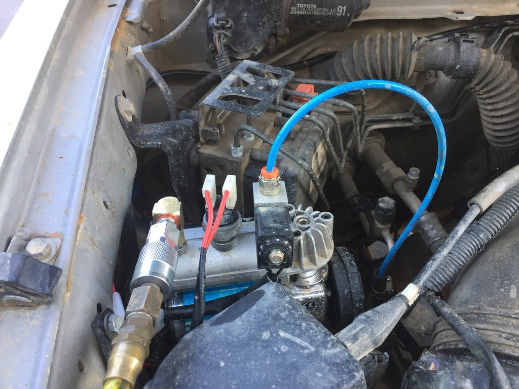

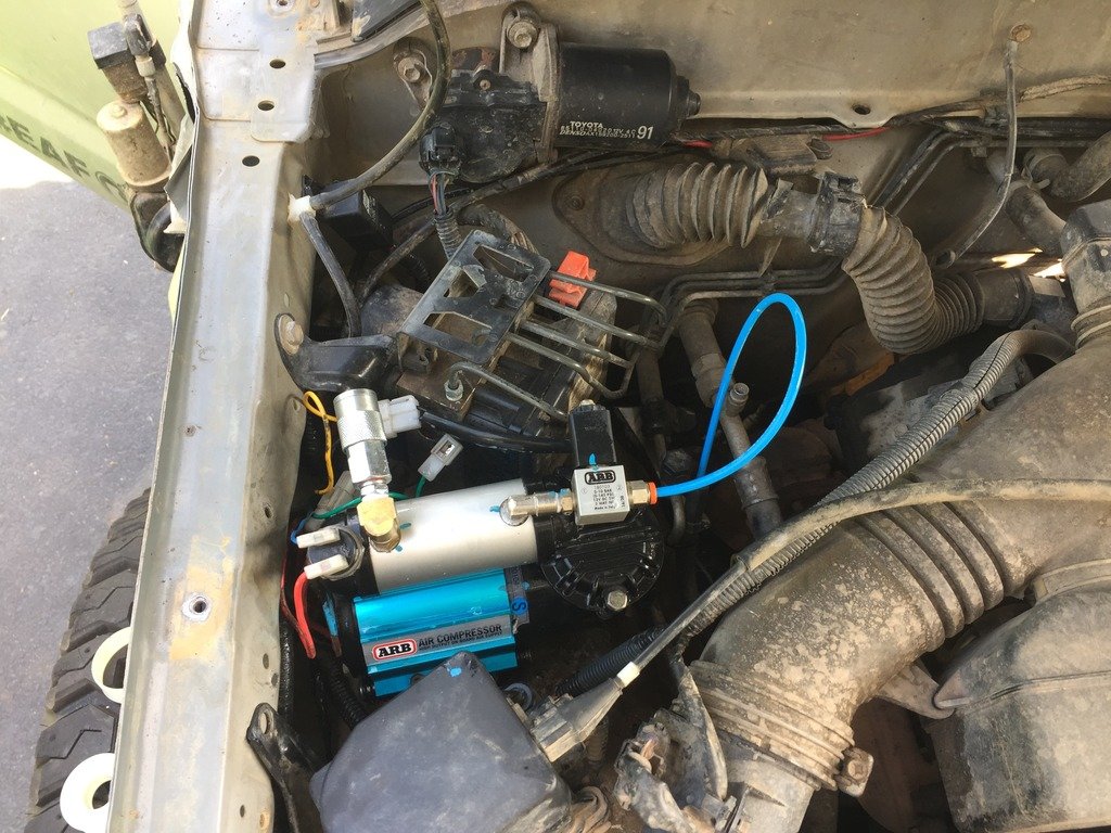

    Finished wiring/plumbing/installing the CKMA-12:
    Comparison to the old CKSA-12 that was there:
    Went a different direction for the ghetto snorkel.This goes into the fender and is pretty protected.
    Still gotta paint and silicone.

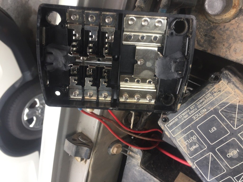

    Also when hooking up the compressor I found the studs on the Blue Sea are shittily pressed in, so when I unbolted the main terminals the studs fell inside. I used quick steel epoxy to set the studs back in place so they won't do that anymore.
