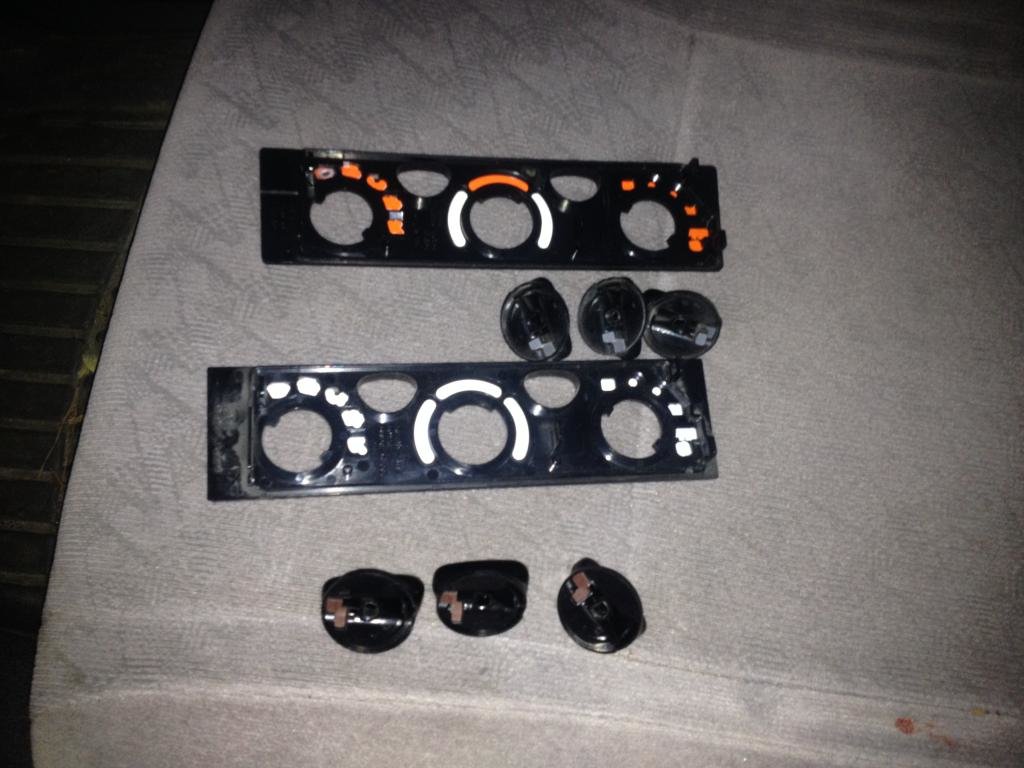

    Yeah same here, air hammer broke it loose. I still haven't gotten it fixed perfectly. Rack travel is pretty much even but my wheel is 1/4 turn off. Whatever I'll fix it when I can get to it.

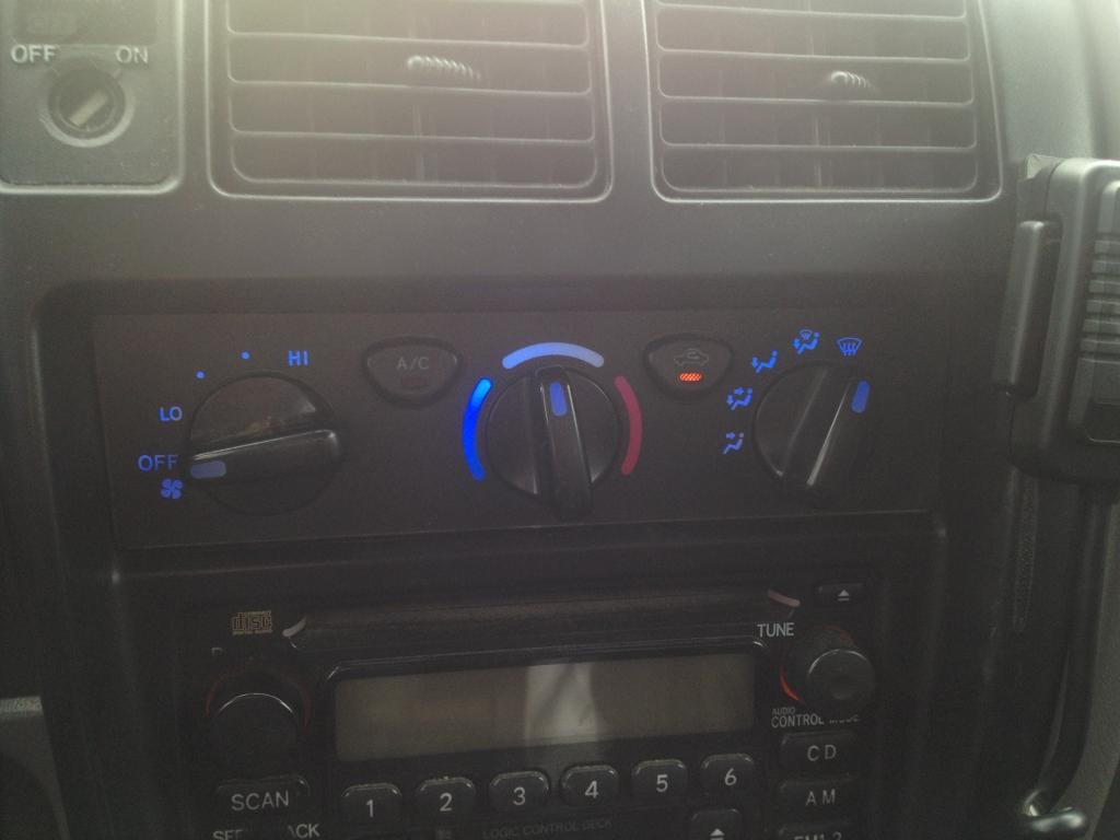

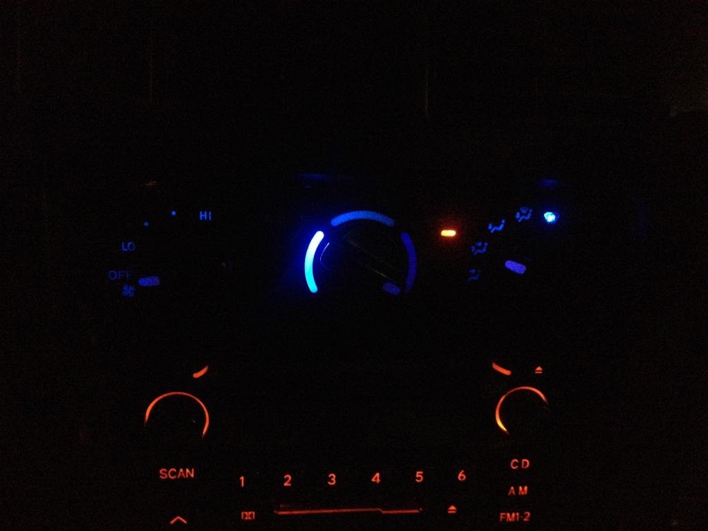

    Also finally found a solid solution to anyone who wants to run blue or green AC panel lights but do not want to use a new face plate (personally stock faceplate is clean and adding a white one mucks up the whole section)
    Turns out since 99-02 ( I believe) 4 runners used green lights they had clear white faceplates and knobs.
    Plates side by side:
    Old (Hardcore hot spots and not uniform color):
    New (Uniform color, no hot spots)
    Can even see the blue in the day now:
    Very happy with figuring out a solution to this.

    Nice man! That is something on my to do list. Any idea why some were green and others blue? Specific model or something?

    As far as I know all 99-03 taco's were actually orange, 95.5-97 were green. Mine are blue because I did the blue LED swap.

    Interesting. +1
    I switched out to blue LEDs a while ago to match my headunit, and was never very happy with how they looked. Now I need to keep my eye out for 3rd gen 4runner to steal that out of.

    Definitely. I just went on the t4r and hit up a dude who totaled his and got the panel and knobs for $30.
