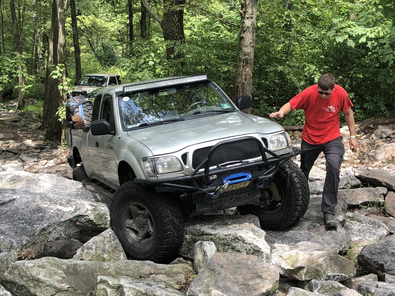

    I'll post a quick update to what lead to all this. A weekend full of carnage.
    I made it out to Rausch for the first time this year for the NTC Takeover. The intention was to keep it relatively mild on Friday so we wouldn't break too much shit so we can still wheel hard on Saturday. We wanted to start on Tata's because I haven't been on it in ages and wanted to try out the new black lines that were added. On the way we came across "Walk in the Park" a black hill climb. It was a pretty easy hill climb but fun for sure. It pretty much goes straight up.
    [​IMG]IMG_8378 by Michael Halat, on Flickr
    Only had a minor issue where @Cyberman's hubs would not engage but once that was sorted we were on our way.
    [​IMG]IMG_1748 by Michael Halat, on Flickr
    We ran Tata's with all the black offshoots and that eventually put us out to Cemetery. Cemetery was going great until we came to the red line out of cemetery. I took one of the harder but still looked doable lines and finally got over the ledge I was struggling on only to bind the front wheel and bust a cv. So I needed to winch myself out of the bind to get my wheels straight so that I could back down.
    This is the red line:
    [​IMG]IMG_1168 by Michael Halat, on Flickr
    Everyone ate lunch while I went to work changing my CV.
    This is where I was struggling to get up, and did mange to get up through it.
    [​IMG]IMG_6846 by Michael Halat, on Flickr
    [​IMG]IMG_8888 by Michael Halat, on Flickr
    But once I did, I bound up hard up front.
    [​IMG]IMG_2290 by Michael Halat, on Flickr
    Really want to get rid of wheel spacers to make cv changes faster.
    [​IMG]IMG_4052 by Michael Halat, on Flickr
    [​IMG]IMG_2994 by Michael Halat, on Flickr
    The damage:
    [​IMG]IMG_1176 by Michael Halat, on Flickr
    [​IMG]IMG_1177 by Michael Halat, on Flickr
    Oh well, no big deal. Changed the CV and got back on the trail. @Rockbaron1 , @HolyHandGrenade and Karen all got up the red line with no issues and Mike and I continued to the normal end. From there we ran both 22 and 21 and called it a day. Both were pretty fun trails, 22 was off camber, rocky and tight. Karen had lost her roof rack on the jeep. My buddy and I booked it out of the park so I can get another spare CV for Saturday. Got the CV, put it in my spare case, and was ready to rock.
