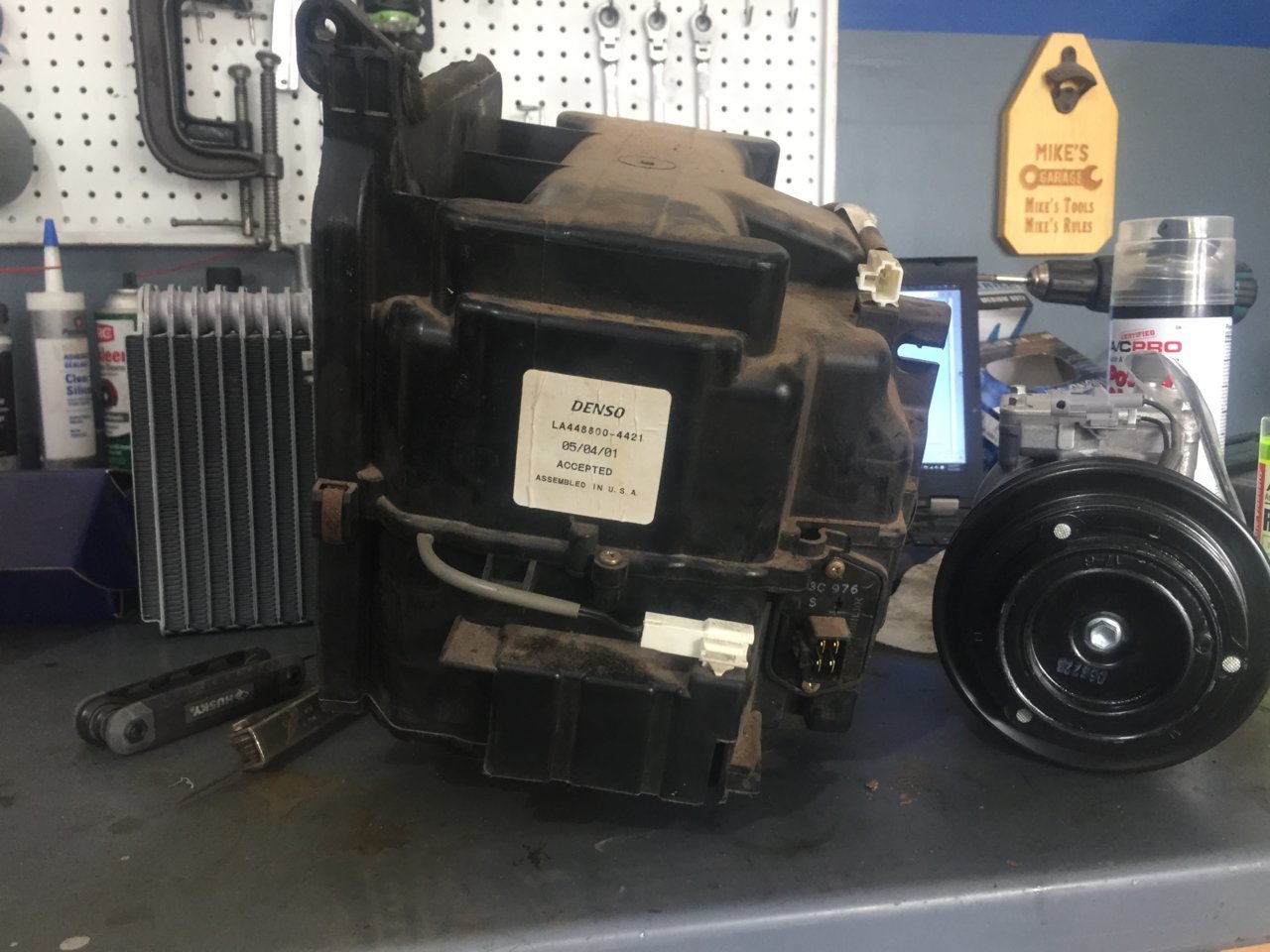

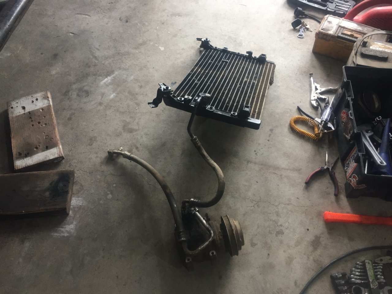

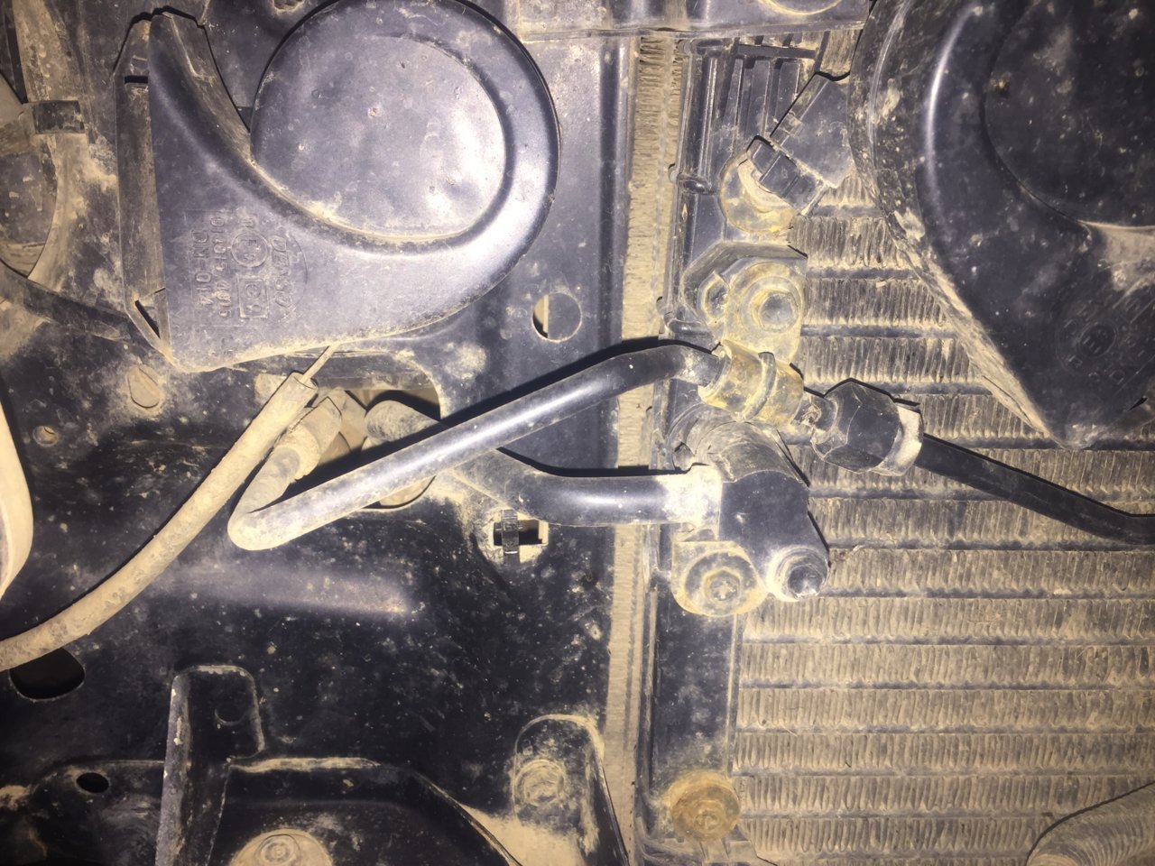

    Started the AC rebuild, snapped a condenser mounting bolt and a bolt that mounts the line to the left side of the condenser shown in this pic (AC discharge line IIRC) so I ordered a new line since that bolt is holding that line to the old condenser.
    I also found NO OIL inside the compressor. Look at the date on the evap housing haha. Everything is out, will get rebuilt, resealed and re oiled on Wednesday.
